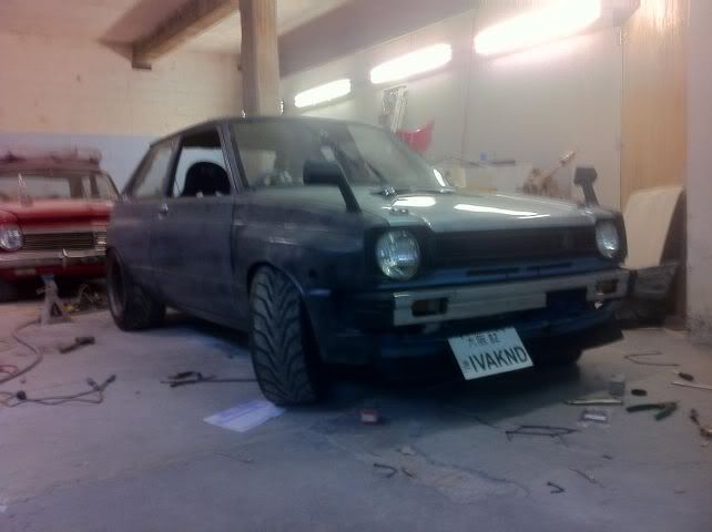

first things first though i made it into gt refinishers to get a little more done on the underbody and a bit of strengthening done.
