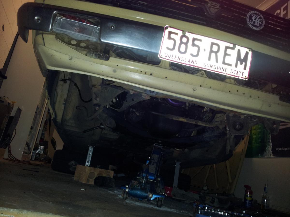

Yeah. Poo's. Well I can start pulling the front end apart. Install the master.
Get the bottom of the struts built. Get the bushes in. Tinker tinker.
Anyone know somewhere online to buy a XT130 brake rebuild kit? Or would it be easier going to Repco.
EDIT: Found these, pretty cheap. EDIT: Double the price including shipping.
PBR does a rebuild kit. Will go see Pedders on Saturday.
