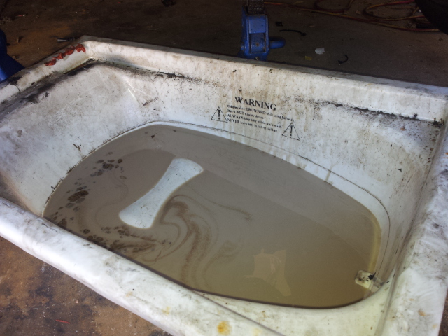

Ill run it for quarter of an hour tomorrow, drop the Woolworths brand oil and put some yummy Penrite in, drop the water, reverse flush the rad and put coolant in and it'll be ready for a test drive.

Cheers Dave. This was the first flush. Put another one through with nulon flush and metho. Now has the good oil in. Few little things to do then drive.

Dropped the water and flushed the rad. Pit in some coolant and took it for a spin.
