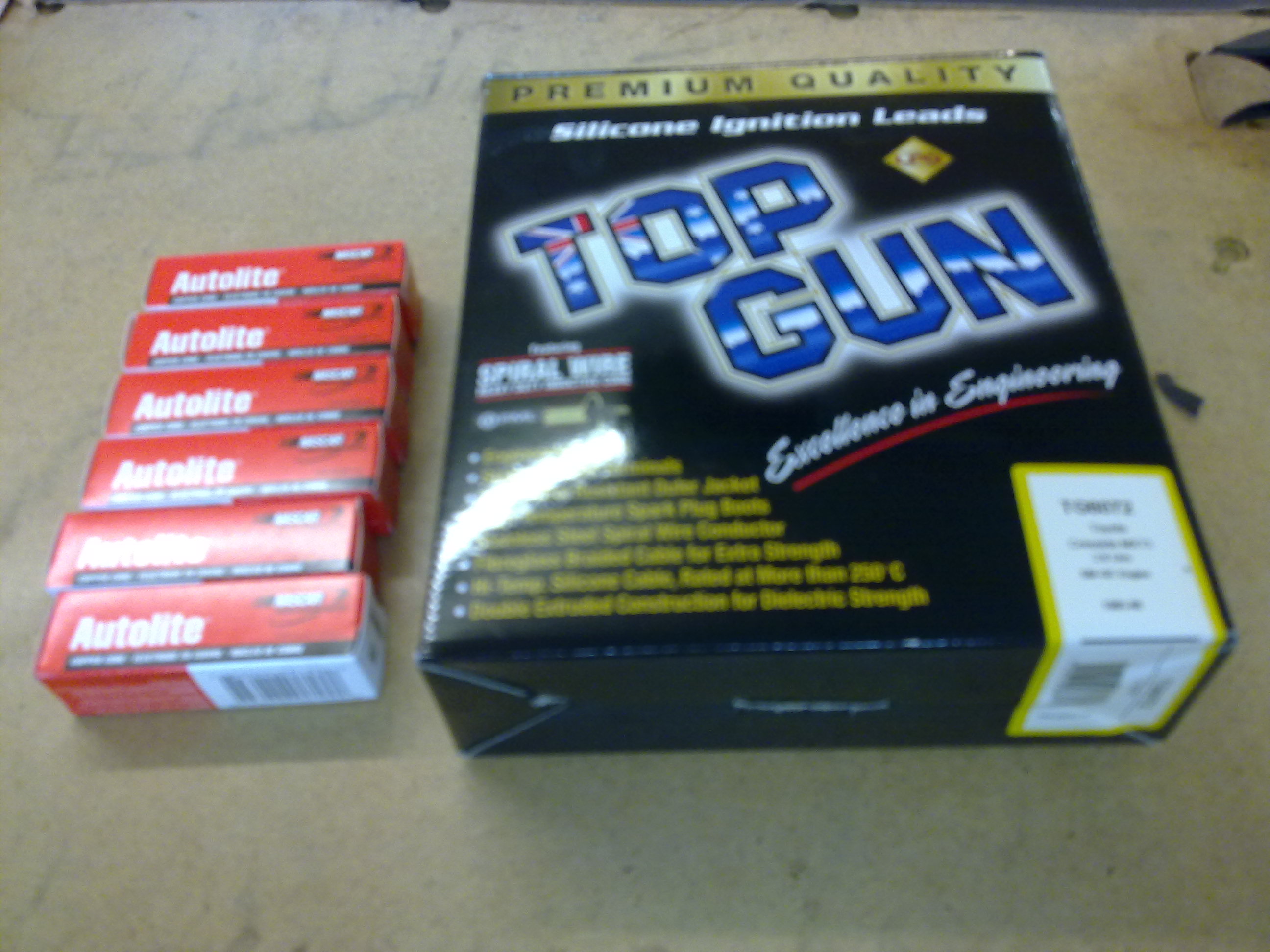

Got the Leads and Plugs ready to pick up from Dad's work. Now I just need the dough to pay for it now. :D
Josh :cool:
Got my new Leads and Plugs yesterday thanks to Dad. :)

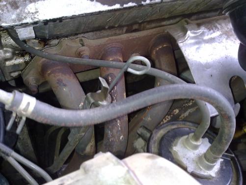

Changed the Plugs and Leads, although there is still a sort of Vibration/Shudder in it somewhere. Might be a Uni that has let go. :hmm:
I'll change the Oil and the Filter soon, and the next time our mechanic is up (pretty soon), we'll get him to check over the car and maybe give it a tune-up, as well as Ollie. :)

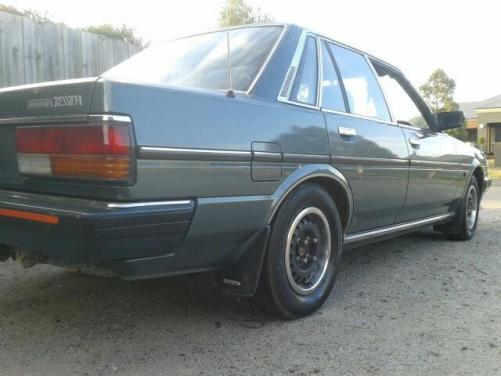

As far as the rest of the car, the Tyres are over 10 years old ( :D ), so either replacing them or finding a set of nice 17" mags is required. We may suspect that the Tailshaft Uni's are gone as there is a Vibration in the rear of the car which intesifys as you speed up. And every now and then, I wash it to keep the dust and cobwebs off the Cressie, and Start and Idle it to make sure the engine is still in good running order. :)
I'm now just getting the cressie fixed up very slowly as I'm in no rush, but come April/May next year, I'll hook into getting it RWC. The next thing that will be looked at will be the brakes, because they're starting to sound a little Rusty.
And another thing I discovered with this Luxo-Barge -- 80s Blue Velour Interior + Hot Sun = A Melbourne Heatwave. It gets really Hot in the Heat. But lucky enough, it has a Tilt and Slide Sunroof. :)

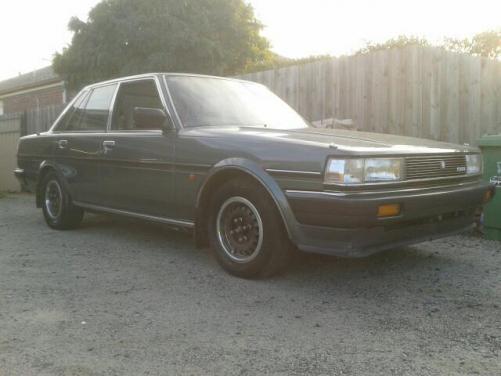

So I've changed the Ignition Coil, the Ignitor, and the Distributor Cap, and the "misfire-on-idle" is still there!
I had another well-experienced technician come out to have a look on NYE, and he suspects it's something to do with the fuelling. He specifically said the fuel filter could be very old, and it's not processing fuel into the engine and not returning fuel to the tank properly. So changing the filter is next on the agenda.
If it's not that, and I can't find what's wrong with the flippin' 5M-GE, I'm just gonna take it out, throw it in the bin, and drop in a 1JZ-GTE from a Soarer. :yes:
To re-cap: I have changed the Plugs and Leads, the Dizzy Cap, the Ignitor, and the Coil. It definitely is not a BHG as what I've been told from Both Technicians.
If anyone else has caught the drift of what I'm saying, and could possibly know what is wrong, please share on here. I just want to get the 5M-GE running correctly.
