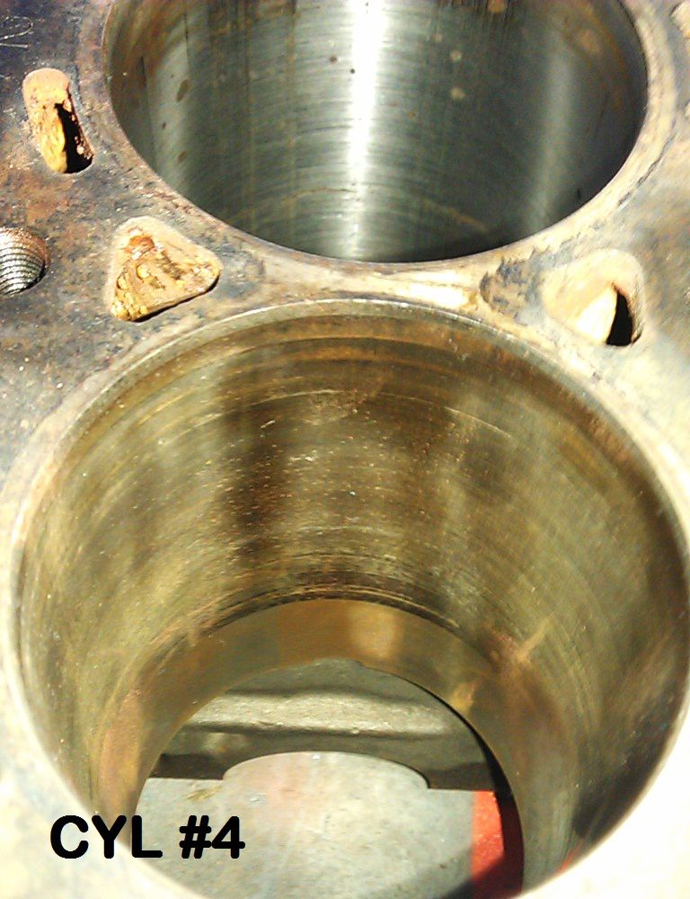

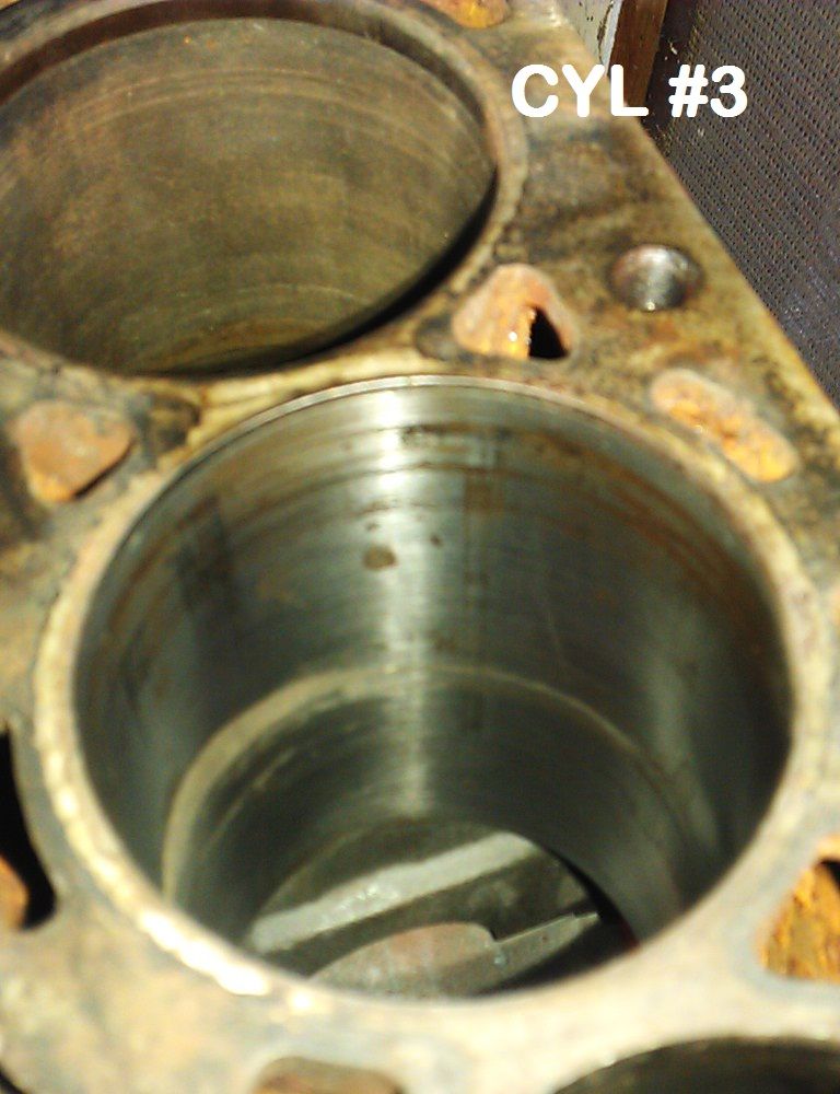

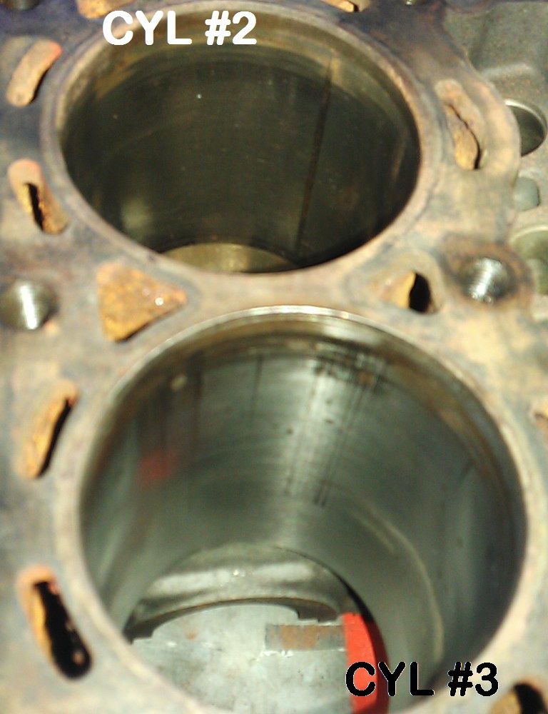

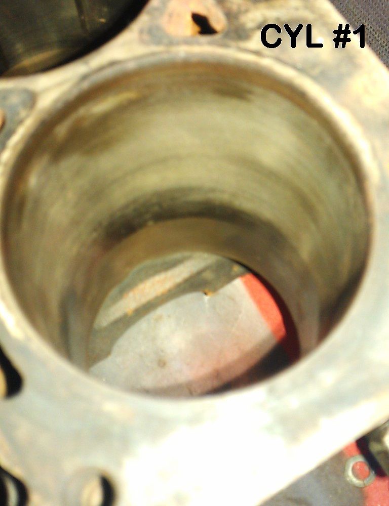

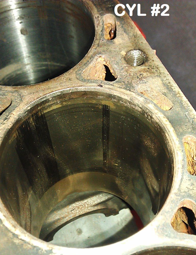

Yeah ring marks, plus what look to be some decent piston slap marks in one of the cylinders as well
If you let me know a good time I'll shoot you through a call if you don't mind?
No worries at all, cheers
Here's how the bores look. Photo's are a tad sketchy but i wasn't looking to win awards.
Majority of the marks are pitted not just visual
Just get her honed out and chuck some bew slugs in it. you won't regret having a nice fresh motor
Too deep to hone. Would either slap or blow smoke.
Oversize looks like the best option

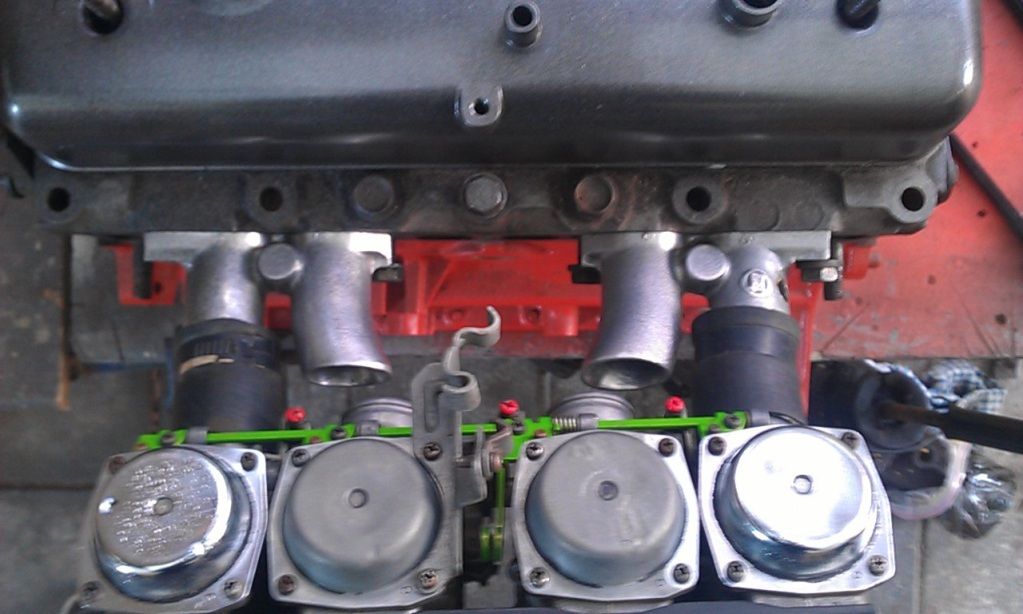

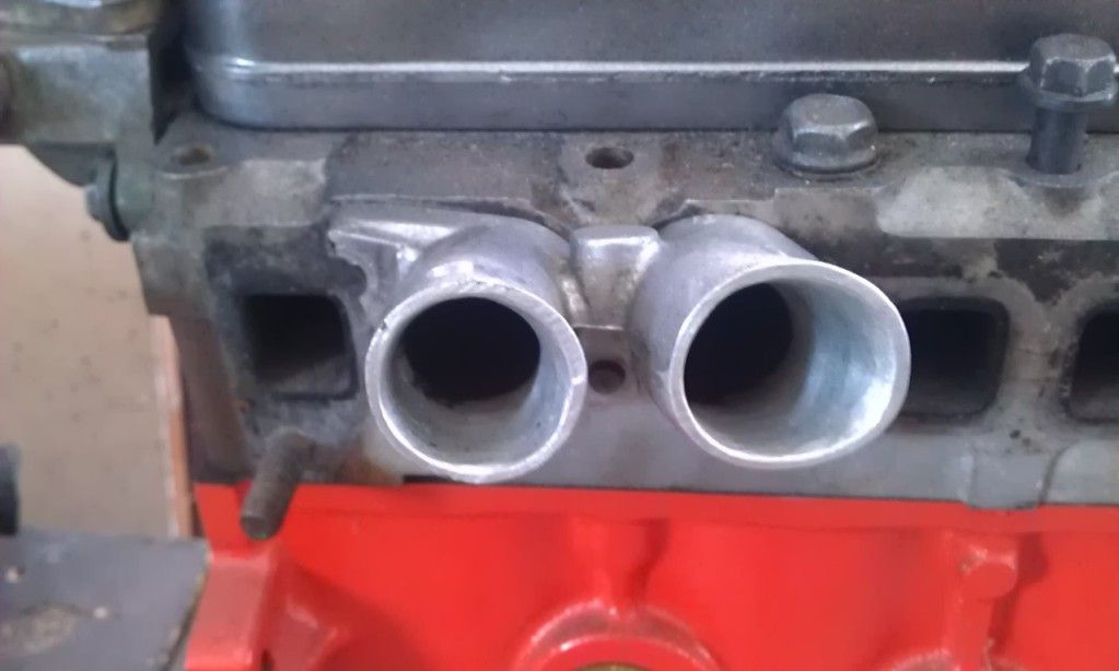

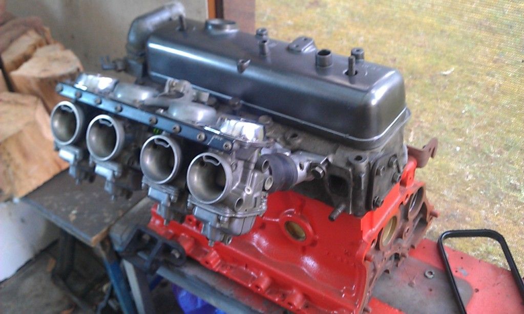

Carbs are Keihin VE series with a cable choke that will look to work well with a corolla setup

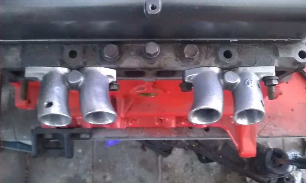

Just a standard K inlet manifold (4k-c) bigport wouldn't work as the runners are too close.
Basically sawn off and ported out..
Inlet #1 and #4 line up pretty well but 2 and 3 are a little off. This will be easily fixed when i run the llonger hose to the carbs (4" or so) It'll all pull in nicely no worries, or i'll heat them up and tweak them slightly.
But when the bike carbs will be sitting about 4" out then there'll bve no issue's at all.
Also it's not true that you want the bike carbs on an angle, not with these anyway.. As it can trigger the overflow and the fuel will pour out the bottom.. Right where your altenator is. So potentially it could end unpleasantly.
Nice, I like your idea of using the manifold. How big are they bore wise?
P.S. 0.5mm is 20 thou

The bore on what sorry? The carbs?
