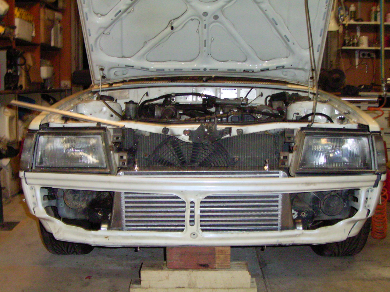

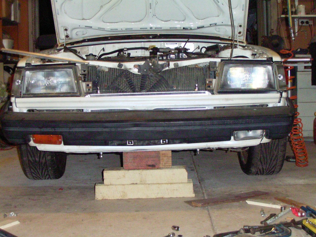

well, been having a play b4 and after tea and been thinking about everyones thoughts
heres what i came up with
no bumper:
bumper:
:dance: stoopid frigging bumper, the cooler disappears!!!!
so not cool :)
i need ideas/thughts/suggestions. help me guys
and in that first pic, thats as high as the cooler can go, coz of the brackets for the grill across the front
and the holes up the top are blocked so your idea corolla bitten is a no go :P
