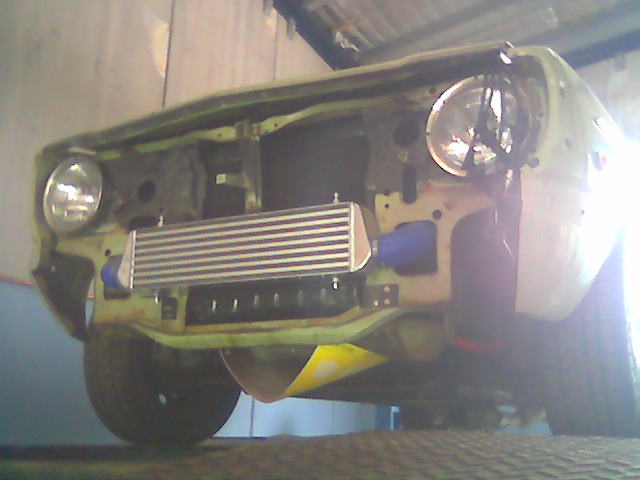

Jono Posted October 1, 2007 Author Report Posted October 1, 2007 started mounting the intercooler today. made up some dummy brackets and will make them out of some alloy. may have to lower the intercooler by 10mm so i can shut the bonnet or i could take a small check out of the top of the 'cooler, obviously without damaging the top horizontal tube. car is going in to workshop to get a steampipe manifold made on thursday. Quote
HIGH ROLLER Posted October 3, 2007 Report Posted October 3, 2007 Gday JC, mate that thing looks awesome with the front mount in there... who are you getting to do the steampipe manifold, or are you giving it a crack urself? keep up the good work champ, Marky Mark Quote
Jono Posted October 4, 2007 Author Report Posted October 4, 2007 (edited) Road & Race Exhaust in Hornsby is doing the manifold. I dropped the car off today, hopefully it will be back on the road in a couple of weeks with 7psi on low and 10psi on high. Just Engine Management down at Moorebank is doing the tuning. Apparently they have setup a few NA motors with bolt on turbos for drift on 11psi with no problems. Not trying to break any records or anything, just after a fun little sunday cruiser. Edited October 4, 2007 by JC807 Quote
