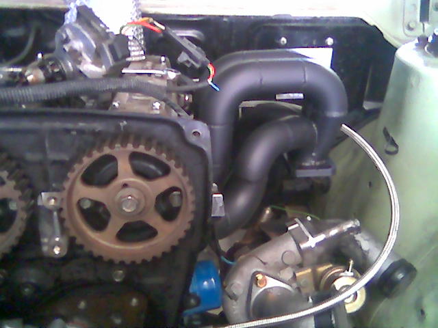

No worries, but what do you think of the cam cover?

new exhaust almost finished, then its intercooler piping, timing belt (again) and then a tune. hopefully be ready for the 9th march cruise to terrigal.

hi flow cat + 2.5" mandrel bent, resonator and will have muffler and dumpy.
