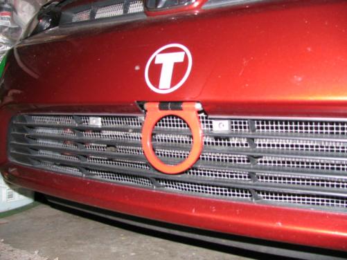

^ I assume he means those flashy red "drift/ race" ones.. Like this i assume? But weld on

^ I saw that. But that's bolt on, Not weld on as he said.. So presumed he meant the other type
