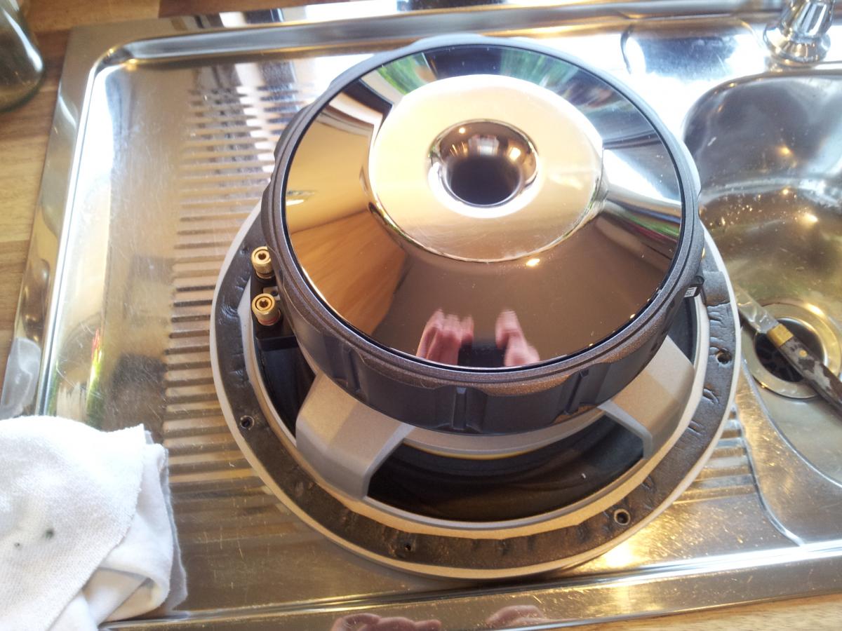

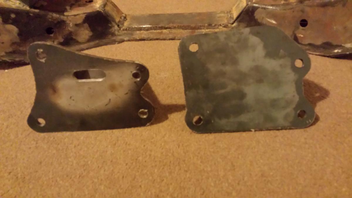

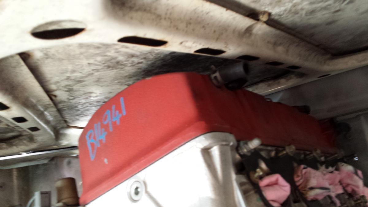

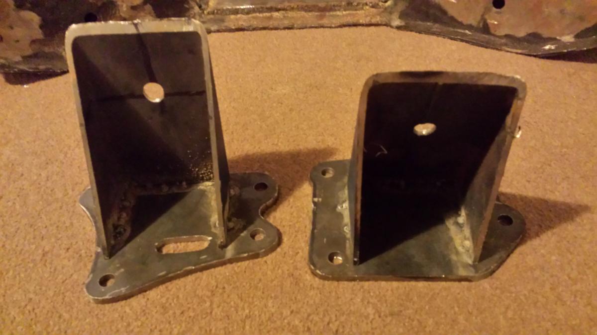

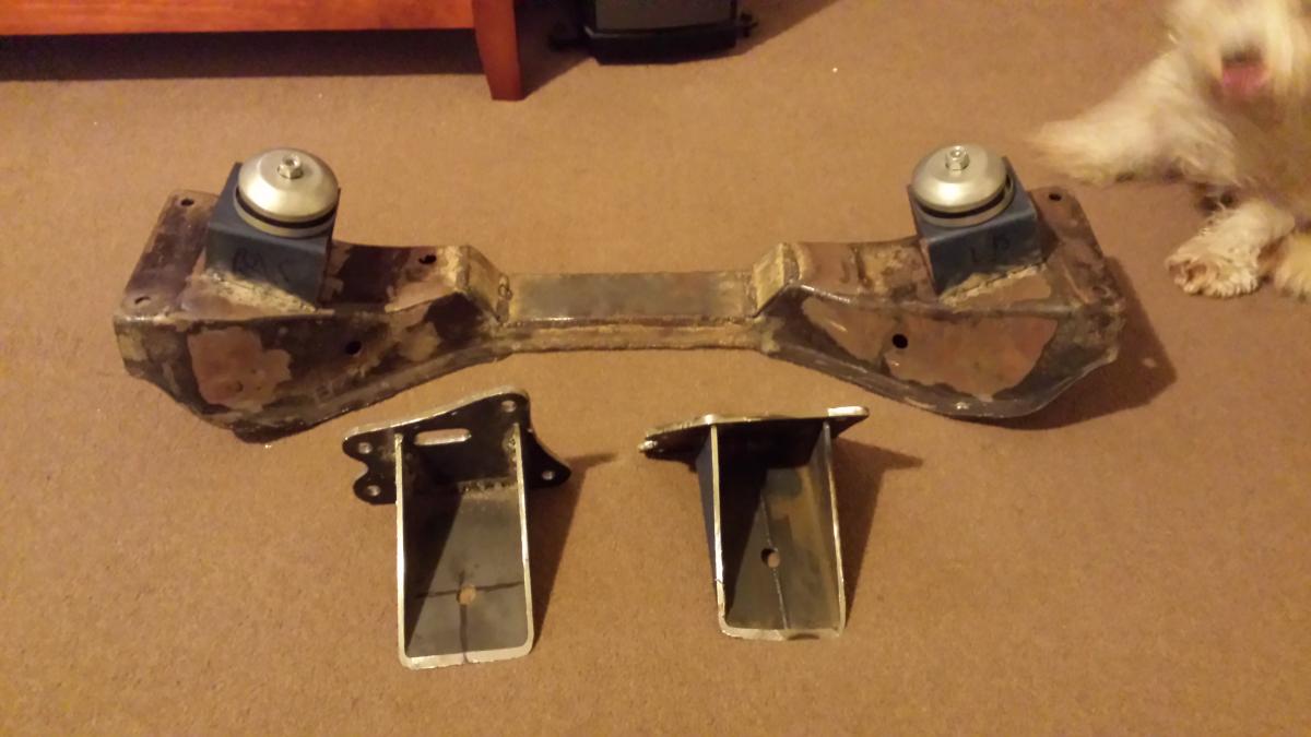

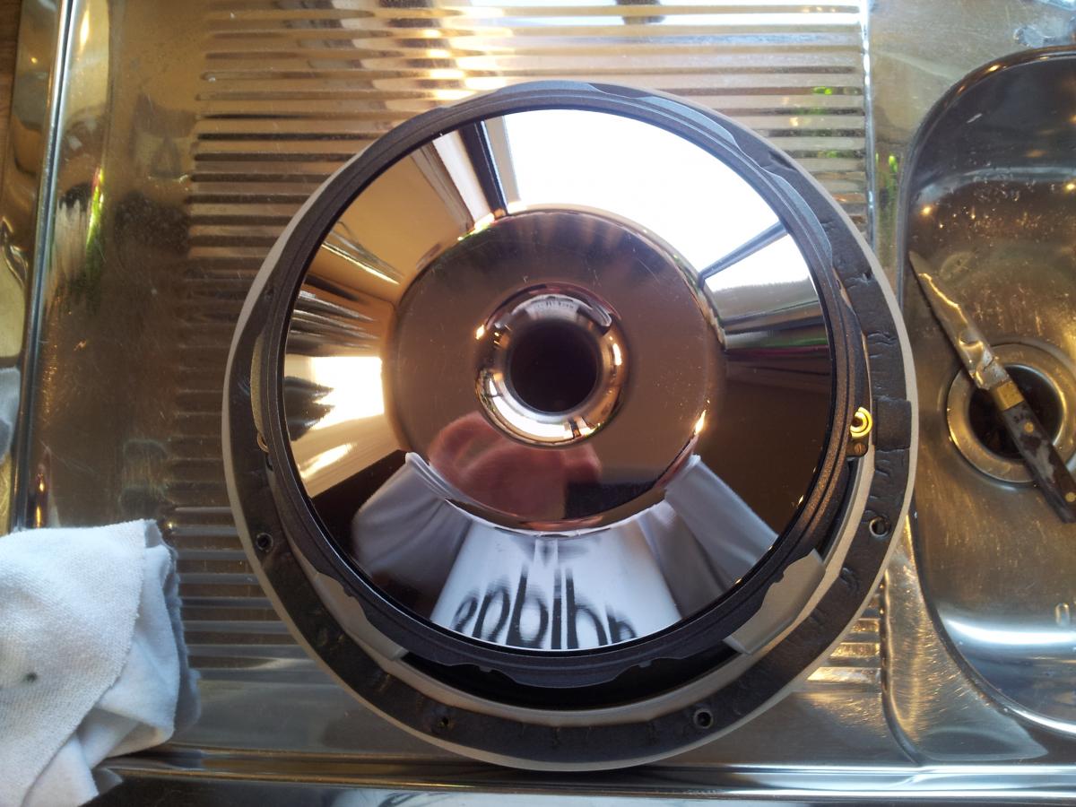

maccat01 Posted December 8, 2013 Author Report Posted December 8, 2013 (edited) Only about an inch of space between rocker cover and bonnet. Crossmember and left and right engine mount. Engine mounts again. The left mount needed a hole cut out of it to fit a stupid knobby thing sticking off the side of the sump. They base plates are fabricated from 6mm mild steel plate. The out riggers are made from 4mm mild steel square tube. There is only the one continuous weld on the mounts, so they should be immensely strong. It took me 10 minutes to cut along one edge with a 2400Watt steel cut-off saw as its sooo thick!!!!! And the other angle. Note that they are only tack welded. The big slugs are being laid down by my uncle as he a pro welder. Was going to get these made by a fab shop but decided to give it a go myself. When the edges are all finished and routed and its been painted, should look awesome. And finally my sub woofer... can't remember if I posted it up here yet. Edited December 8, 2013 by maccat01 Quote

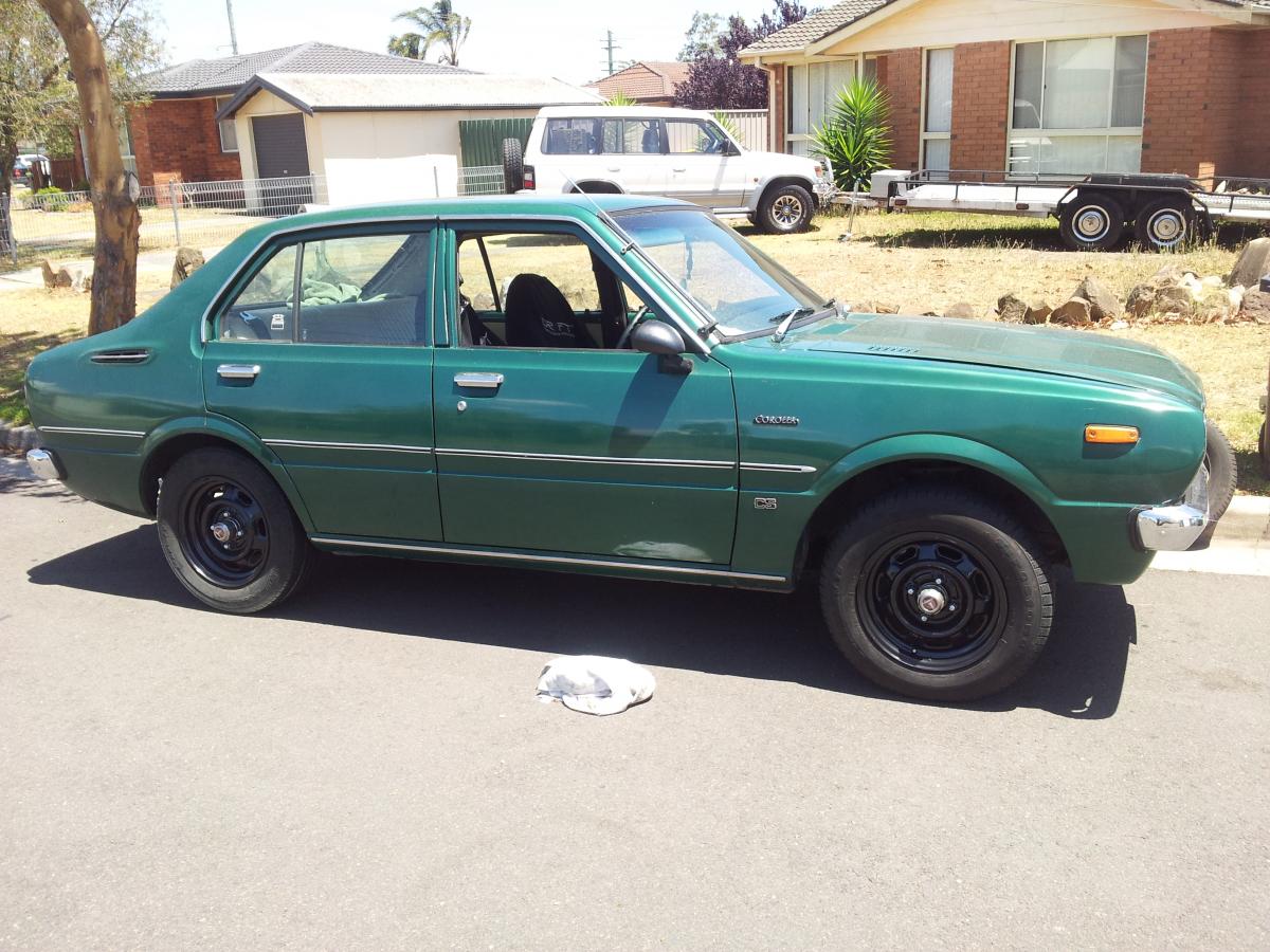

maccat01 Posted December 8, 2013 Author Report Posted December 8, 2013 And a pic of the daily driver with some freshly painted celica 14 inch wheels. I got two punctures on the way to work a few weeks ago and had these wheels laying around. Quote

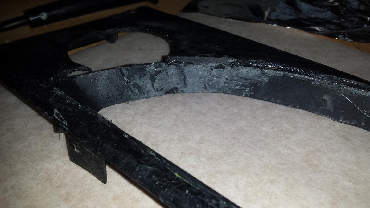

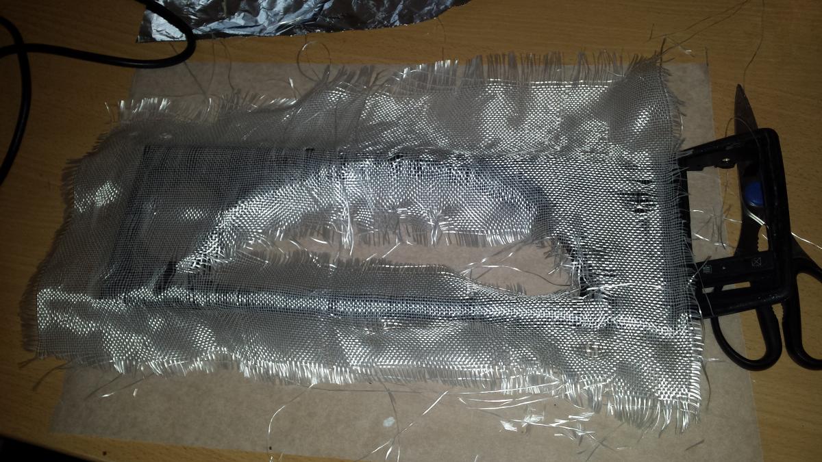

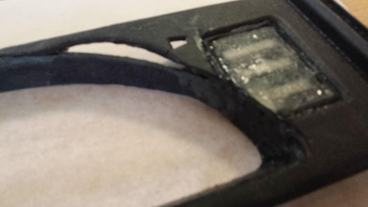

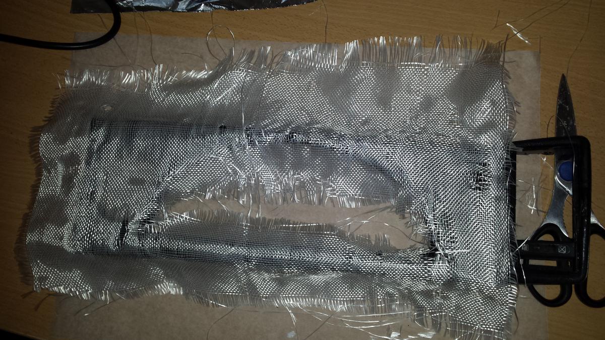

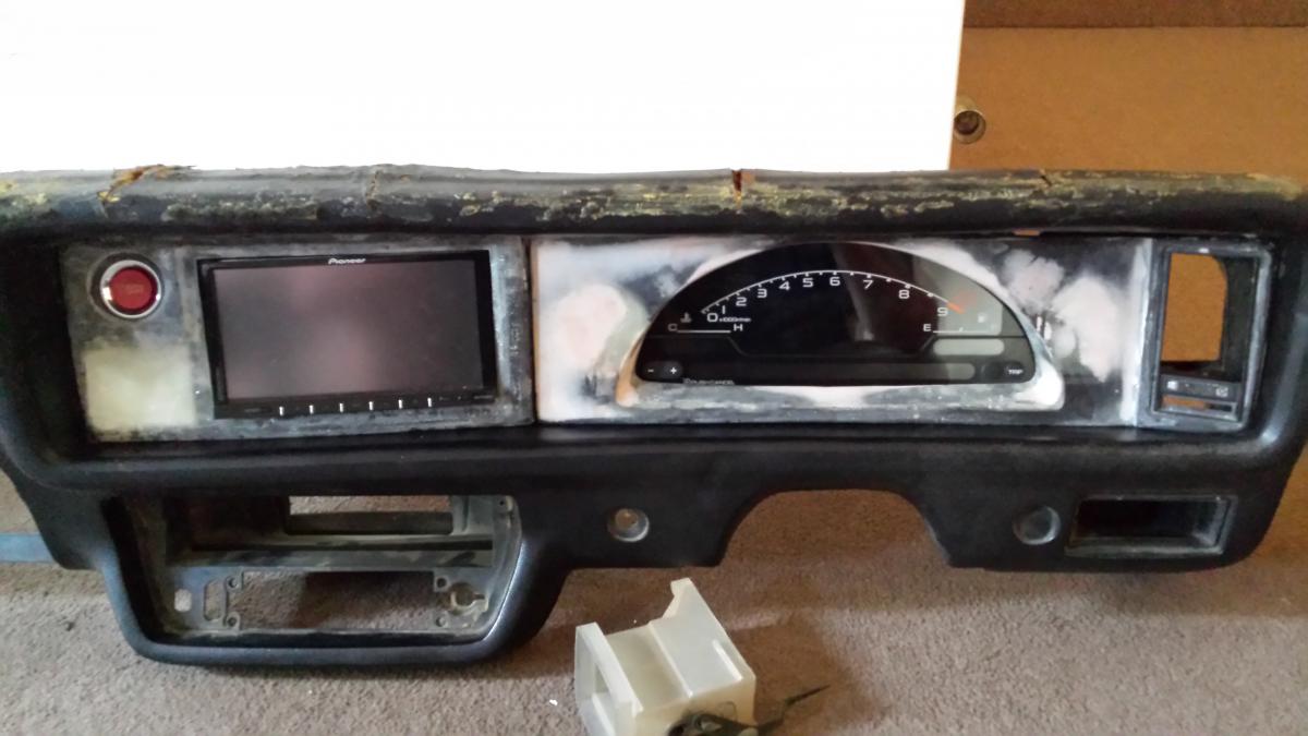

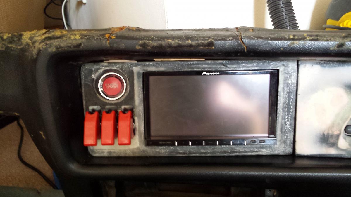

maccat01 Posted January 20, 2014 Author Report Posted January 20, 2014 I think it is. I took the head to get a full service, but it appears my rad is blocked or water pump stuffed. Its overheating at high speed now, not waiting at the lights. As for the modified one. I tried to post some pics last nite but it didnt post them for some reason. My Engine cross member and mounts are complete so will have pics soon. My dash surrounds have all been cut, fibreglassed and sanded and are awaiting a covering of carbon fibre. I have cut speedo cluster mounts and mounts for my Pioneer DVD screen out of 3mm thick galvanised steel sheet. Real pain in the ass to get the right shape too. I have fibreglassed my usb and aux ports into the s2000 centre console this part is also waiting for carbon fibre. When i get paint and primer my crossmember and all suspension parts with be painted and finished. I will be welding the s2000 transmission tunnel when i have time to get the crossmember in the car in a couple of weeks. Most of the build is being held up because i need the tunnel in to measure where the seats will mount. I have started to shape my boot install and am in the process of cutting out the floor out of 10mm mdf board. Pics will deffo come tonight Quote

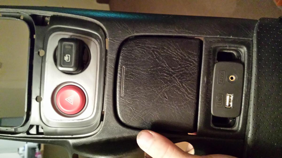

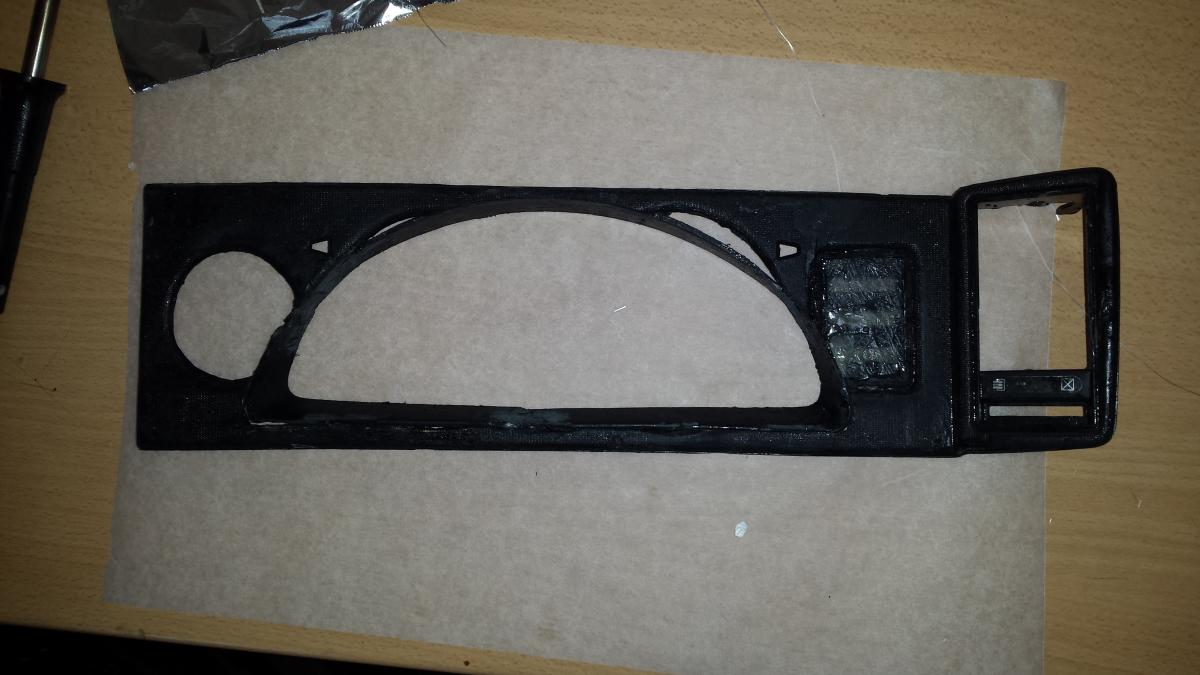

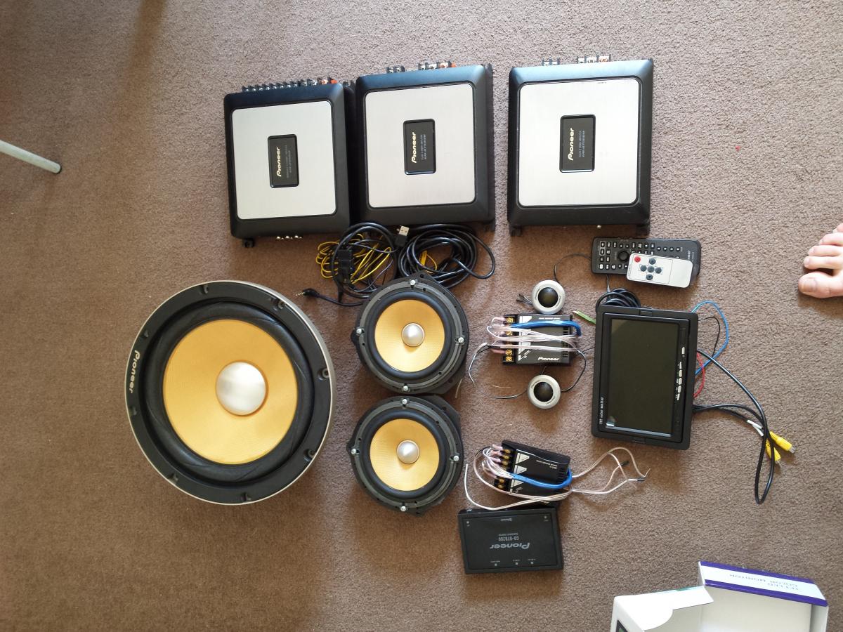

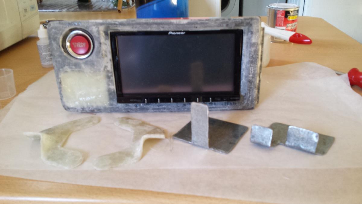

maccat01 Posted January 25, 2014 Author Report Posted January 25, 2014 Plastic welded together to make right shape start for fibre glassing job whole facia shaped and brackets made for radio and gauge cluster. switches fitted for air horn, driving lights and random stuff usb/aux panel fitted courtesy of my wrx. sound system and my new 7 inch monitor for rear seat passengers. It will be built into trans tunnel as it is running back to the rear seats 1 Quote

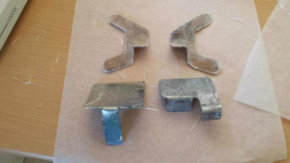

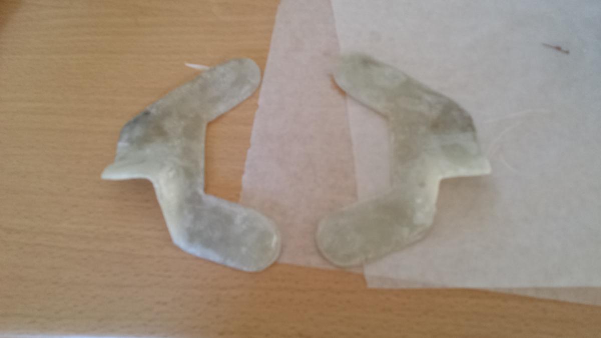

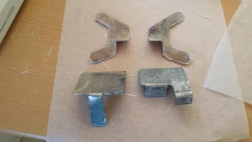

maccat01 Posted January 25, 2014 Author Report Posted January 25, 2014 metal brackets for radio and fibreglass brackets for speedo. ( fibre glass speedo brackets have been replaced... they worked very well and were super strong, but there was no adjustment in them, and as such when I fitted cluster surround it sat out by a few mm... so I just cut new ones and the same shape from 3mm steel... Quote
Robski Posted January 27, 2014 Report Posted January 27, 2014 Interesting set up Dave and looking like it is coming together quite nicely. Never been the sort of person for large ICE system but will be very interested to see the final product. Especially like the AUX and USB input point. What year was the WRX that you poached that little trinket from??? Quote
maccat01 Posted January 27, 2014 Author Report Posted January 27, 2014 It was from a 2011 wrx. I owned one for a short while but ran out of money to pay for it :-(. Very good car but better to have money to live haha. they cost about $100 from dealer but ill have to fish out the part number if you want one as its not listed as a spare part on australian dealer network parts catalogue!! Quote

maccat01 Posted January 28, 2014 Author Report Posted January 28, 2014 @ robski. There are quite a few variants of the subaru centre console ports. There is usb/ aux, just usb, just aux, aux with component R/W/Y and usb with R/W/Y. I'm having trouble finding the one i have but it appears the easiest one to aquire is the usb with R/W/Y. ill post a full list of parts numbers when home this arvo. Quote
