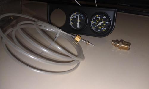

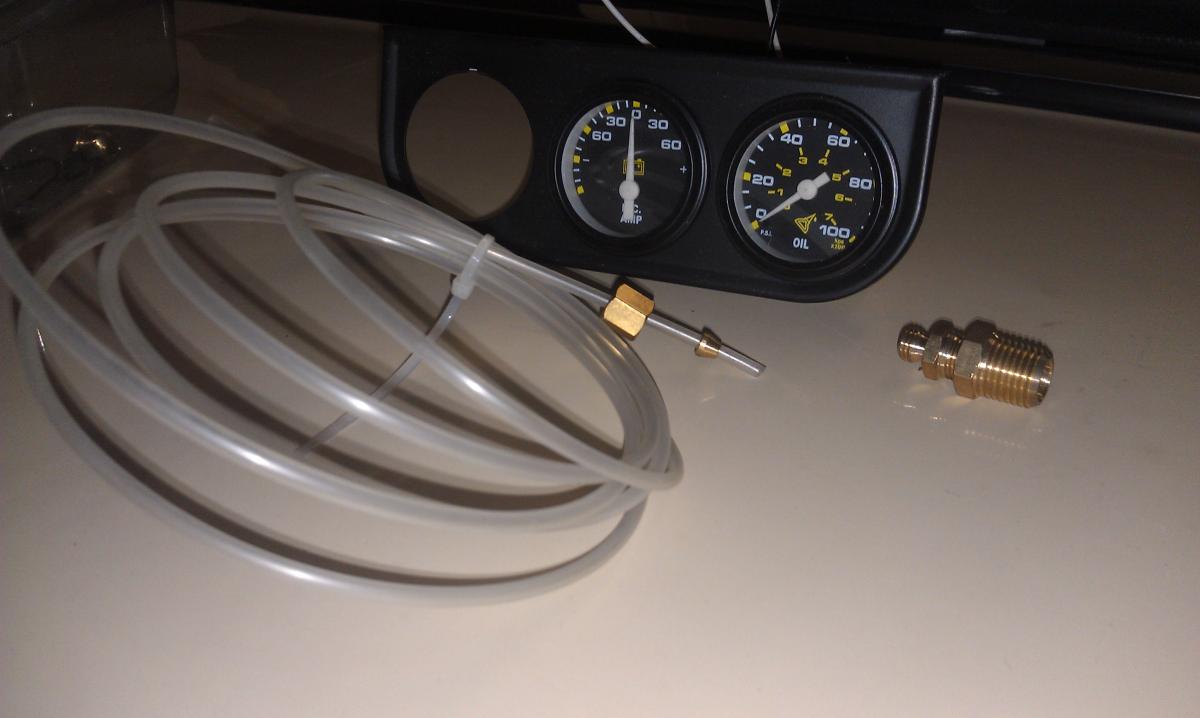

B.L.Z.BUB Posted August 15, 2012 Report Share Posted August 15, 2012 Ive got an oil pressure gauge in my garage ill never use you can have for postage. It just needs the hose and some fittings I think (might still have them all). Ill see if I can dig it out and get some pics if you want. Quote Link to comment Share on other sites More sharing options...

B.L.Z.BUB Posted August 16, 2012 Report Share Posted August 16, 2012 (edited) The one I have is mechanical. EDIT: And free :P Edited August 16, 2012 by B.L.Z.BUB Quote Link to comment Share on other sites More sharing options...
altezzaclub Posted August 16, 2012 Author Report Share Posted August 16, 2012 (edited) Ive got an oil pressure gauge in my garage ill never use you can have for postage OK, the use of the gauge was to see if the sender unit was reading correctly. Let me see if the Pintara sender fits tomorrow, and if it doesn't then getting that gauge would be good. Once I've tried it I can return it or pass it onto someone else who needs it. That will say either new sender needed or new pump needed. I can't see how the oil pump is worn out when the motor isn't that high a mileage, still under 200k, maybe there is something else I'm missing.... faulty sender, shit under the release valve, pump bleeding around the gears, worn bearings... Edited August 16, 2012 by altezzaclub Quote Link to comment Share on other sites More sharing options...
B.L.Z.BUB Posted August 16, 2012 Report Share Posted August 16, 2012 No worries, all it needs is one of those little brass V things that is on the tube which it never came with, which is why I never installed it. Annyone need an ammeter? Quote Link to comment Share on other sites More sharing options...
