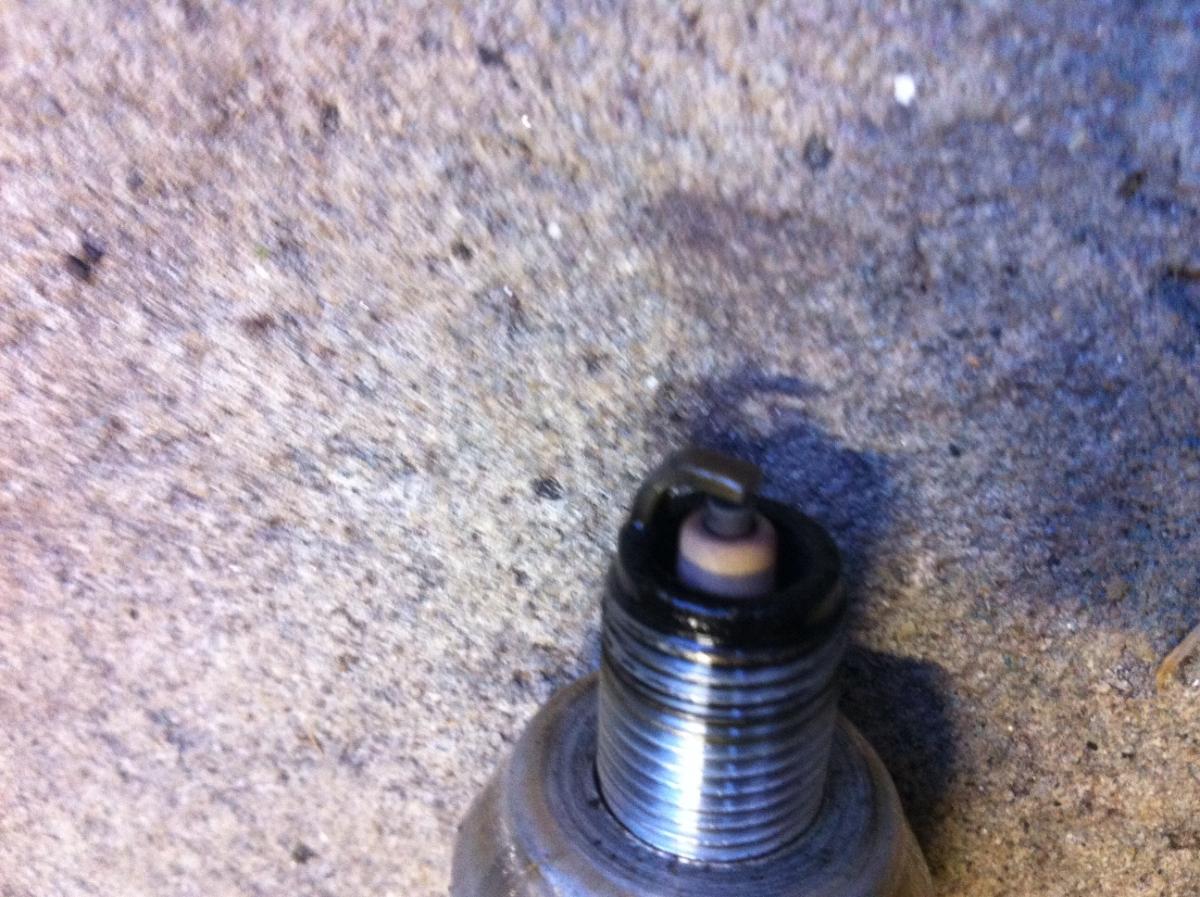

So I dropped 110 main jets (I had 135) reved out like a normal motor ! This is how the plugs looked after a drive - Does it look lean?
Looks like it is running normal.

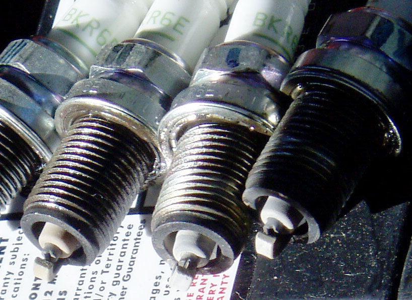

Here's a handful from the Altezza after a run up the big hill outside Tamworth. I had the fuel mixture display from the KE70 in the Altezza that day and it stuck on 14.5-14.7 all the way.
