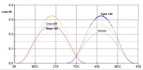

hi guys i have attached my cam specs to this post, would anyone be able to tell me if the cam is any good for what i am running? not real good in reading this kind of stuffcam specs.pdf
289deg is pretty wild, but all that means is that it shouldn't run UNDER 5000! :D
The way I see it you have only 0.325" of valve lift, so its not going to stress the valve springs. Stock springs are OK to 0.4" plus a bit.
If you can check that an inlet opens 40deg BTDC then the cam timing is fine and the problem is somewhere in the carbs.
Check the float levels, make sure the jets and drillings are clean and do a plug cut when its dying on you. See if the plugs look suspicious when it bogs down, because with that cam it should fly high up. While you're sitting at the roadside pulling out plugs, take the top off the carbs adn see if its drained them or flooded them right up. You can't let the motor idle down, its a case of ignition off and clutch down immediately from hard power.
