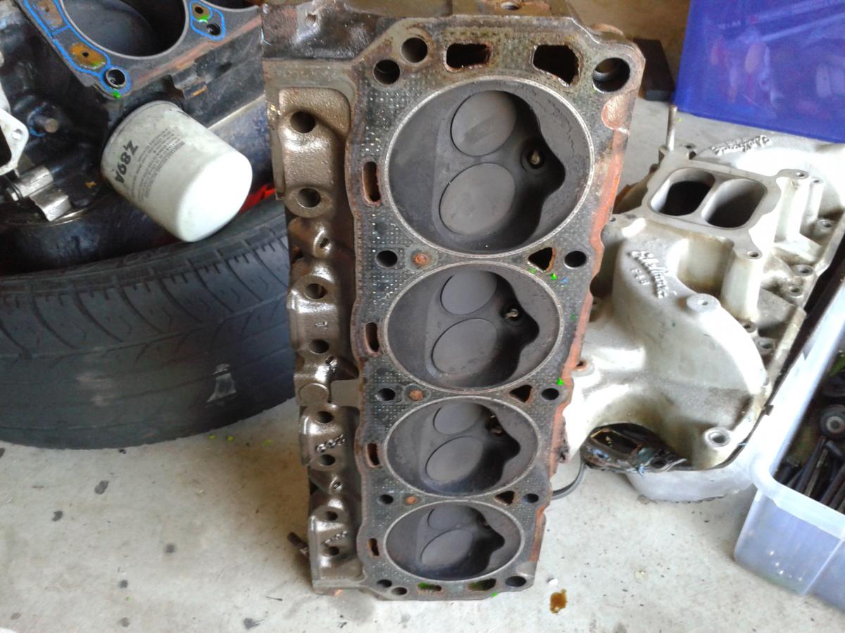

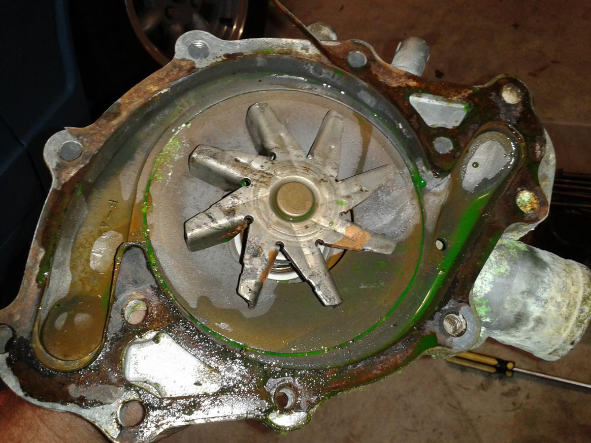

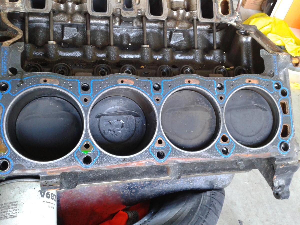

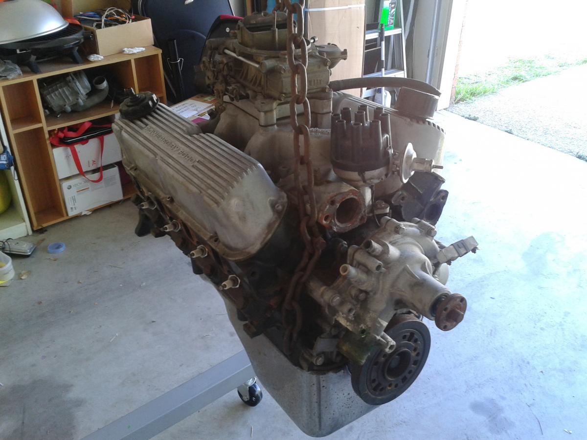

Just had this fall into my lap. I have since pulled it down to find out what's in it. And wasn't that a surprise.
Basically it is...
1966 Windsor 289 bored .060" to 297 cubic inches.
ACL Race Series pistons with chromoly rings
Big ʞ©$ɟing chrome sump
Rollmaster timing kit
Stage 2 Heatseeker cam
Ported heads with 302 stainless steel valves, threaded rocker studs and double valve springs
Edelbrock F4B intake manifold
Holley 600 with spacer plate.
Modified Boss 302 dizzy.
It's really clean and hasn't seen a great deal of milage. From what I've heard it spent 2 years in the car and then 7 years on the garage floor. So i'm just getting a gasket set and slapping it back together. Needs a dipstick, fuel pump plugs and leads and a longer oil pickup. Thermostat housing also.
