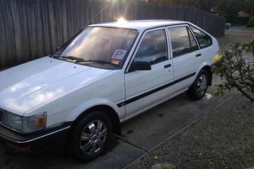

October 17, 201214 yr comment_632197 righty-o folks, i would love some input in turning my little hairdresser car into a creeper... which is to say its gotta look stockish, but gotta do better than 140 kph down hill. how ever my cyber car feaks, i am on a severe budget, $750.00 i know not much, but i have already fed the thing money to get running again with an engin rebuild. (head replacement.) Report

October 18, 201214 yr Author comment_632324 ok, people the 140 crack was a joke... i wouldn't do that on the open road, though i doubt the beastie would go that fast. $750 however is my current available funds... and how much it cost me to buy the car. but by end of next month the budget will grow to about $2,200. i figured the exhust would be on the cards (this is including manifolds etc etc etc.) which is why i am hunting around for something to strap right on there but give me a minor boost to performance. so the old girl doesn't have to work so hard when climbing the mtns/ hills i live close to. but keep the comments coming though i would appriciate it if people would say what kind of exhust, or engin mod, and a good place to check the products out. And as usual have fun stay safe. Report
October 18, 201214 yr comment_632332 Unfortunately the real answer has already been said, buy a wrecked twincam or 4age engine package if a bit of power is what you want. Just a list of what you would need to do and you might just go a little bit quicker than a stock 4age. Carby upgrade - adaptor plate, tuning by carby speciallist Exhaust - Extractors to muffler Head work - Mild camshaft with slightly higher lift and a moderate increase in duration, Bigger valves if you want, Porting, Shaved head. Price guide: Carby upgrade: Carb + adaptor plate ~$250 for a basic Webber 32/36 Jetting and tune ~$500 Totals: ~$750 Exhaust: Extractors ~$250 - $350 depending on where and what you get System Extractors back + new muffler ~$600 - $700 Totals ~ $850 - $1050 Head work: Porting ~$300 - $500 can greatly vary depending on who you know Mild camshaft ~ $200 - $250 (price to do a 4k is about ~$200 plus machining lifters) Must supply own camshaft Shaved head or block (not sure which is better to do on a 4A) ~$200 - $250 (based on what it cost me on a 4k) Bigger Valves (optional and not sure if can do readily on a 4Ac) ~$500 - 600 Totals ~$700 - $1000 Grand total: = ~$2300 - $2800 - not including bigger valves It's a bit of a guesstimate but those prices would be farely close to your total cost. The prices apart from the carby and exhaust would require you to do strip down and assembly. If you need a workshop to do all the work double the price. What I have not included is a full balance and lightened flywheel which would bring the price up another ~$1000 Suddenly a wrecked 4age sounds appealing eh? Edited October 18, 201214 yr by Twinky Report
