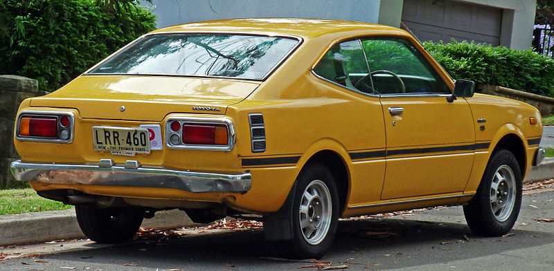

altezzaclub Posted October 19, 2012 Report Share Posted October 19, 2012 get one of these! Quote Link to comment Share on other sites More sharing options...
