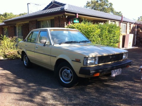

hi just bought a granny spec ke70 needs to be lowered I'm wanting to spend no more than $1500 on coil over just wondering if i can buy ae86 coil overs and put them straight in or do i need to modifie alot of stuff? iv lookd around and can't really find any info and yes I'm aware theres shit loads of lowering forums.
what is the best coild over/ easiest to install into a ke70 and where can i buy them form asap?
any help greatly appreciated thxs
