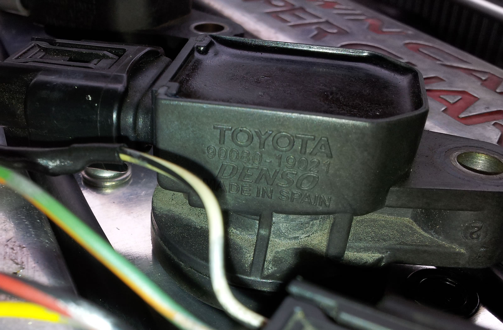

Sznaps Posted May 3, 2015 Author Report Share Posted May 3, 2015 I am using ecumaster emu & Denso 90080-19021 (used in yaris i believe) ignition coils. As how to set this up this i cannot explain since its electronic mambo-jumbo only my ecu magitian fully understands Quote Link to comment Share on other sites More sharing options...
Sznaps Posted May 3, 2015 Author Report Share Posted May 3, 2015 Quote Link to comment Share on other sites More sharing options...
