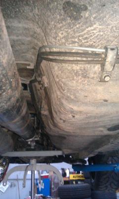

Lastly I spent some time making the transmission crossmember.
It's one piece of steel C channel. Not finished yet as I need to make a raised platform at the back (remember I'm solid mounting the engine and gearbox). Pic is before it's welded. I'll post more pics when it's fully completed.
