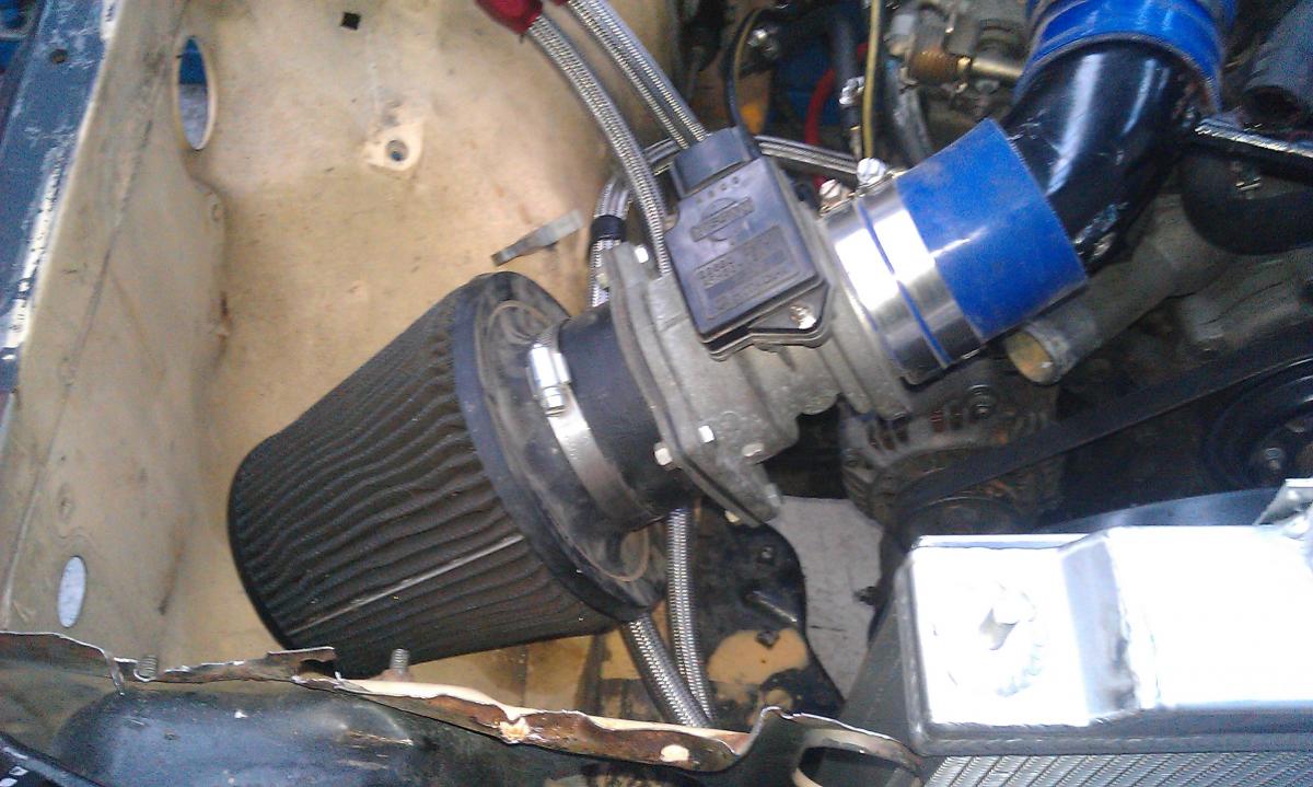

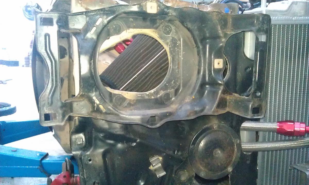

I mocked up the air filter assembly to make sure it cleared
When in daytime i won't run a drivers light and will use this as a cold air induction

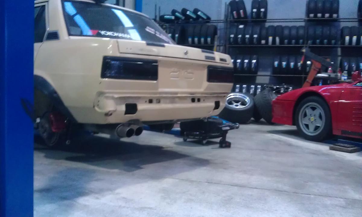

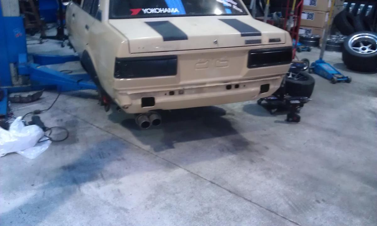

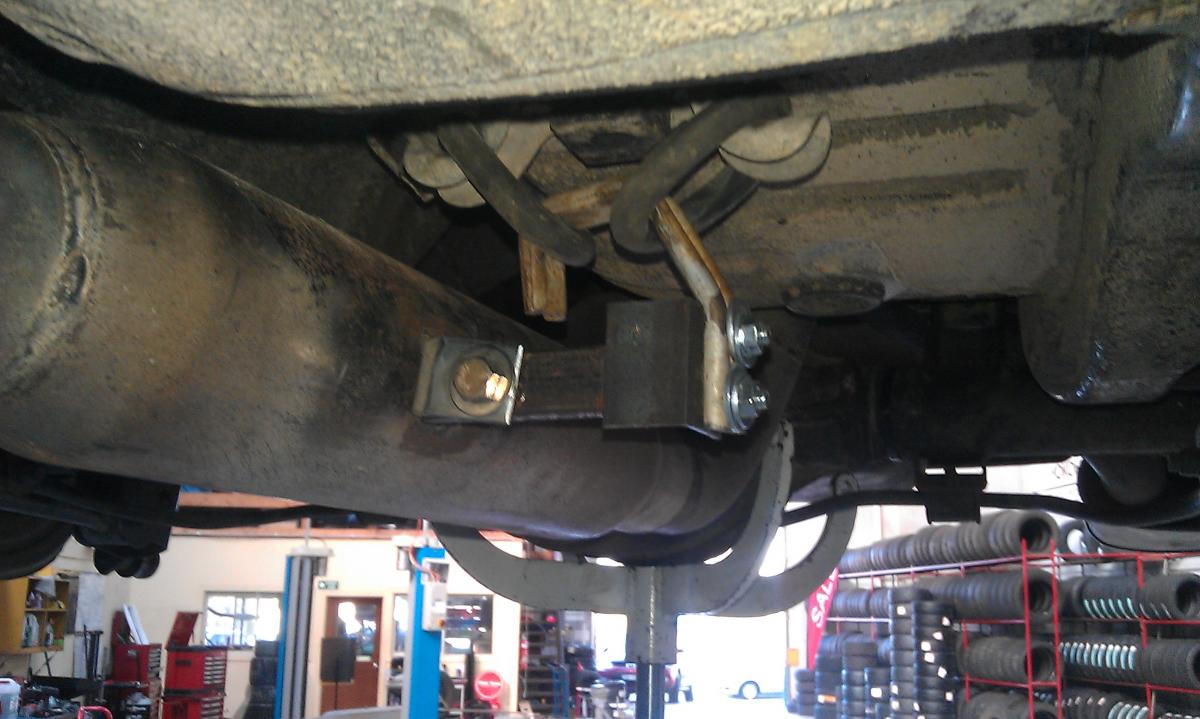

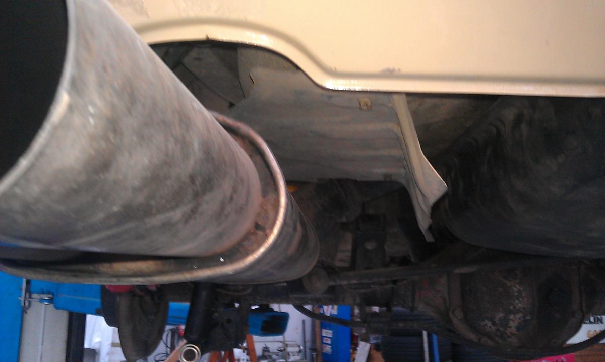

Made an adapted exhaust bracked to go from the old 86 bracket to my factory bracket. Doesn't look that flash but is solid and isn't moving at all. once the cars up and running i'll probably re-fabricate the entire exhaust system.
Put the fuel filler neck cover and exhaust heat shield back on to protect the fuel tank from getting too hot.

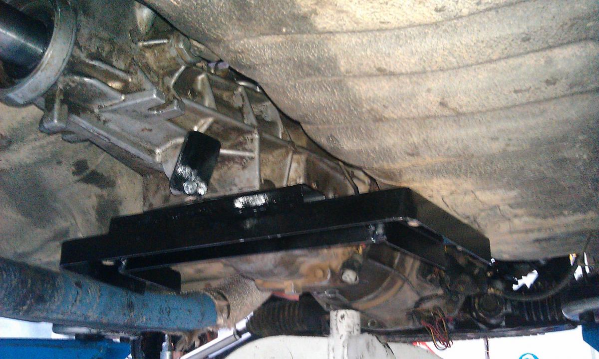

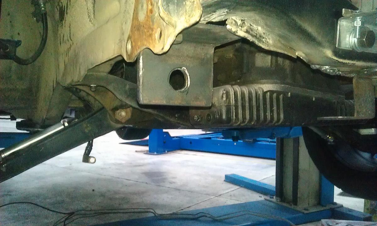

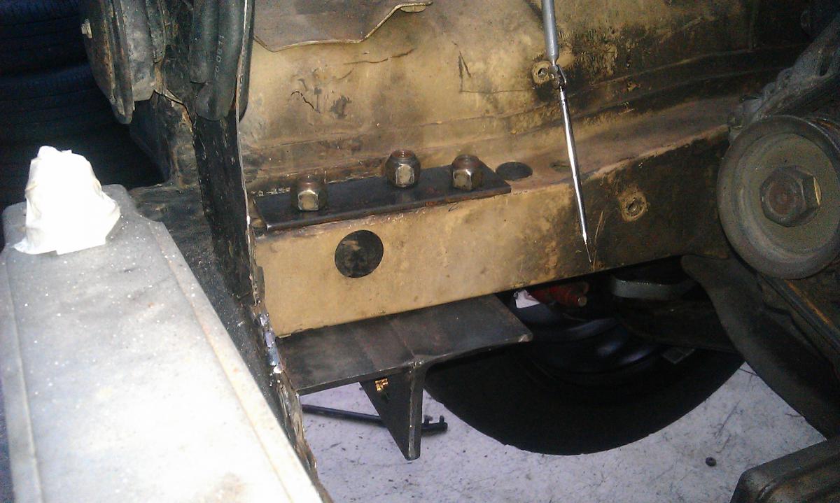

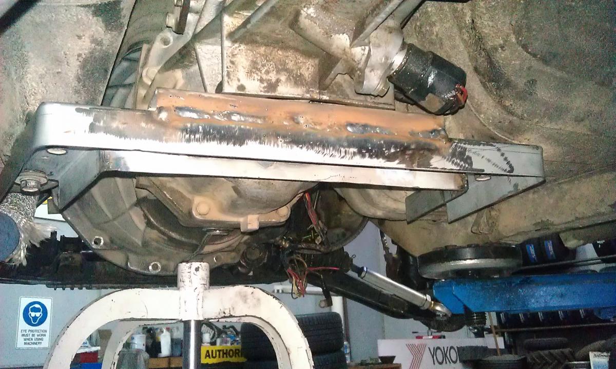

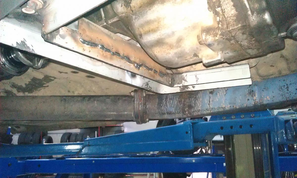

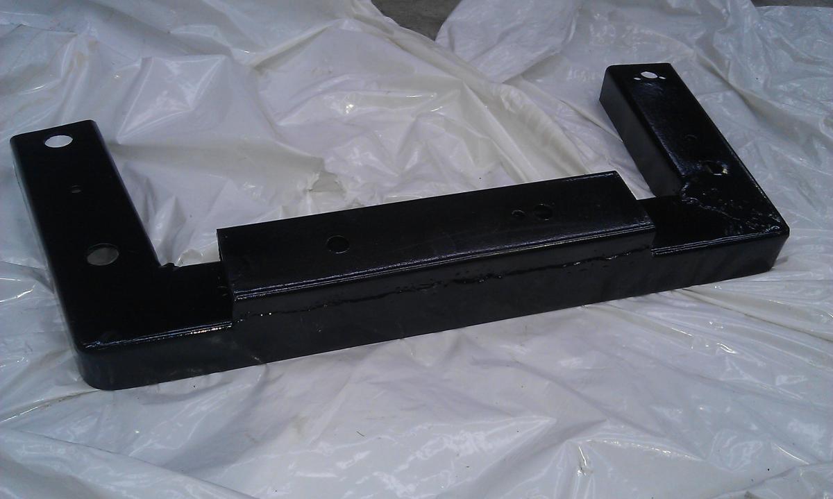

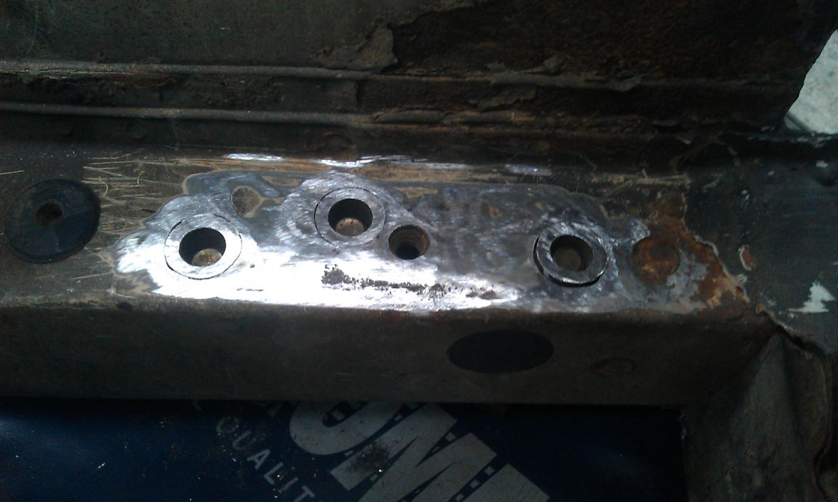

Most importantly I got my transmission mount 99% done, I took so long becuse I had to get it exctly right becuse any tension when bolting it up would cause it to snap as it's solid mounted. The welds are really strong despiter it not looking to flash in the pics. the brown is a coating the metal had on it oxidizing as i only removed it where It was to be welded..
I drilled 2 holes in the lower part so I can put a socket through to the nuts.
Tomorrow will be final welds and it's done

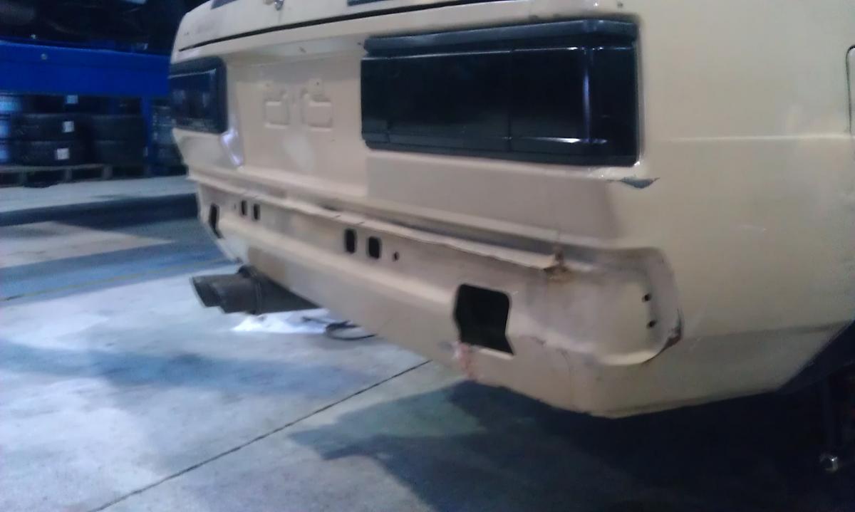

To the displeasure of some, I cut back my driftpipes, In my car it actually sat out more than the allowed 100mm. I think I might have cut just about 20mm too much though :/ They're angled to match the bottom of the bodywork but I haven't finished grinding yet

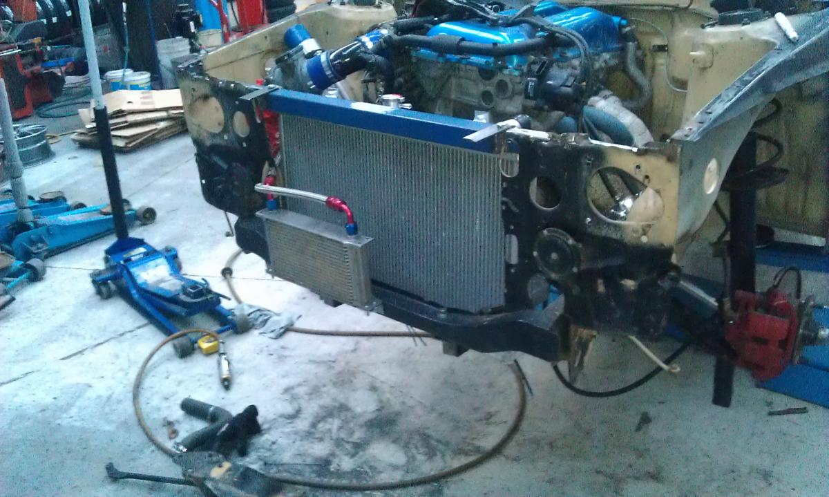

How it should look except with my new radiator.

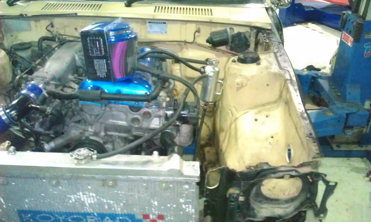

Using a catch can as an overflow bottle

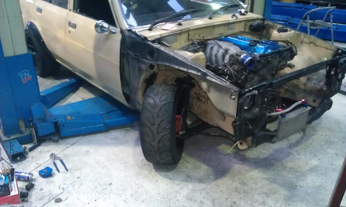

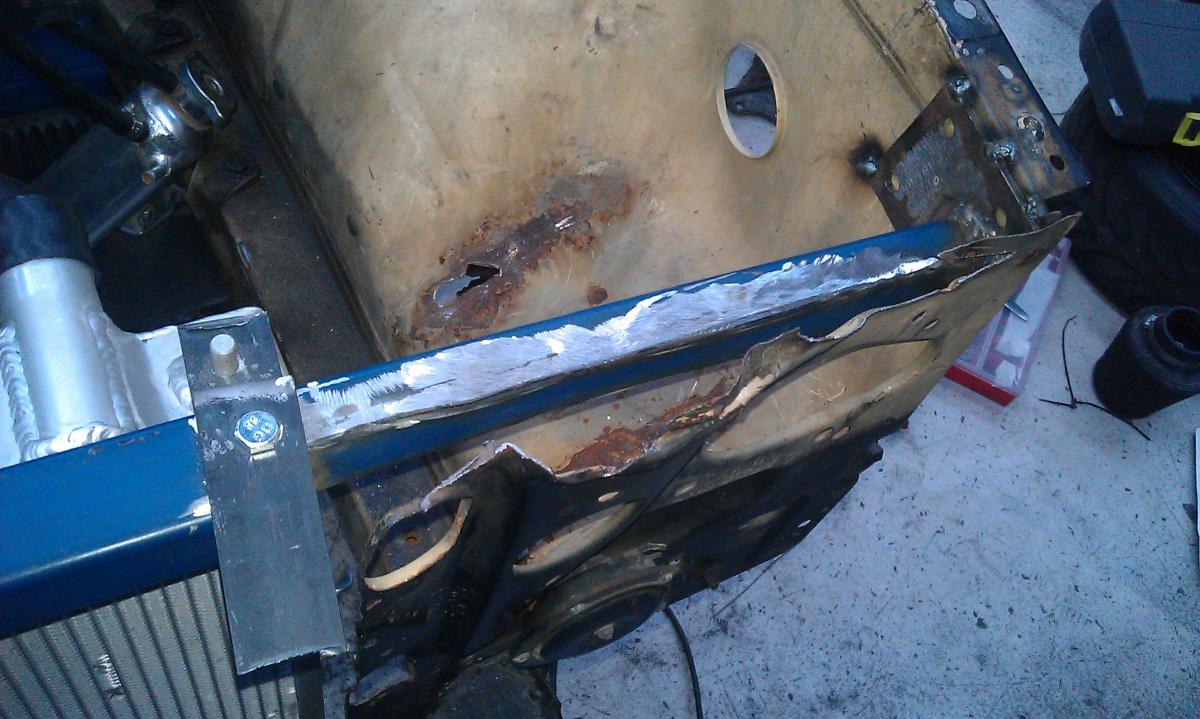

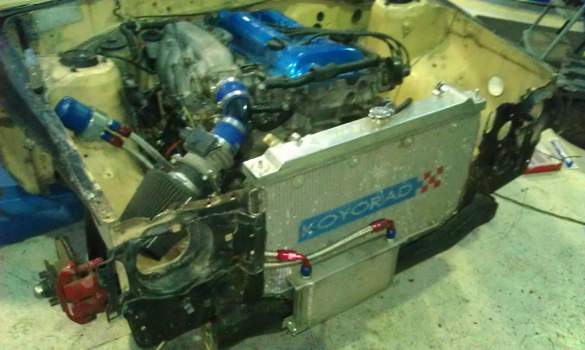

Dropped the caster rod mounts so I could see how my radiator would work
Will just cut the tabs that stick out
I cut my tubing to size for the rad support, radiator will be approx 20mm higher than in the pic.

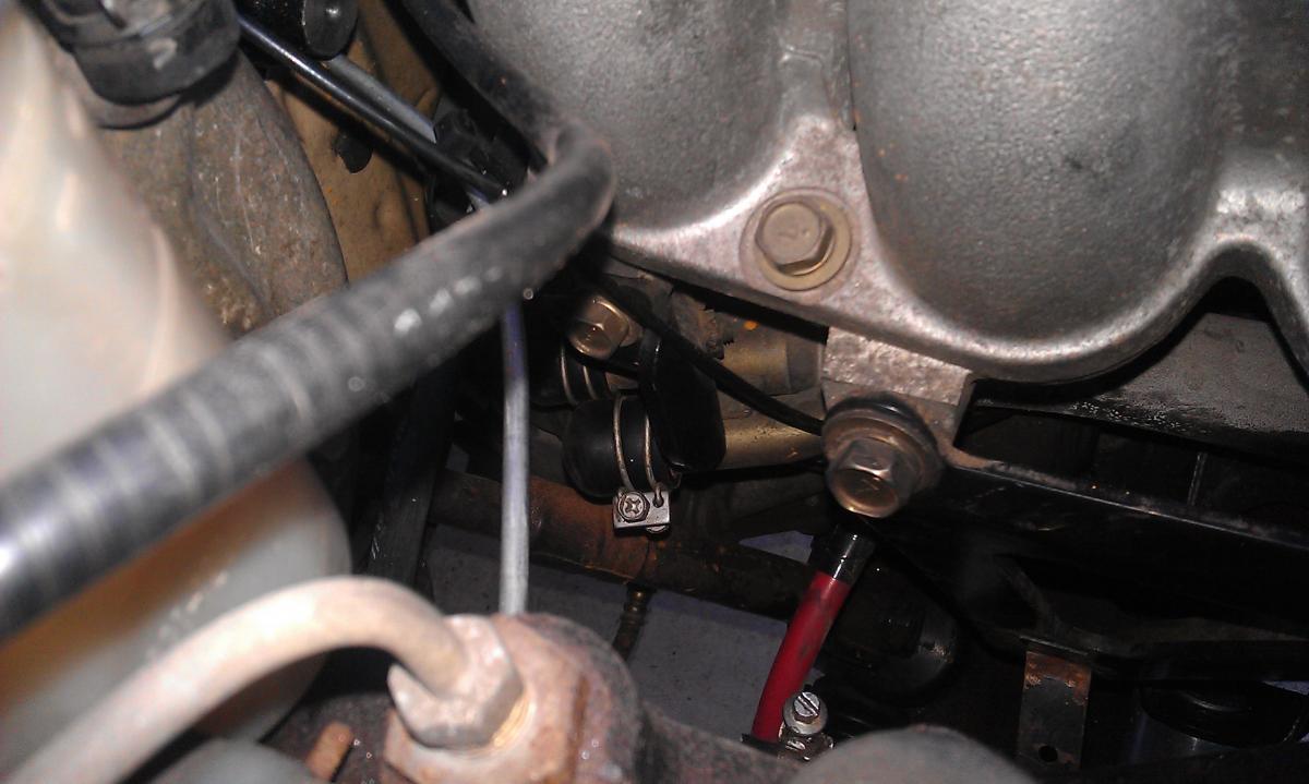

EDIT: I also used pinch weld around the oil cooler lines, thanks to B.L.Z.BUB FOR THAT

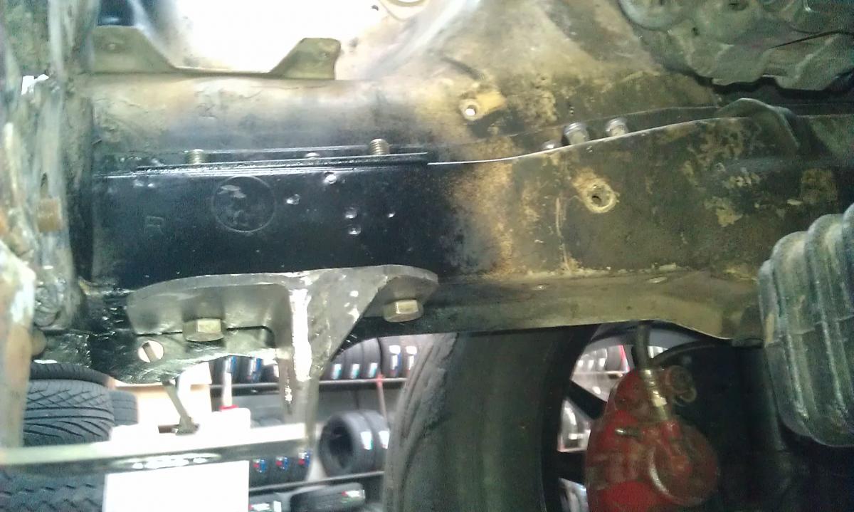

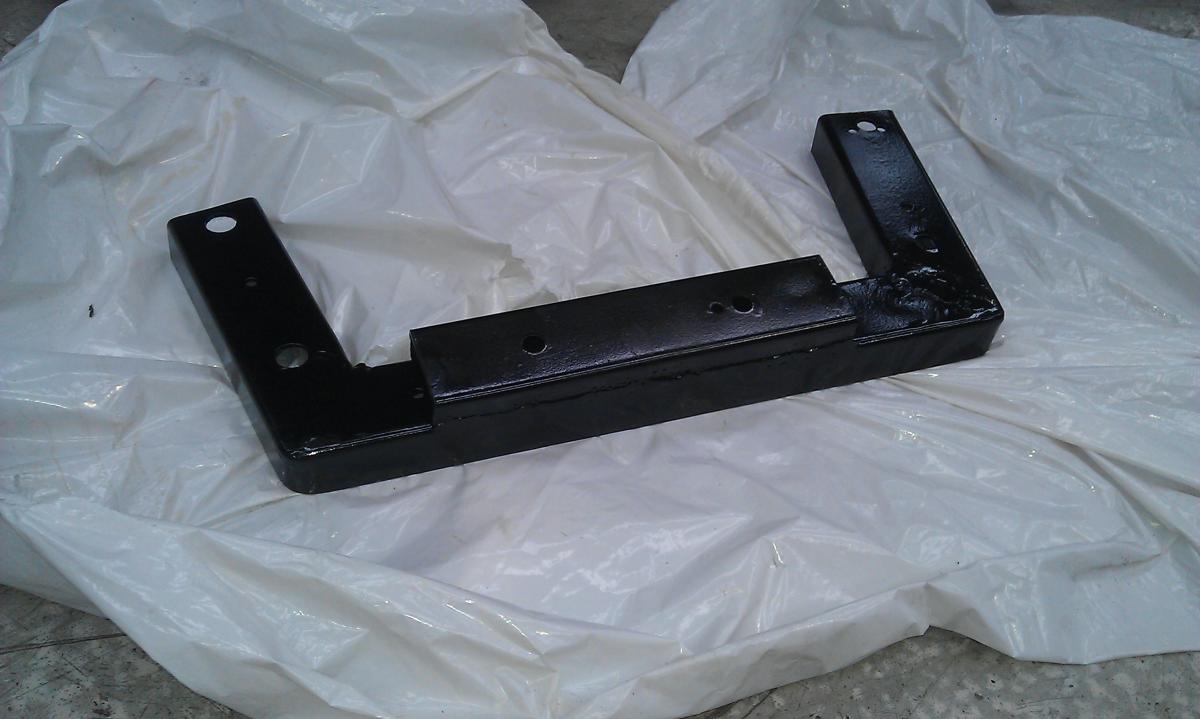

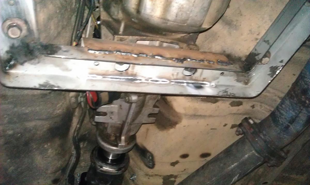

The transmission crossmember was finished and painted. I have to thank Trent who works at Traction for doing the welds. Although I can weld I don't trust myself yet with structural pieces.
All bolted up.

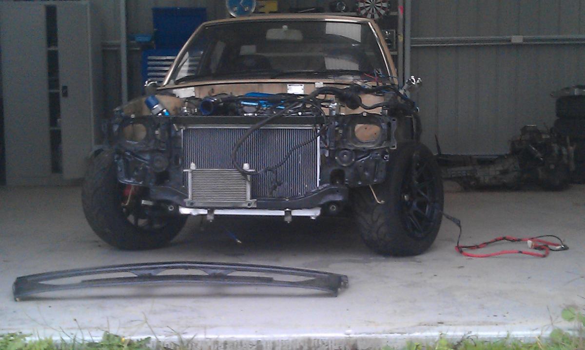

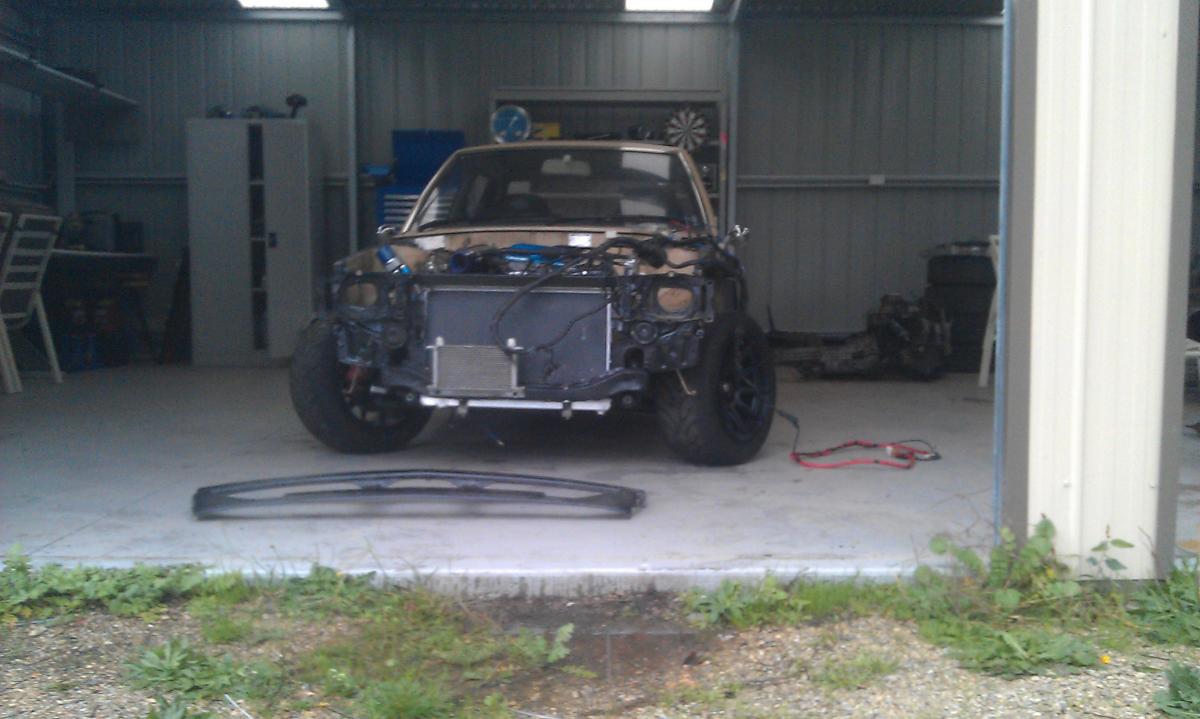

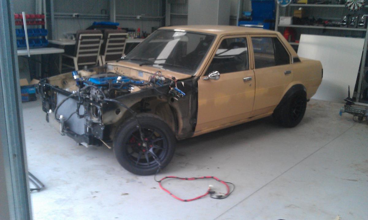

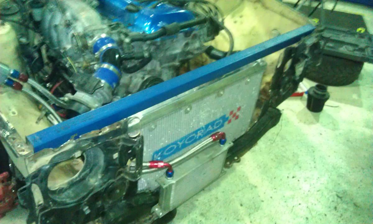

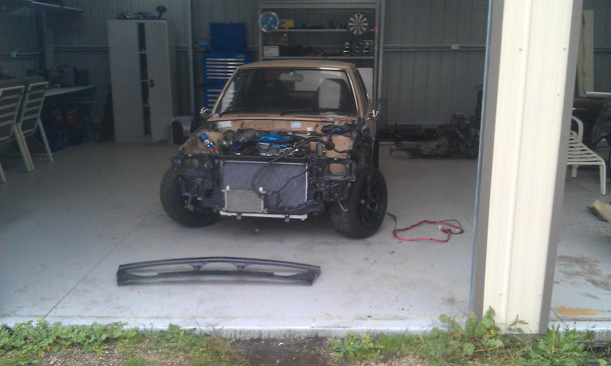

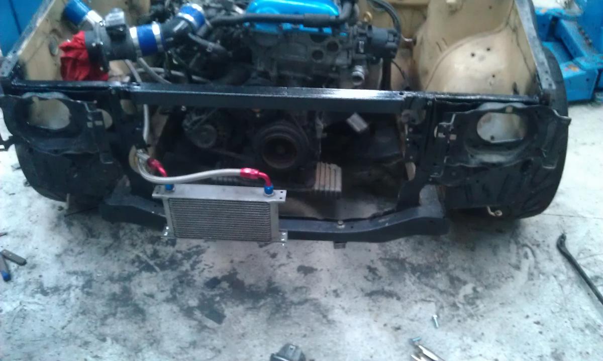

Time for an update, sorry it's been a while I've been lazy with the updating.

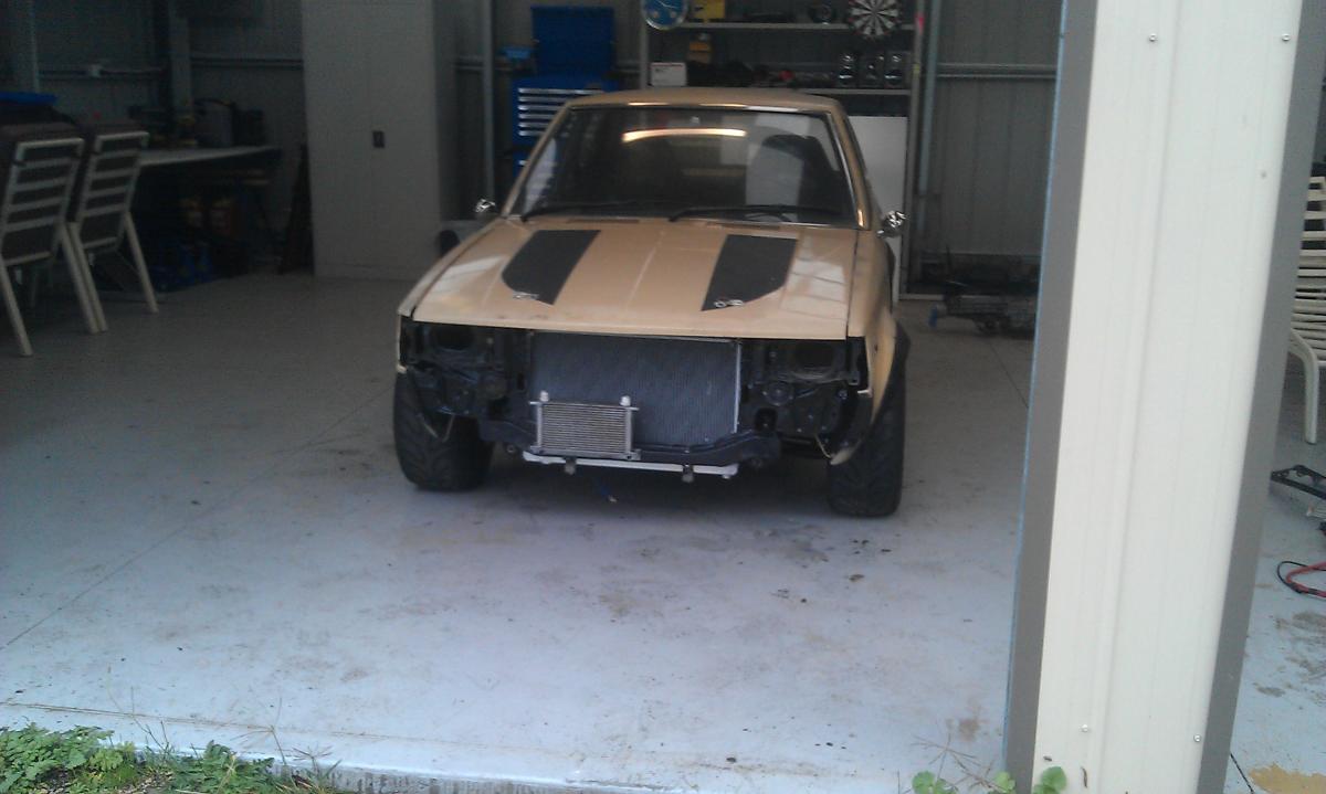

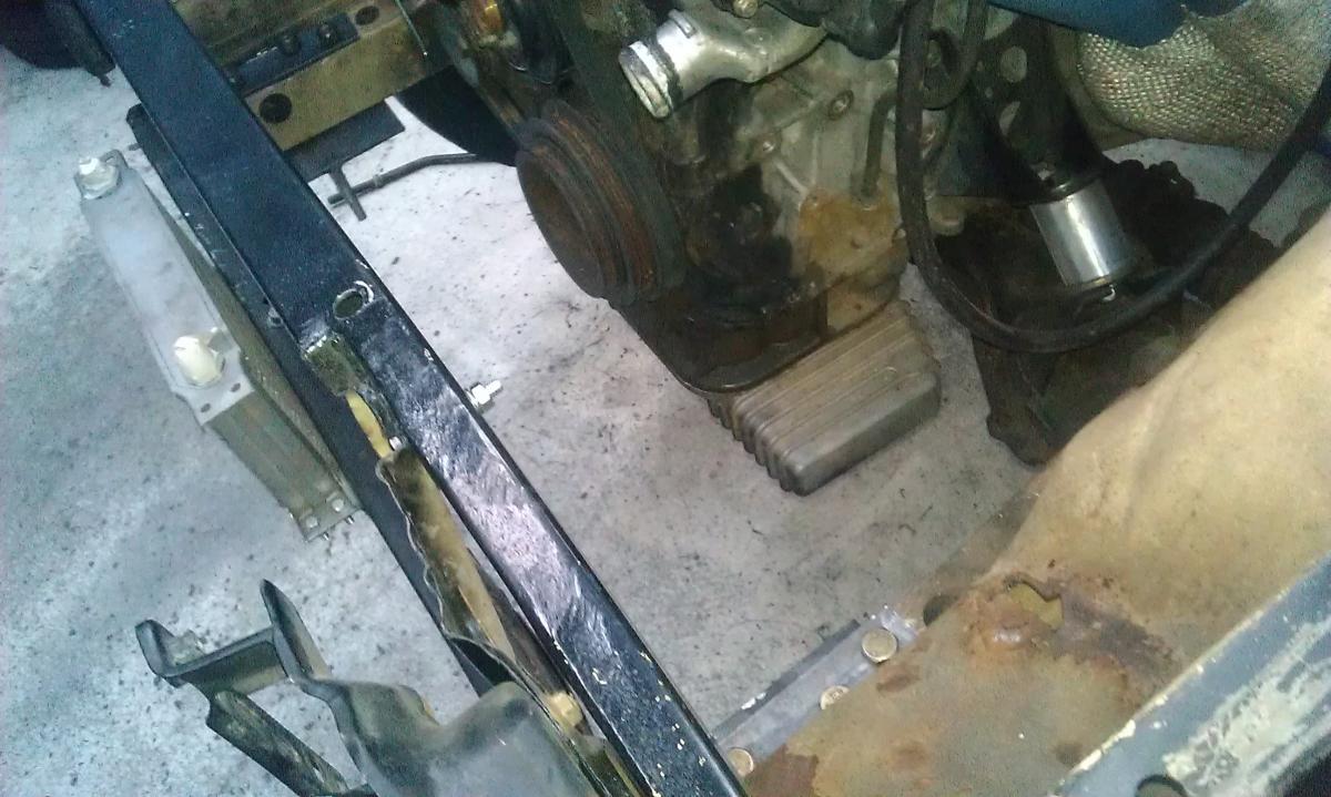

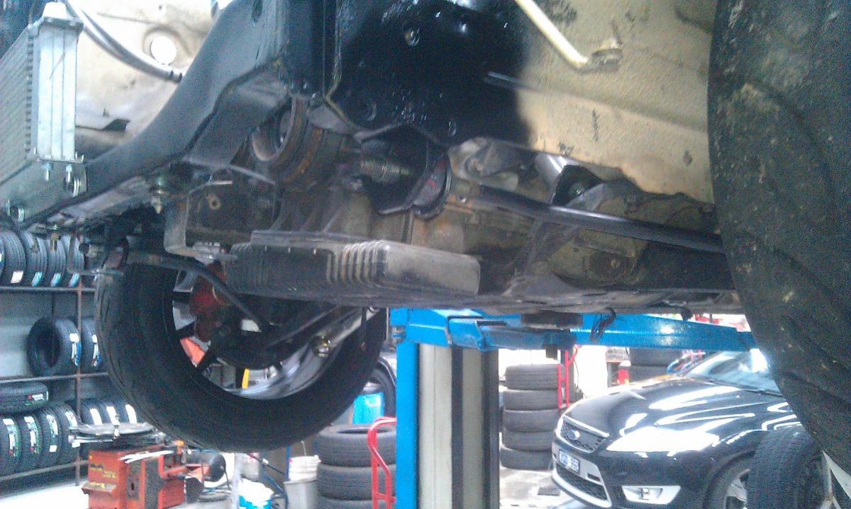

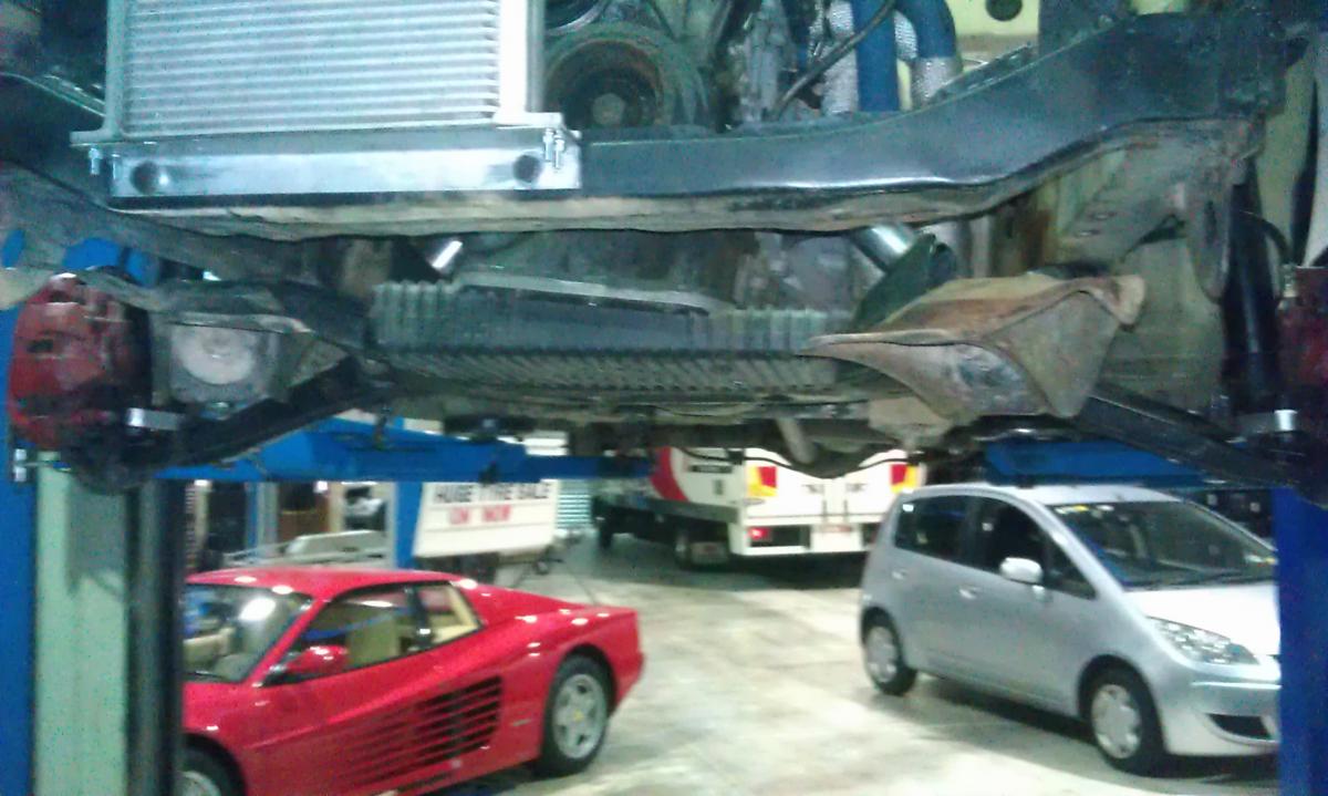

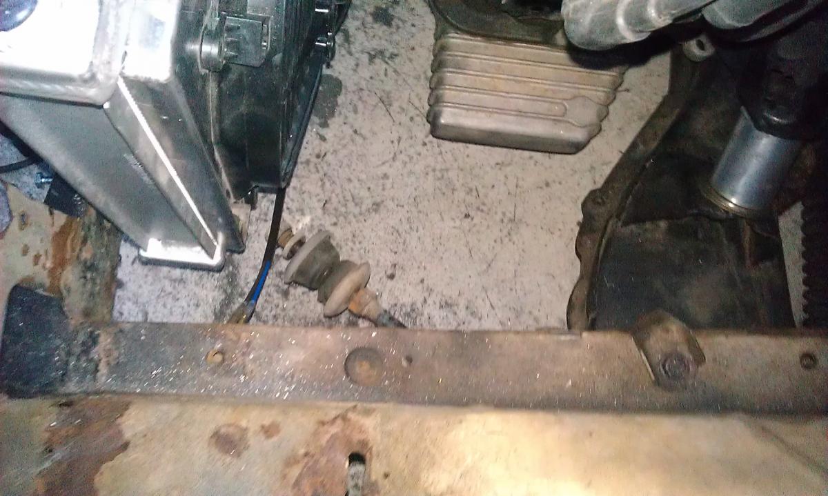

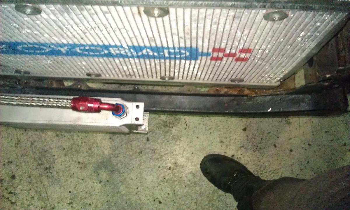

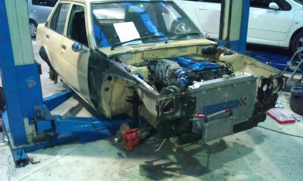

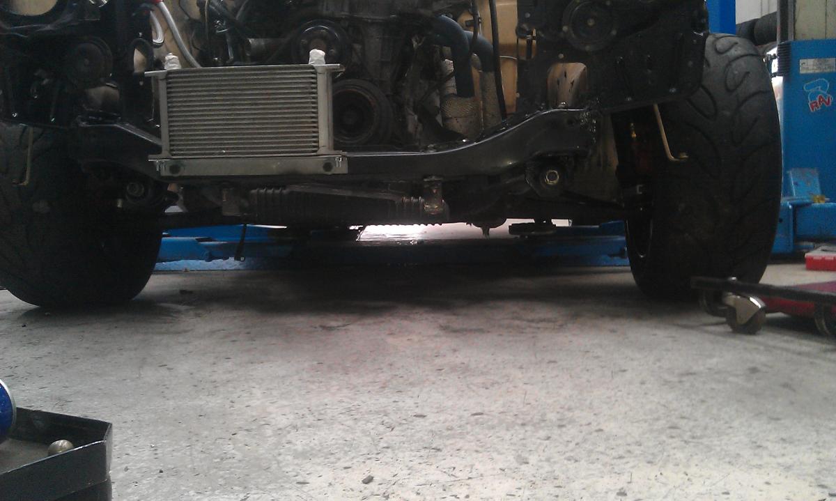

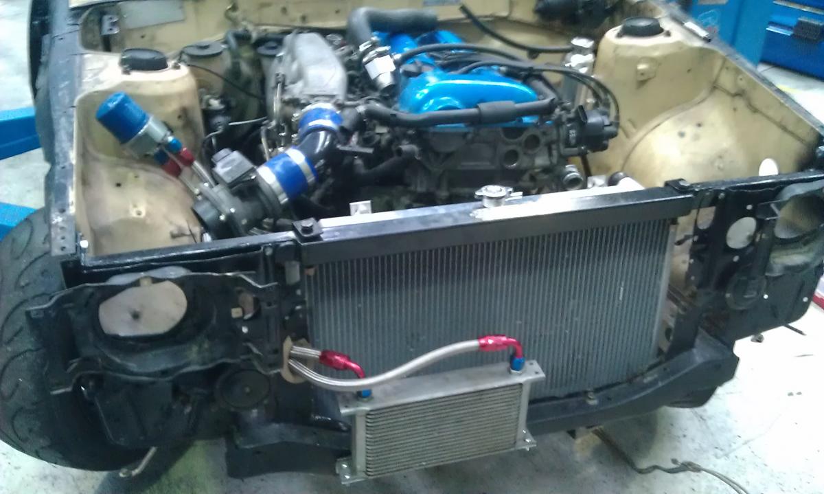

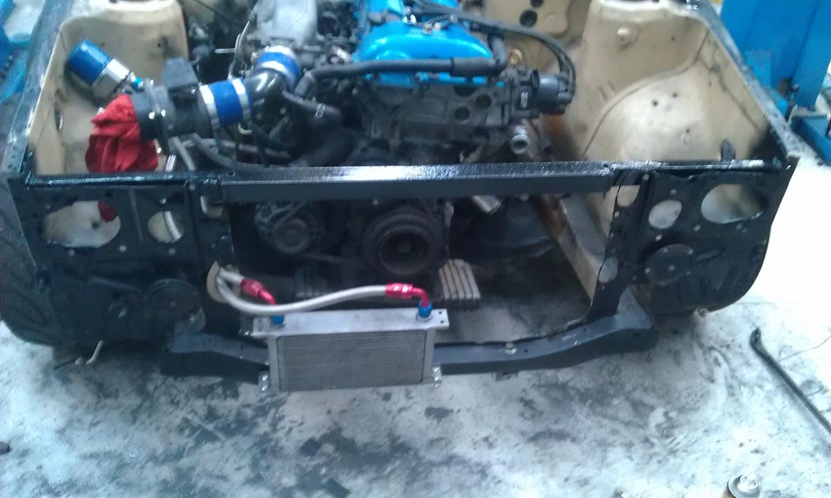

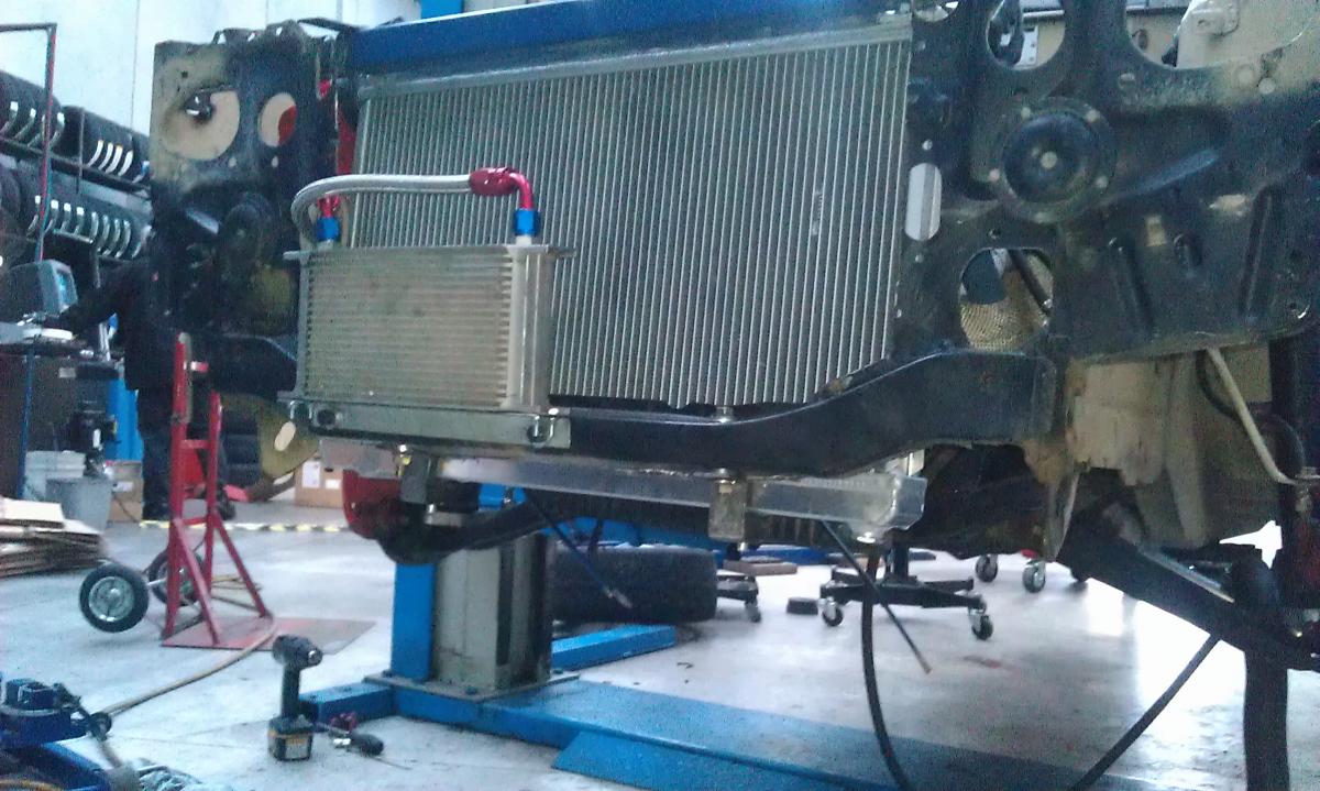

So on thursday I came into work. This is how far trent got mounting the radiator.

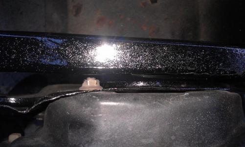

Tack welded to frame.

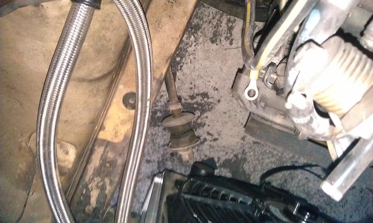

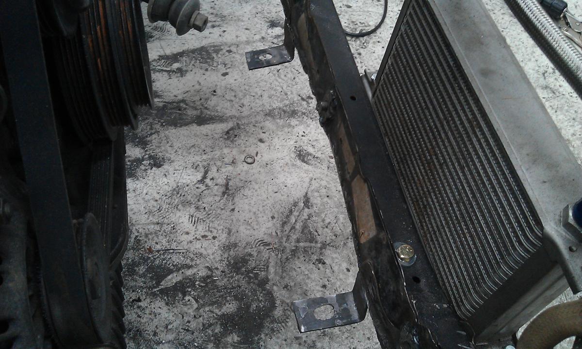

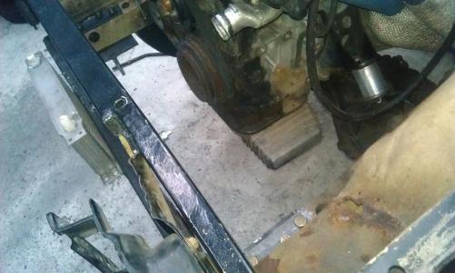

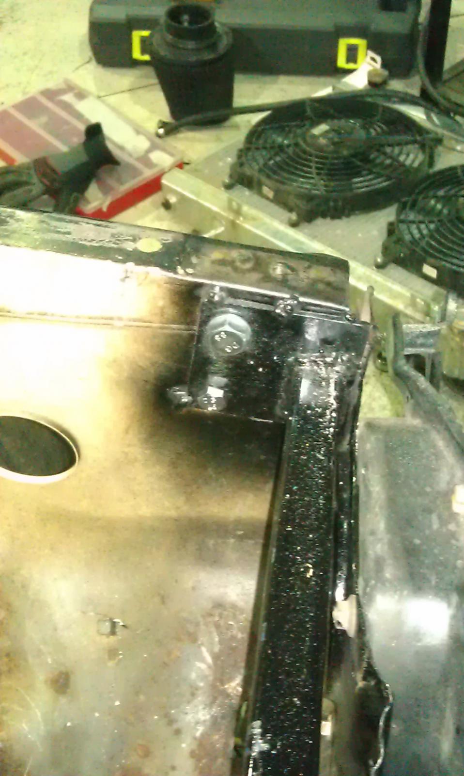

Needed a bit of work. I cut the protruding oil cooler mount bolts as they were to close to the front of the radiator, grinded the welds on the lower support as it fouled on the bottom of the radiator and as he'd only used the bottom factory bushings and had it metal to metal fixed at the top I went rumaging upstairs to find something suitable and ended up using link pin bushes that I then sanded down on the belt sander.

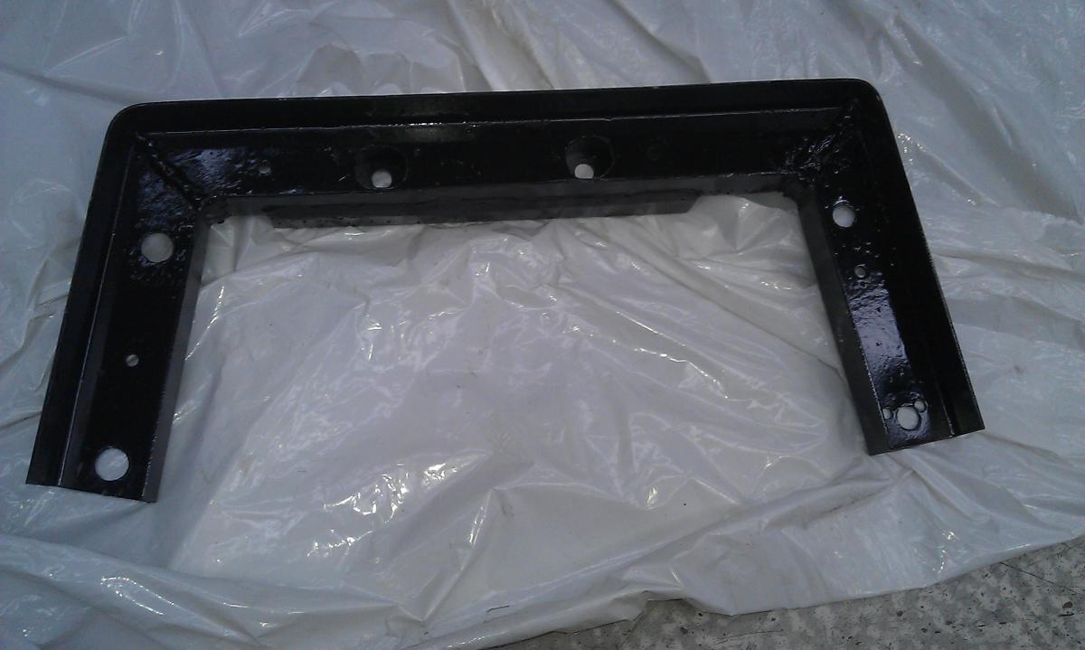

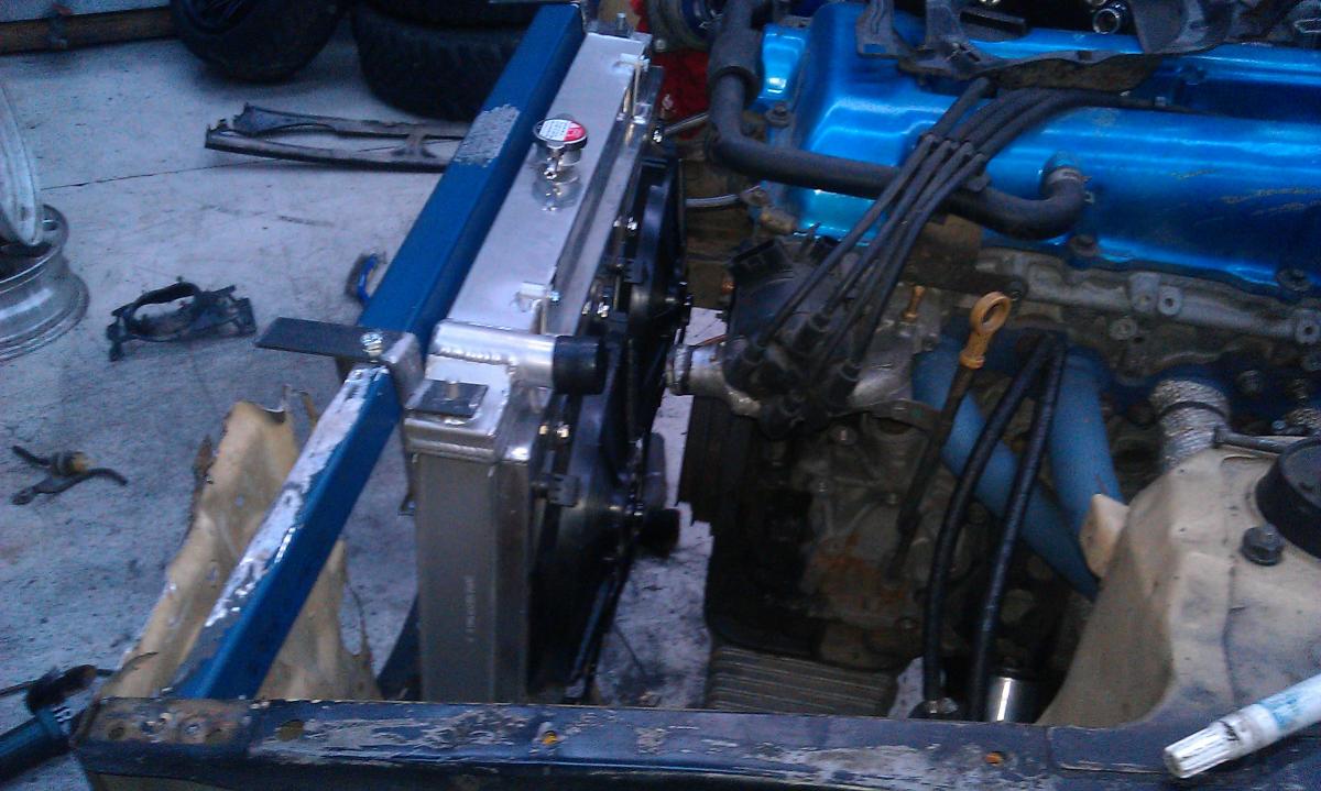

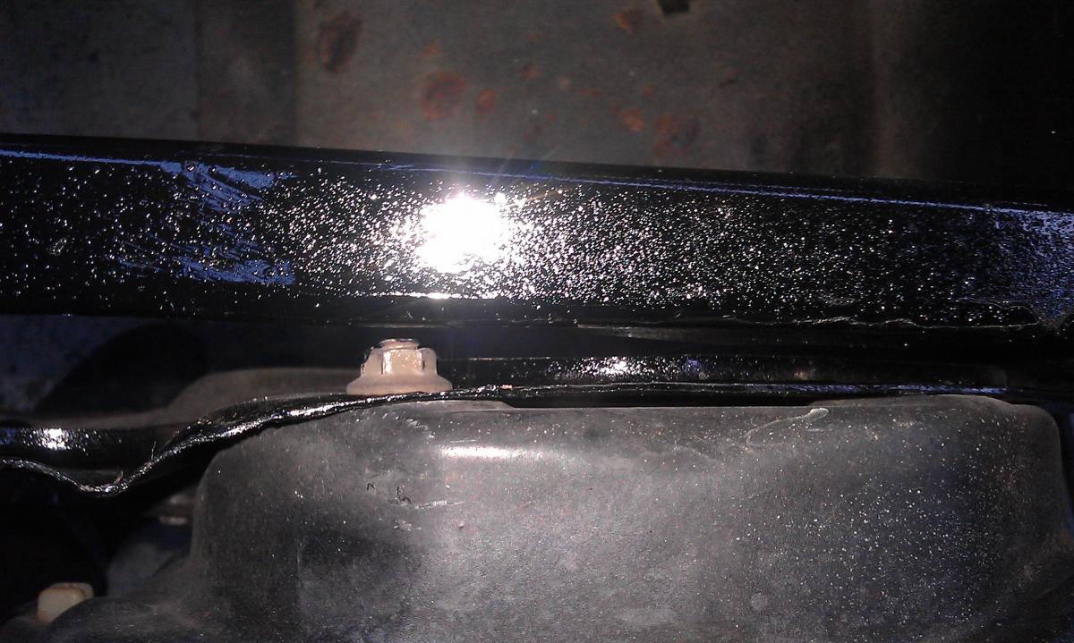

Cut the front down to the height of the support and sprayed it black just to stop it rusting
Then Re-installed my headlight brackets, cutting the top bolt down so it fit.

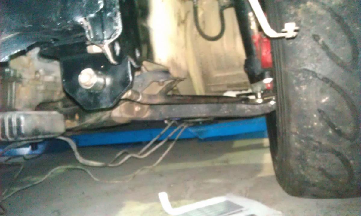

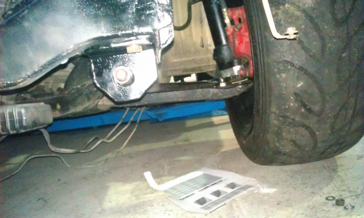

Put my castor rods in to see how the cleared everything, and had a talk to grant about mounting ideas.
Drilled and bolted the crossmember to body, so if I have to remove it All I have to do it grind off tacks and unbolt it.

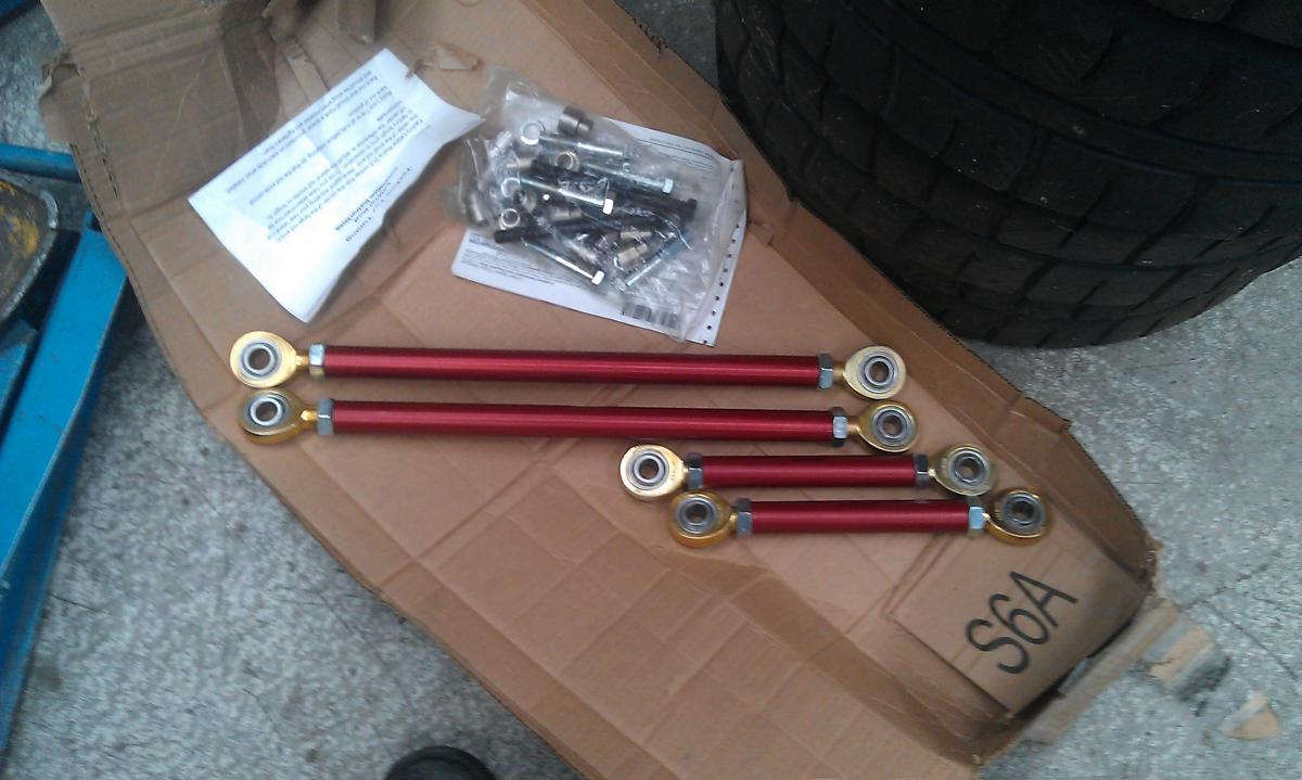

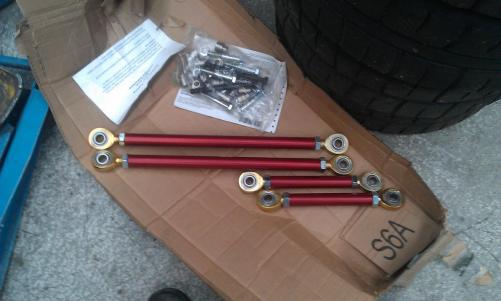

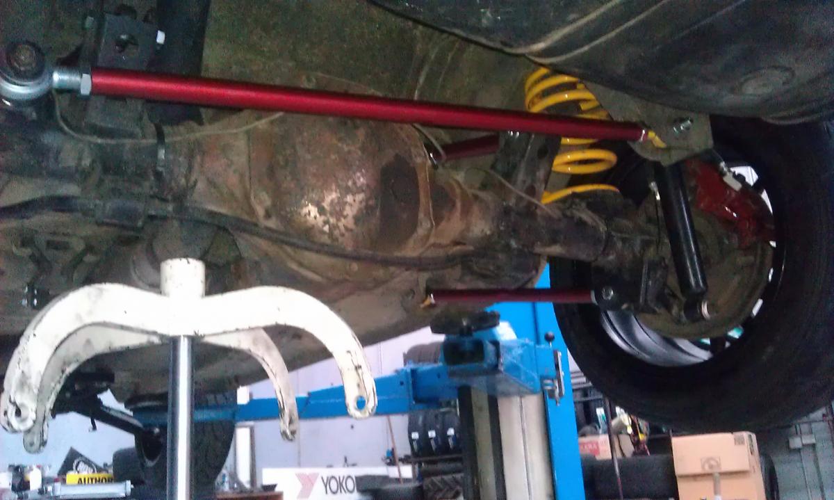

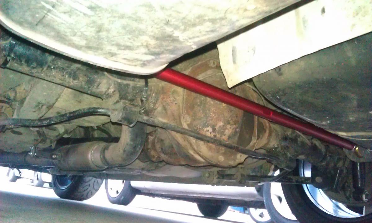

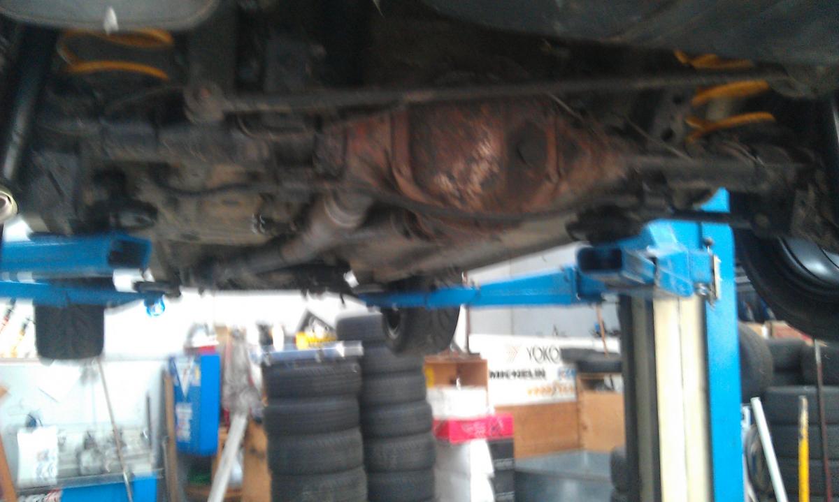

I worked the first half of friday, But my adjustable 4-link and panhard rod arrived! Yay
I installed the panhard rod then rolled the car outside.

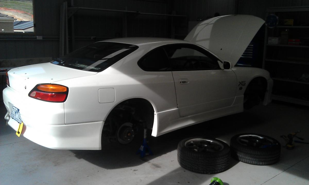

Well not really relevant to my build thread but on sunday I installed a set of HSD coilovers into a mates Autech S15, So an N/A sr20de like mine. Also fixed his side skirts which had been fitted badly and rolled his rear guards.
Factory lip
Folded completely flat with not a single bit of paint cracking, I was pretty stoked :D
Rockin with the coilys!
Dropped It about 1 and a 1/2 inches from factory and dialed in some camber too, Can't go any lower due to his driveway and how low his exhaust sits would make it illigal.
He's is getting some Phat 18's in about a months time :)

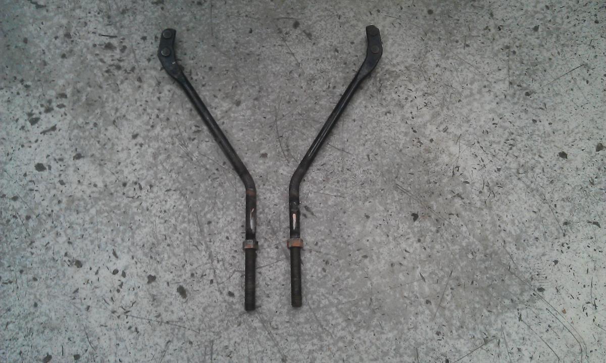

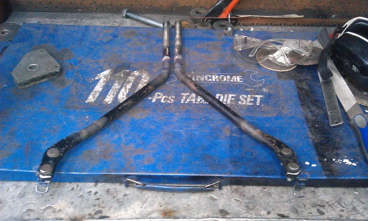

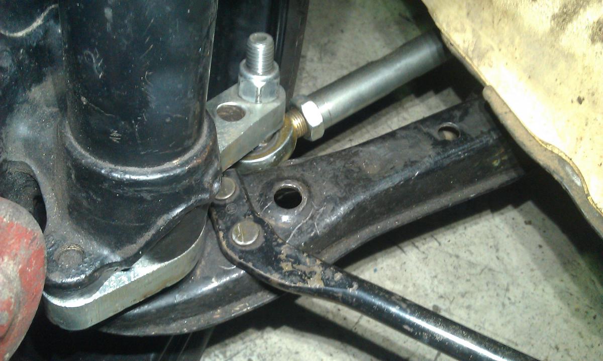

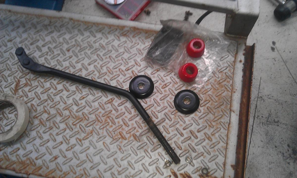

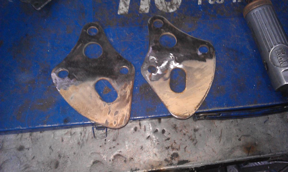

Today I started with modifying my castor rods. Took some measurments, then heated them up with an oxy and bent them. This design allows the rods to pivot properly through travel rather than squish the bush. It'll be a massive improvement over factory. With rose-joints this wouldn't be necessary, but I can't afford them at the moment. I will design the bracket to allow more caster.

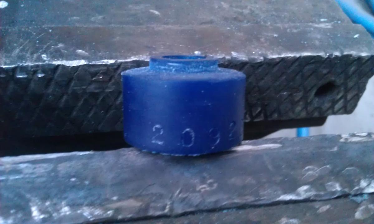

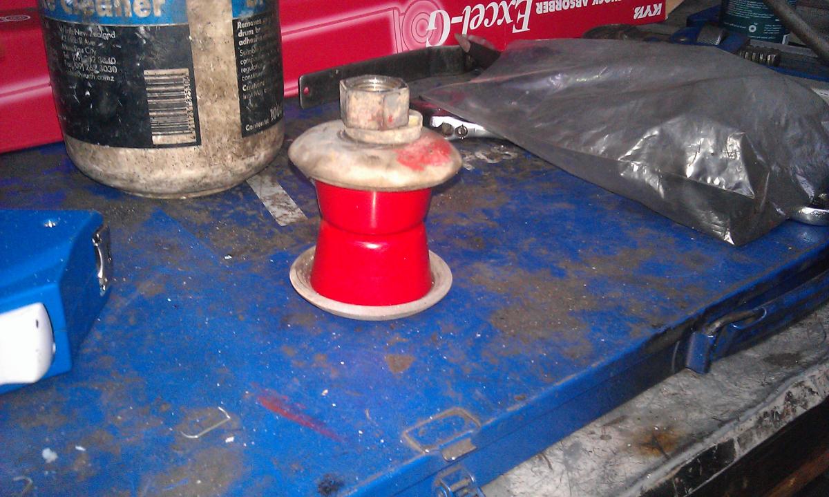

It was then time for another rummage upstairs for some polyurethane bushes, Found some that were the right size and shape but the internal diameter is about a mill too big so i'll use a lathe to turn down the original sleeve to fit in the new one, will work fine :)

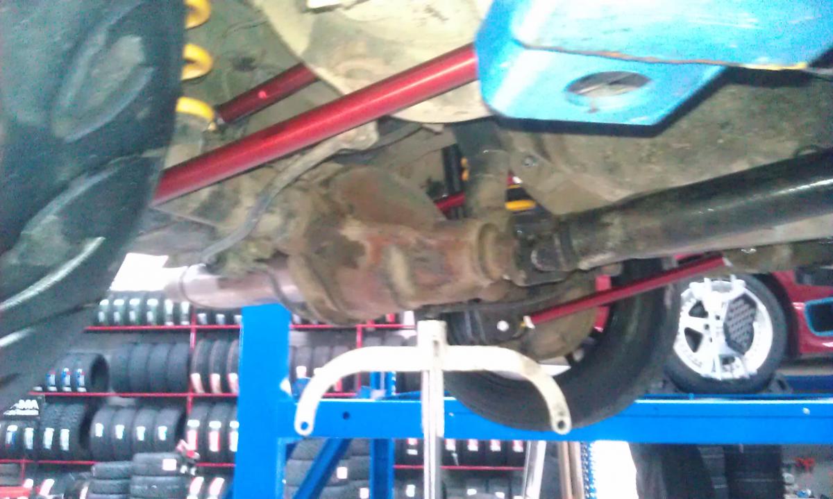

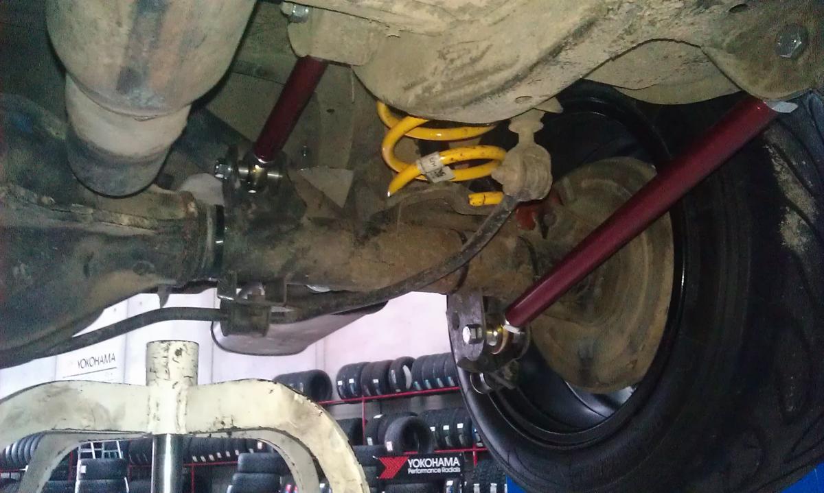

Here is my adjustable 4-link :D
All the TechnoToy tuning parts I've bought have been excellent quality and I'm very happy with them.

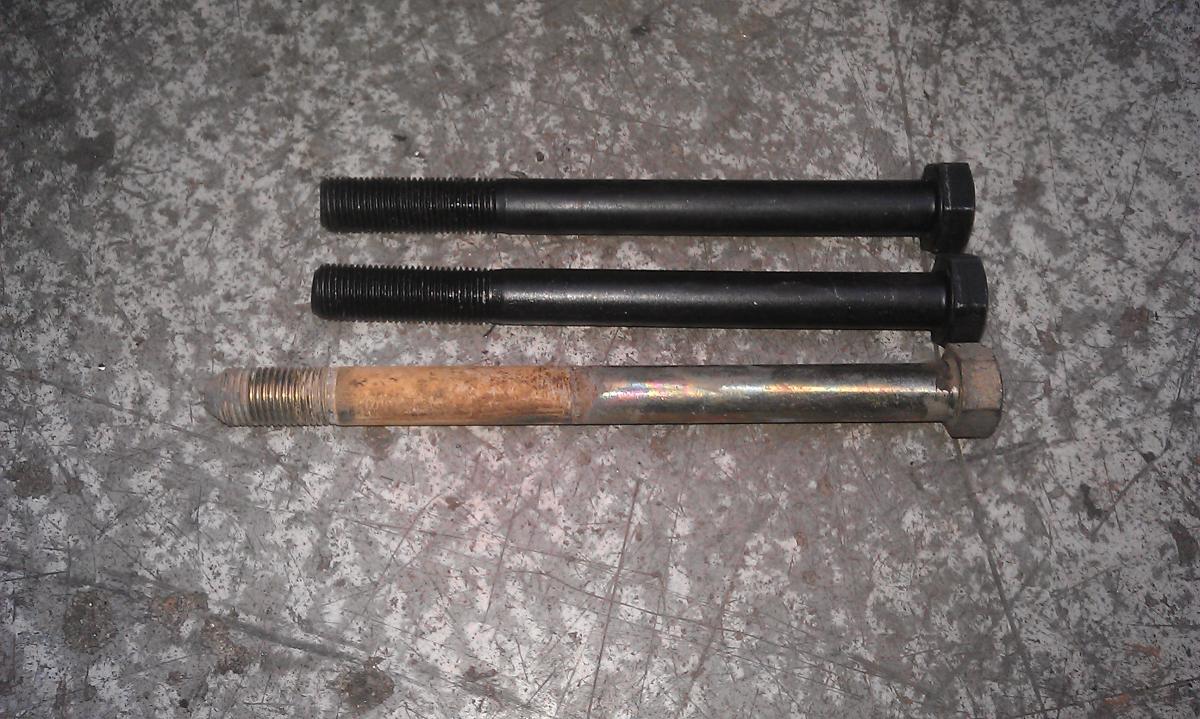

My only problem was 2 bolts that were the wrong length, I think they sent the wrong ones though.
All Installed and looking sexy!

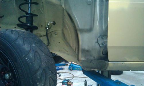

I don't Think I mentioned this before but the heater hoses had been looped but had kinked causing them to balloon so I pulled them off and ordered block off caps, which I'll install tomorrow.
I also just pulled off the ke70 strut tops off my standard struts to fit to the ae86 ones for more caster without destroying bushes so much. I will set it up with about 6-7 degrees castor which I think is about the max you'd want to run on these little corollas.

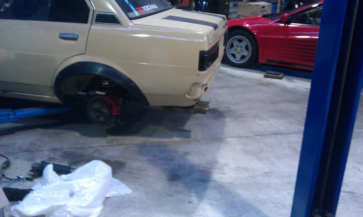

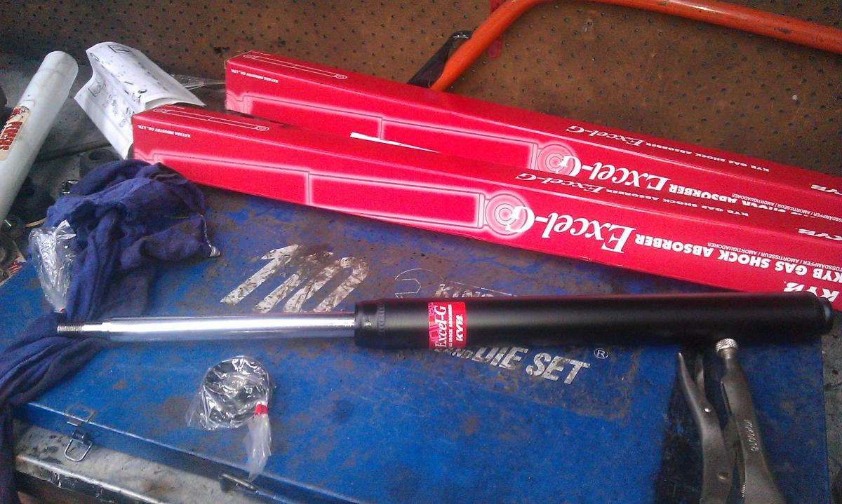

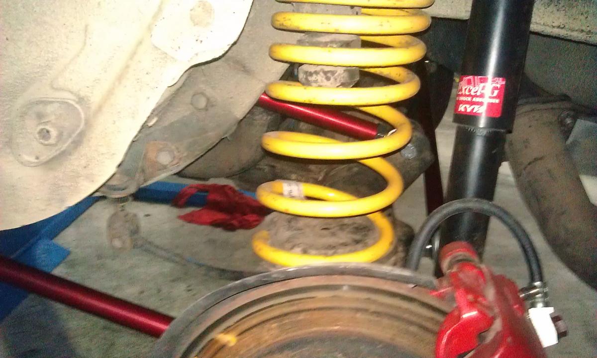

I got to work around 1 as there wasn't much I could do except my shocks which would be there till later, as it turns out they arrived 10 mins before I got there so that was good timing.

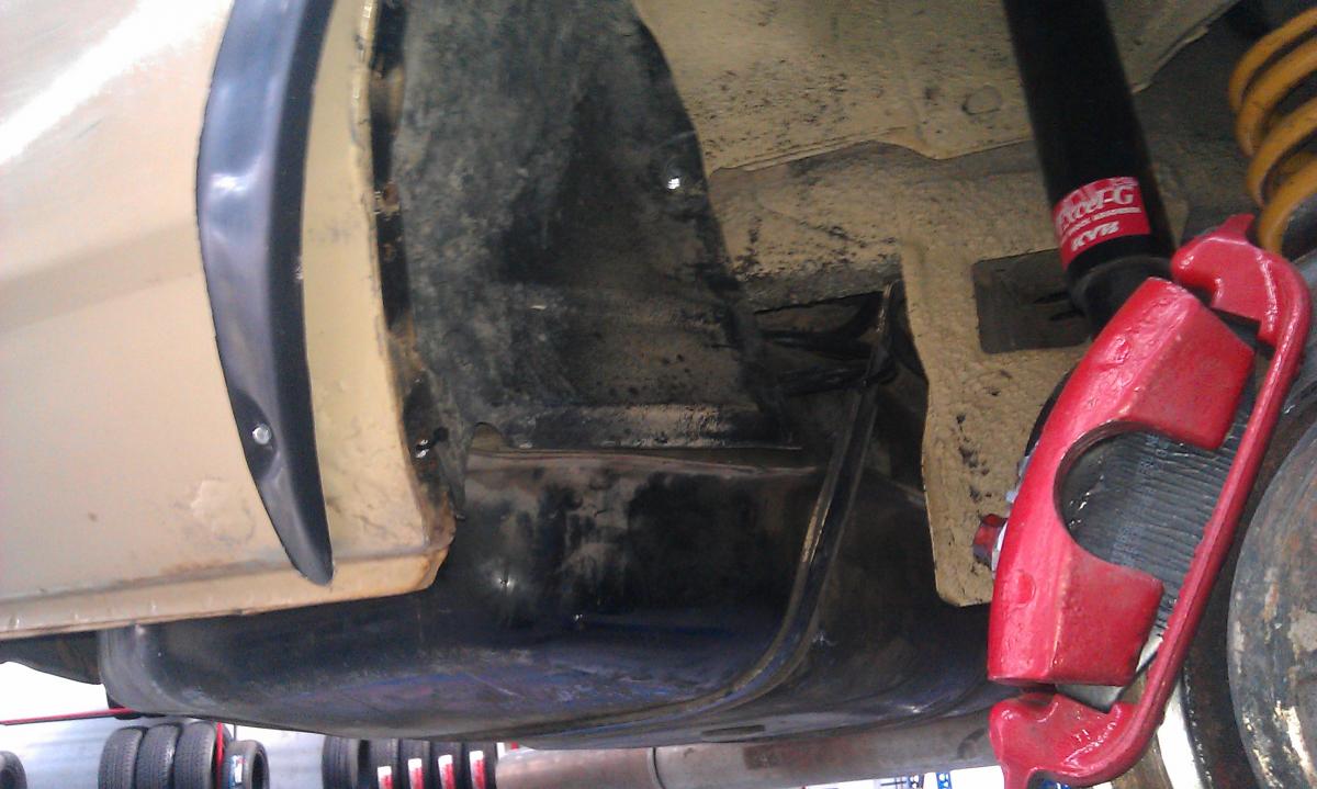

Now I have KYB's all round and the rears are only 2 motorkhana's old. In this pic stuts are back it and I'd cut off the tabs for the mudflaps on the body seam and painted the metal black.

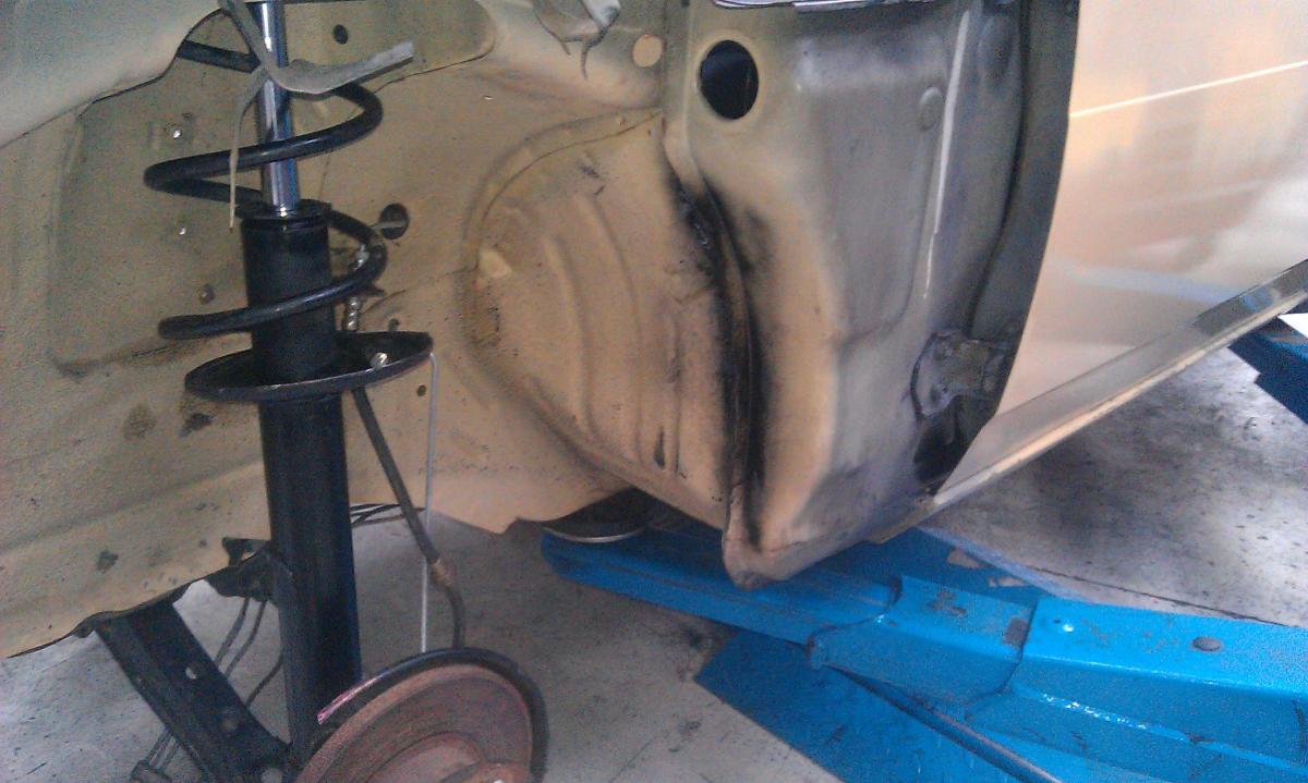

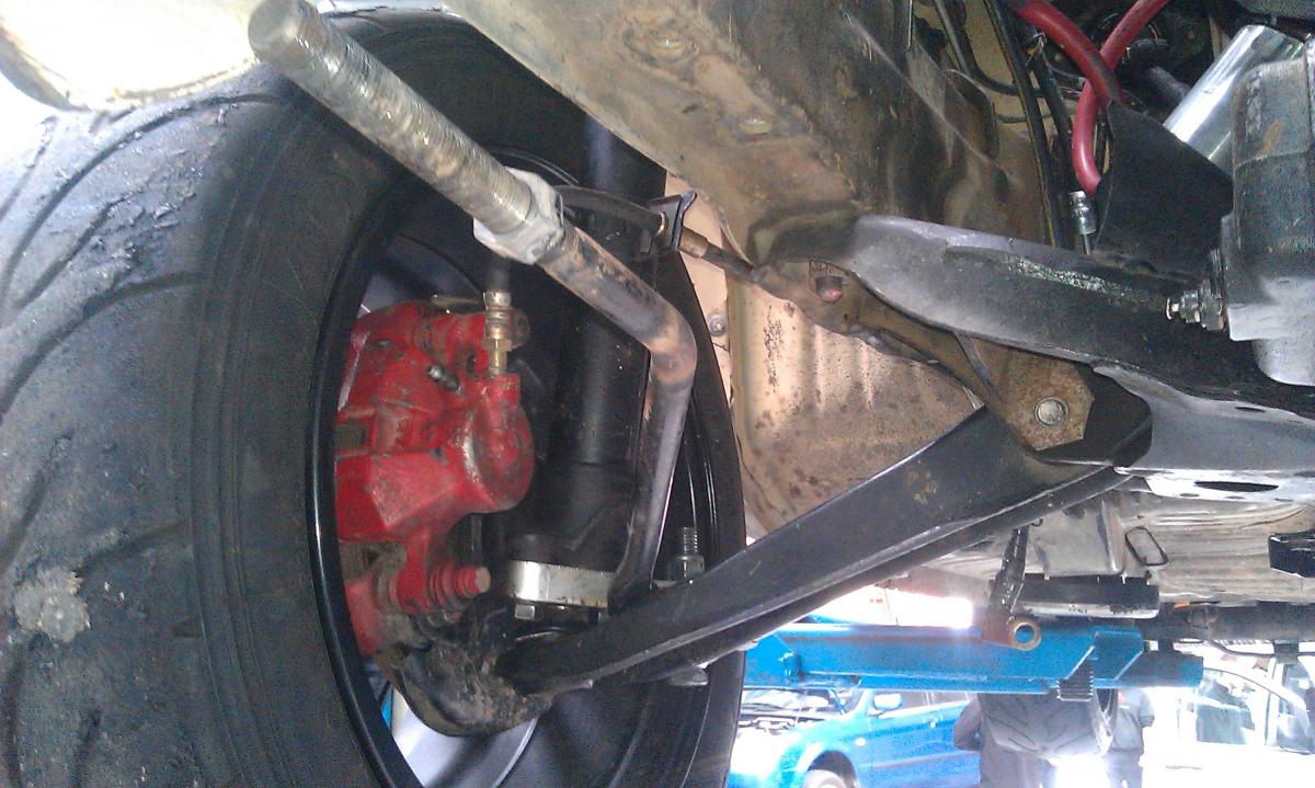

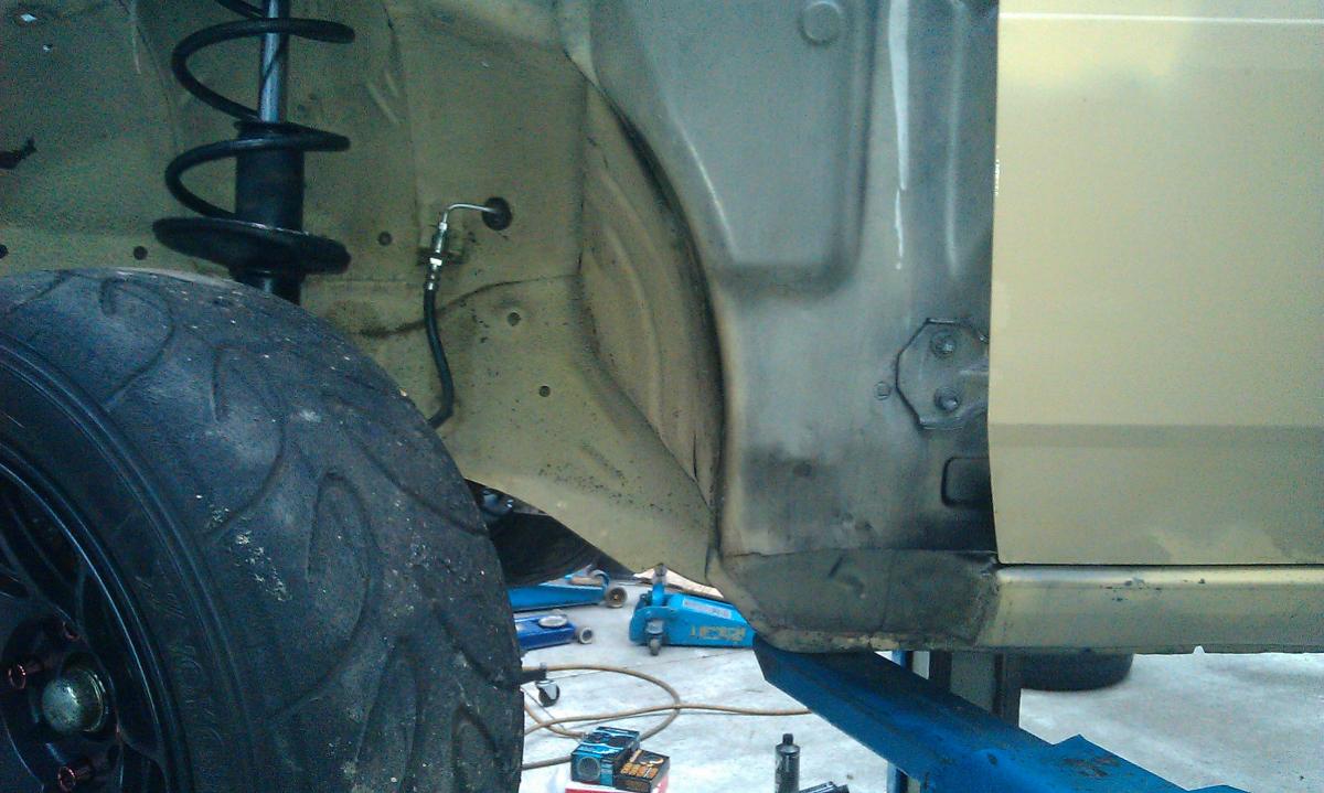

Then I got out the BFH and bashed the seam flush as I have cearance problems with it.

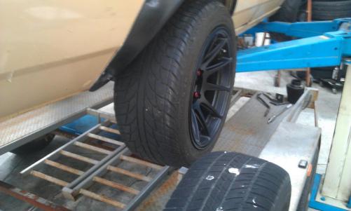

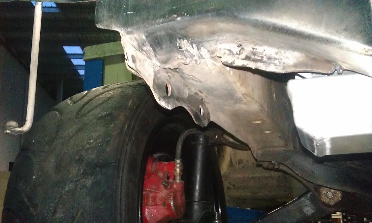

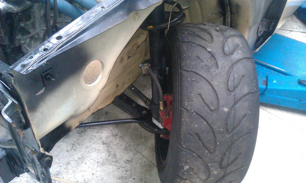

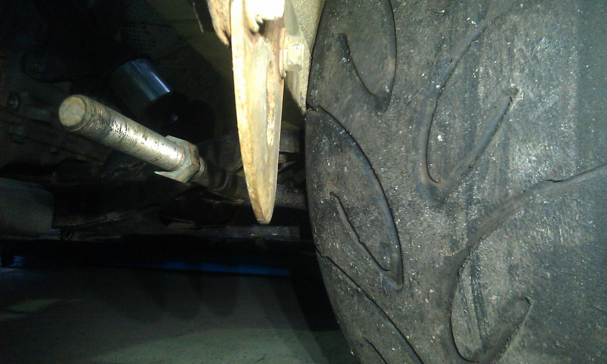

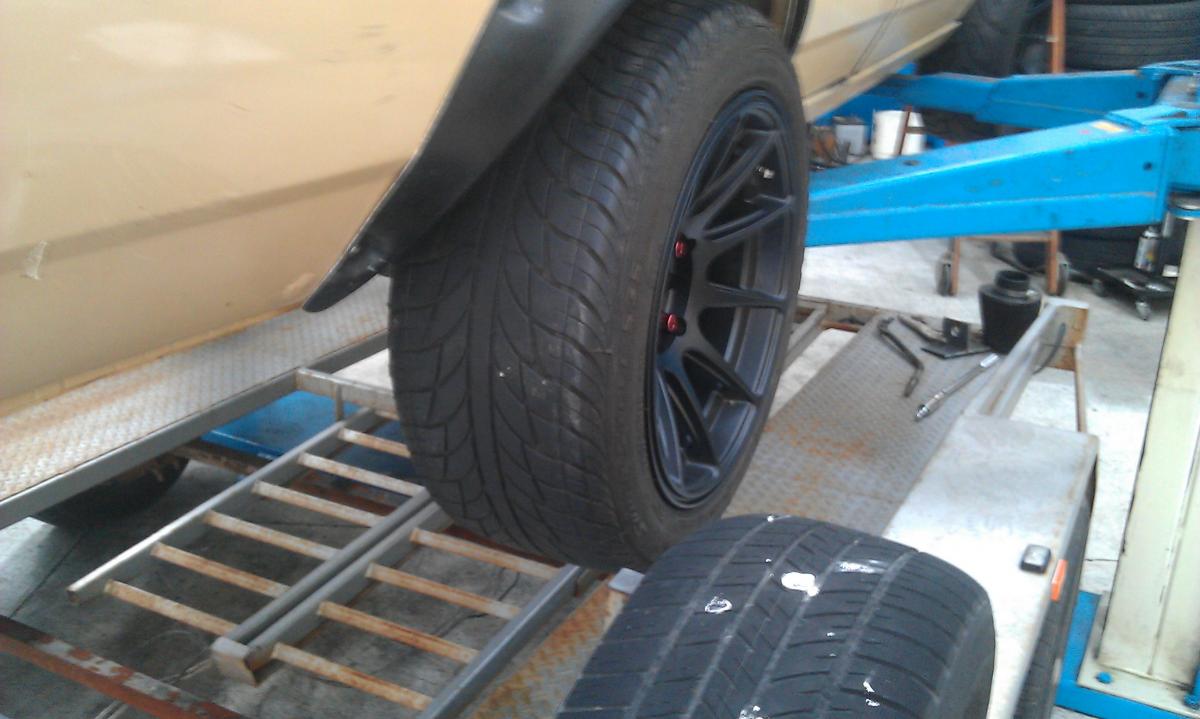

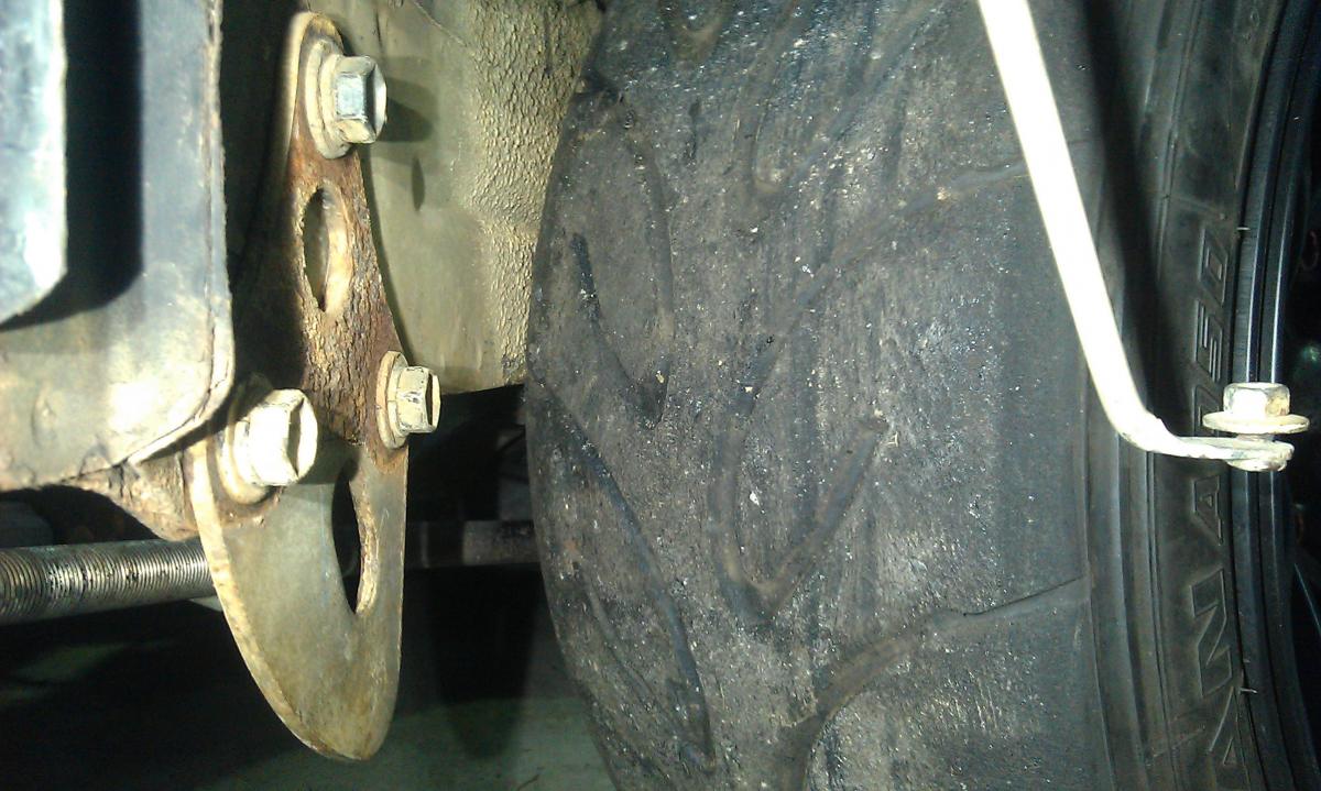

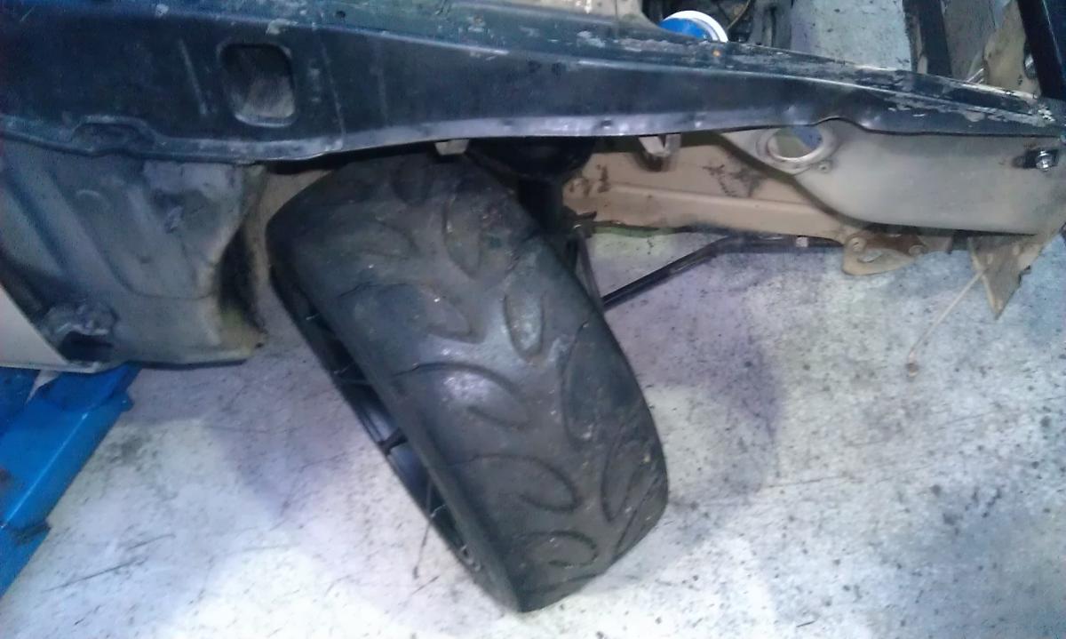

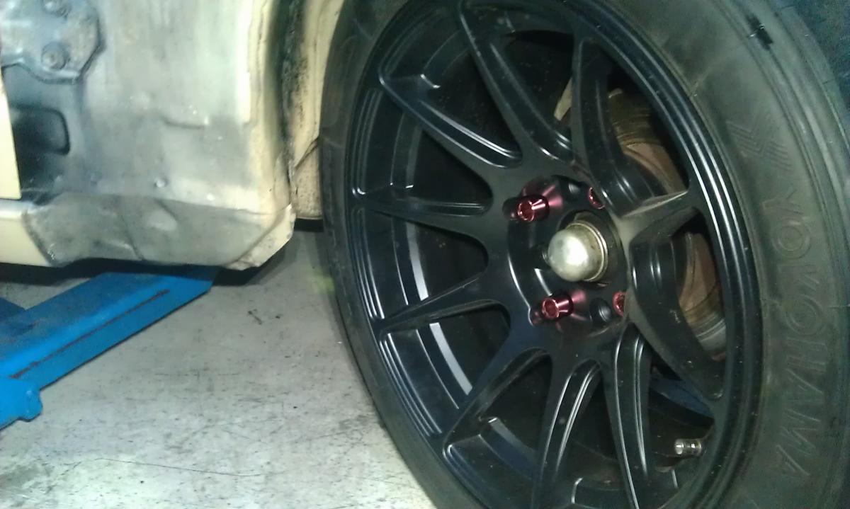

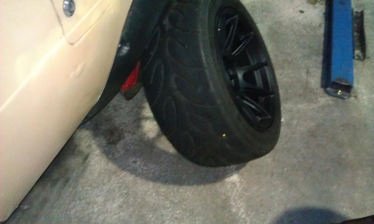

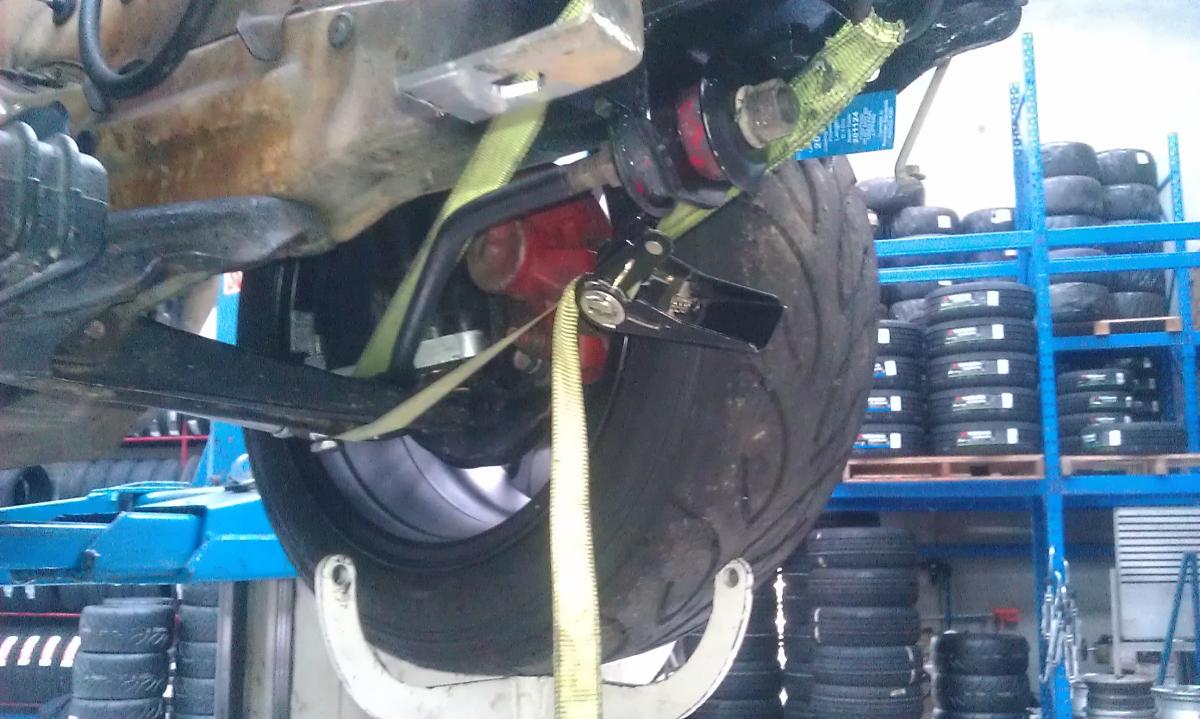

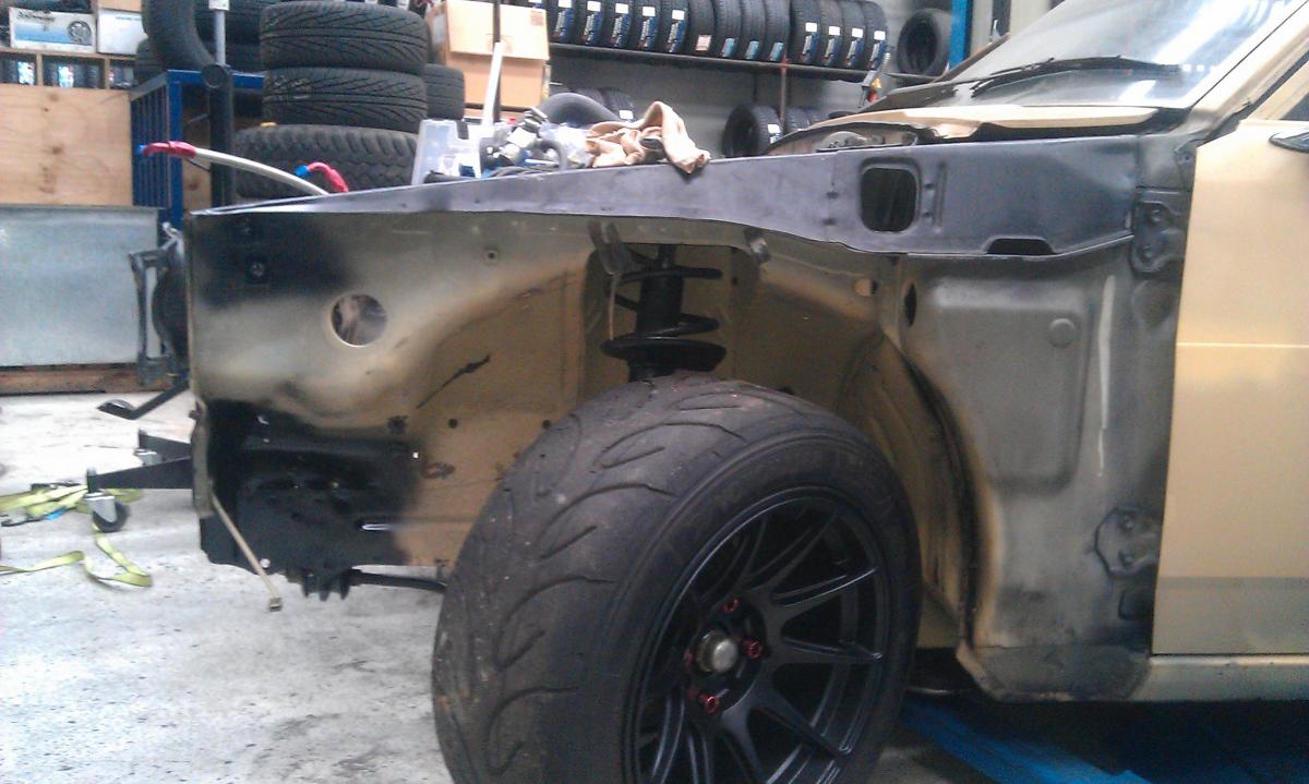

Then I proceeded to check out how much lock I now have and am pretty imprest, It's more than I'll need and I have things hitting left right and centre :P
The inner edge of the trailing wheel hits the arches so if I want any more lock I'd have to get longer lca's which I am getting as the next upgrade, I have now changed my mind again and decided to go with the battle version kit http://battleversion...lla-ae86-85-87/
From what I can find out they're great other than not having enough castor adjustment but as I'll have to make new mounts again this isn't an issue, anybody have any input on my choice or other ideas?
The leading wheel hit the back of the arch but that's just because I have no castor rod mounts so it pulls back as I turn,
I have just about a mm clearance with the tierod to lca as the inner tyre hits first but there's still more rack travel left, I'll have to check everything when I mount my castor rods. I might for now until my new lca's put in lock stops to stop the tyres rubbing on the inner guard.

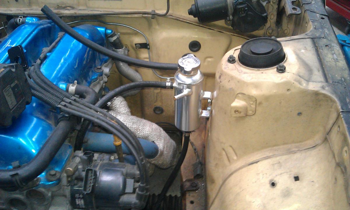

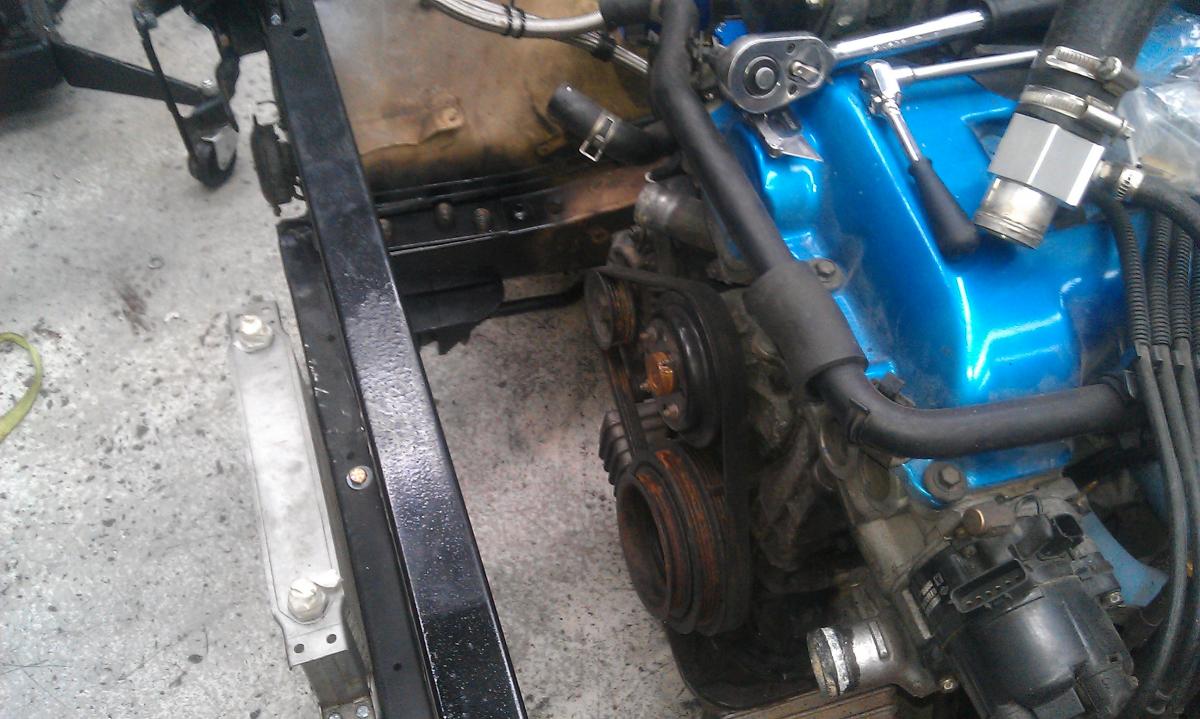

Mounted my overflow tank

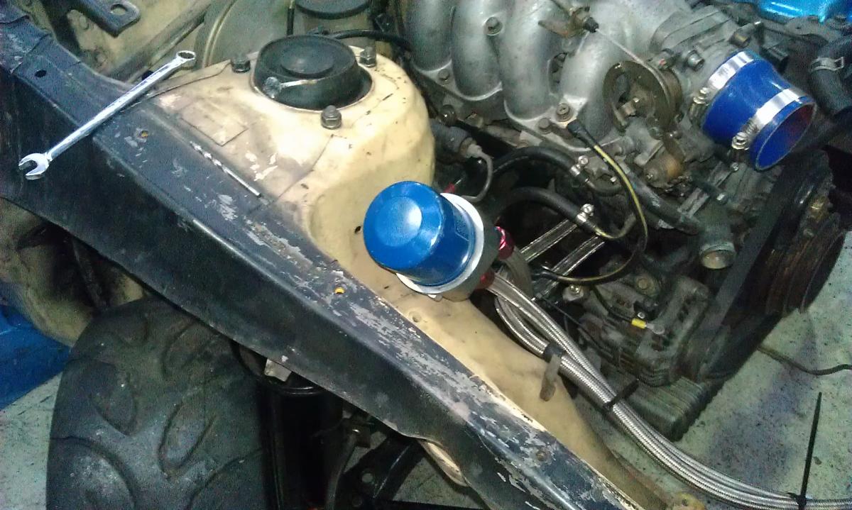

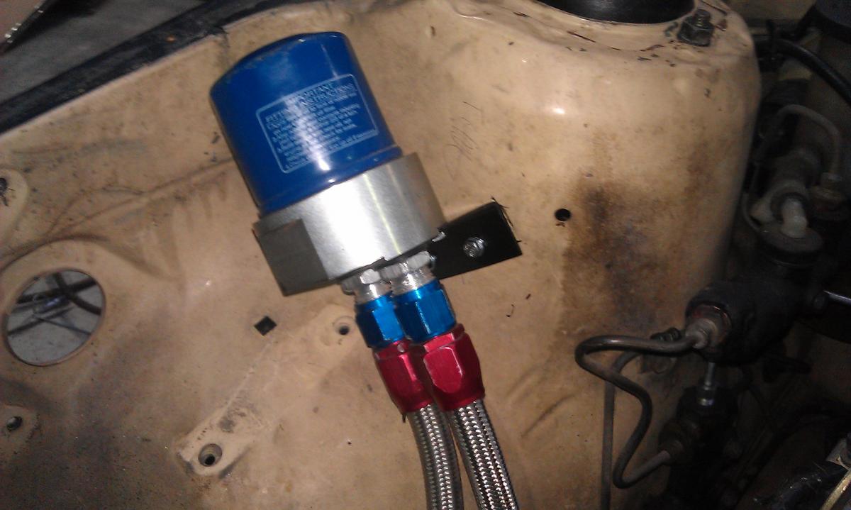

I made up a mount for my oil filter
Everything to do with radiator mounts is now done but incase I have to remove it again I haven't bolted it up properly

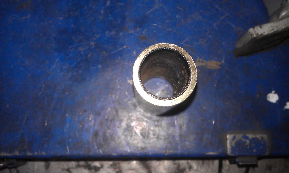

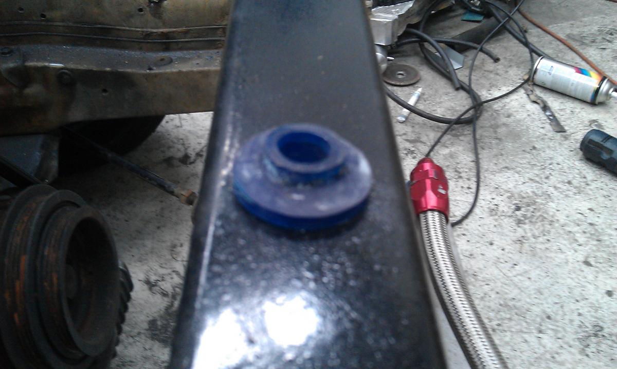

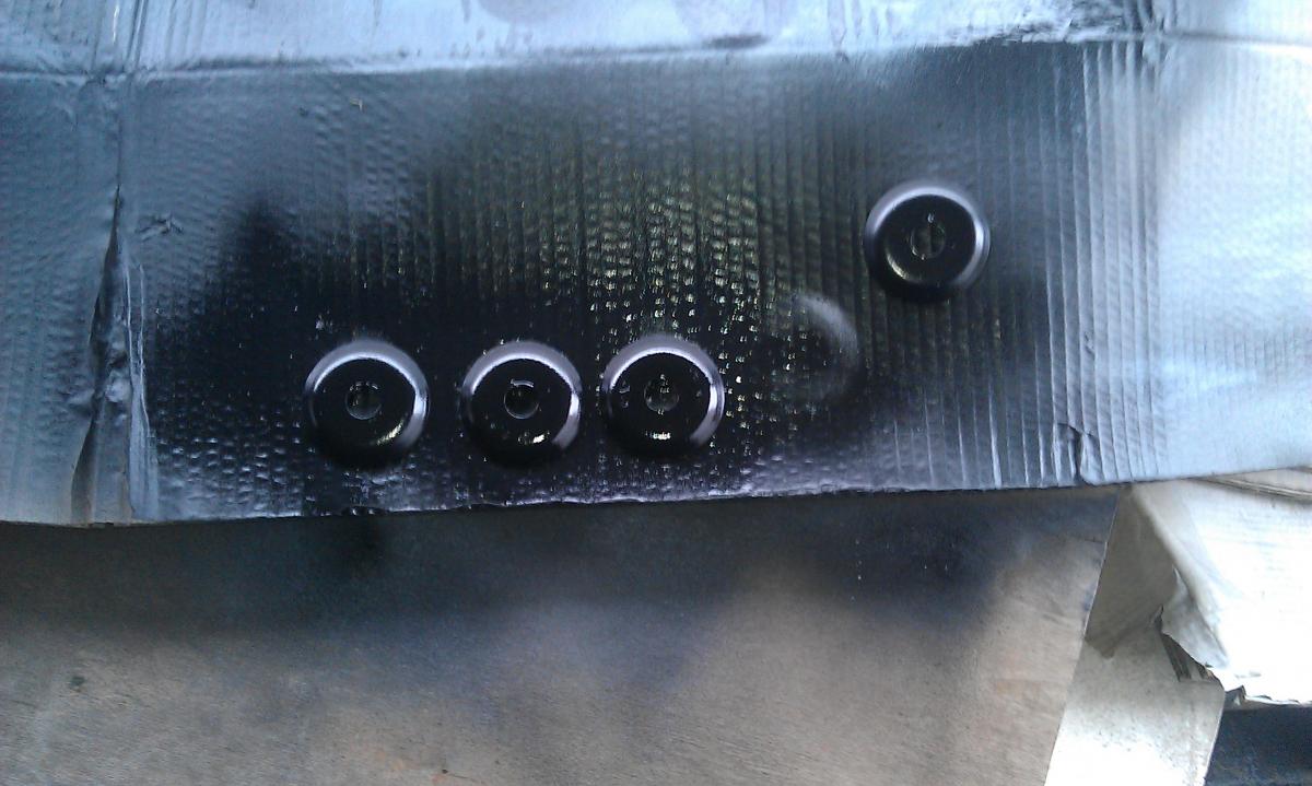

I used the lathe to turned down the factory crush tubes to fit it the new ones for the castor rod
You can see how it sits inside
The next one was better as It was a press fit

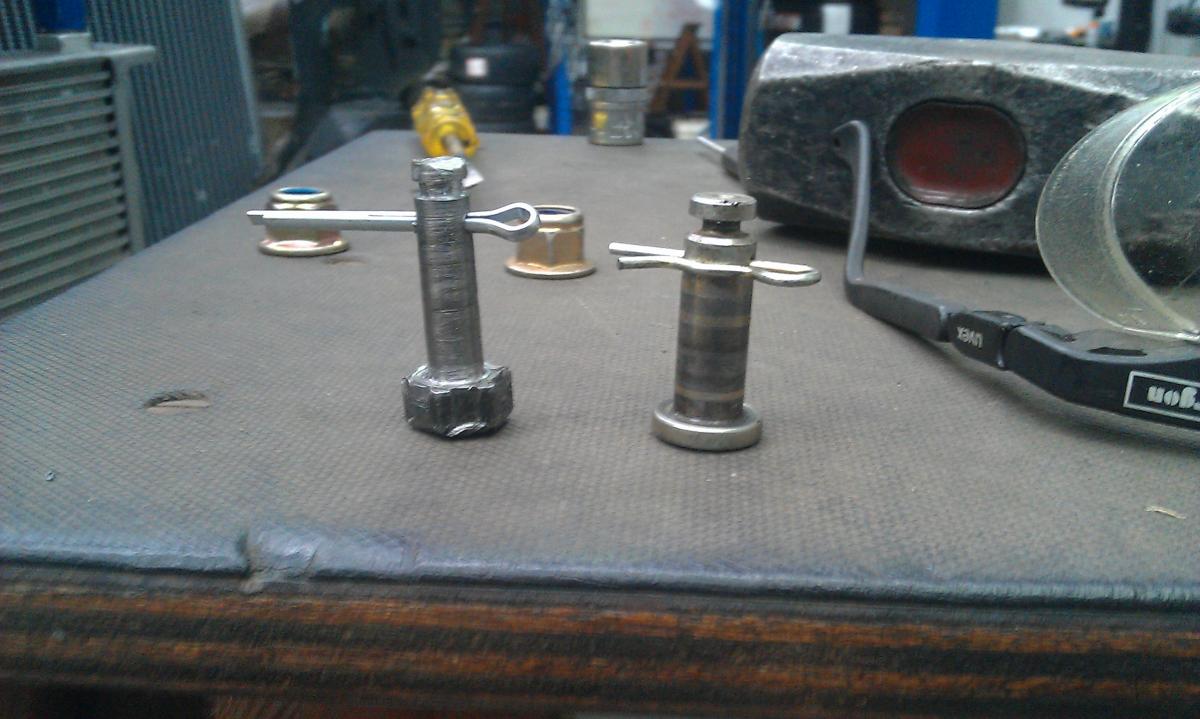

Machined up a bolt to use as the pin to connect my clutch master the the pedal so now all three pedals work :)
I totally didn't pretend to be drifting in it :P
My new bushes

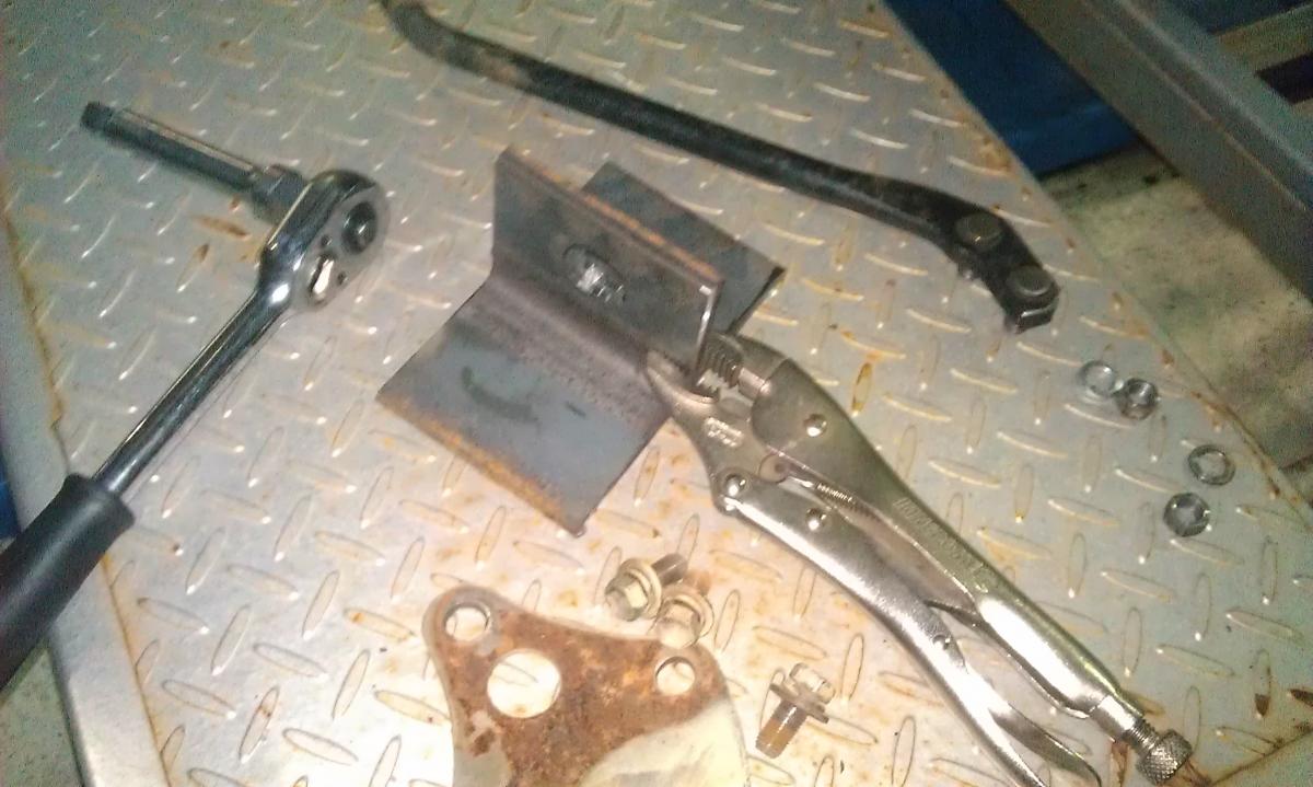

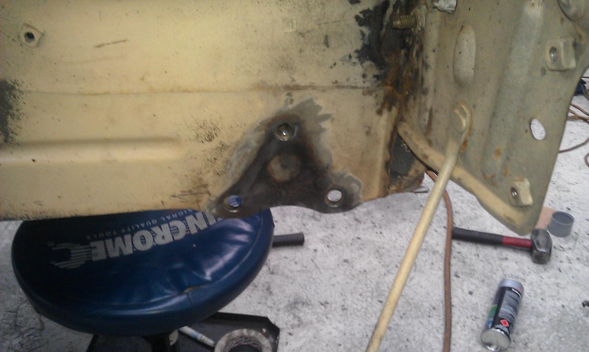

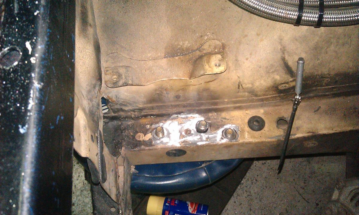

Cut off the nut for mounting the tow hook as my castor rod mounts will be sitting flush against this seam.

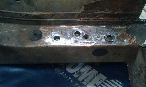

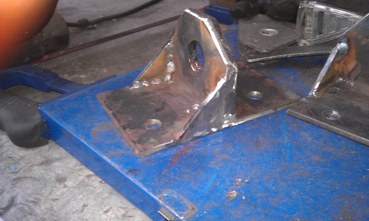

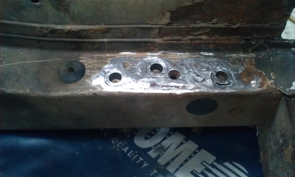

And here is the beginnings of my castor rod mounts
Was going to weld them to the chassis and so it would have been done now, but it wasn't going to be strong enough so am now going to be bolting right through the chassis using crush tubes so they will be beef as so now stuff needs to be bought and there's more to do so it'll be longer. I've been busy since Monday and will be busy until next Monday so there goes a whole week :( I hoped to have it home by the weekend
So there you have it. It's getting really close :D

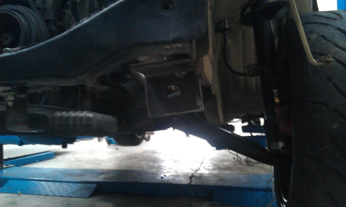

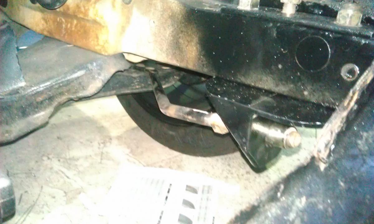

FINALLY AN UPDATE!
Sorry I haven't updated this in ages.

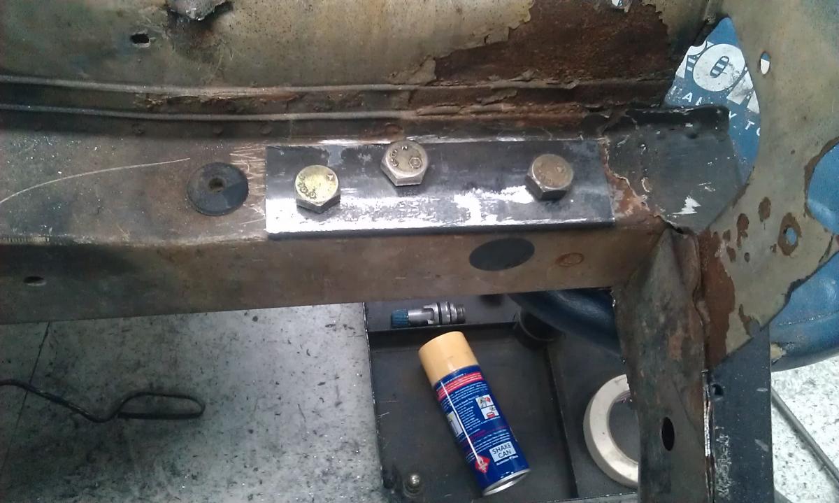

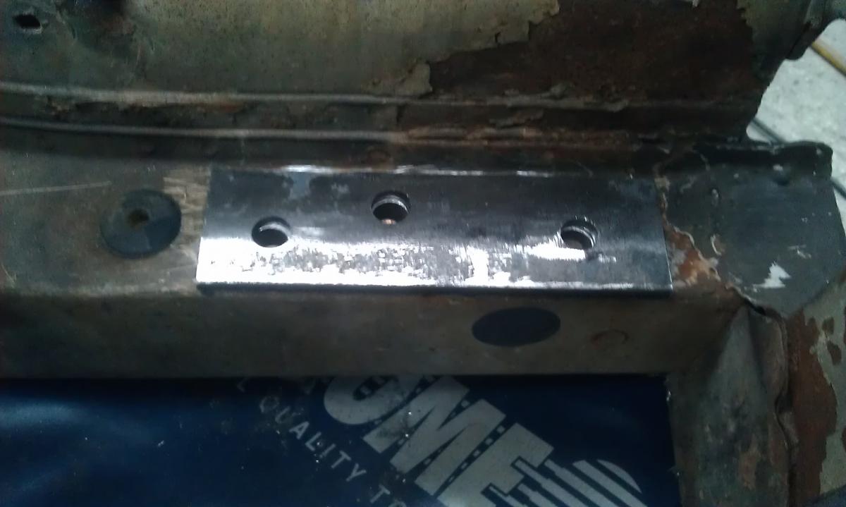

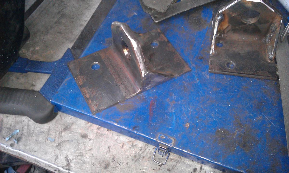

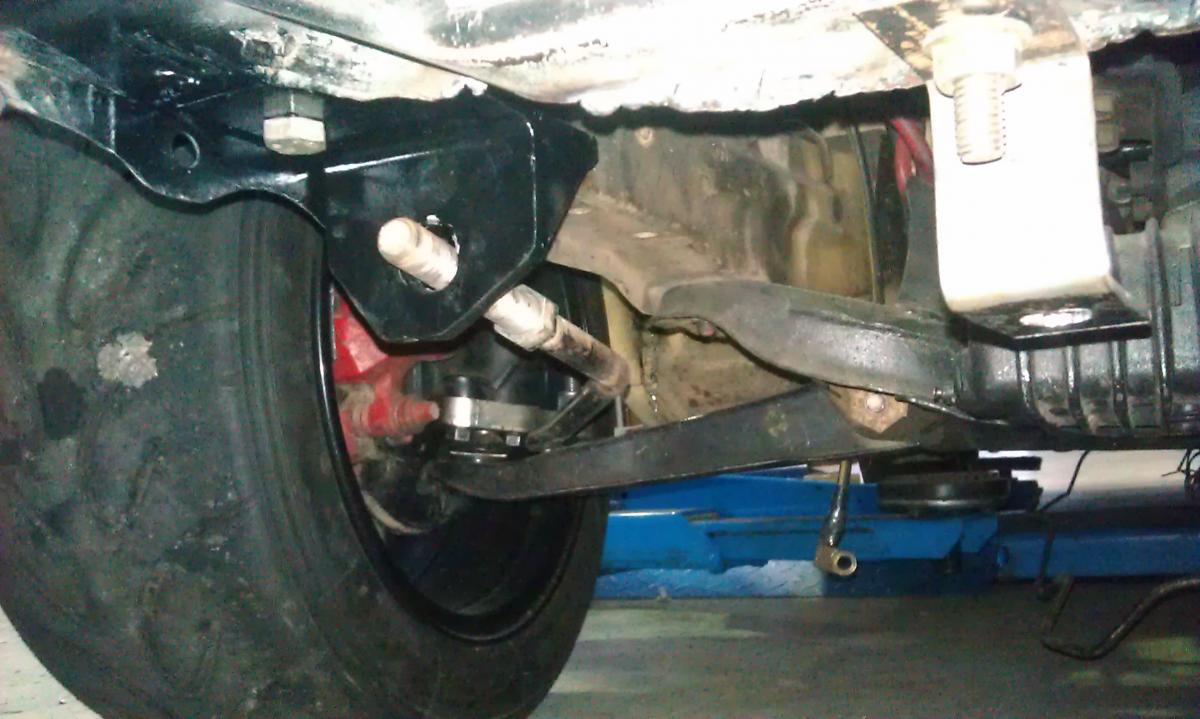

I spent the following week finishing and perfecting my castor rod mounts.

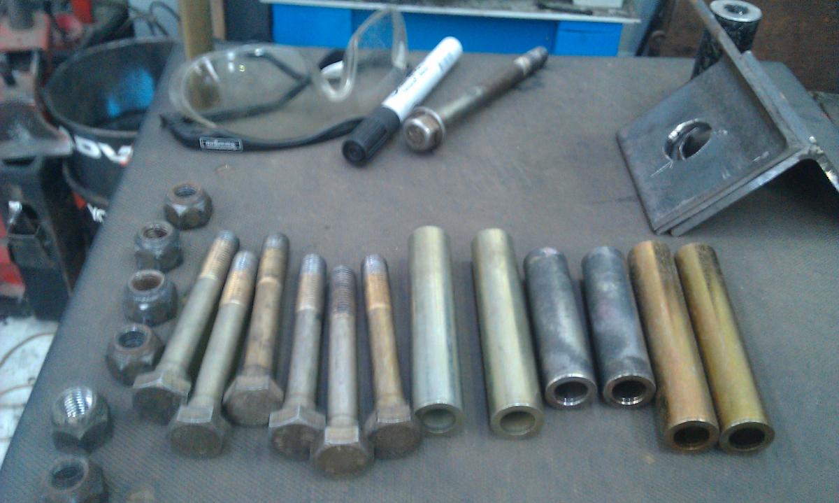

Went scavenging and found nuts, bolts and crush rod tubes to use.

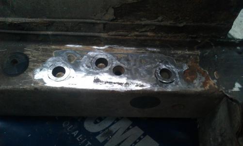

I adopted a mounting design used to mount tow bars to cars.

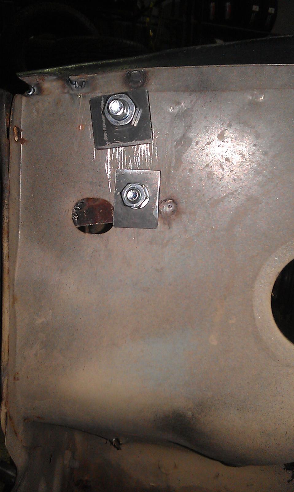

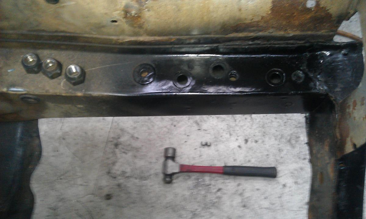

It is to drill a hole at the bottom of the chassis the size of the bolt to be used, drill a hole on the top of the chassis as big as the crush rod tubes, then slide the crush rod tubes in the chassis and cut the down to a eight making them flush with the rail.
pics of that

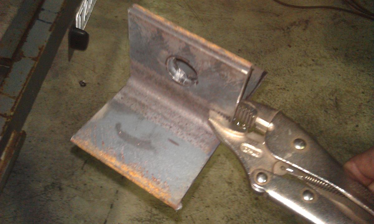

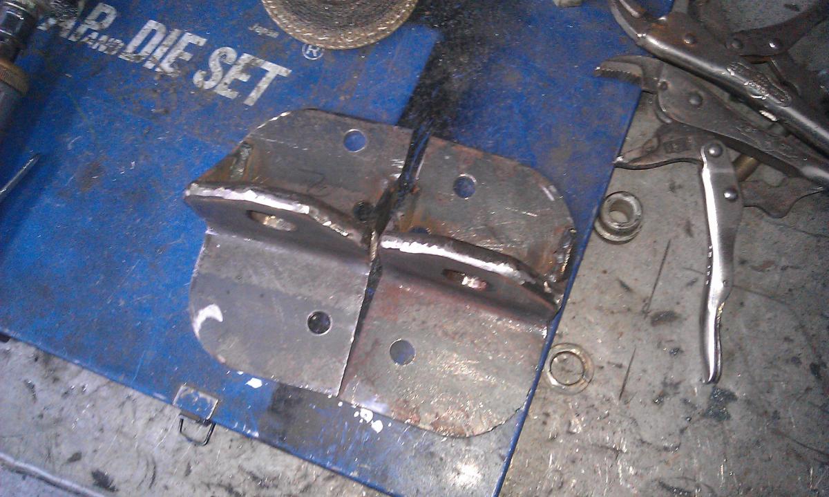

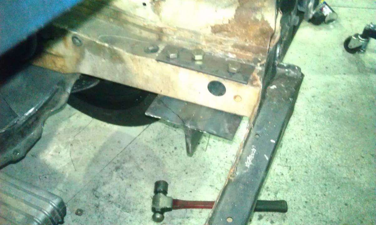

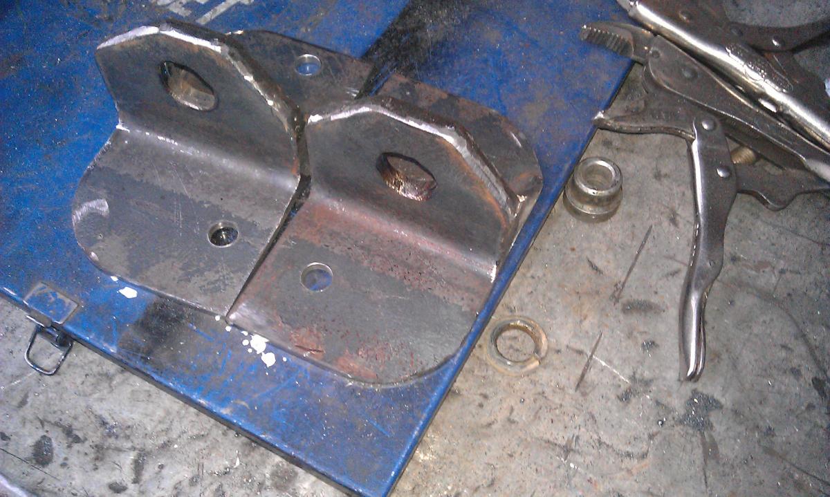

I cut a plate of steel to use as sort of a giant washer connecting all three mounting points and spreading the load along the chassis
Loosely bolted up the brackets to check everything worked.
They're made of two sections of 5mm thick 75x75mm Angle Iron fliped then welded all along the join.
The other side done
Found some good Federal's for drifting.
Cleaned up the rust on the tow hooks as I'm going to re-use them
Added some extra bracing to the brackets and trimmed off the corners to make it look a little nicer.
Painted the rails and brackets black
Test fit the castor rods and they would have worked but I wanted to get the geometry perfect so I took them out and bent them again to get them exactly the way i wanted, I hope they're strong enough and won't straighten out. Guess we'll see.
Happy with it I painted all the bits and put it together
All done and gave it a quick alignment and it's running 6"18' castor a side. Reduces steering angle a bit due to the angle of the lower control arms but I'm fine with that. It does get an alarming amount of toe change during suspension travel due to the angle of the tie rods but one of the next things on the list is to move the rack forward and down to perfectly align with the lca pivot point height and steering arm pivot point.

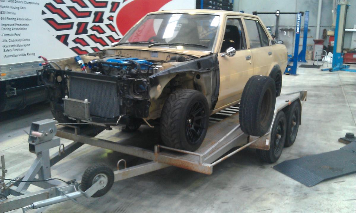

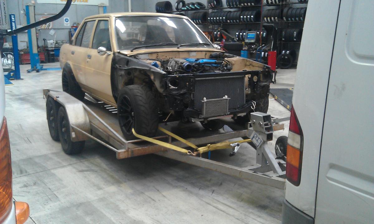

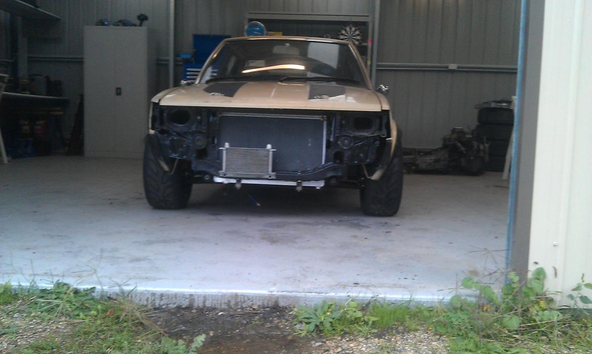

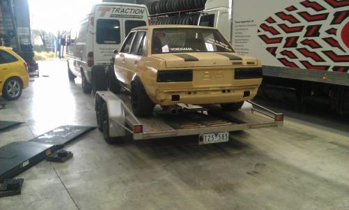

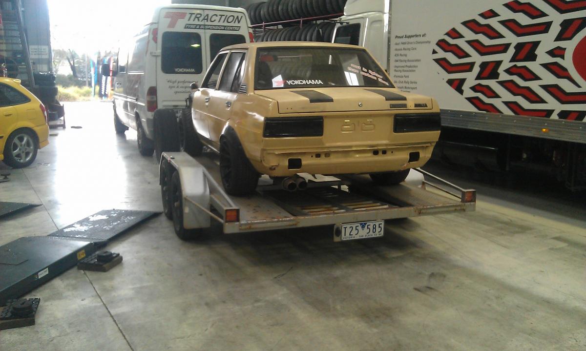

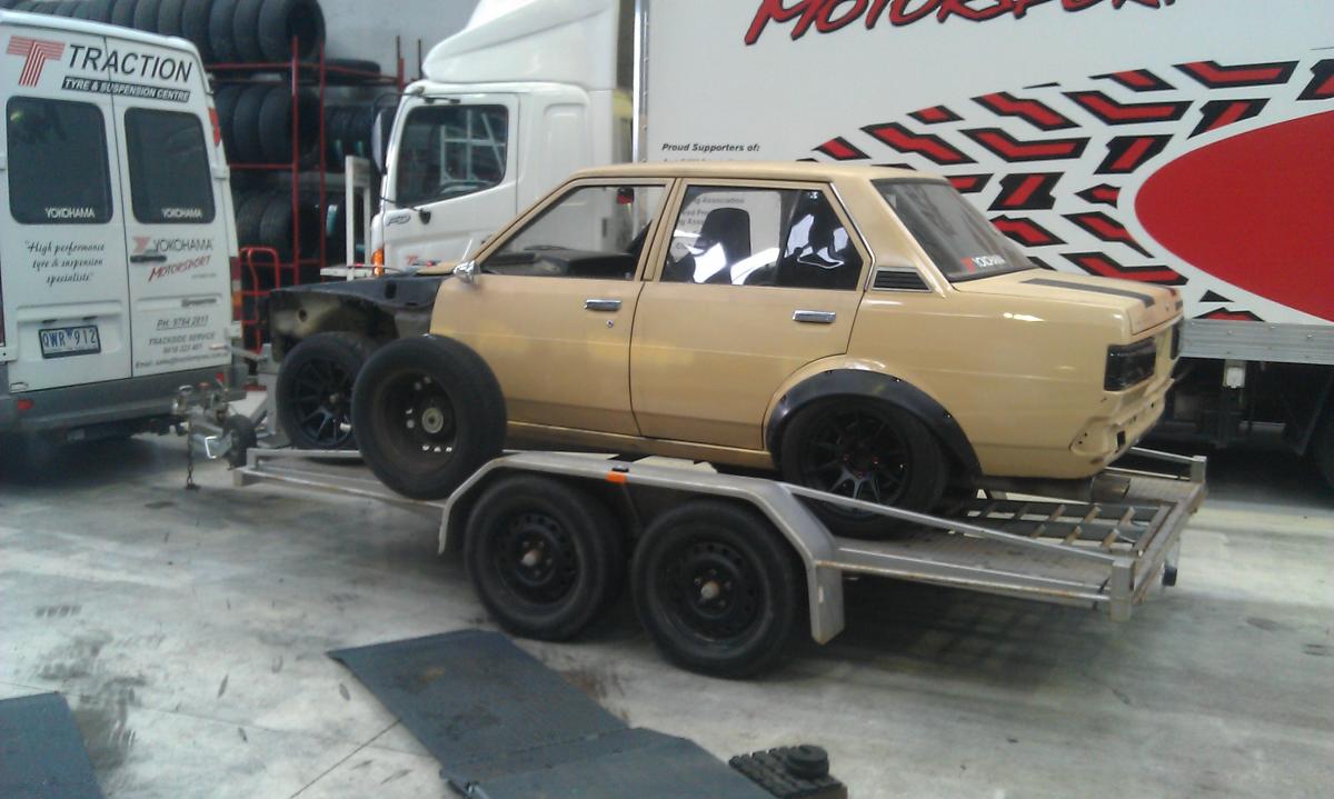

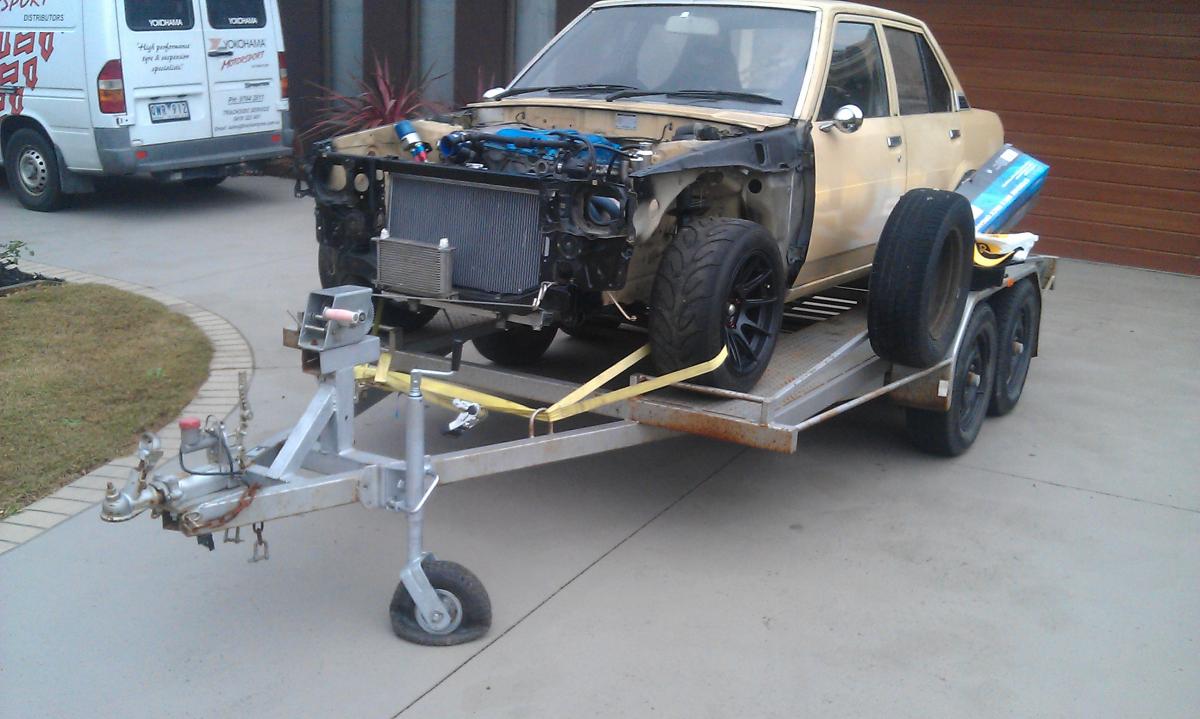

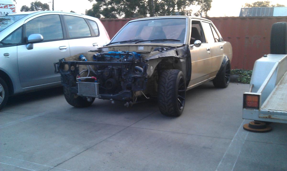

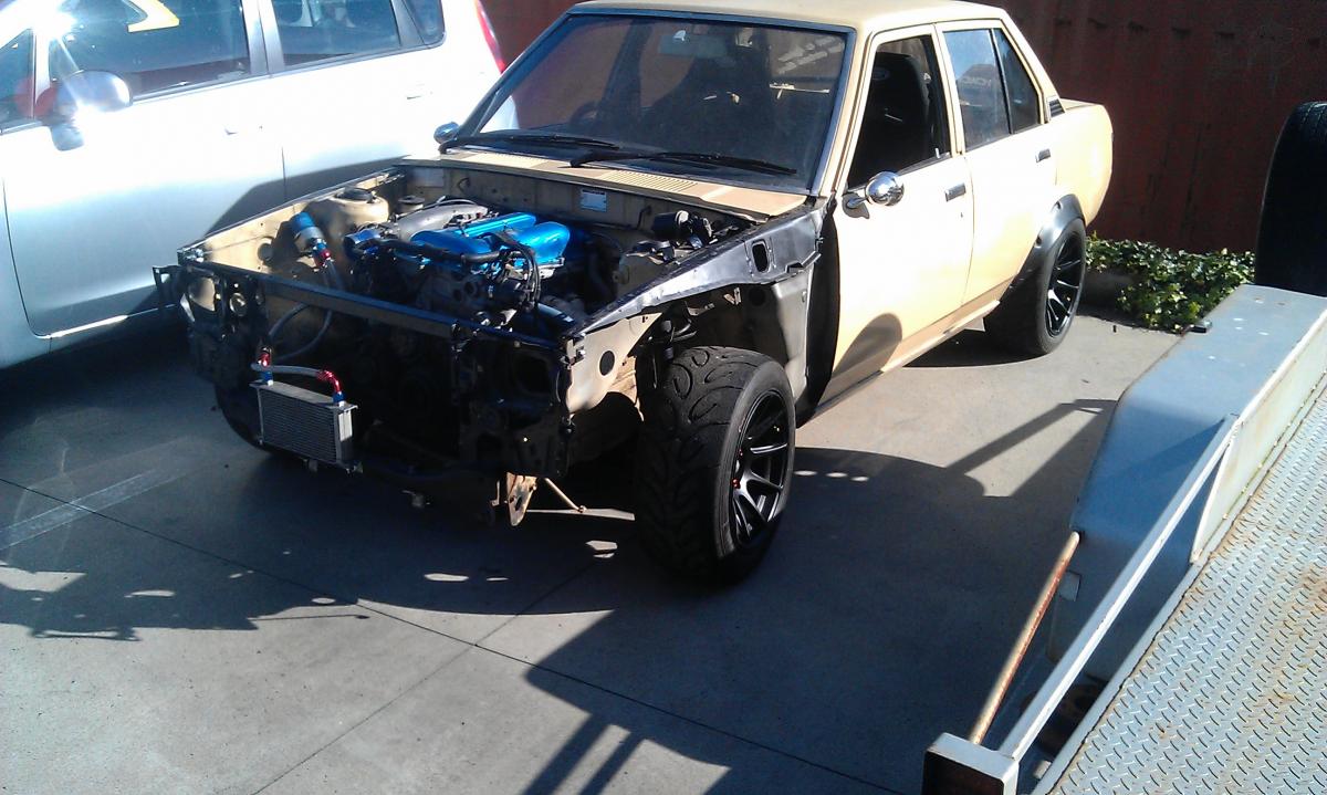

Loaded the car on the trailer on Saturday and headed home.
When we got home the dolley wheel finally gave up and exploded with a massive bang which had the neighbours wondering what happened :P
Finally back in it's home

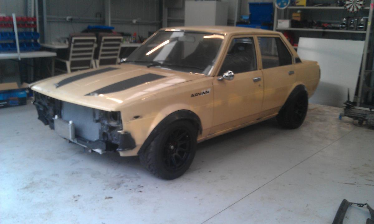

And my Fave pic so far, looks tough :D

If you cold pressed those castor rods I don't think you'll have too much on an issue. Its when they get heated, you'll start to have problems.

Unfortunately I did heat them as I don't have the equipment to cold bend them. I did let them cool at their own rate rather than dipping them in water to cool which is ment to be better but oh well if it bends hopefully It doesn't cause me to crash and I'll just get my rose-jointed lca and tension rod kit sooner than expected and make new mounts :)

Letting them cool slowly will help. I don't think they'll straighten up(which having a W/A machine helps check). I think IF anything they may fatigue crack on the bend, just keep an eye on them. Should always go over the car before and after a track day anyway.
