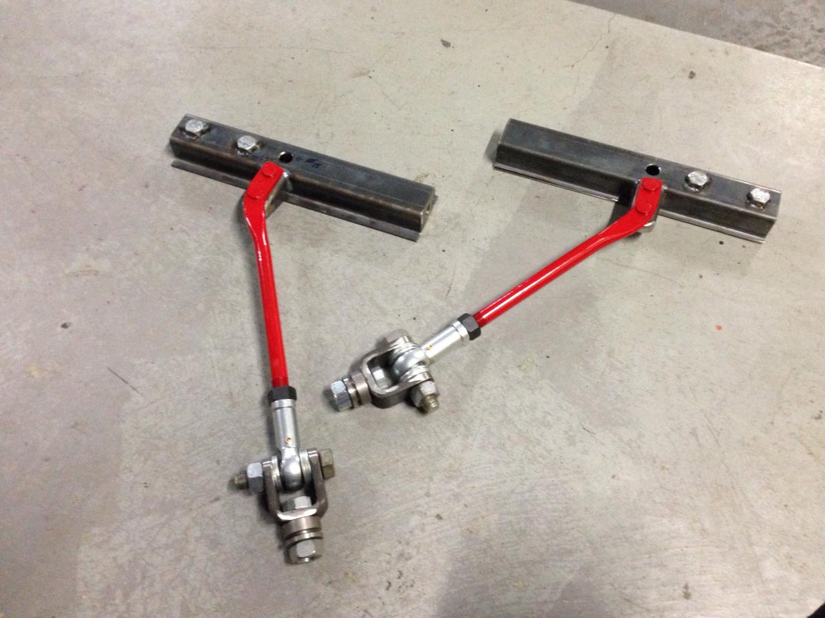

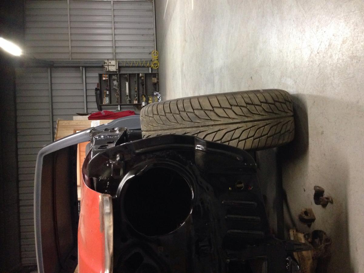

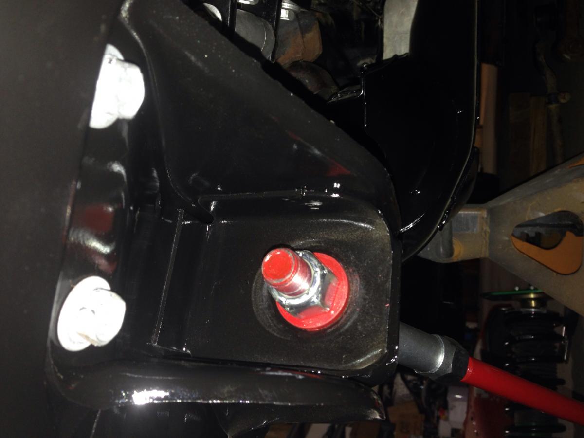

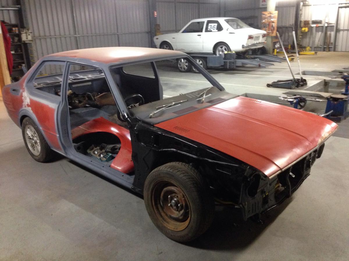

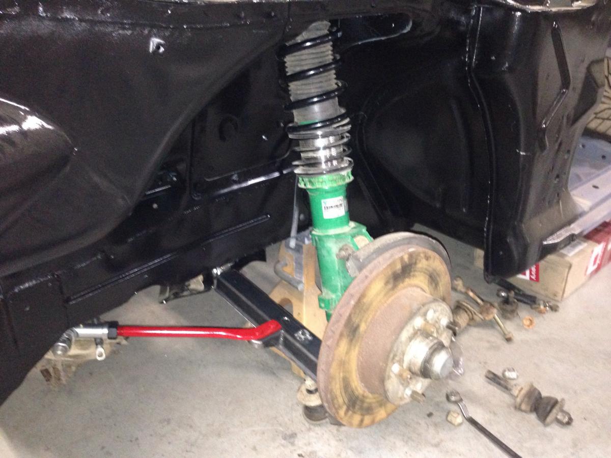

September 11, 201412 yr Author comment_688215 Base plates have been welded on since taking these photos, just need to get high tensile bolts, then make some spacers to go in place of the flat washers an paint it all, assemble and she's ready to roll (with floppy wheels until my new idler arm, pitman arm and rod ends turn up Report

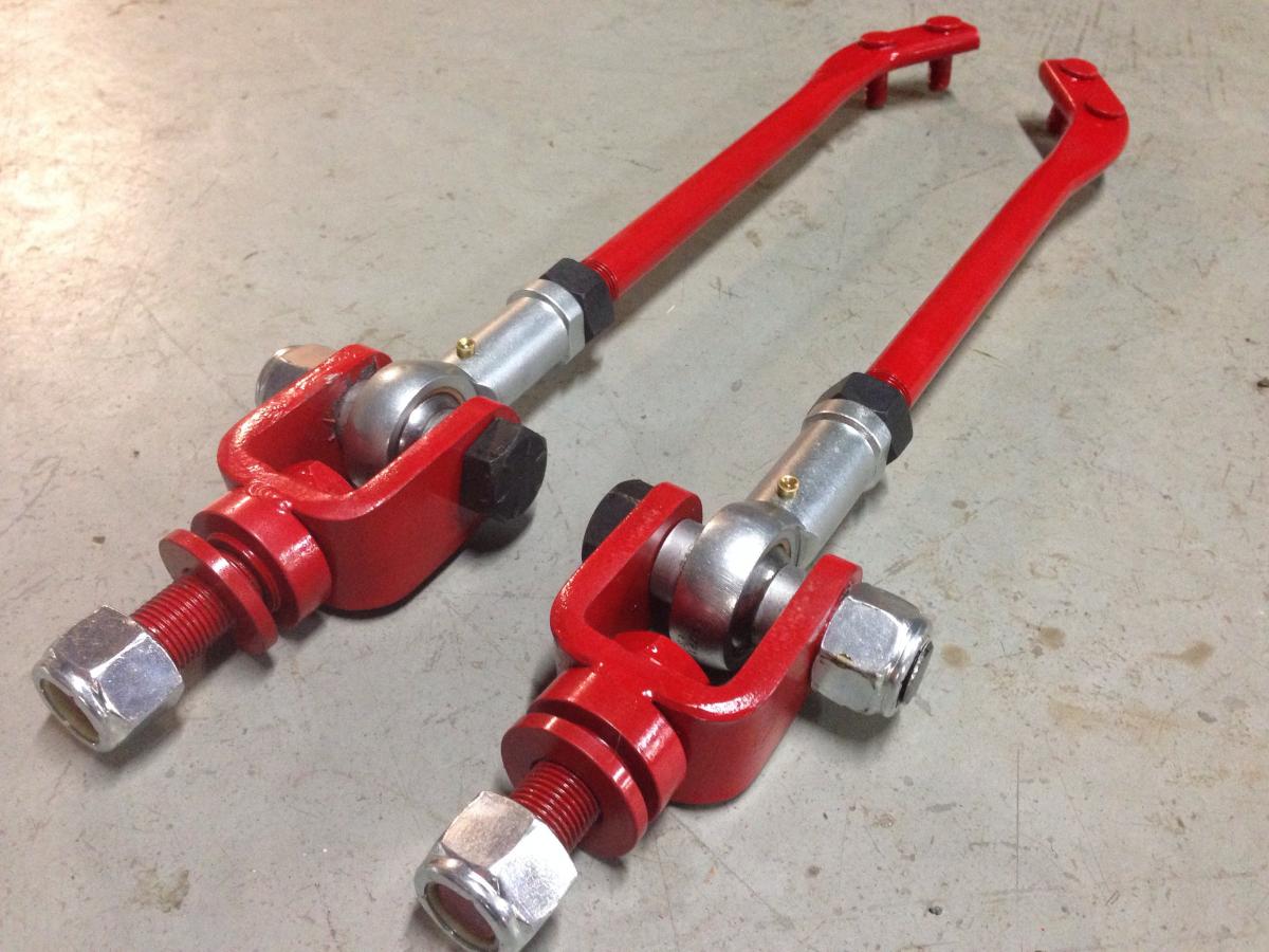

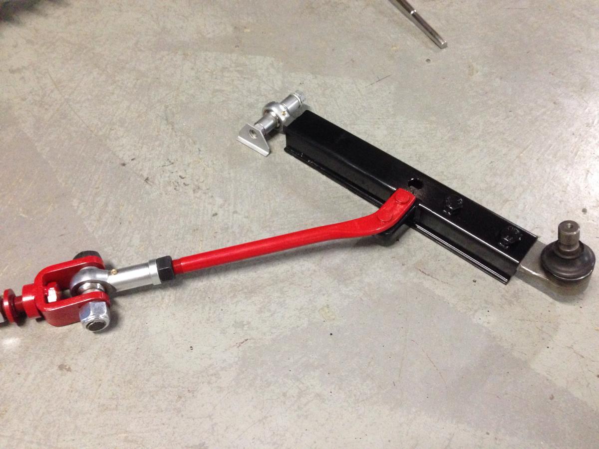

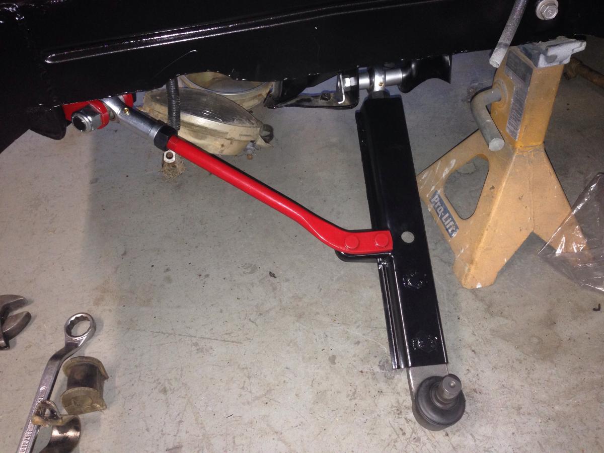

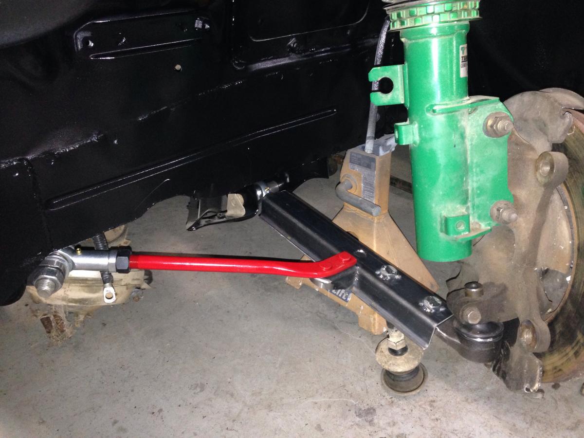

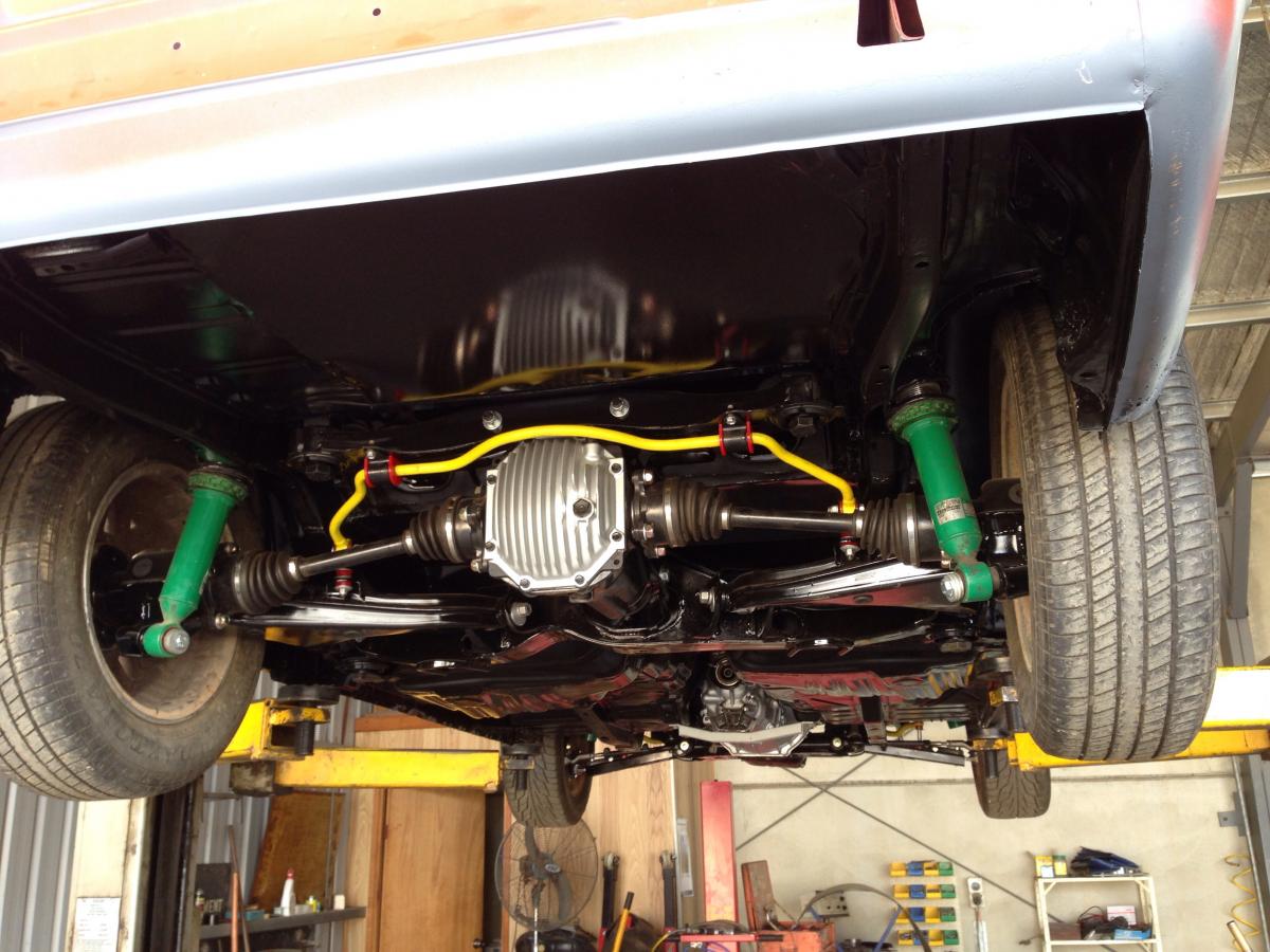

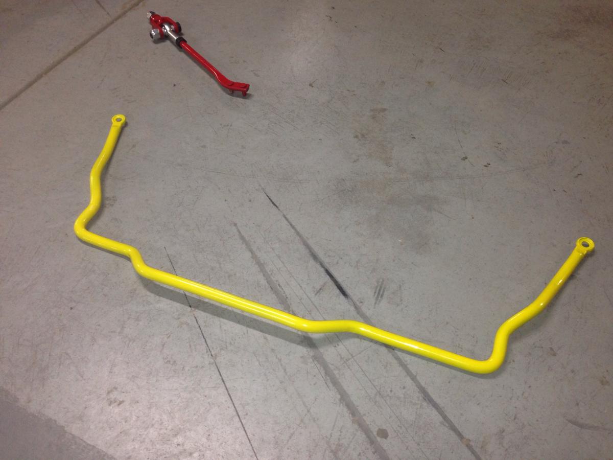

September 12, 201412 yr Author comment_688241 Ok, radius rods done, lca's are just waiting to be painted, also painted the sway bar Report

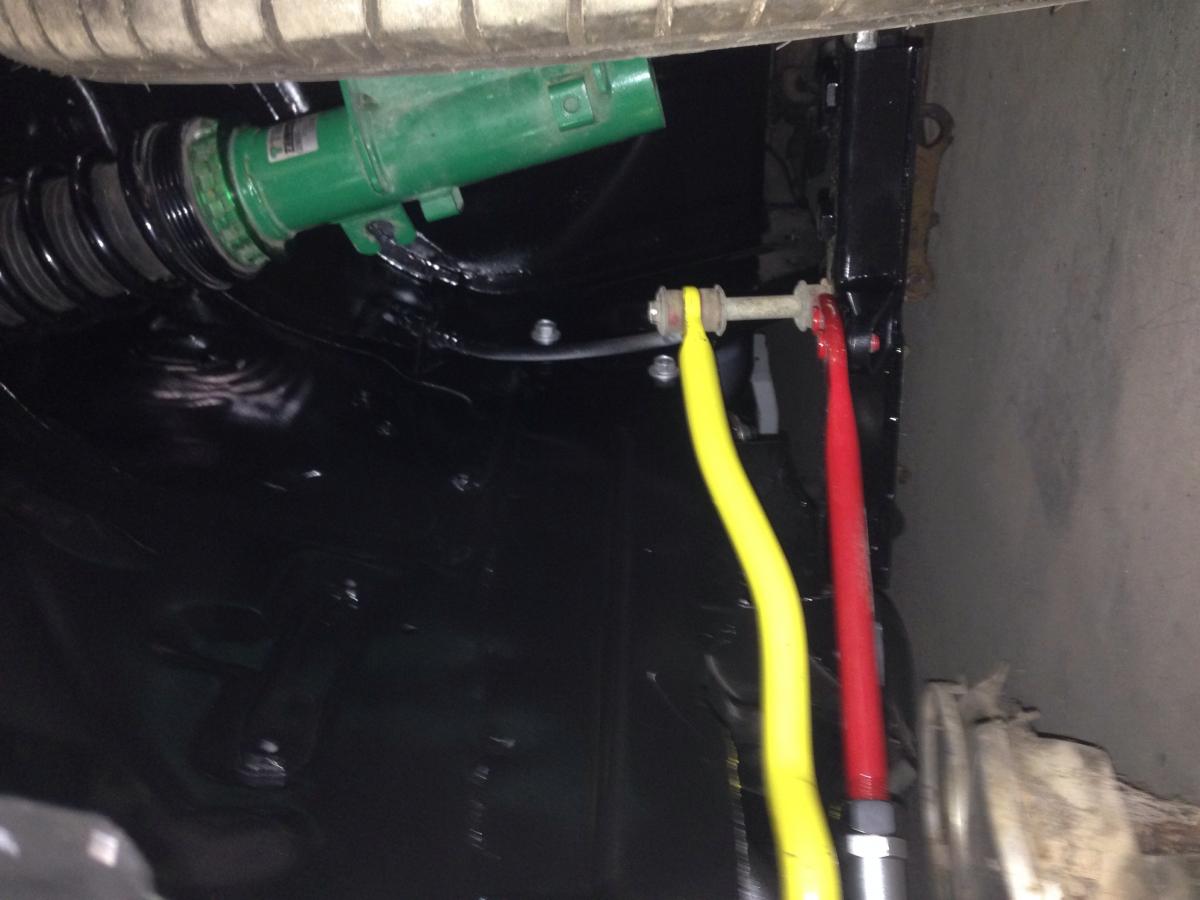

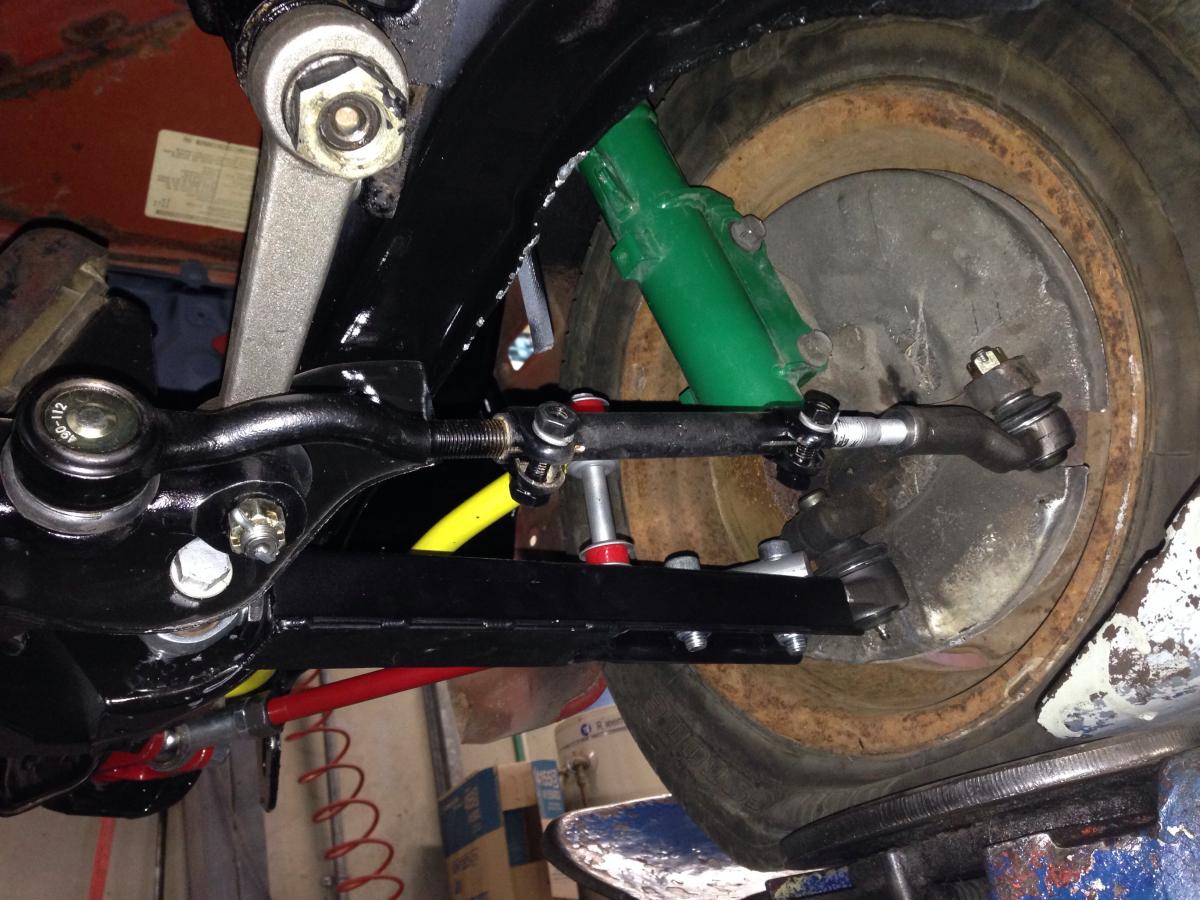

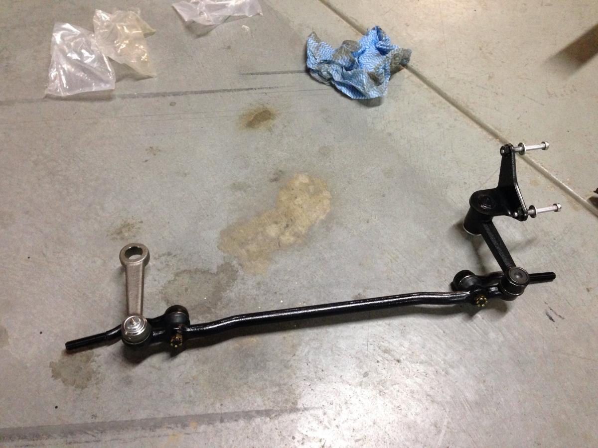

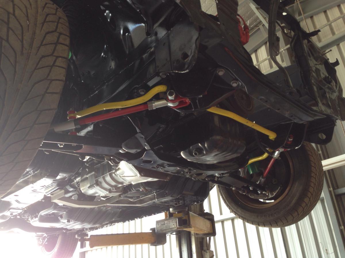

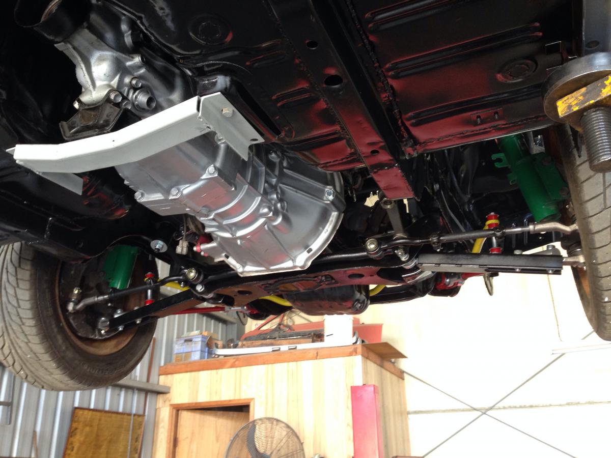

September 14, 201412 yr Author comment_688315 Another section completed ????????????????????. The arms are all mounted up, wheels are on and the car is rolling on all 4's. The new idler arm is in, waiting on the pitman arm and rod ends, then time to rebuild the steering box, ordering new swaybar linkages tomorrow so that's why they're not painted, cage is next after all that's done Report

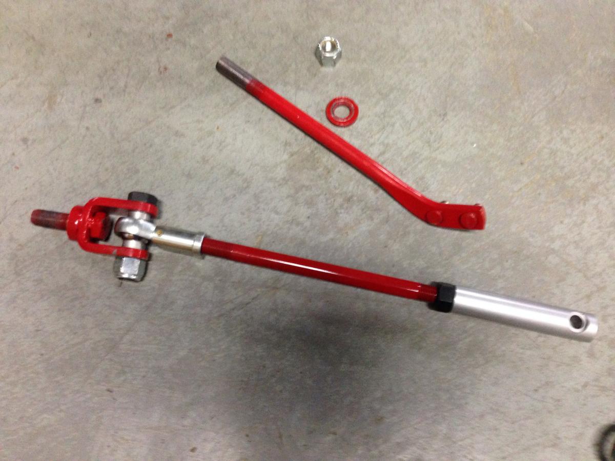

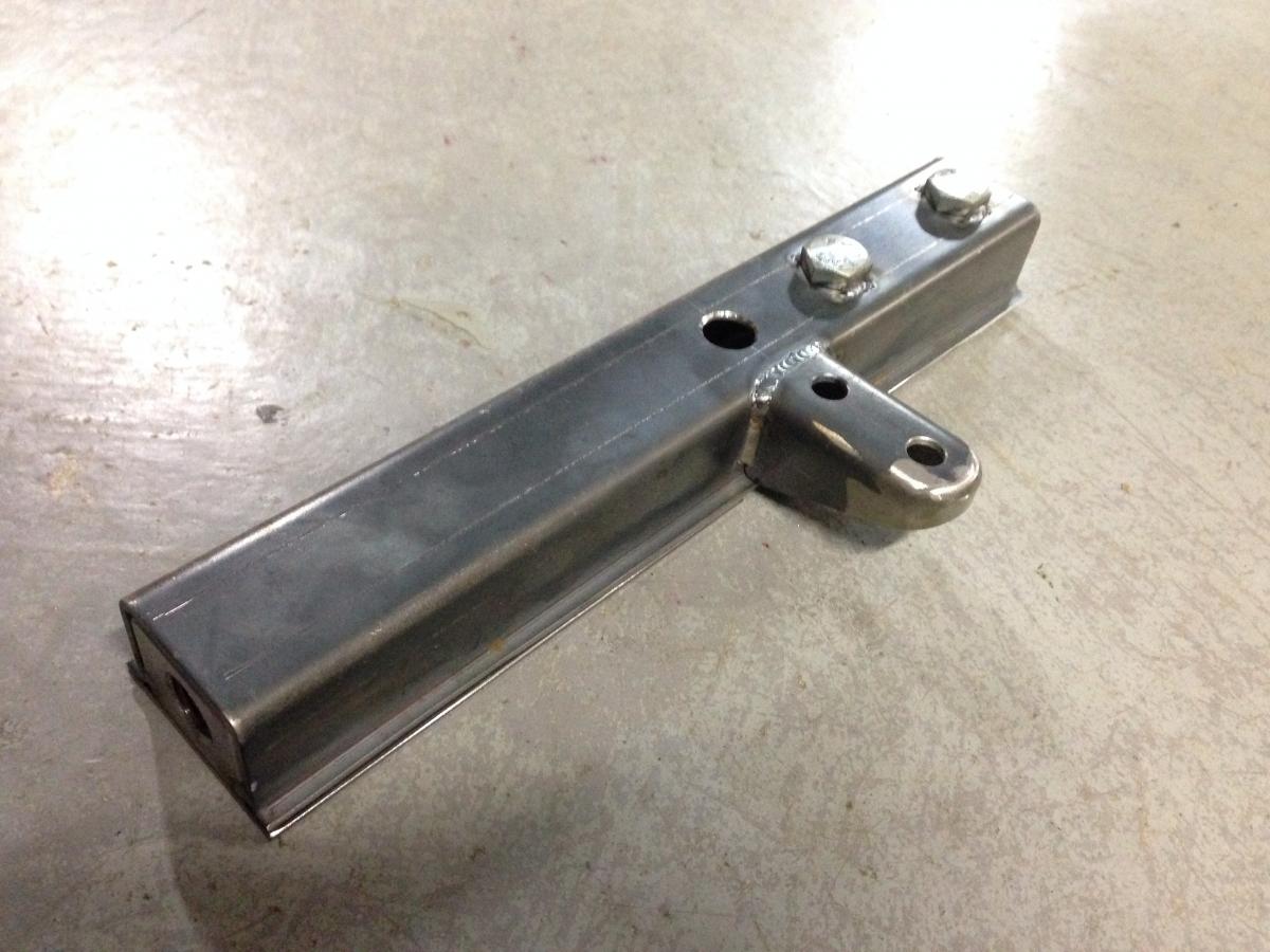

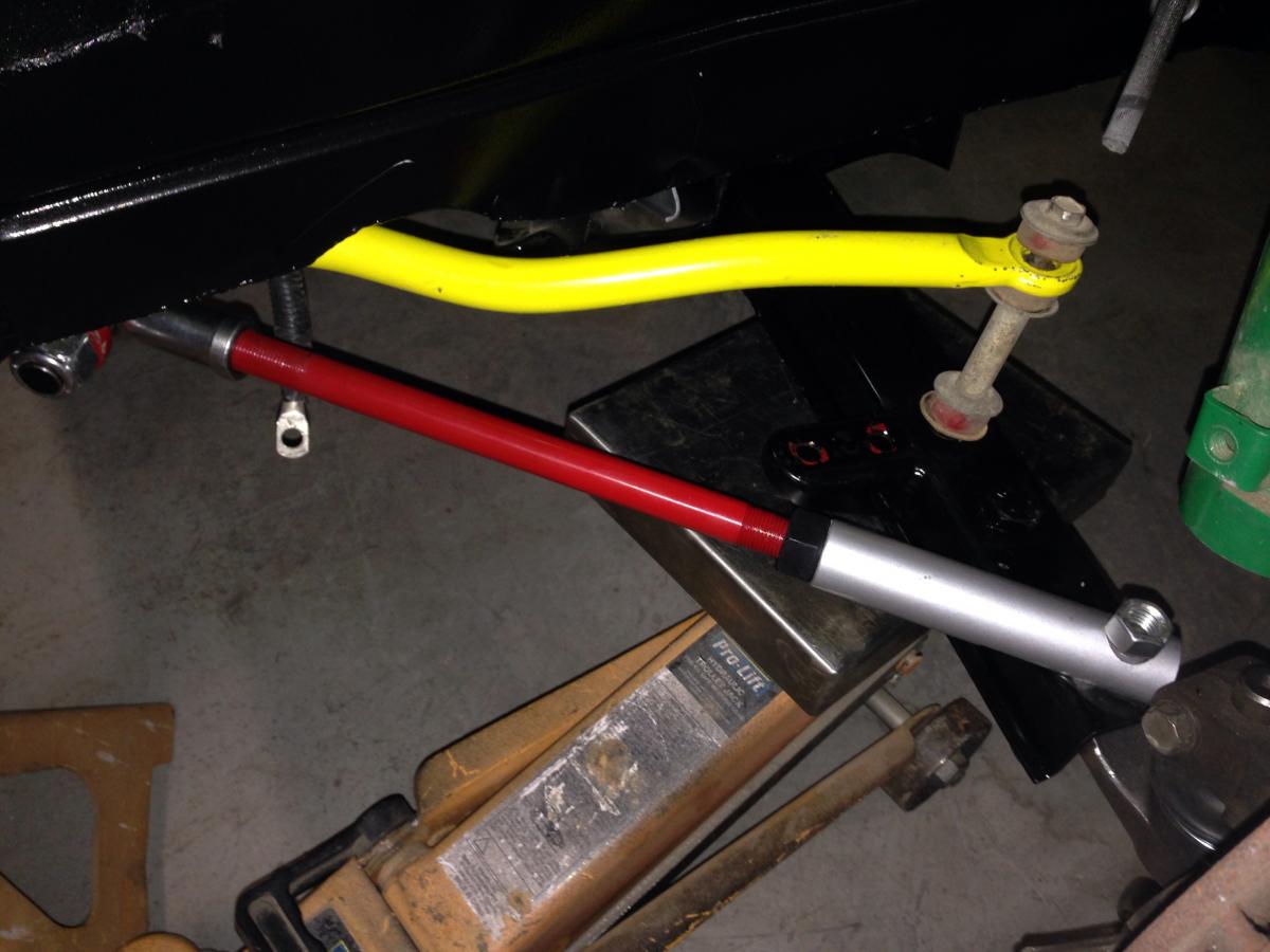

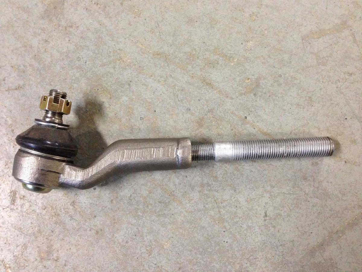

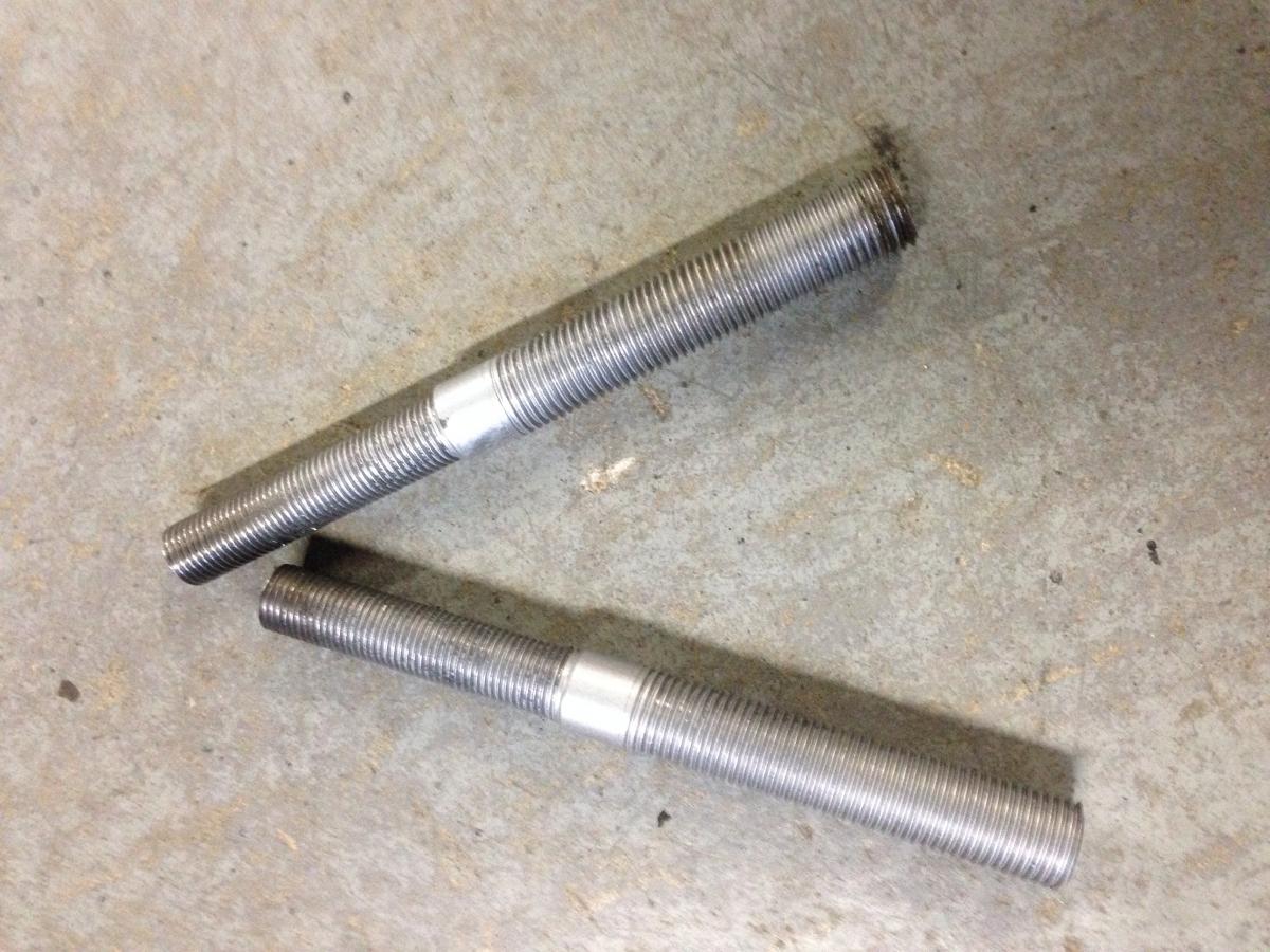

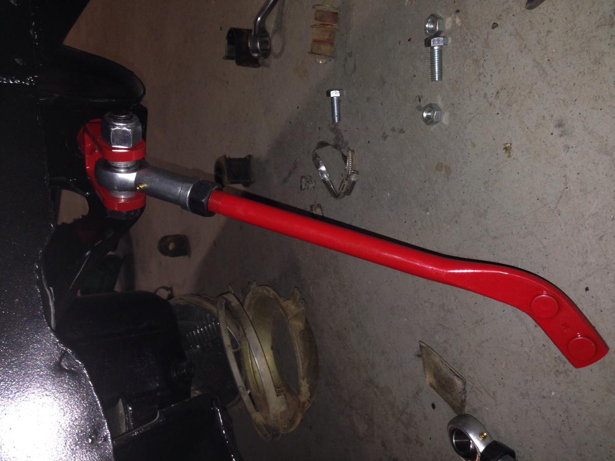

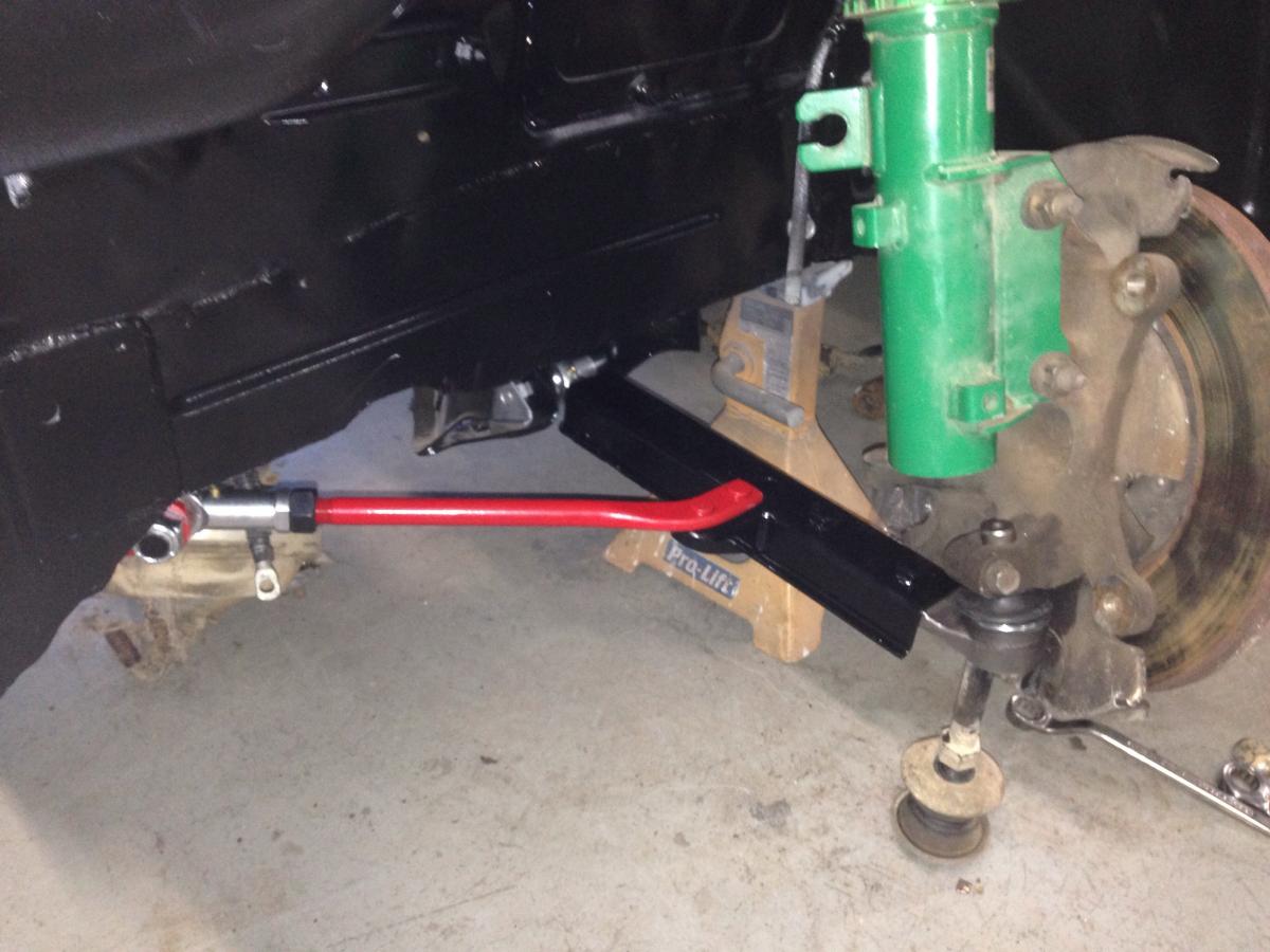

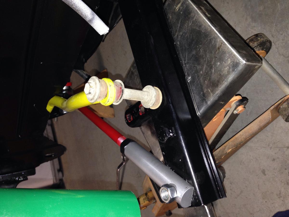

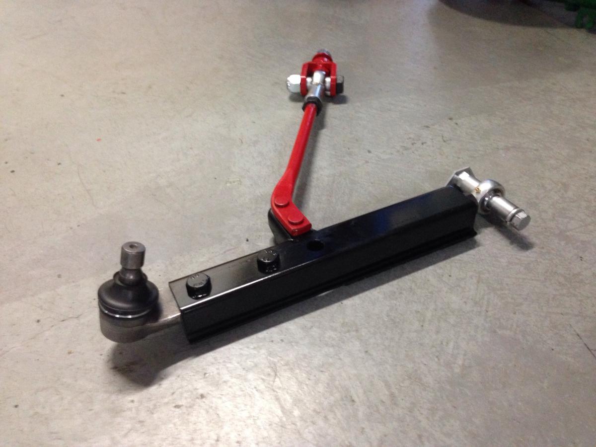

September 23, 201412 yr Author comment_688670 The car is back on the ground again haha, I changed the radius rods, they now have a left and right hand thread for easier adjustability and support further out on the lca. I have all new steering links, just waiting on the outer rod ends then I need to make some extensions/adaptors Report

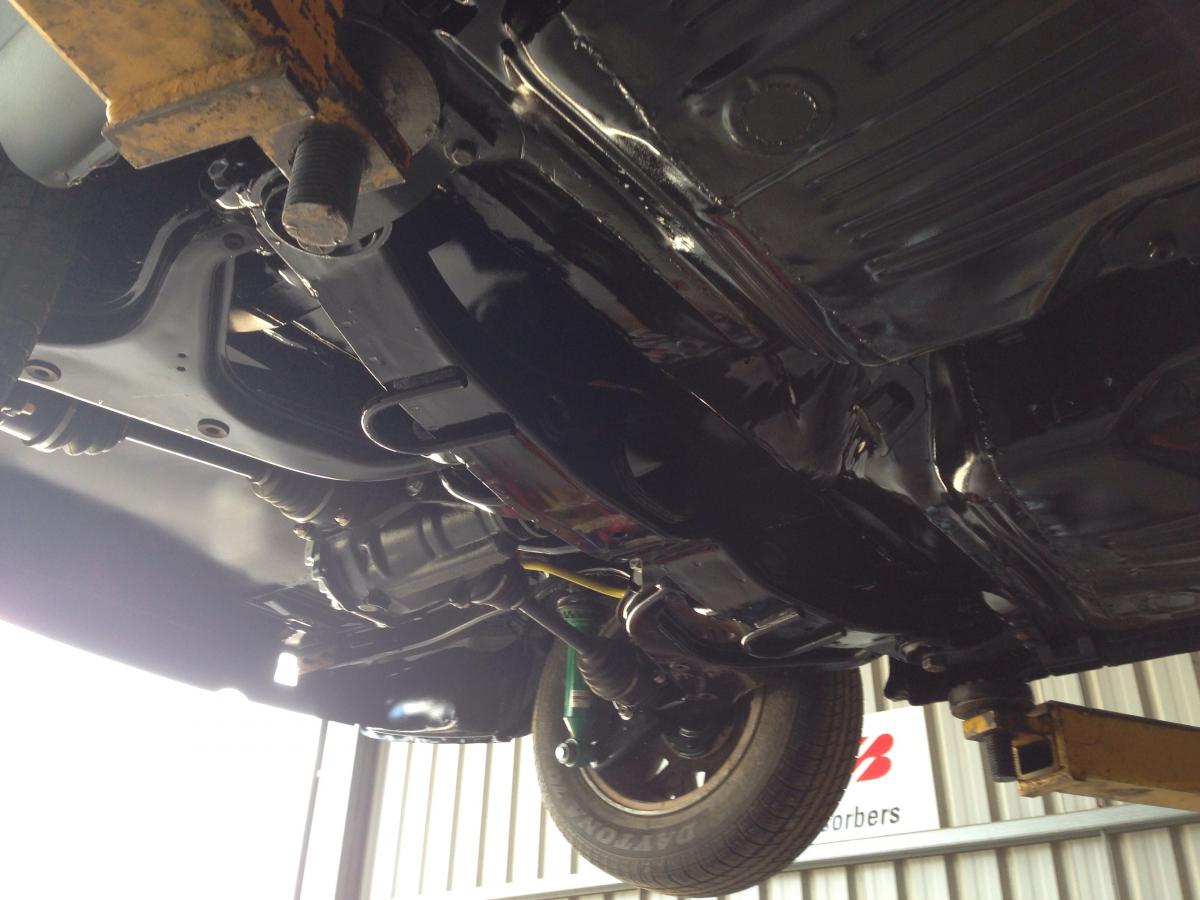

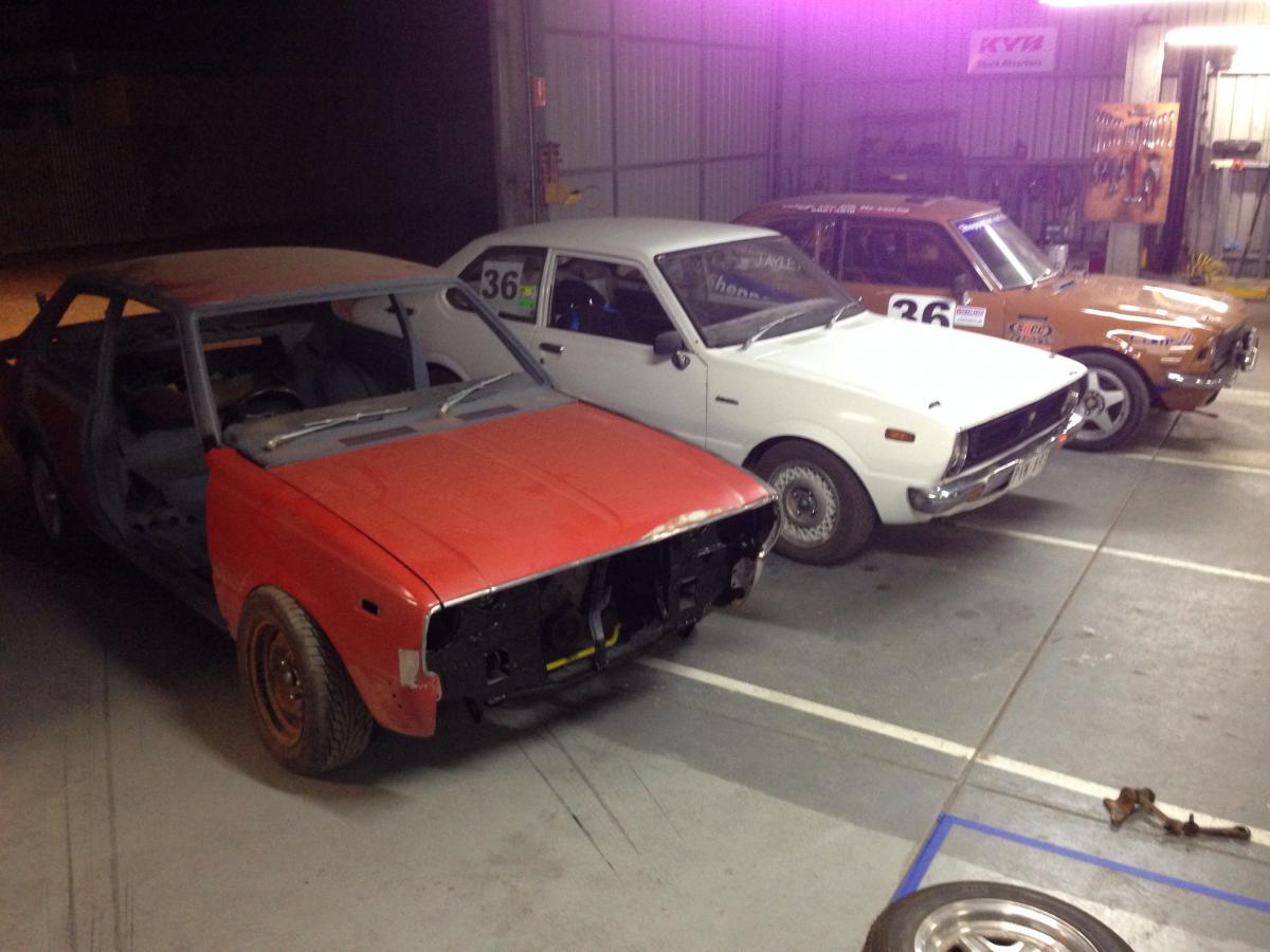

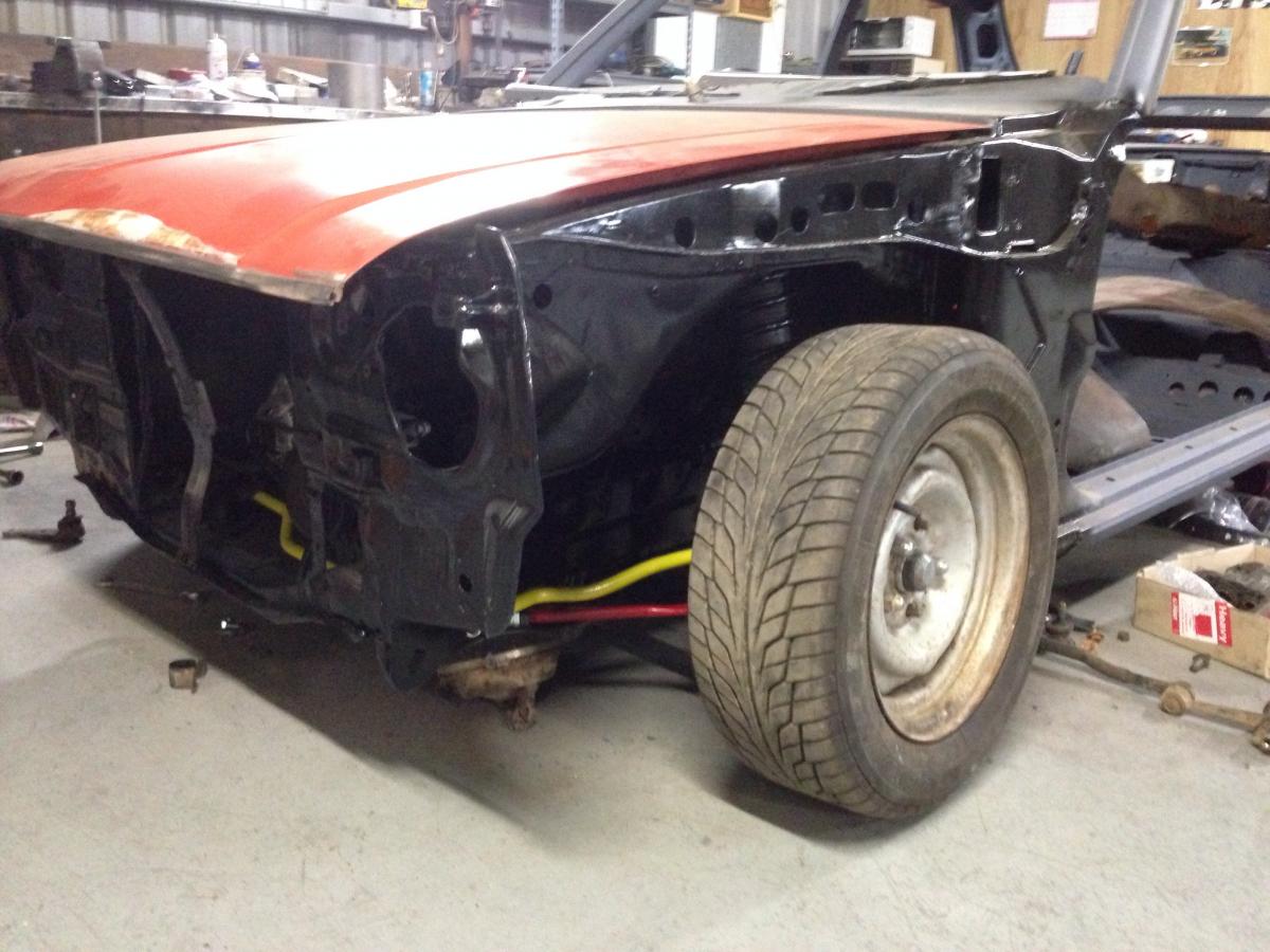

September 26, 201412 yr Author comment_688818 The rolla has working steering and suspension all around now, very pleased with myself, pushed it into the yard on it's own wheels for the first time in a year and a half, and I couldn't help but take a family photo haha Report

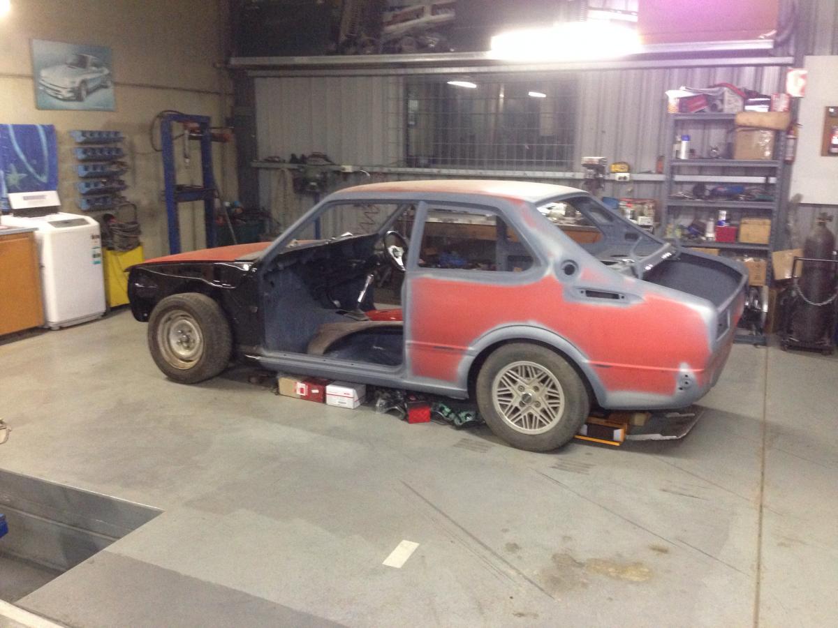

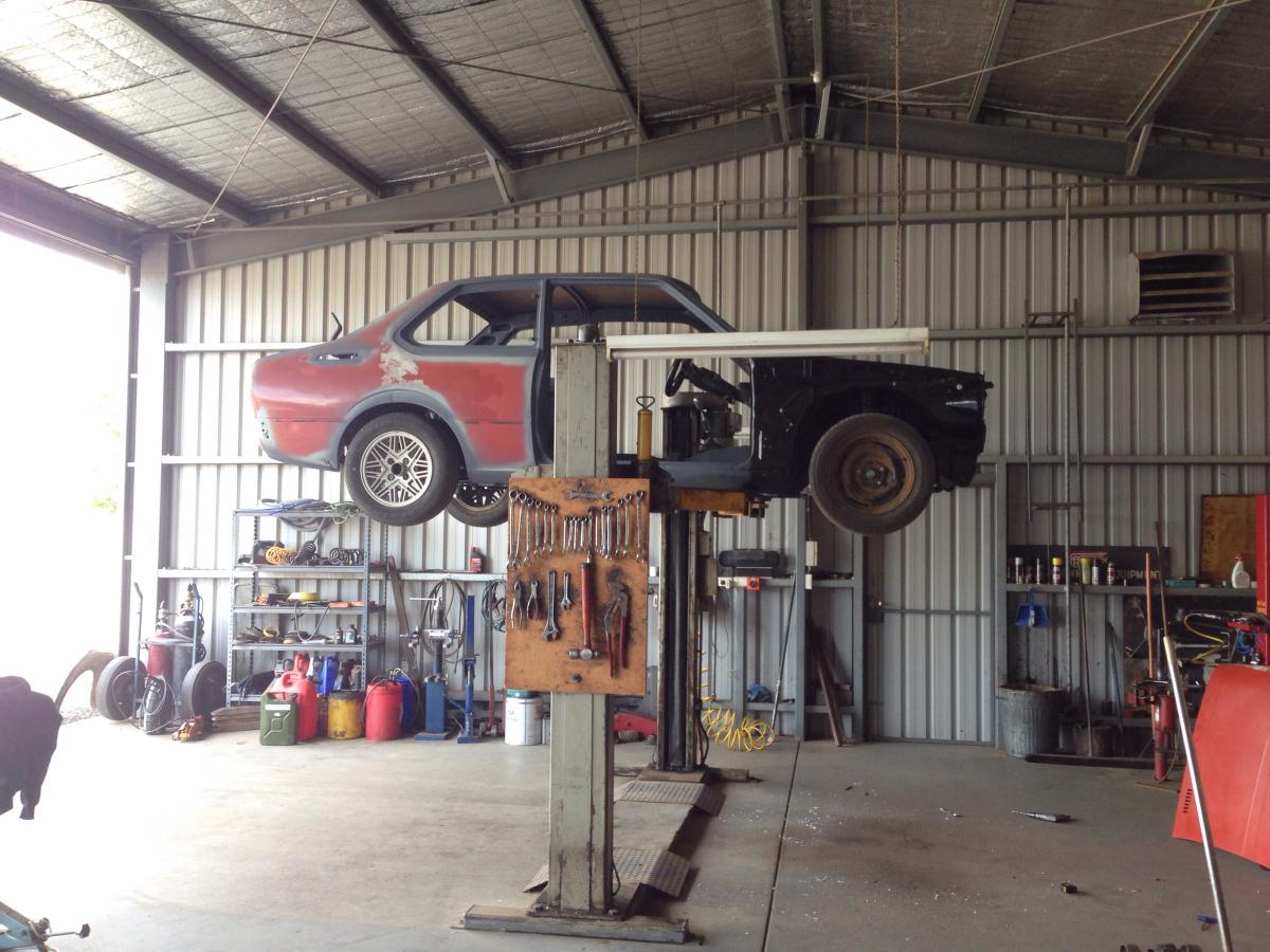

September 27, 201412 yr Author comment_688850 Gave the cars a good wash today, aligned the 30 front and rear, about a year ago I put the car on the rotisserie, to finally get it out in the sun, steer it around on it's own wheels and get it on the hoist is an awesome feeling, now I've gotta decide what part to do next Edited September 30, 201412 yr by Tough_little_ke20 Report

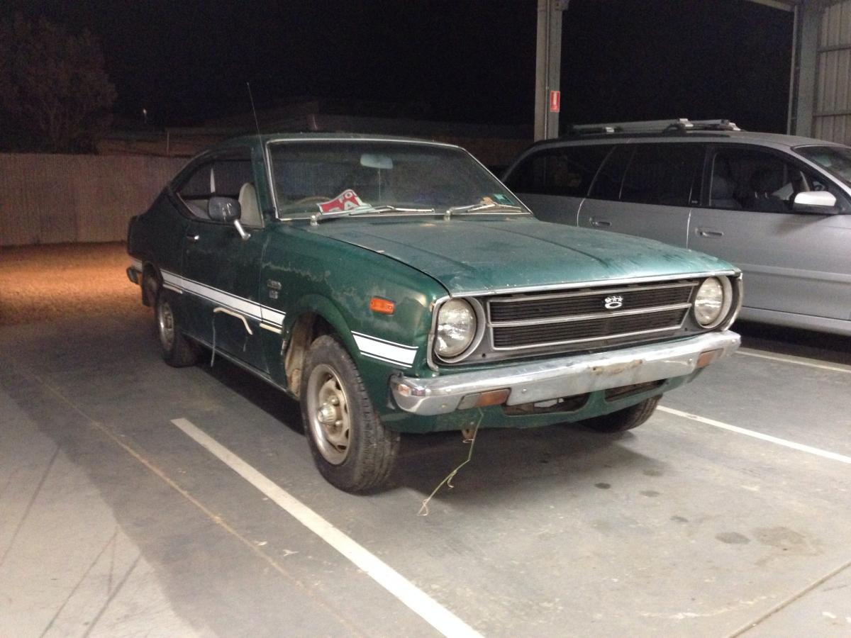

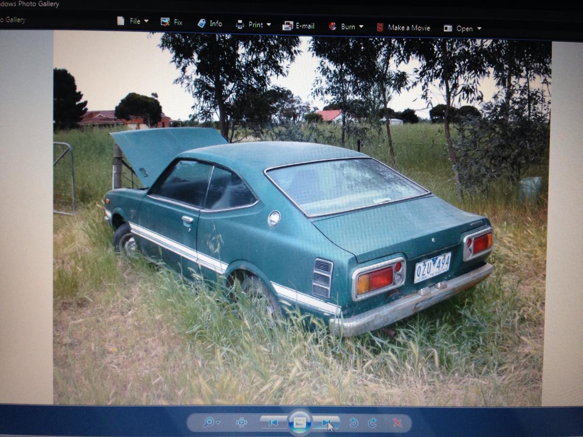

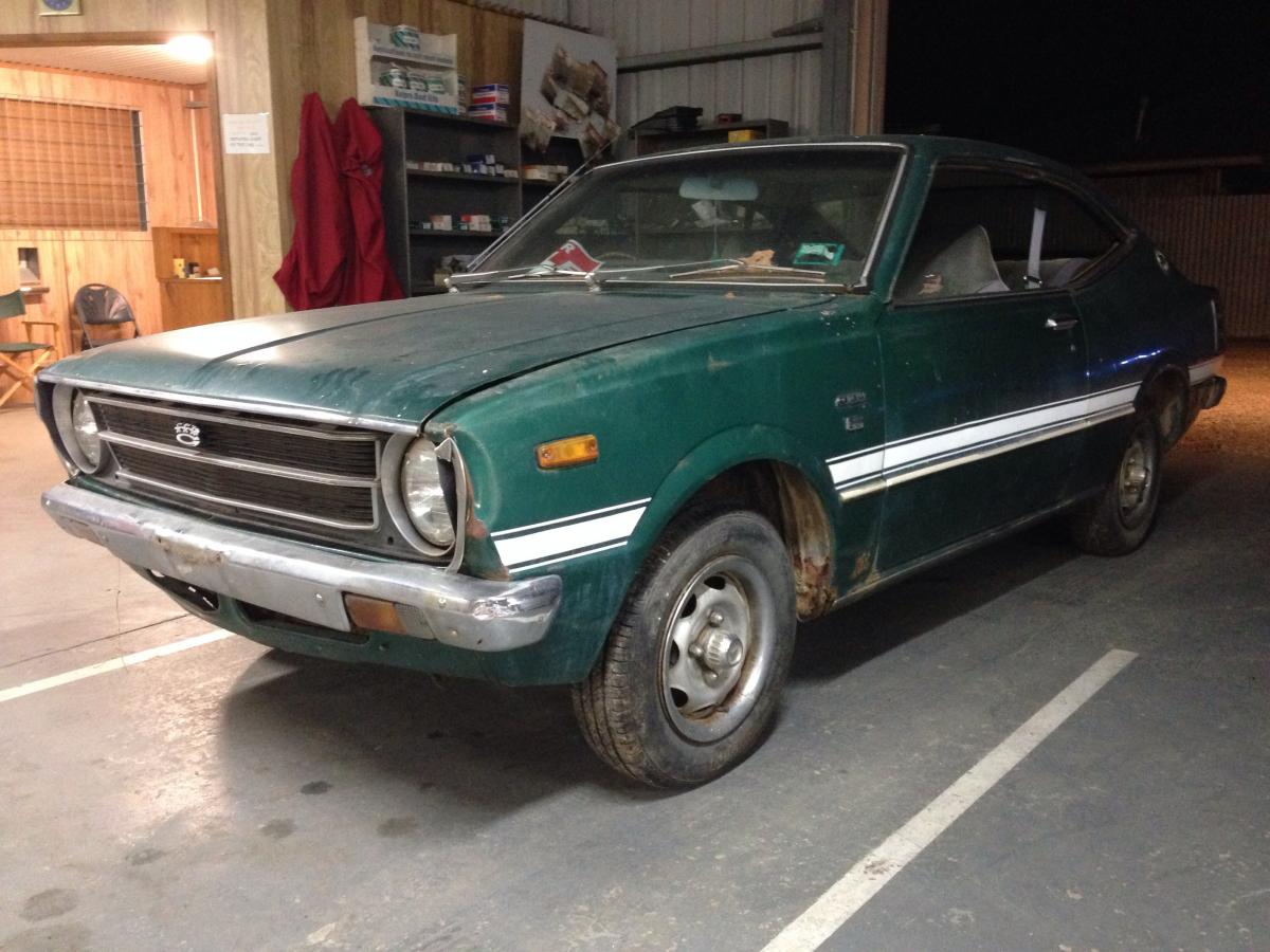

October 8, 201412 yr Author comment_689228 Bought myself a coupe tonight, I'll restore it for a Sunday driver Report

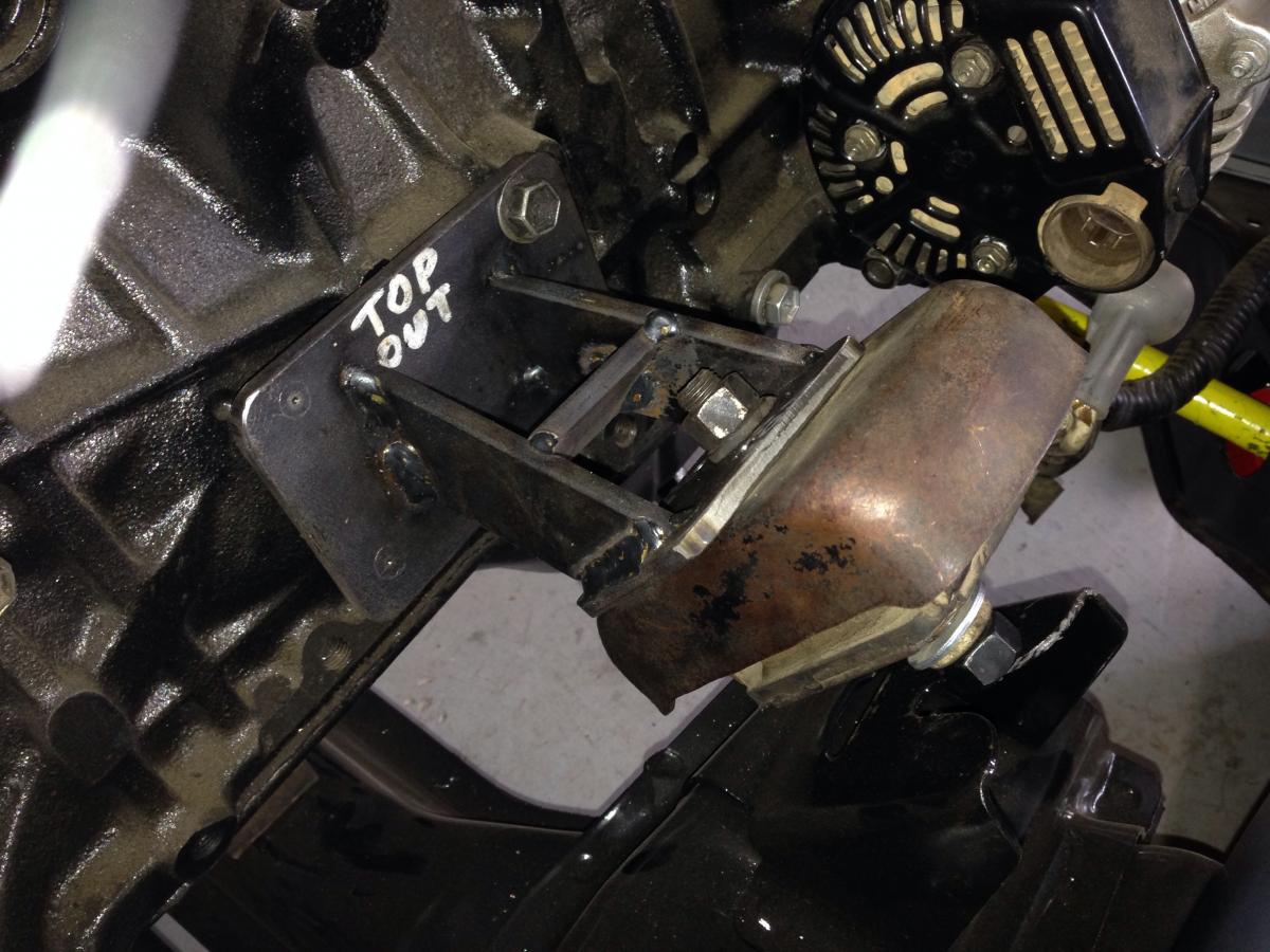

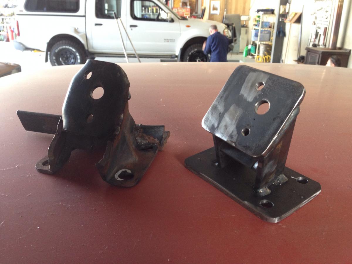

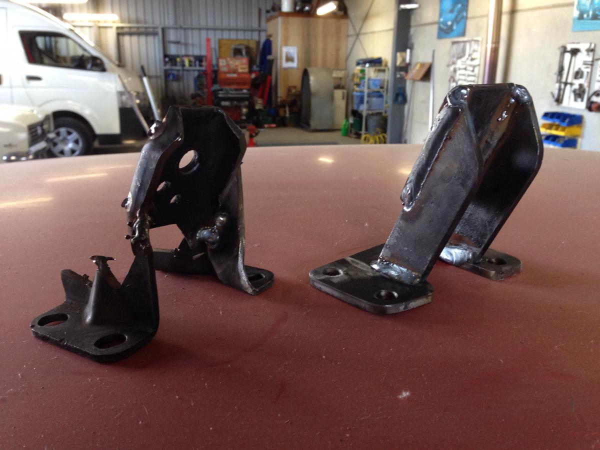

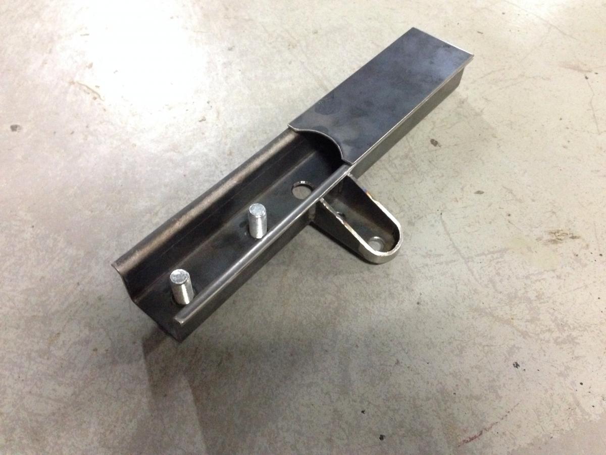

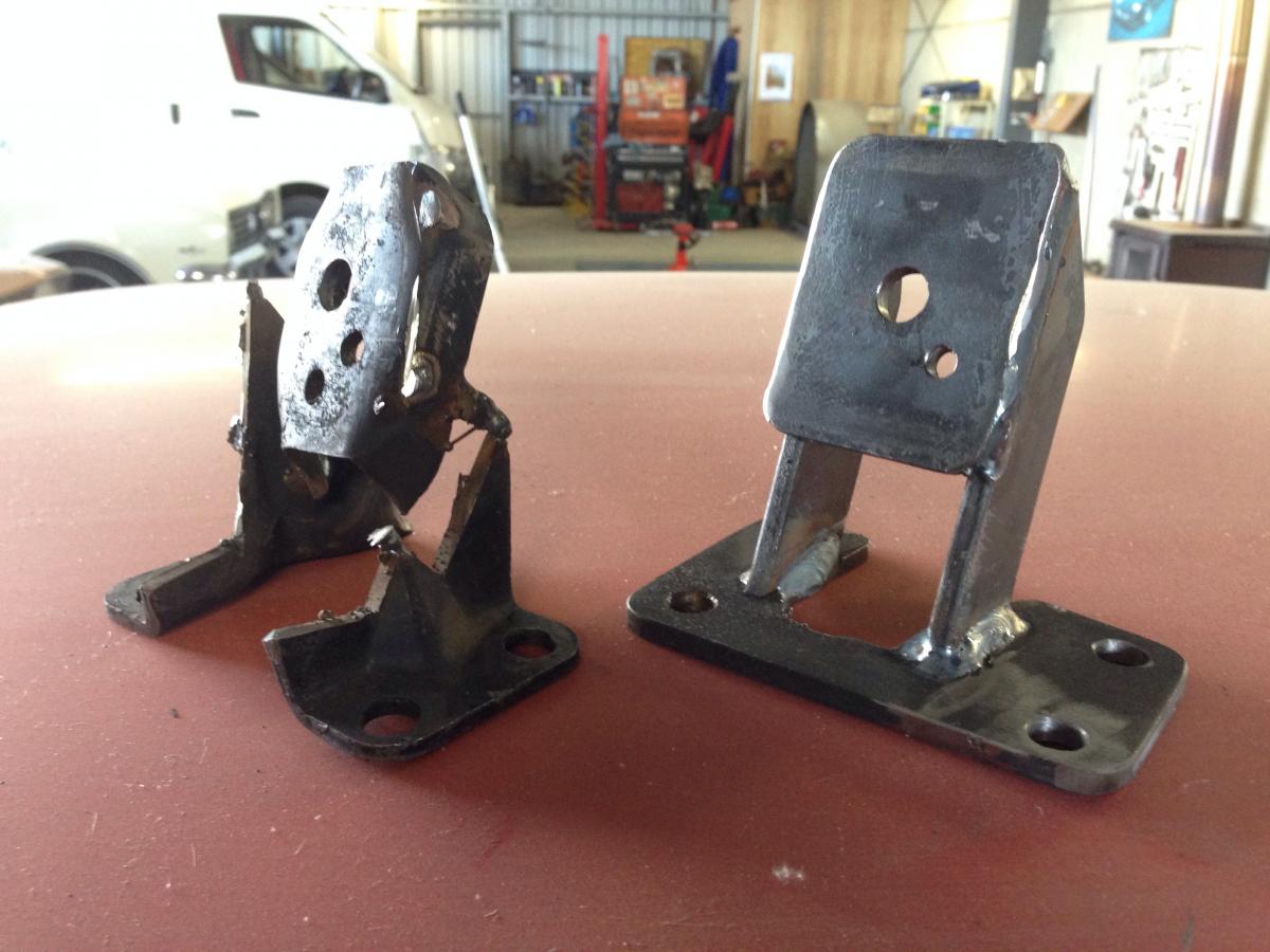

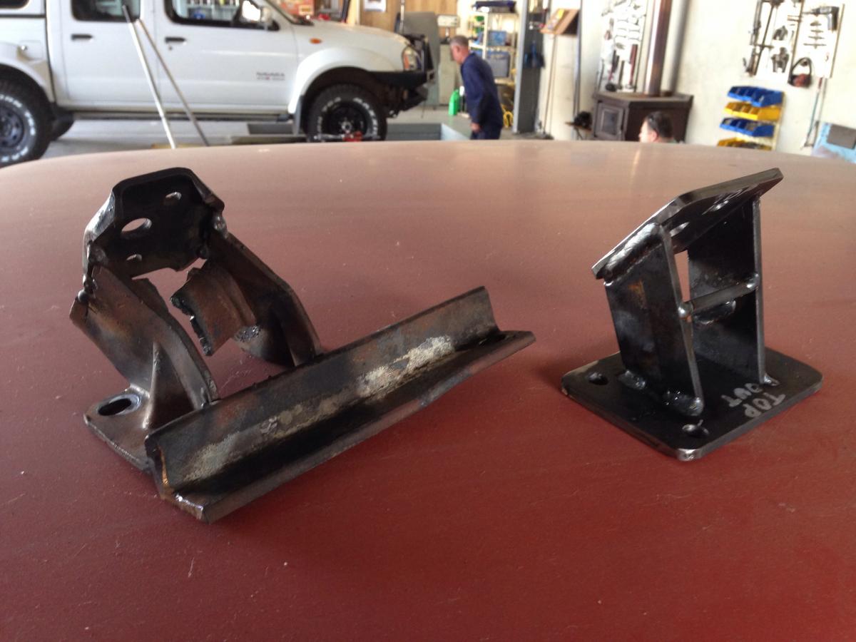

October 28, 201412 yr Author comment_690000 Finally got something done, I now have proper engine mounts, I will start on making the proper gearbox mount this week, I got a quote on the cage getting bent up for me and the supply of the material, now I've just gotta save my penny's, hopefully I can get that done in the next month as long as I don't get anymore bills in the mail, once the cage is bent my brother and I will find a free weekend to notch and weld it, fully tig welded, then it's onto steering column, dash and pedal box manufacturing Report

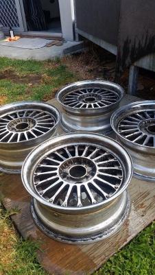

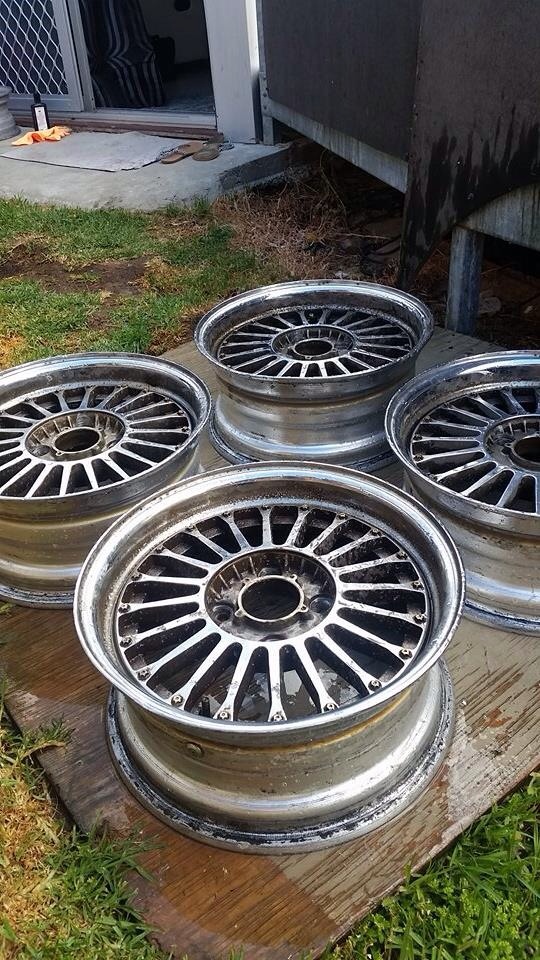

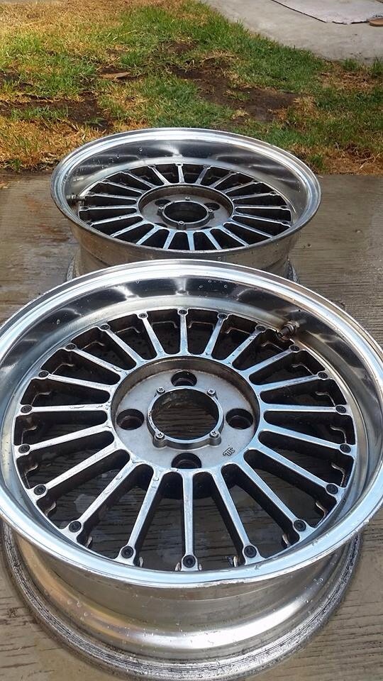

November 8, 201412 yr Author comment_690392 It's amazing how things come to a holt when your broke, was ready to take the car around and have the cage bent up... Then I found these wheels.... So I've got 6 rims heading my way and the cage will have to wait a little longer Report
