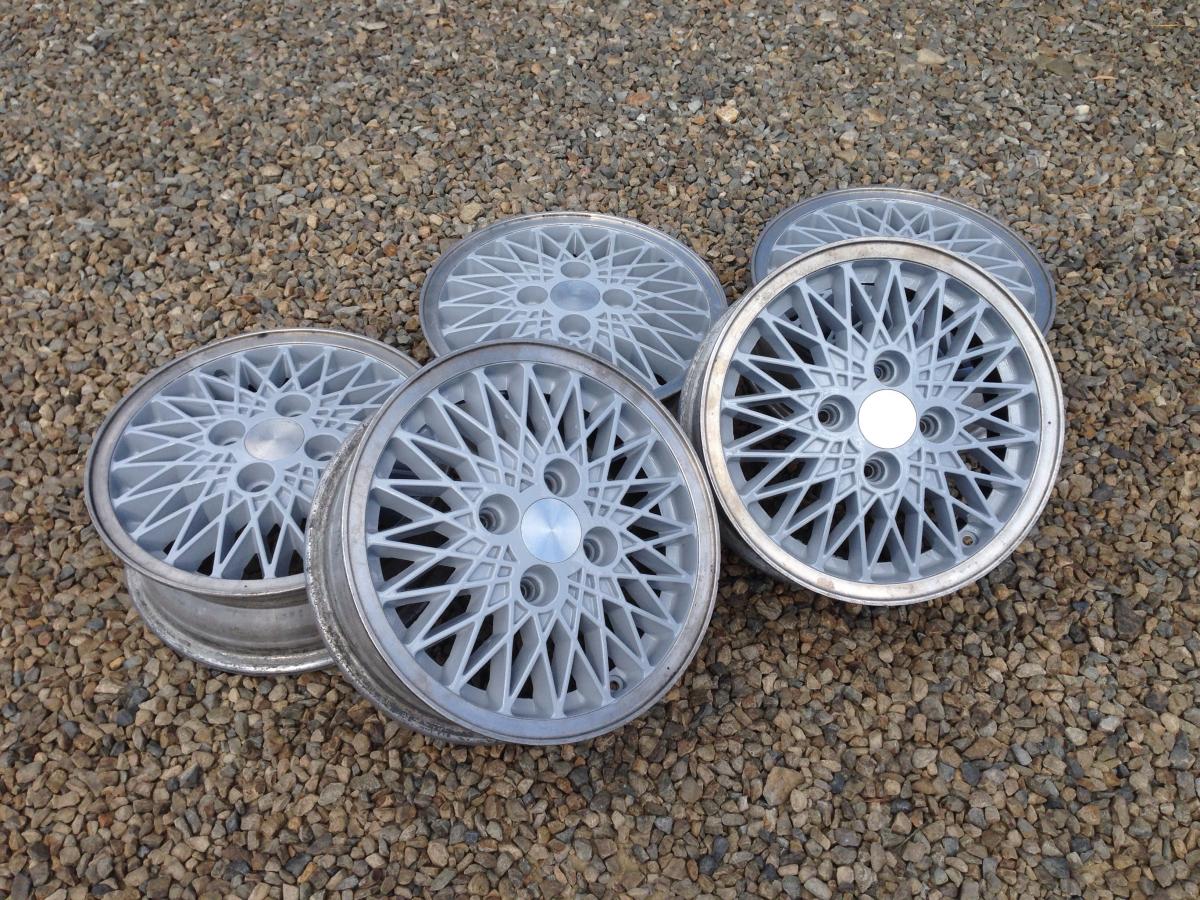

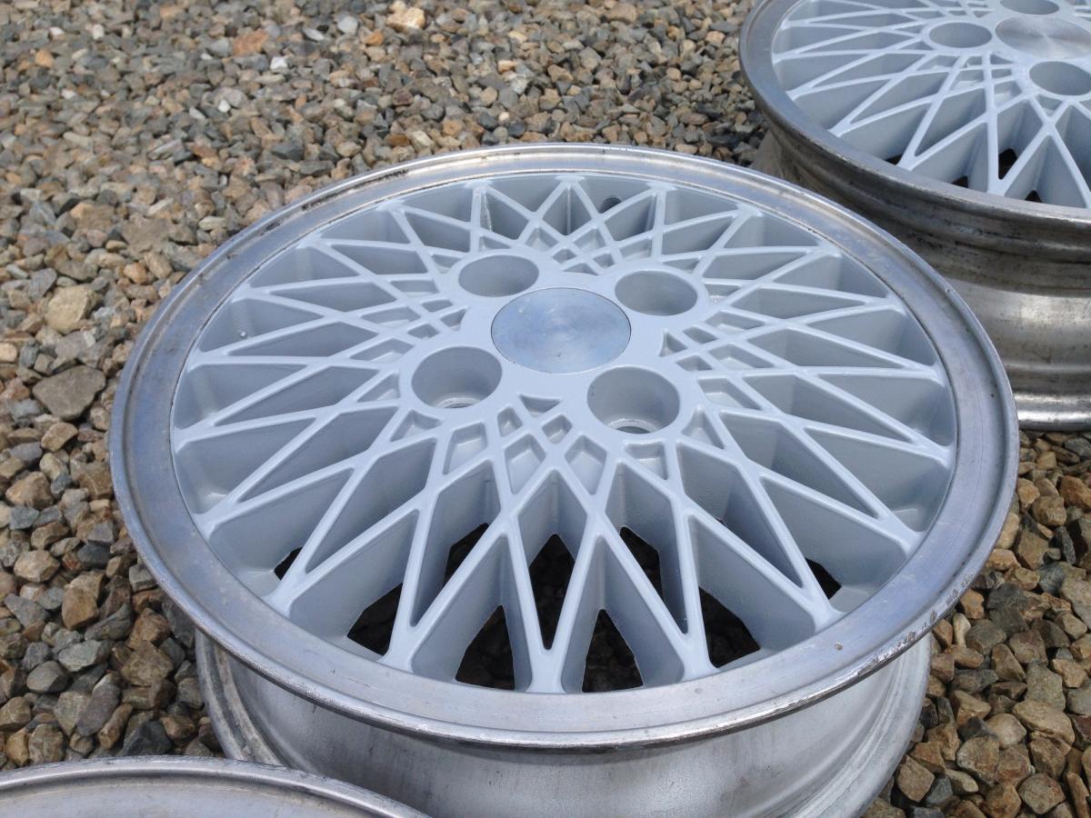

I've also got these for sale if anyone's interested, 15"x5.5" 4x114.3 TRX bluebird wheels, repainted them on Tuesday, no buckles or dints, very minimal gutter rash, billet alloy centre caps (I didn't want datsun caps on my rolla so I made these lol) $300ono located in shepparton Vic

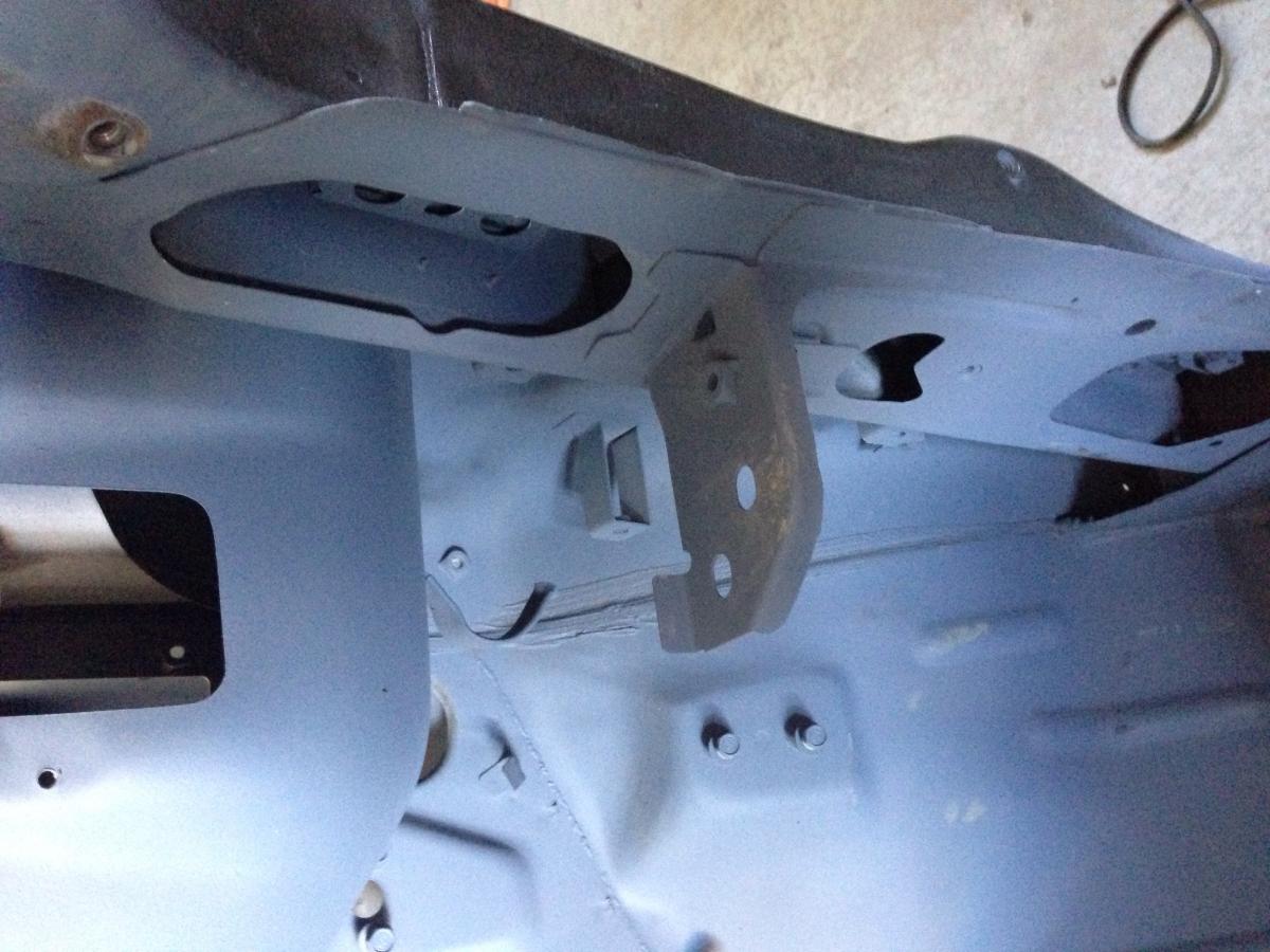

    Well, big day on the car today, extremely happy with the progress, got the welding finished, primer on, chassis blck on and the irs in with the car back on the ground, very exited

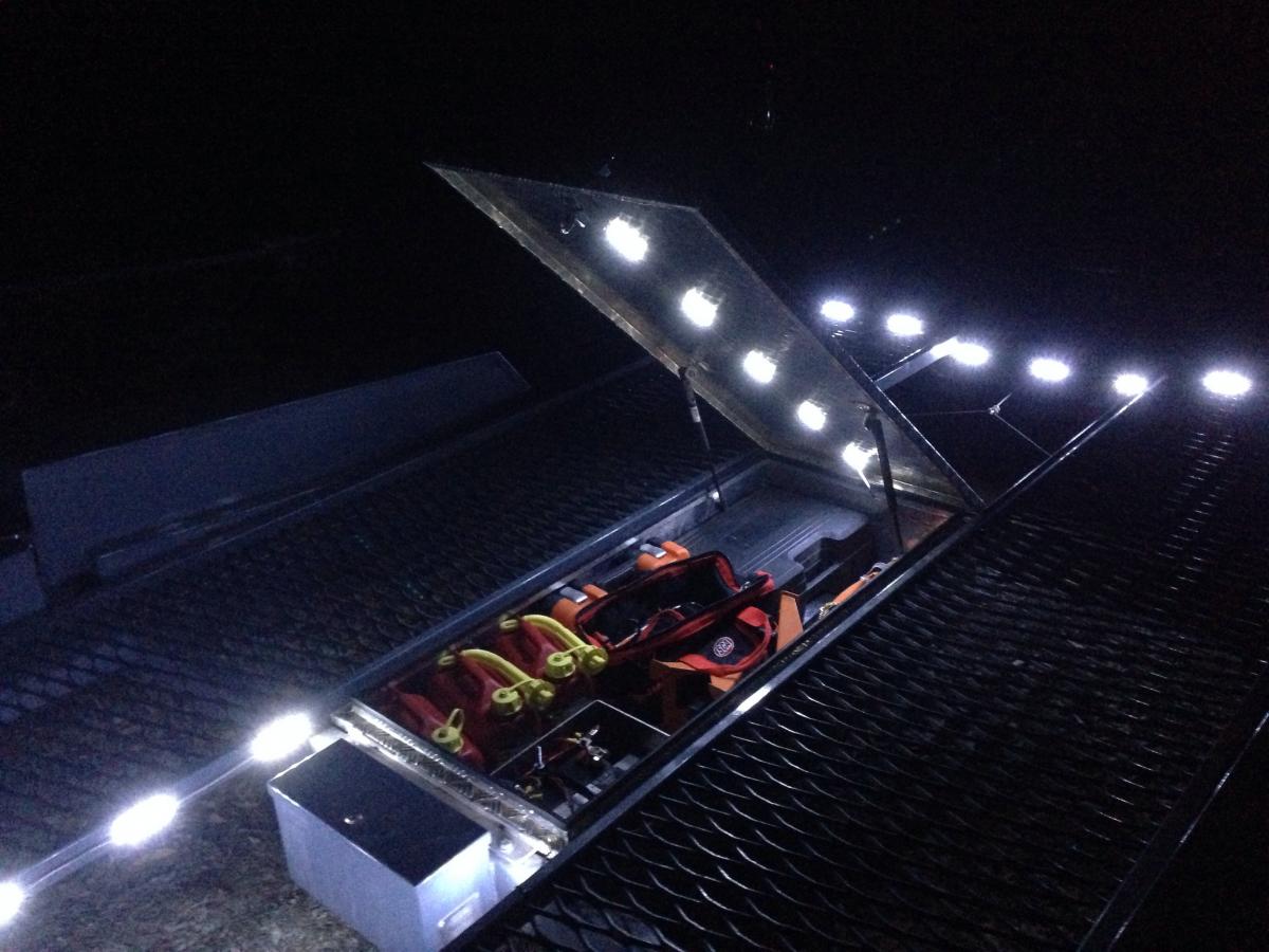

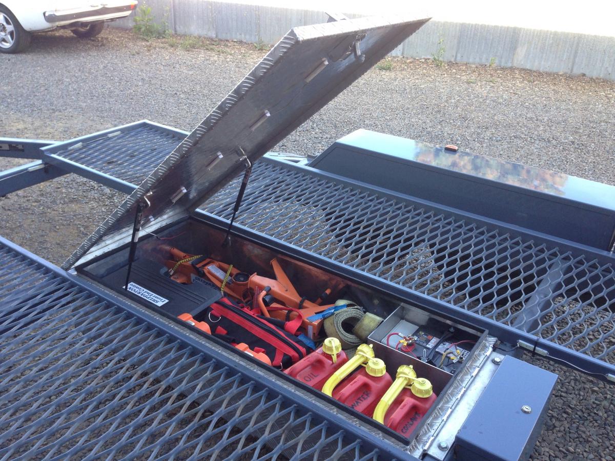

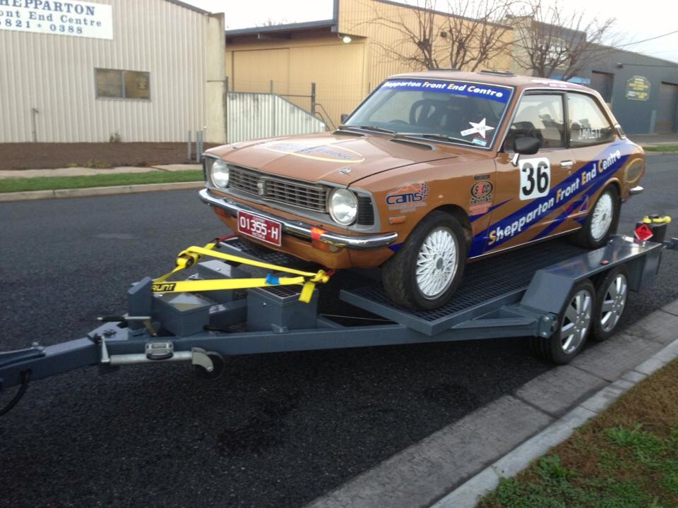

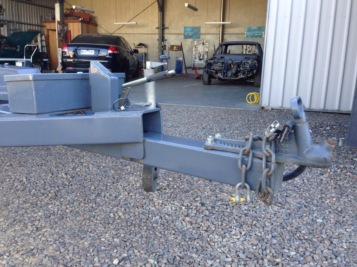

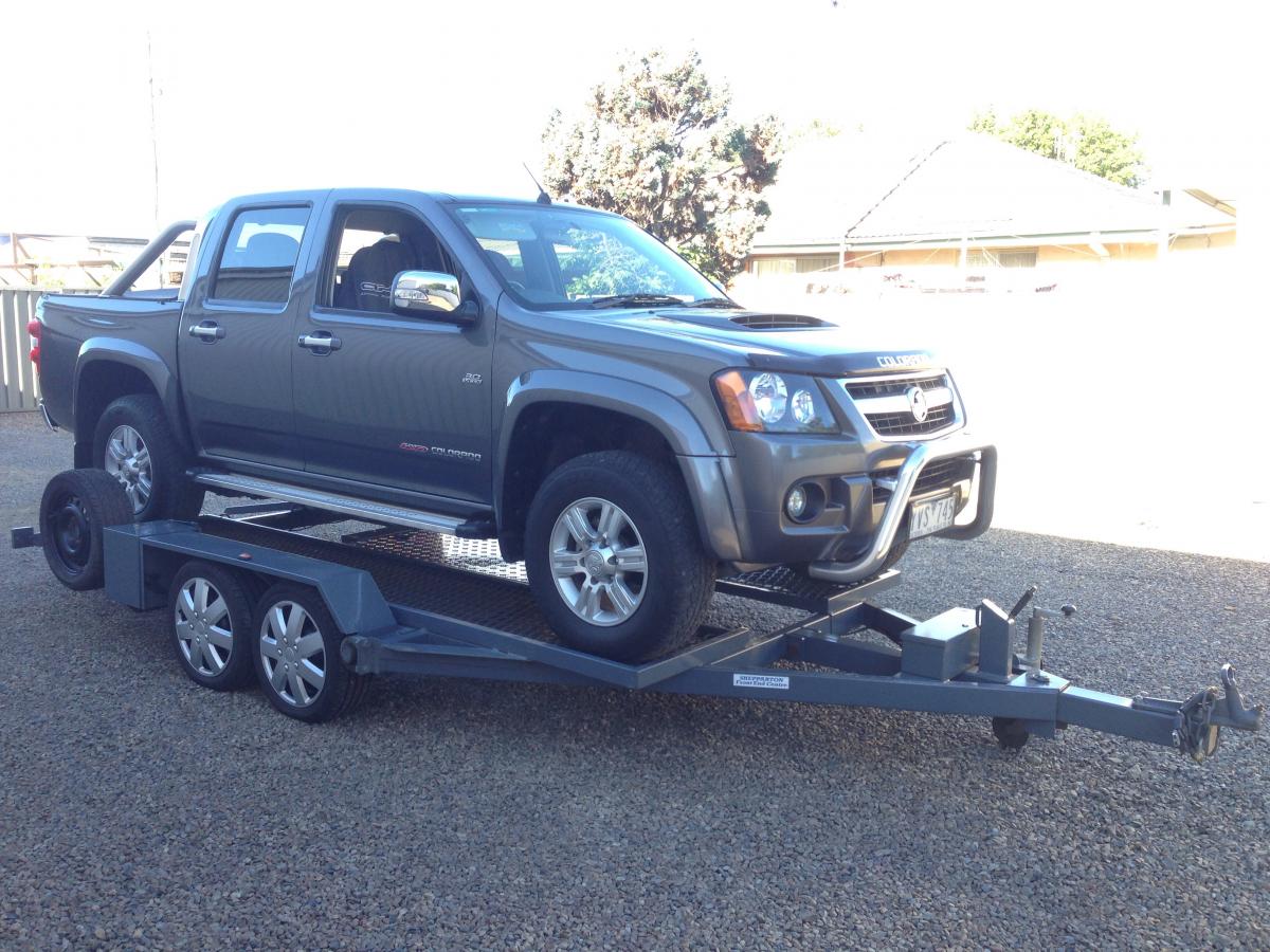

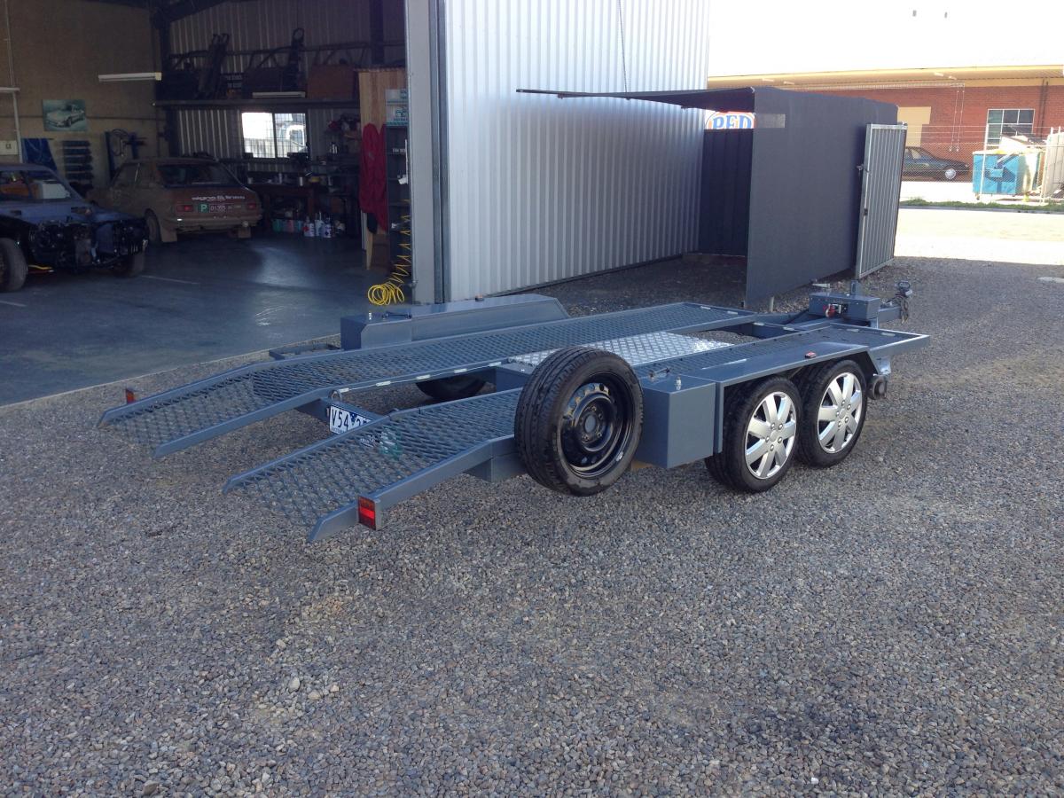

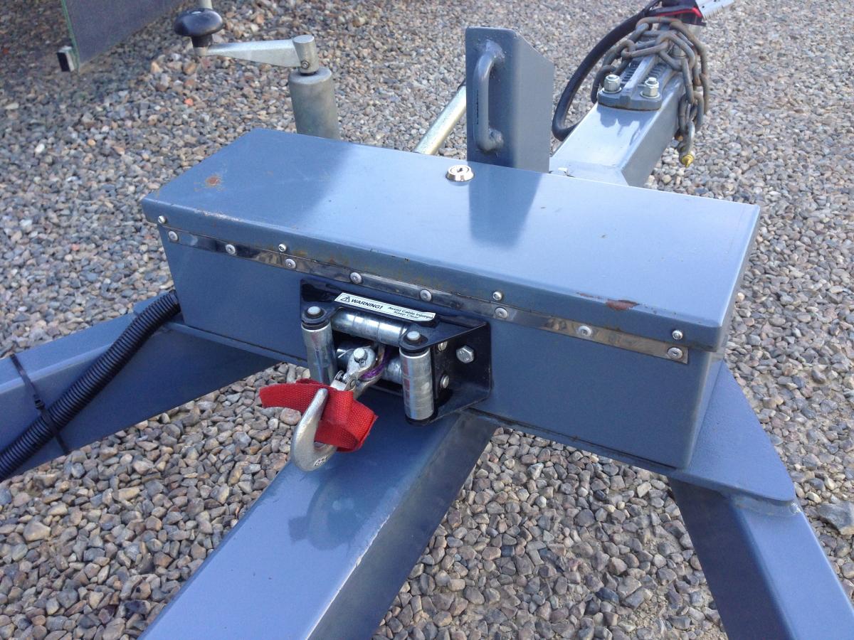

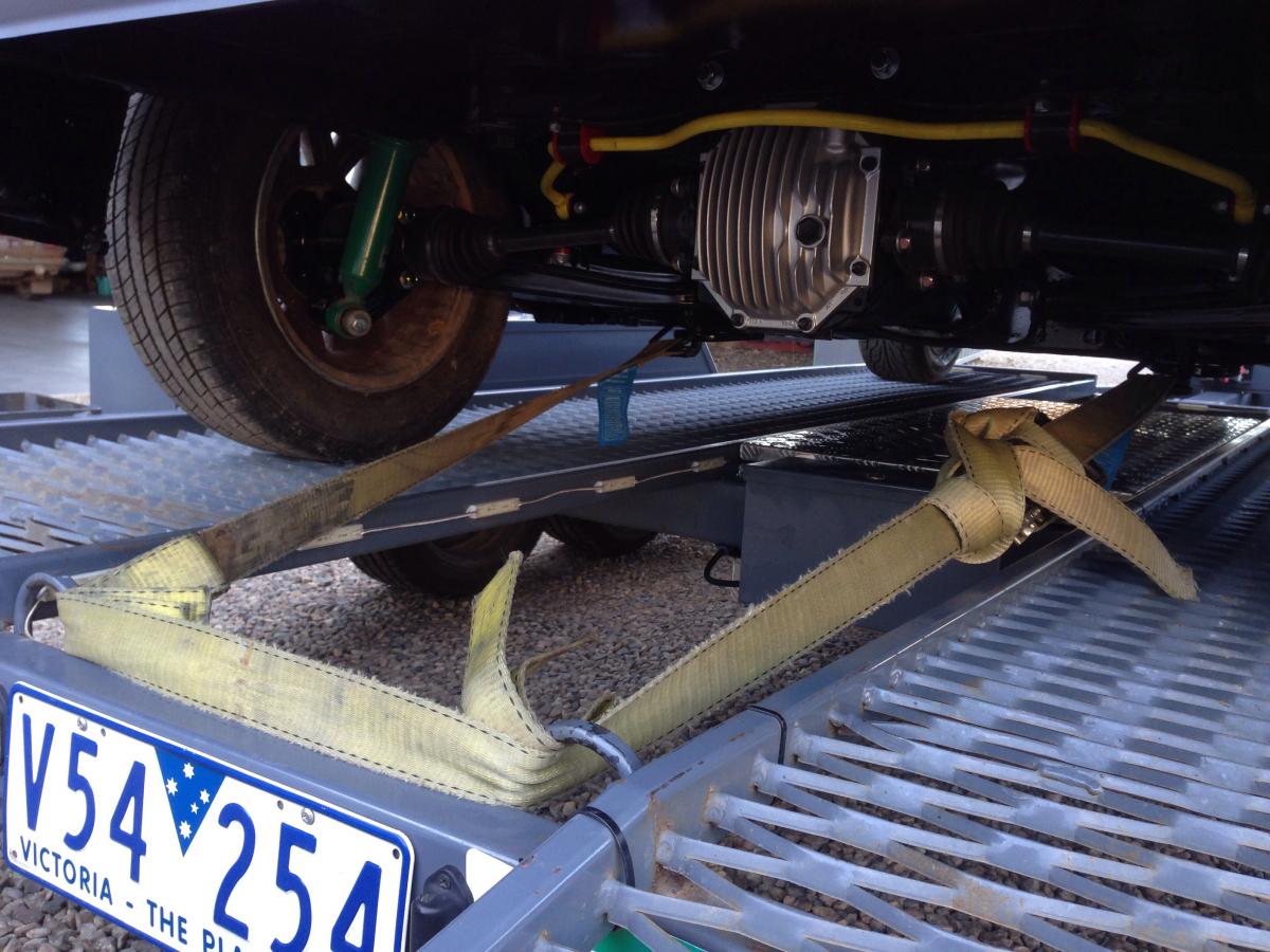

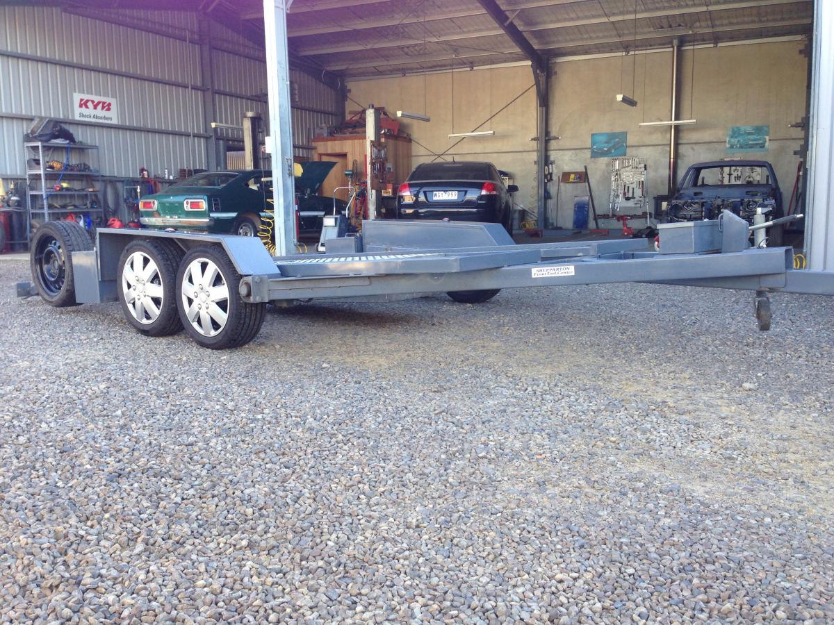

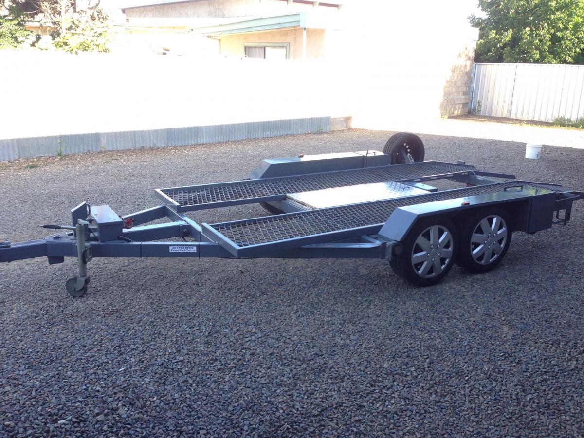

Anyone interested in buying my trailer? I'm gonna build an elclosed trailer
FOR SALE
Air bag tilt trailer
Electric brakes
Electric winch with remote
Twin cylinder compressor
12" firestone airbags
Alloy tool box in the floor (tools not included)
Onboard battery (connects to tow vehicle via anderson plug)
Floor lighting and tool box lighting
All lights are LED
Wireless remote airbag operation
Manual override switches
Tyre rack
Jerry can holder
Spare tyre
15" tyres 80% tread
Brand new spare
Timkin wheel bearings
45 seconds to lower with car
35 seconds to raise with car
Overall length 6m
Overall width 2.5m
Max car wheel track 1,840mm
Min car wheel track 630mm
Max car wheel base 3,300mm
600kg
Rated to carry 2,000kg
Tows very well
The cars I've towed with the trailer and fit well are:
Ke20/30/35/55/70 corollas
Ae93 corolla
TA22 celica
ST162 celica
86 corona
98 WRX
Mazda RX4
Datsun 1600
$6,500 firm
So close to not wanting to sell it, it's a great trailer, I love it but I can't afford to have 2 trailers and don't have the space anyway

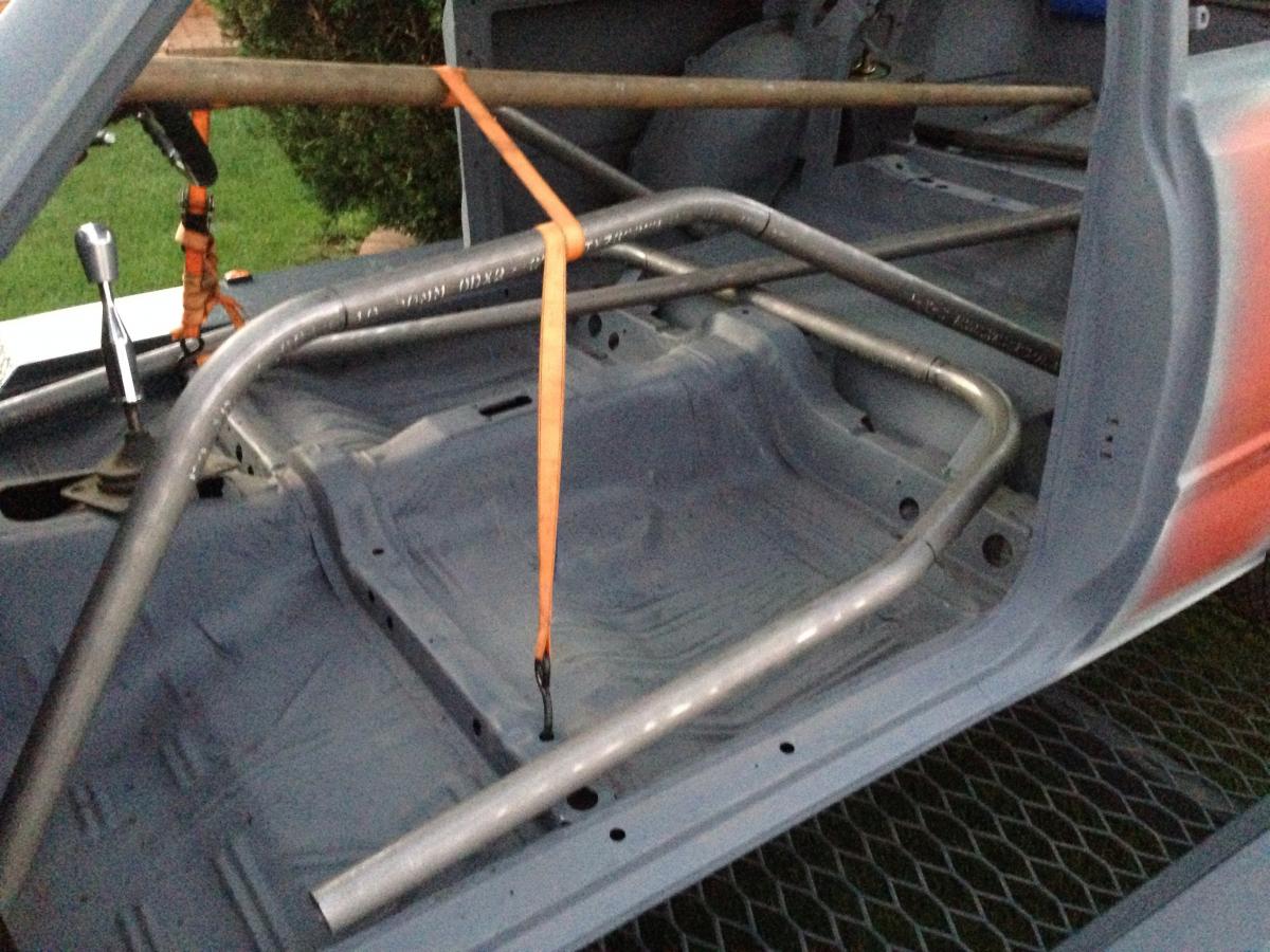

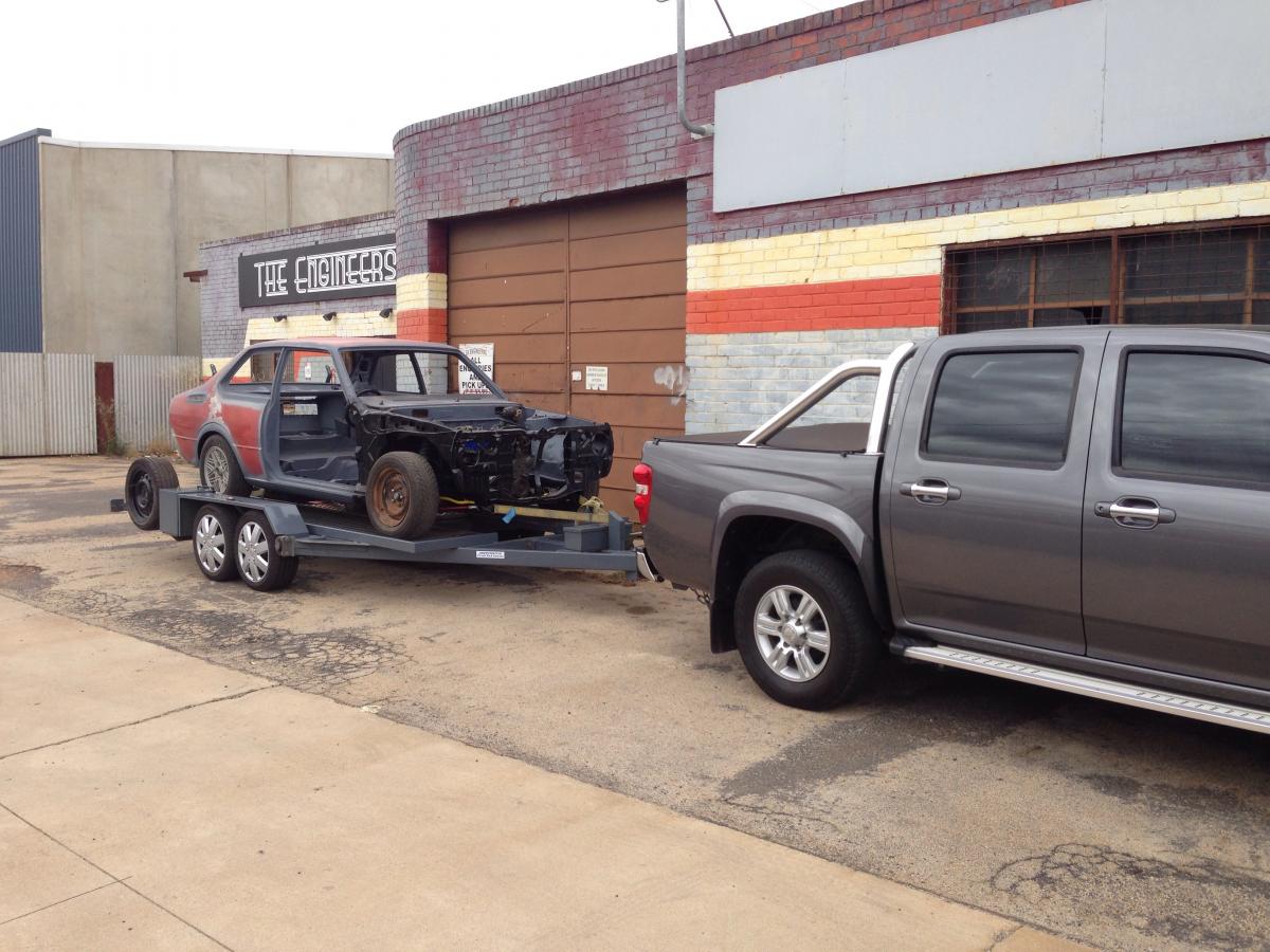

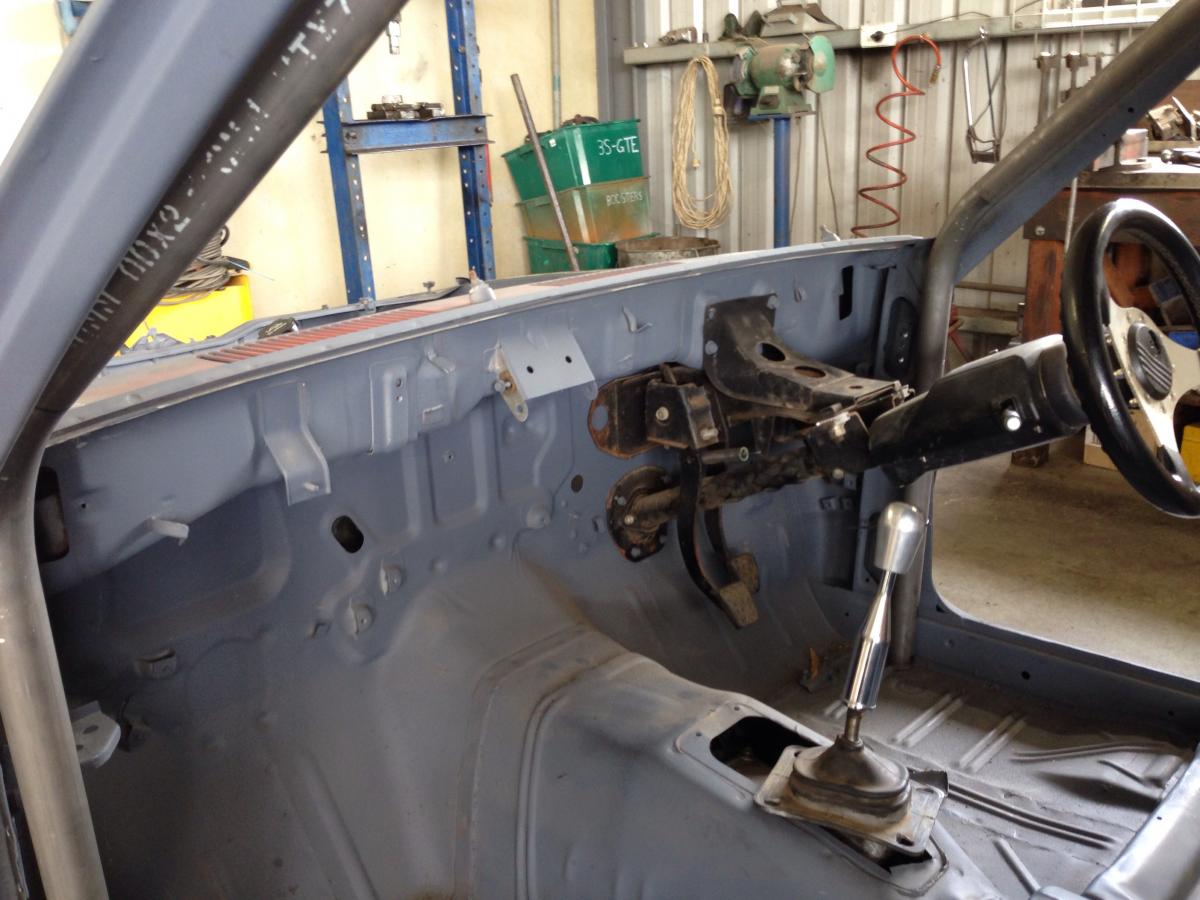

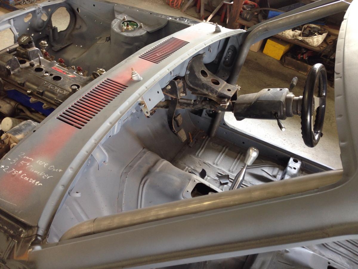

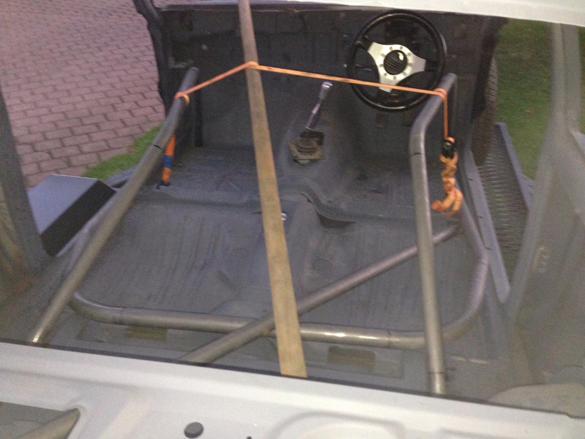

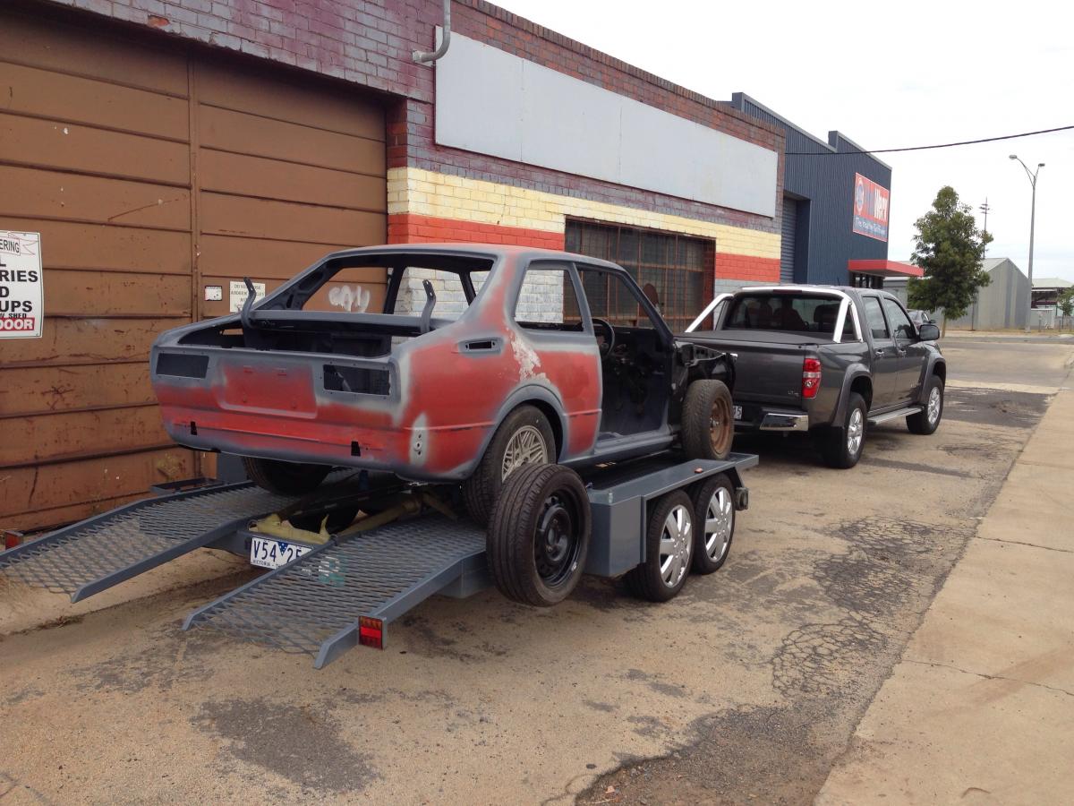

Picked up the car tonight, majority of the cage is bent up, I'll bend up the intrusion bars and seat mounts once the cage is fitted and I am able to work them out properly, I have another 3 7.3m lengths of tube at the workshop, the car weighs 575kg as is minus the parts of the cage sitting in it, the cage material sitting in it weigh 25.5kg. Gotta wait now infill my brother is free to help me with the fitment, he has fantastic tig welding skill unlike me

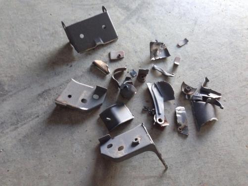

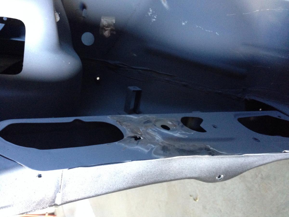

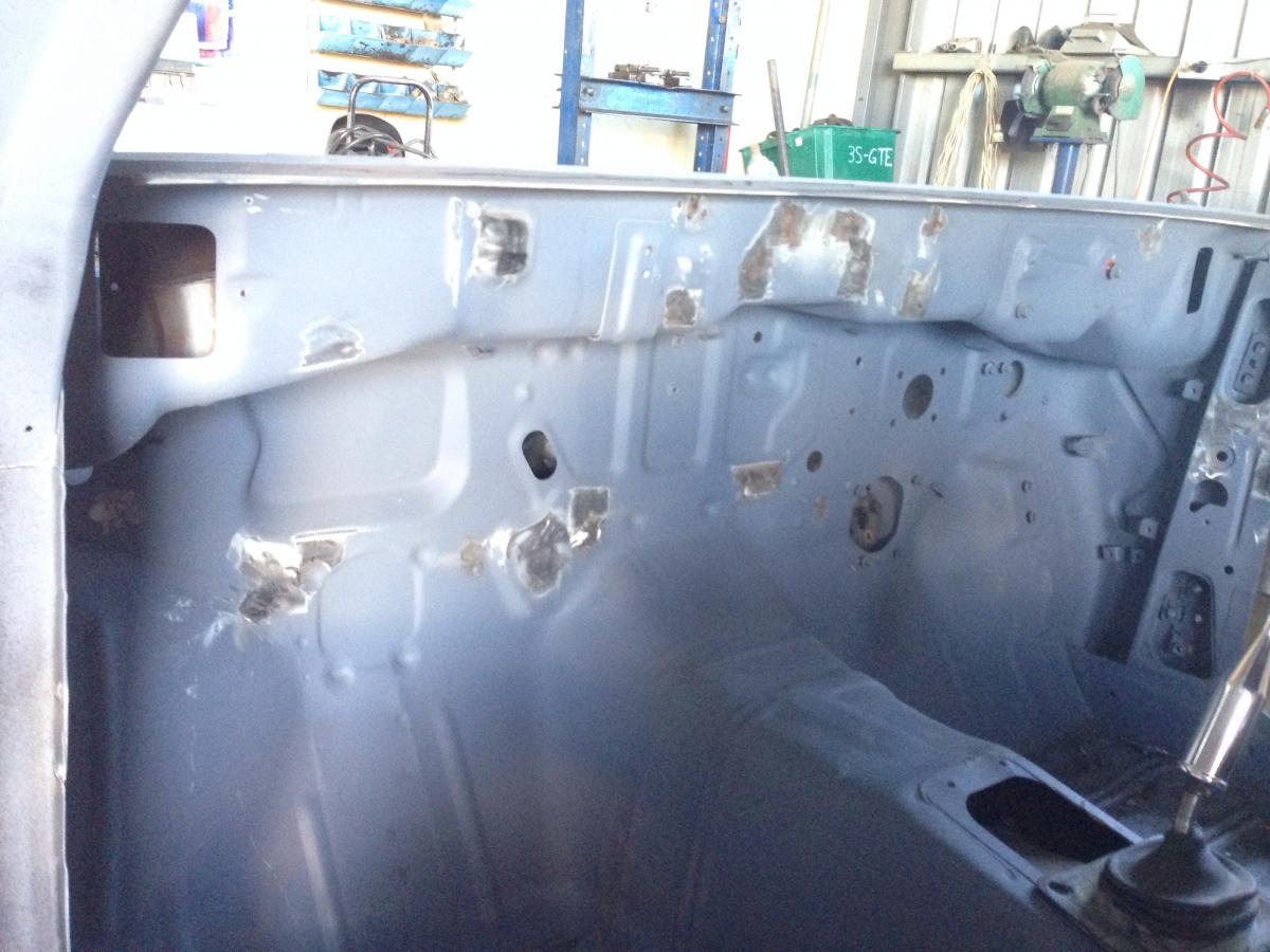

Cut all the brackets and tabs off the firewall, I hate grinding off spot welds
Some of those suckers just crack off with a twist and others think there holding the car together.
What are you doing for a dash?
