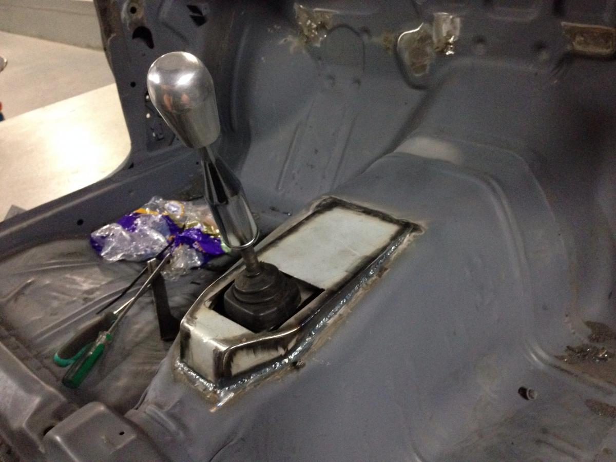

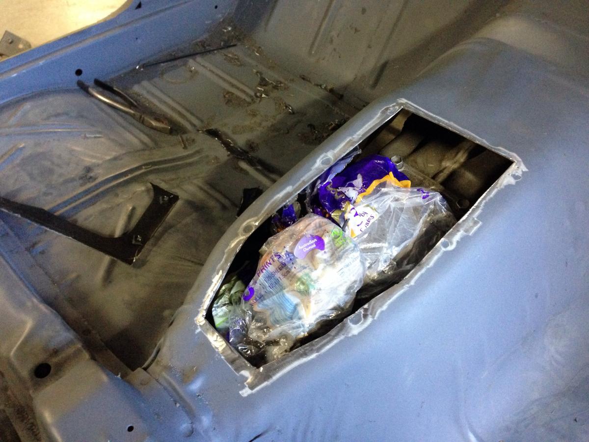

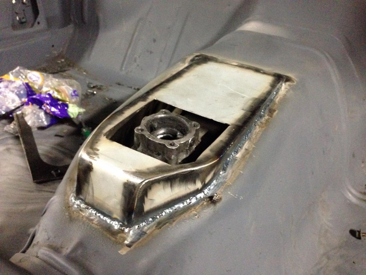

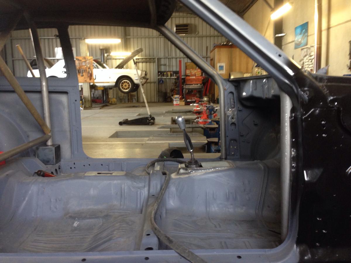

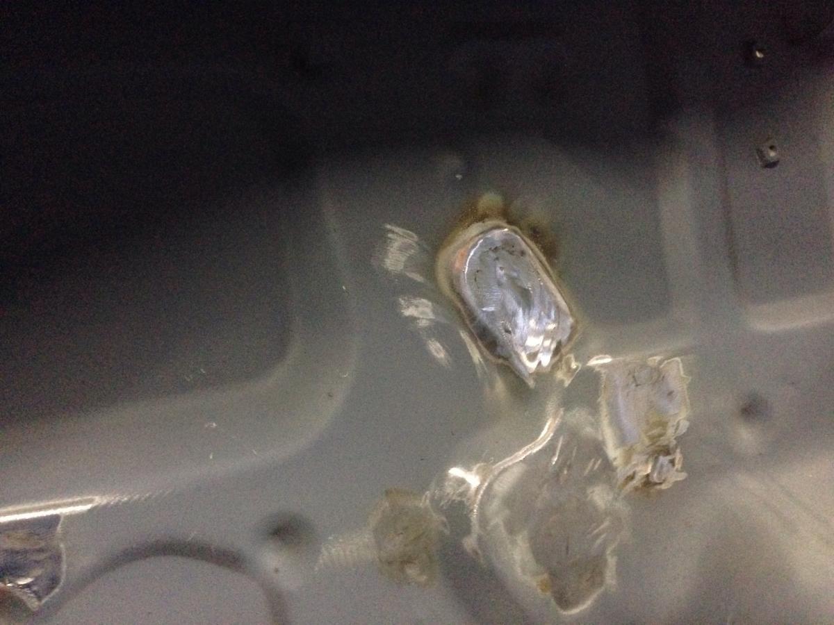

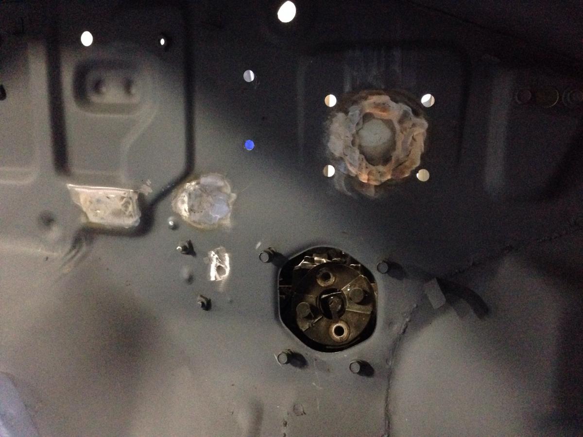

Finished off the shifter hole tonight, been staring at it for months, looks much better now, I've just realized once the cage is in that's about all the cutting and welding on the car done, getting a little bit exited about that
Edited by Tough_little_ke20

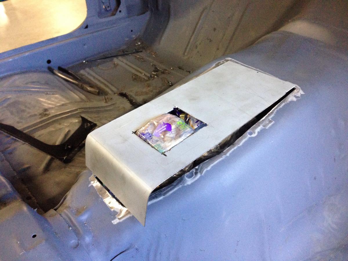

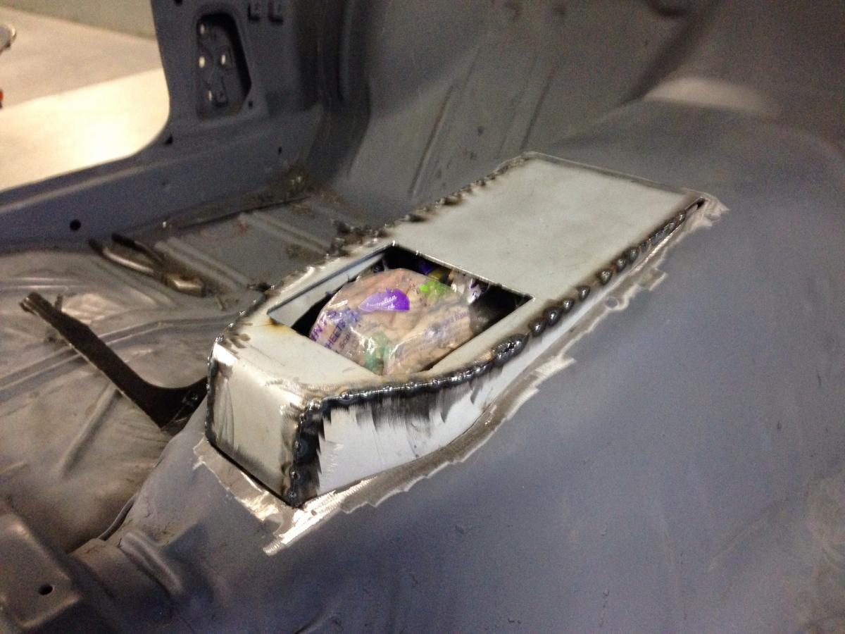

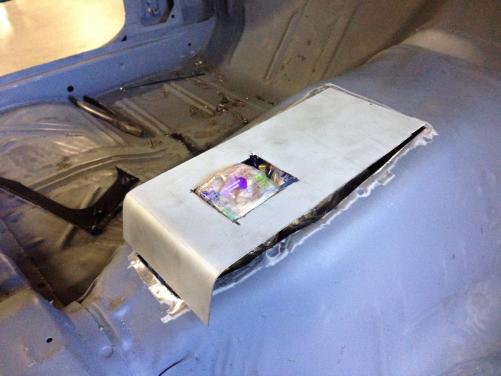

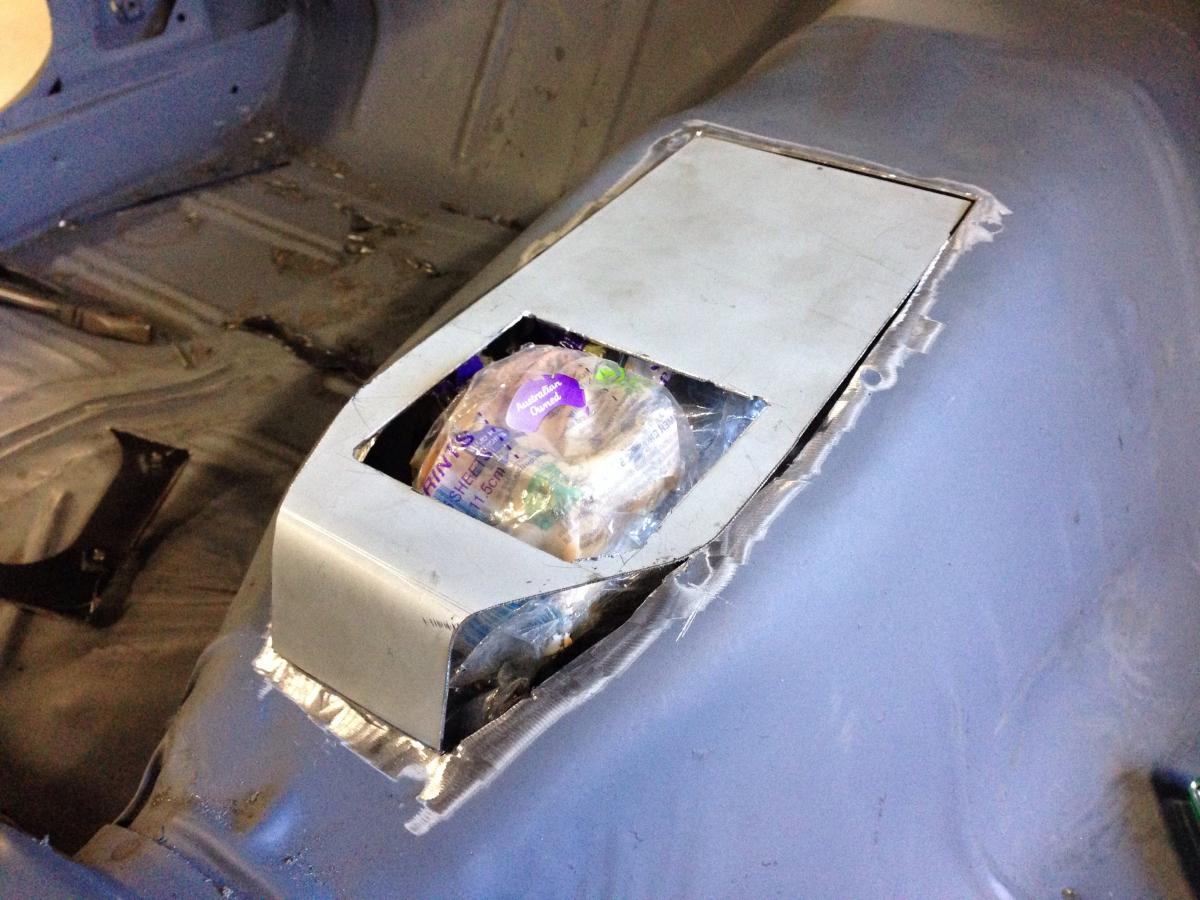

Filled some holes in the firewall, how I've just gotta do all the bolt holes, and then cut a big hole and make a cover for it so I have access to the back of the head and I can pull the dizzy out

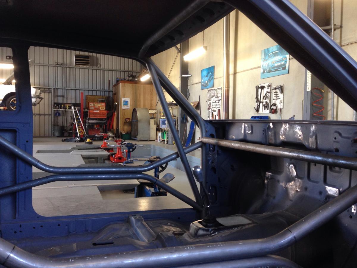

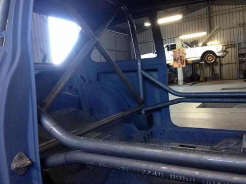

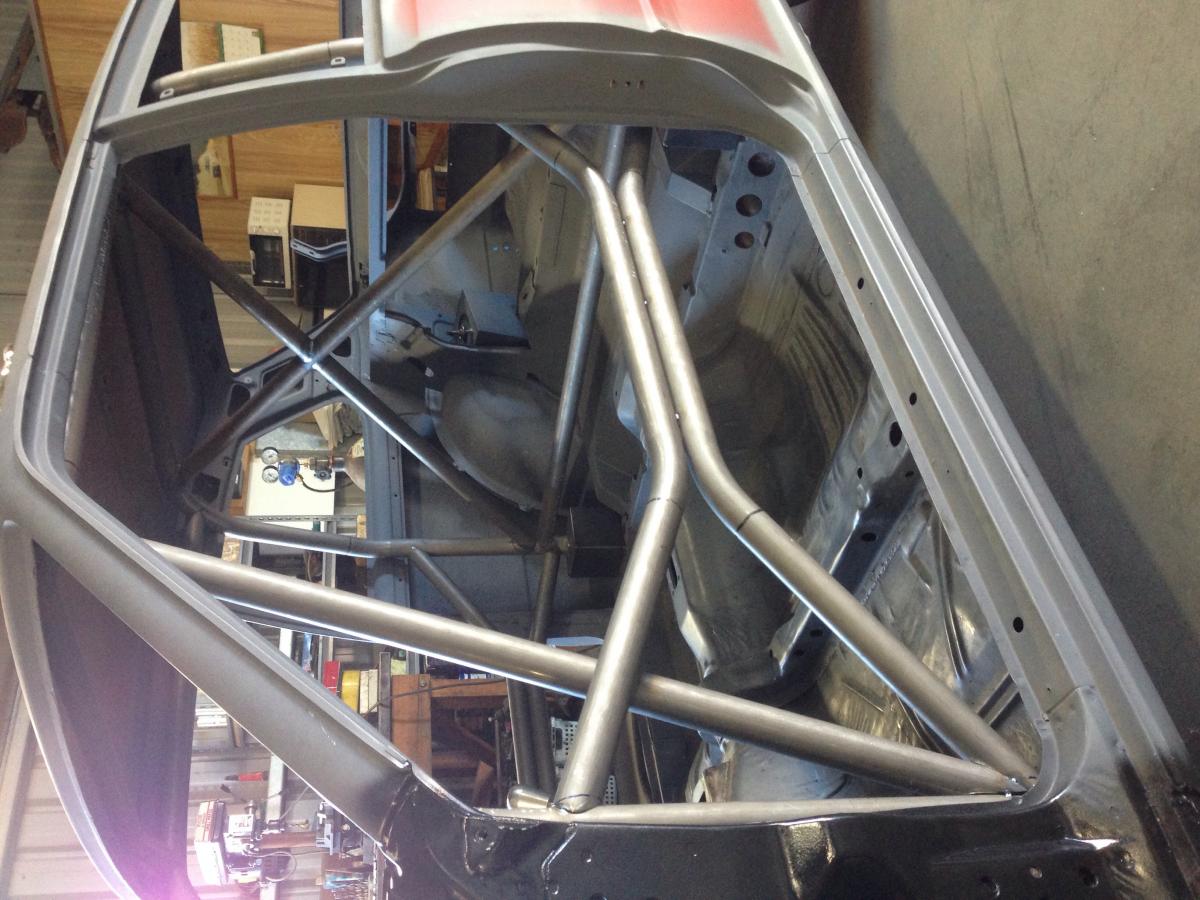

Looking great, Why are the main hoop feet so big?
The bloke that bent the cage said 100mm bases and 120 for the main hoop, after reading reading the cams manual step by step as I build it I saw that it depends on your cars weight and I definetly don't need that big but at least there's plenty of room for welding when I take them out and drop the cage, the front doesn't have them because the legs can go through the floor, the back has lots of layers and the irs so it got the pedestals.

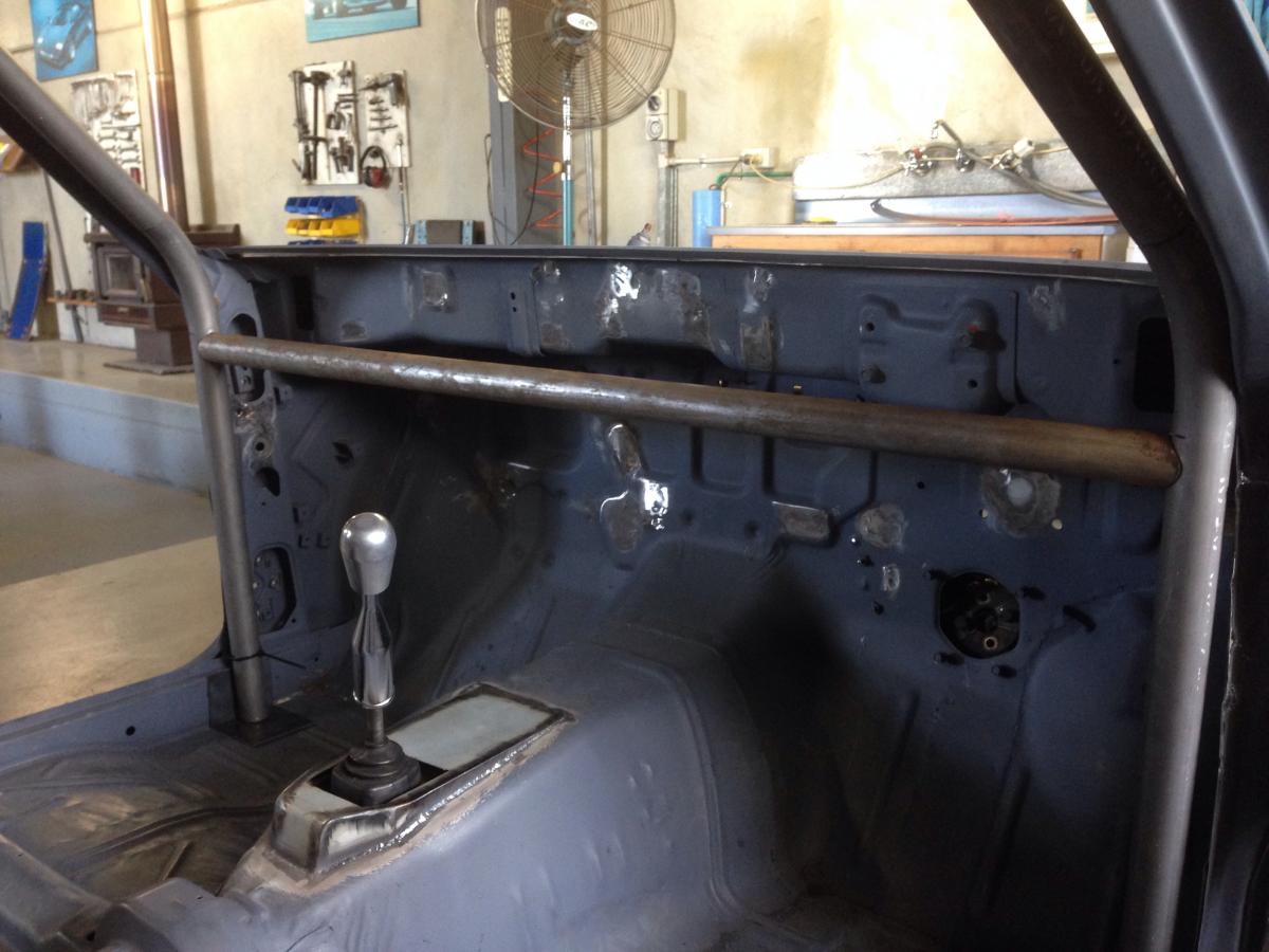

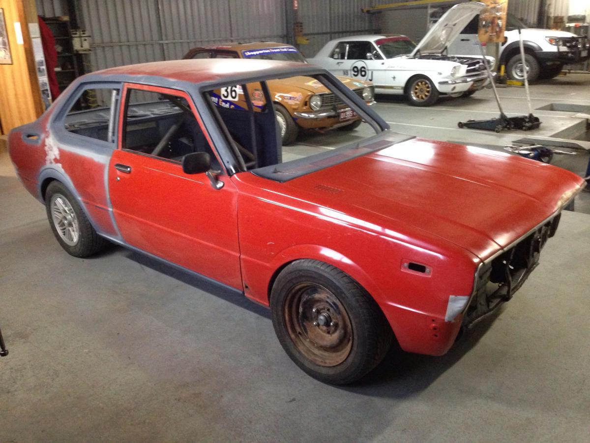

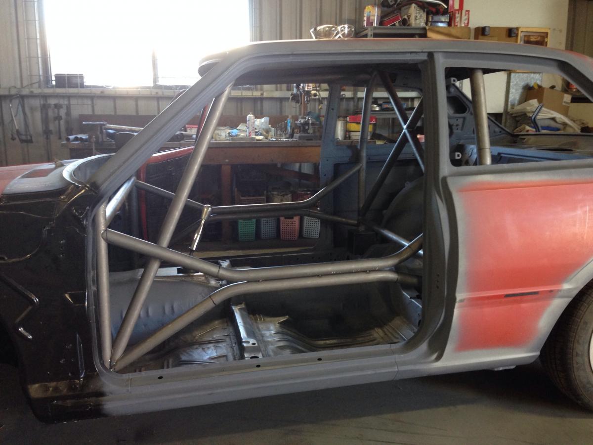

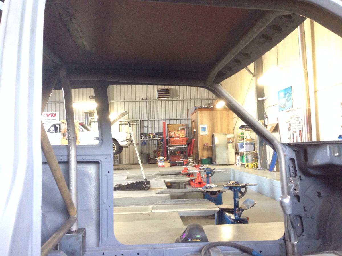

Half laterals, windscreen and dash bars went in today, I'll take the main hoop back out and get my brother to weld it then put it back in and do the roof bars, intrusion bars and weld all that then start the front strut legs

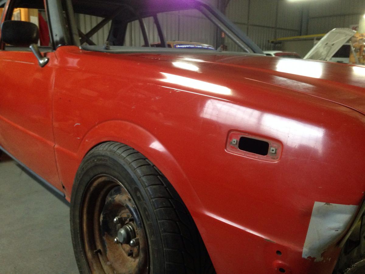

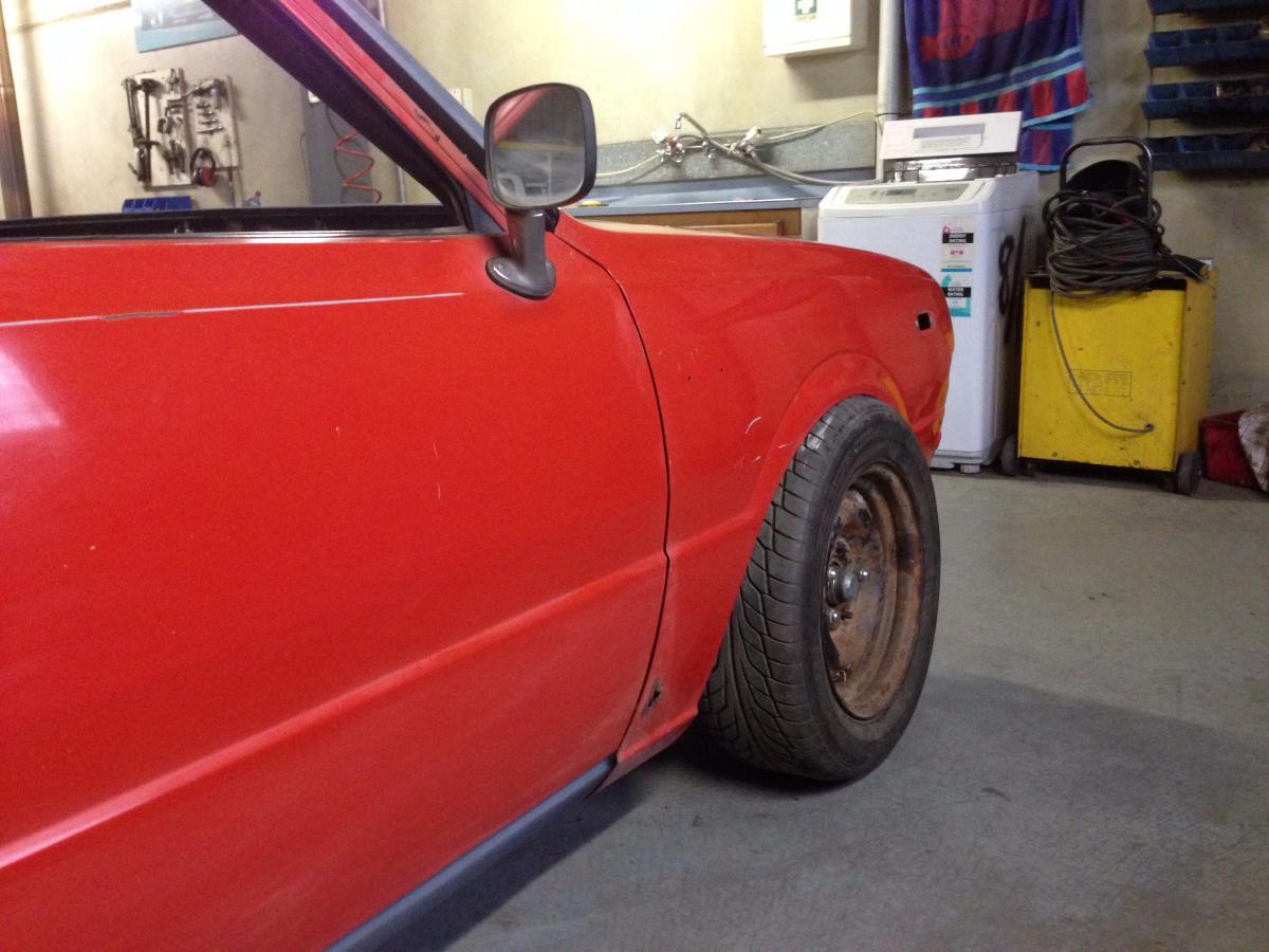

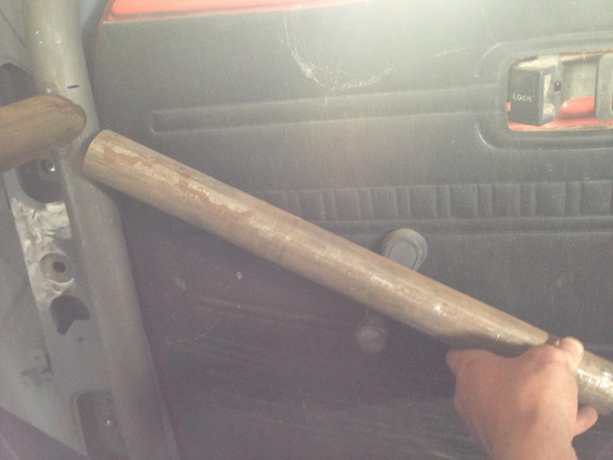

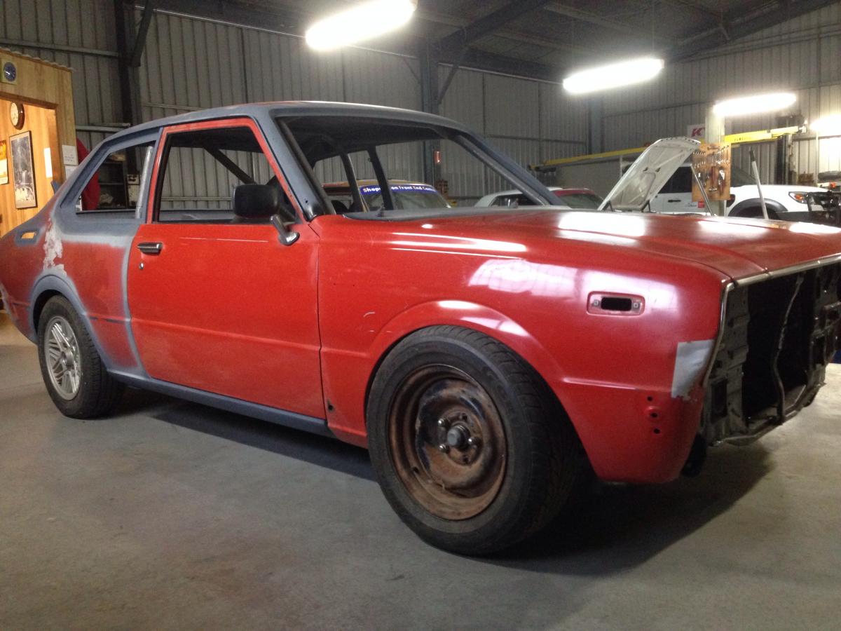

I've finally decided what red to use, original, gave the panels a good polish and I'm happy with that colour, always nice to be original too, even if nothing else on the car is, I've also discovered my intrusion bar will clash with the window winder so I'll put in electric windows, I don't want perspex or fixed windows so that's my best option without changing to a different style intrusion bar

I know nothing at all about rollcages, but couldn't you just angle the bar the other way? So that that's the low end and missing the winder?
Looks like it's starting to come together mate, liking the cage!!

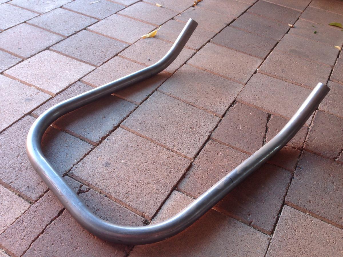

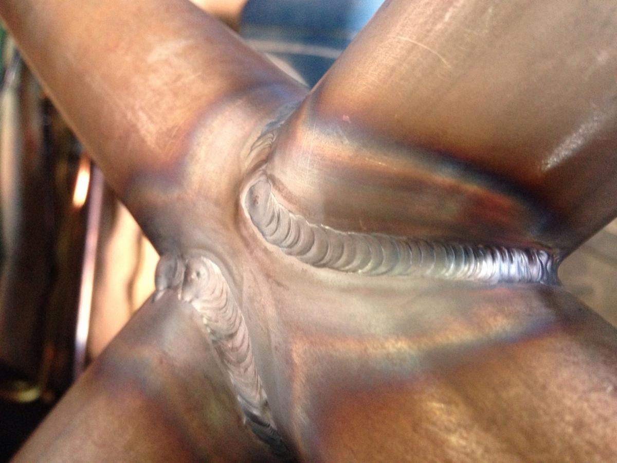

Yep, getting exited, my brothers gonna tig up the hoop tomorrow then I'll make the patterns for the intrusion bars and roof bars and see when I can go and bend them

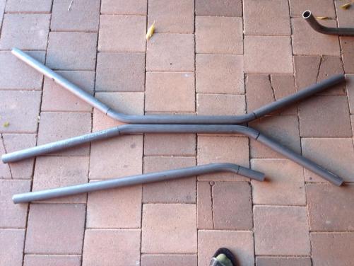

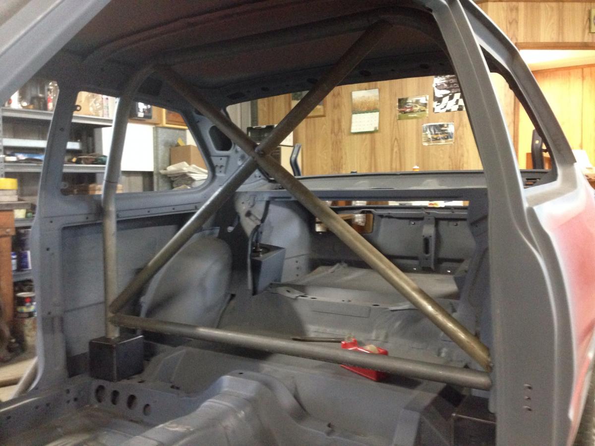

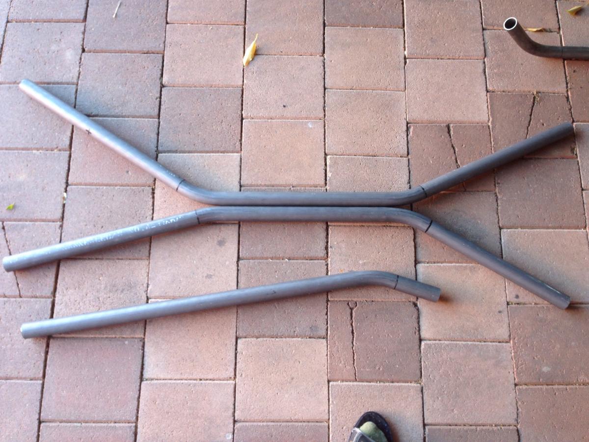

Make some Christmas presents for the car yesterday, bent the intrusion bars and roof bars, and welded the hoop, I've also got a sample for my seat mount. Merry Christmas everyone
Intrusion bars and one Jesus bar in, I'm very happy so far and can't believe I haven't stuffed up any bars yet, I'll do the other Jesus bar tomorrow aswell as the roof bars and half lateral gussets
