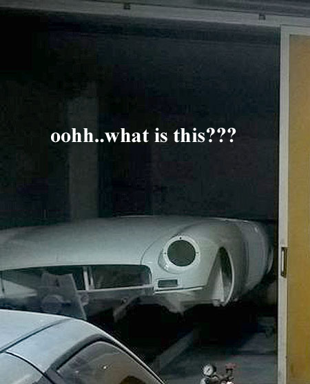

Nice! Not quite a 124 Spyder, or a Lancia, or MGB... but very similar... Something Italian..
It is an mgb ready from paint. Next in line vw ghia
Nice toys!
I suppose you have lots of old cars tucked away in the backblocks of the island just waiting to be discovered and restored.
From time to time will will find those but not so common due to the fact that Malta is small and every one knows each other like so will know what other peoples history.. Maltese people really like cars and the restoring business of cars in these 5 years boomed. The old cars have a special scheme which 30 years over cars are named as classics and only pay 15 aud for road tax and around 150 aud for road tax roughly for a whole year and can only be driven 500 miles. That is good enough for a ride or two each month. So this helped the restoring business a lot.
