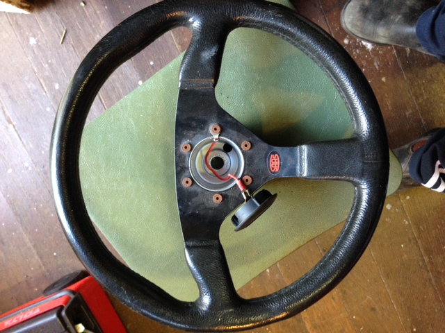

parrot Posted August 10, 2014 Report Posted August 10, 2014 I have this very tasteful vinyl SAAS wheel on my KE25. It seems to fit nicely on a KE11 steering column I have spare, and also my KE15. There is a horn contact screwed to it, removed in this photo. I can't see a brand on the boss. You are very welcome to borrow on long term loan if you wish? I doubt I will ever use it, but you never know. Quote
parrot Posted August 10, 2014 Report Posted August 10, 2014 The interweb suggests that KE2x and KE1x are supposedly the same boss. I note the SAAS catalogue has different part numbers for KE1x (the one you note) and BK40L for a KE2x. http://www.shopsaas.com/pdf/saas_bossKits.pdf I pulled the boss off my wheel and the only markings are the numbers 7005. If you google steering boss 7005, it comes up as a Momo adapter for a 928 Porsche! I wonder if it is coincidence or real. Then you could have a fancy Celica twin cam wheel on the AE95 and a Porsche 928 wheel on the Sprinter! Quote
silverra23 Posted August 10, 2014 Author Report Posted August 10, 2014 Well at least I am not going mad if others have had the same issue! Feral4k saas may well have changed which pattern they use over the years. Momo spec is different to Nardi spec for instance. Parrot I will pm you. The borrow will be a good place to start - wanted to do something easy just for winterfest and it's so far not gone to plan! Quote
