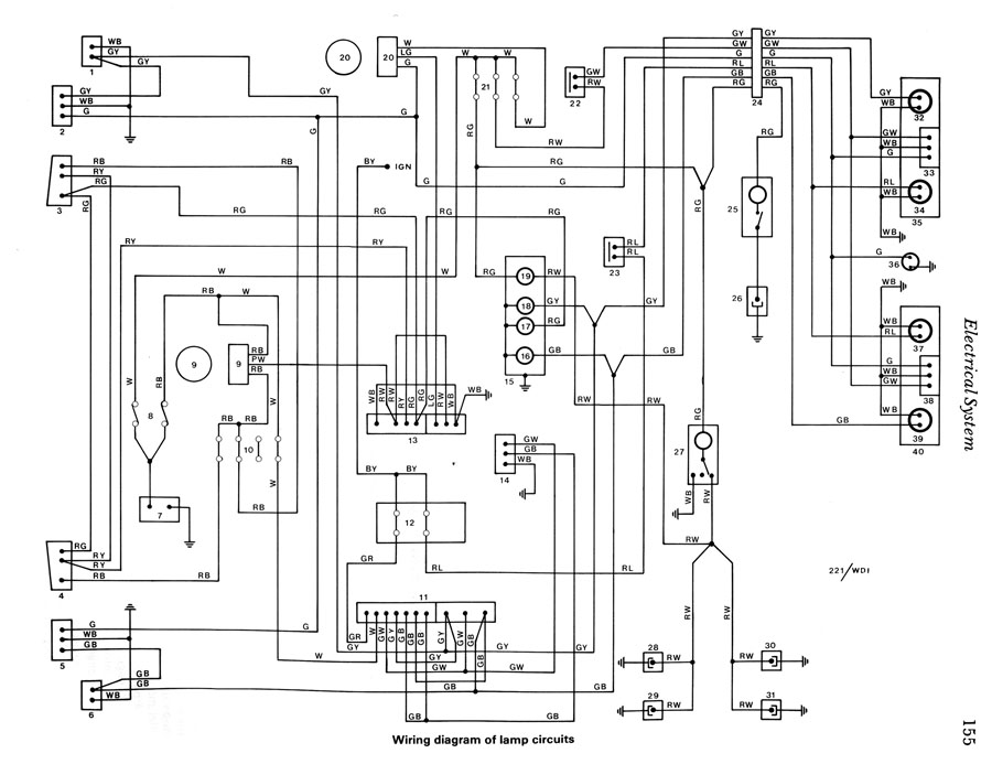

altezzaclub Posted October 15, 2014 Report Share Posted October 15, 2014 (edited) Measure the resistance with a $10 multimeter from Supercheap.. Motor or anywhere directly to earth should be less than 1ohm. You could meaure from that fusebox to the battery -ve with a bit of extra wire and that will tell you the overall reistance. Wiring diagrams- Trace the power from headlight switch to everywhere and back again. Corollas supply 12V to the headlight bulbs via the COM wire and then earth each filament individually back through the dipswitch. If the dipswitch is crap the headlights don't work. There might be some usful info in The Girls KE70 here- http://www.rollaclub...the-girls-ke70/ hmmm.. quality is not there for the diagrams. PM me an email address and I'll send them over. Edited October 15, 2014 by altezzaclub Quote Link to comment Share on other sites More sharing options...
