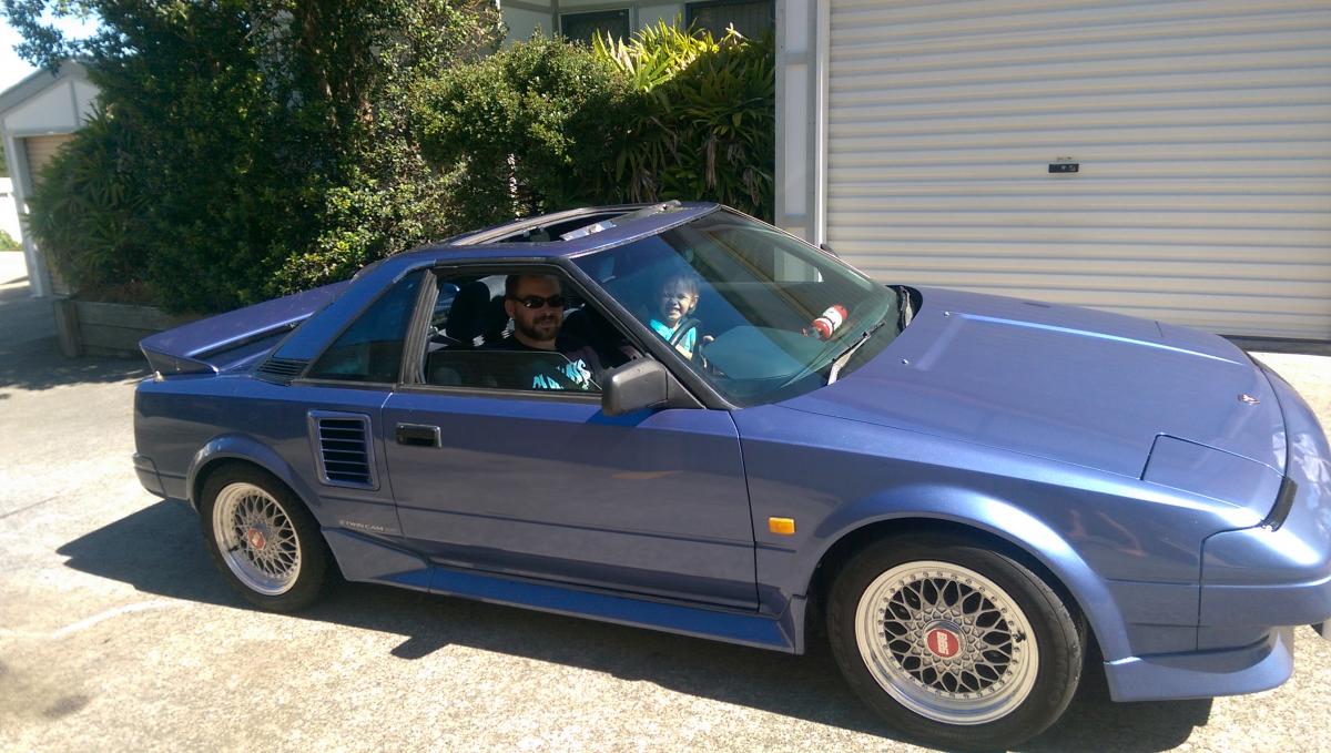

But good news, detailed it, threw my daughter in the passenger seat and went for a spin. It's driving and sounding great.
Loving the pop put sunroof. There was a lot of what I thought was faded vinyl but it just turned out to be human scum and it cleaned up pretty well. I'll have to grab some interior pics.

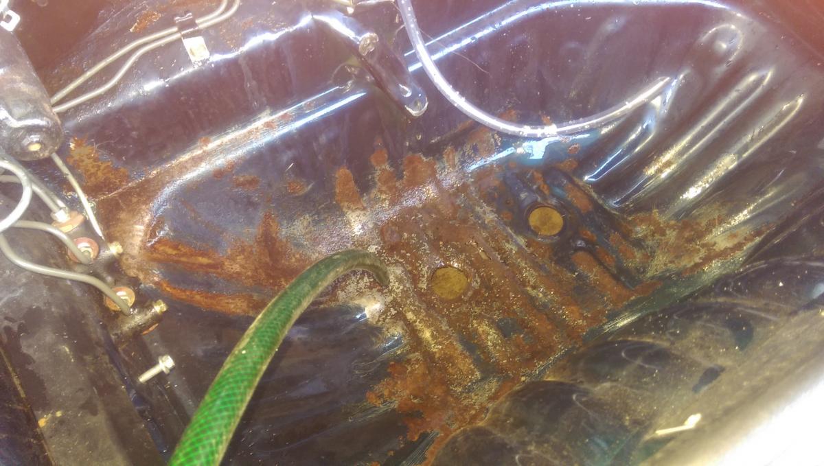

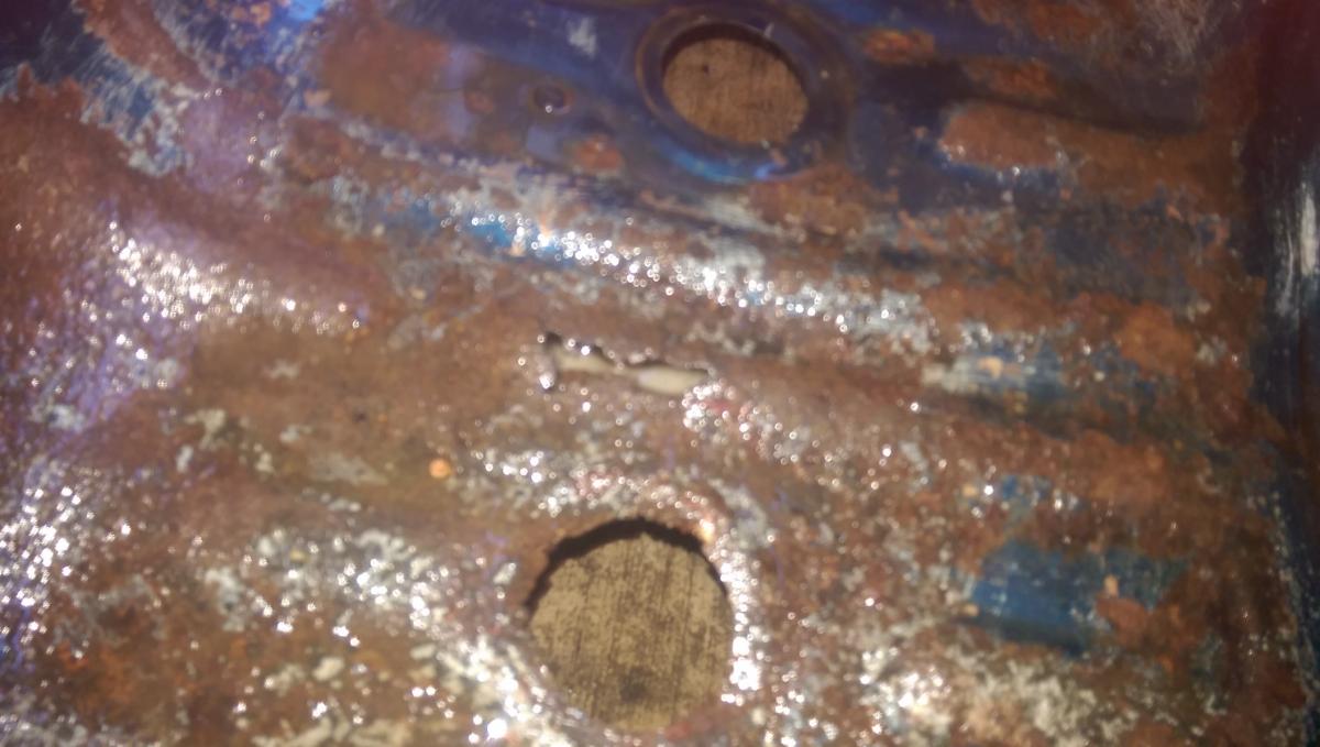

Pulled the frunk lining out and found this.
Lucky its mostly surface with a small hole. I wire brushed it and I'll smash it with some rust kill paint tomorrow.

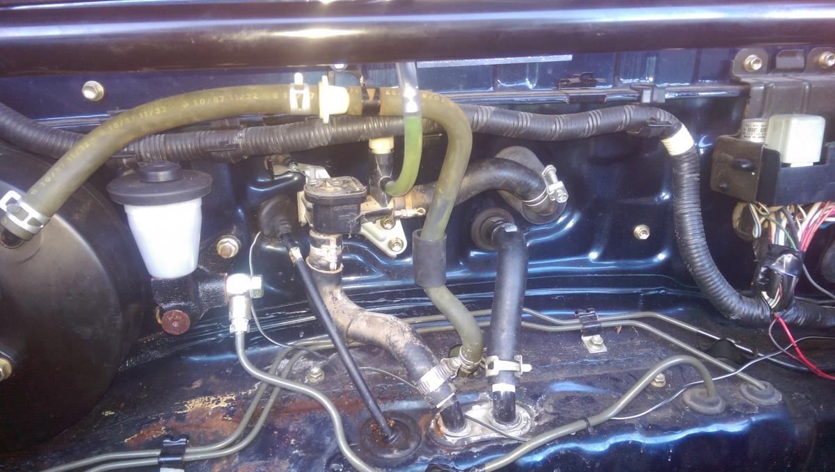

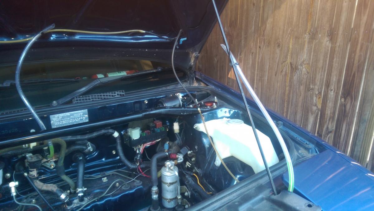

Ticked one thing off the list, sorted out the heater tap.

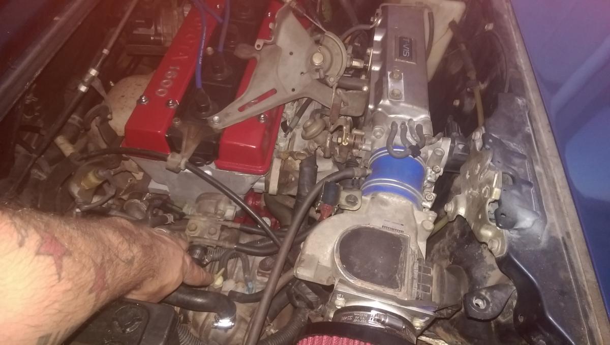

Bleeding the system is interesting considering the amount of cooling piping. You have a bleeder tap at the top of the radiator and one off the heater tap. You need to attack some hoses and hang them up higher that the radiator cap.

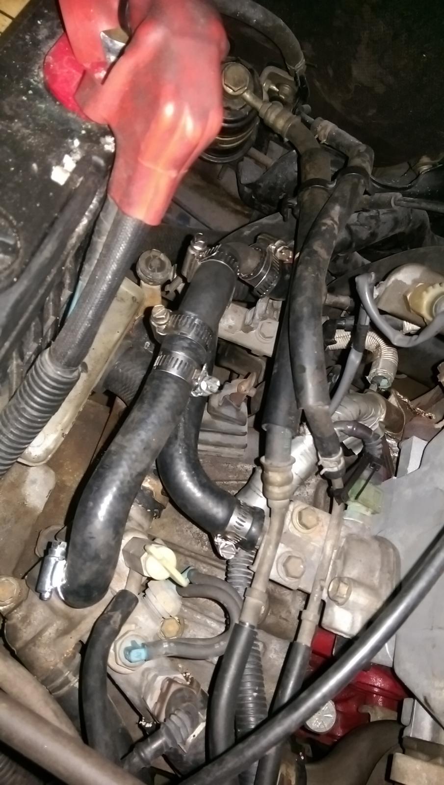

Then you open a tap on top of the thermostat housing which runs to the overflow bottle.
I hacked up the old hose to bypass the tap to had to rangi one up to test it, Ill grab a new hose of the guy I'm getting the front lip from.
