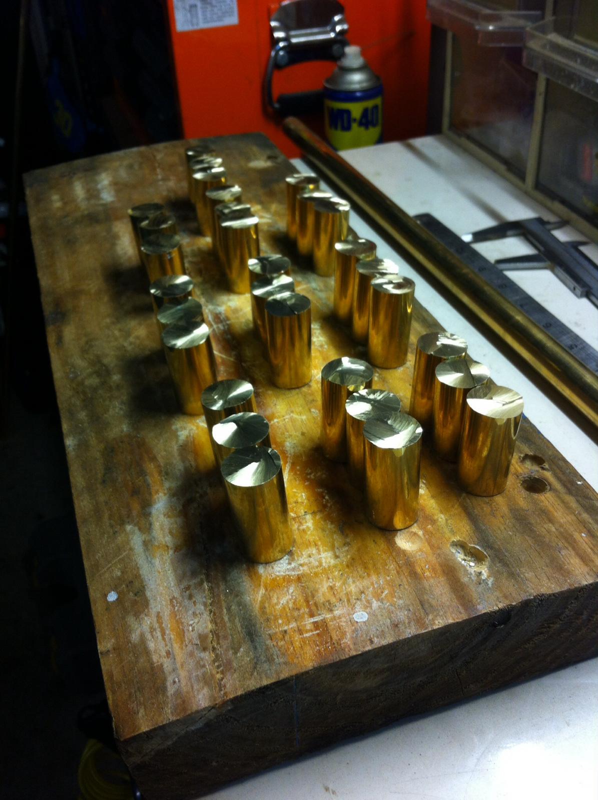

  • First 10 sets are cut and will start spinning tomorrow. I'll finish at least one set to show the finished product. At that point I will open for orders on the sales page. Taz will get the first set.

I finished the first official set today but i didn't get as far with the rest as I'd hoped. I sorted out a bit of a production method with the help of my brothers so hopefully I can get the other 9 sets done for next week.
This is the finished product.

I looked at the brass tube and the closest size was 3/4 16G (19.05 ODx15.79 bore). This would have definitely been cheaper and easier to put out the finished product. But the design I've chosen put the overall diameter of the spacer at 20mm with a 16mm bore which gave me the extra wall thickness to cut chamfered inner and outer edges whilst maintaining good contact area on the ends.
Smoother and larger contact area means the cast iron and the brass are less likely to form friction points and the chamfers should still allow plenty of lubrication between the 2 surfaces.
The magic of brass. Resistant to friction, self healing, soft yet durable.

Today was a very busy day. Over 10 hours straight on the lathe. I'm ʞ©$ɟed, but I got all I planned plus all the extras done.
