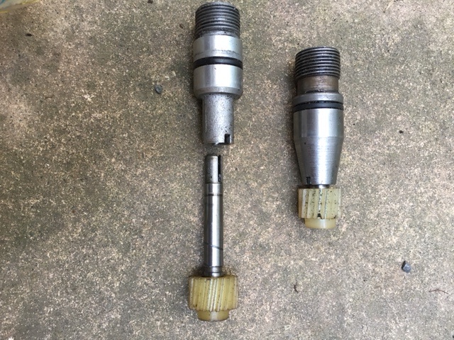

I just came across some speedo drive gears in the shed. I have various box requirements so have them for assorted Toyota's. i.e yours may not look exactly the same.
Here you can see one in it's housing, and one removed. Have noticed they don't all have a circlip to hold in the rod, looks only to be the later T50 type so you may not have one of those.
