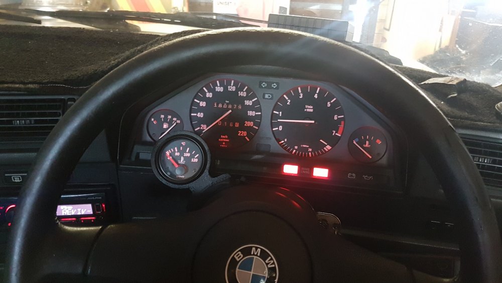

Now the wife bought me a 3d printer for xmas, probably one of the coolest toys ive played with in a while. very cool thing. I took no time in printout a toyota logo.
20171227_183947.jpg.0420a847f044511a9c691fdb7c112b90.jpg20171227_084551.thumb.jpg.47340318d40f901acb79e0d891278f07.jpg
Once i had fgured out the settings on the thing i eventually modelled up a proper gauge holder for my water temp gauge. turned out quite good i think!
I am still working out the settings. its a trade off between print quality and print time. You can reduce it to 0.1mm layer height and it looks great, but it takes hours to print.
Alternatively you can print it quite course, and then just hit it with some primer/putty and paint to smooth it out. I probably should paint the parts anyway as currently i'm printing in PLA which is the easiest to print for a beginner but it doesn't have the best UV resistance.
