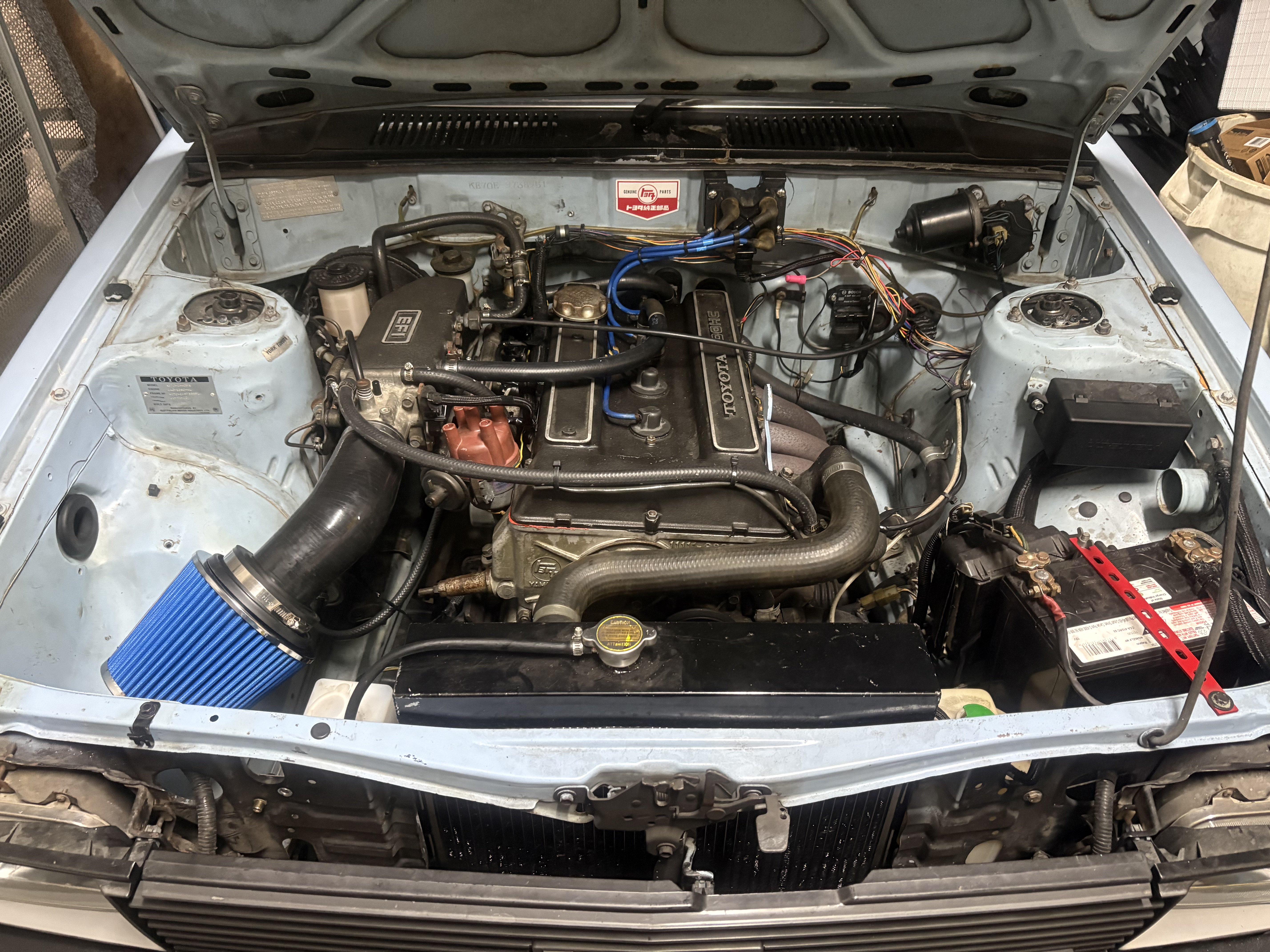

As she sits now
I also recently purchased a 3tgte sump with oil returns, and am waiting on a 3tgte crank, 2tgeu lighted flywheel to arrive, for eventual turbo once the things running.
If anyone has a 3t turbo manifold hit me up!
