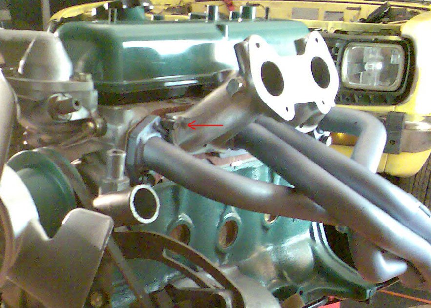

But I just cannot figure out how anyone can get these manifold bolts in! The outer/upper bolts near cylinders 1 and 4 are in such tight space with the curve of the intake runners that I can't even get  a spanner on to the 14mm bolts. I've tried with studs and nuts, but this didn't help much.
The ones underneath are more annoying but I think with the starter out they should be accessible from under the car.
Someone suggested hex head bolts and a long ball end Alan key socket fitting, so I guess that might be my next try.
Has anyone had success fitting these manifolds with regular bolts or studs and some tool configuration I haven't thought of?
Is this the manifold??
https://www.ebay.com/itm/12-3062-Redline-Manifold-Toyota-Corolla-Corona-twin-DCOE-Weber-3K-4K-5K-/331217079754
It looks pretty straightforward, which means it probably doesn't fit a K motor!  Are you fitting the manifold with the carbs on it already??
Pop up a few photos, it shouldn't be too bad. I've never had to take the starter out. The usual problem is a height difference between intake and exhaust manifolds which leads to air leaks, or weld too close to the bolts so the washers have no room to sit flat.
Ah- is it lacking space here??  This is a Redline single side-draught manifold, but I expect it has the same shape. It looks like you have to put the nuts on with the manifold held off the head 5mm or so, then tighten them up.  Option B is some work with a grinder I suppose.
