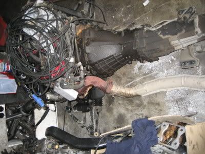

Below are the pictures:
GB, dismantle and waiting for the clutch kit :)
