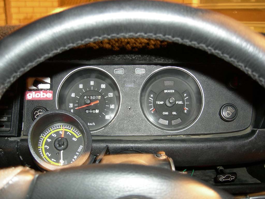

I found out one of the local importers is actually in Japan at the moment sourcing parts.
So today I put my order in for:
1 x TE27 Instrument Cluster & Fascia
1 x TE27 3 Gauge Cluster & Fascia
1 x TE27 Centre Console

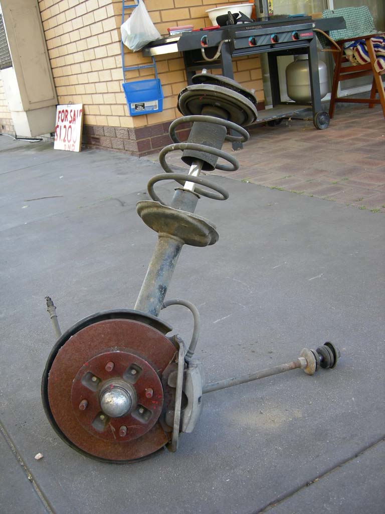

So I started dismantling my RA40 celica struts today, with the intention of turning them into adjustable coil-overs for the coupe.
All that is left to do on them now is drain the oil from the strut (its a wet strut system) and insert new cartridges.
To get things done on the cheap side, I'll be getting my awesome neighbour that lives next door to me, to make me up the adjustable sleeves.
I'll also be getting him to make me some adjustable camber tops too.
The next upgrade once this is all done is to get those elusive KE30 axles, shorten them 5mm each side and do my rear brake upgrade with KE55 drums for now.
So a 4 x 114.3 stud pattern is on the cards ;)
I went and spoke to my neighbour today about borrowing his vernier calipers as I needed to measure the outside diameter of the RA40 celica strut, and to my suprise, it has a 51mm OD.
So now I need to source some threaded sleeves with an ID of 51mm so it fits nice n snug ;)

New wheels are coming on Monday or Tuesday ;)
Gonna slap those Bathurst Globes from Trendact that I'm getting on there once I've cleaned 'em up :y:

So I went around and got prices for the Noltec Coilover Sleeve Kit.
Revolution Racegear - $350
SA Suspension - $460 but he dropped to $350
Pedders - $460, wouldnt budge on the price
ABS (Auto Brake Service) - $287 Trade.
So Guess who's getting a coilover sleeve kit next Tuesday? :y:
I also get the rims on Monday and will also have to get some strut inserts too for my struts and get the discs machined.
I should be able to stop pretty well soon enough :P
