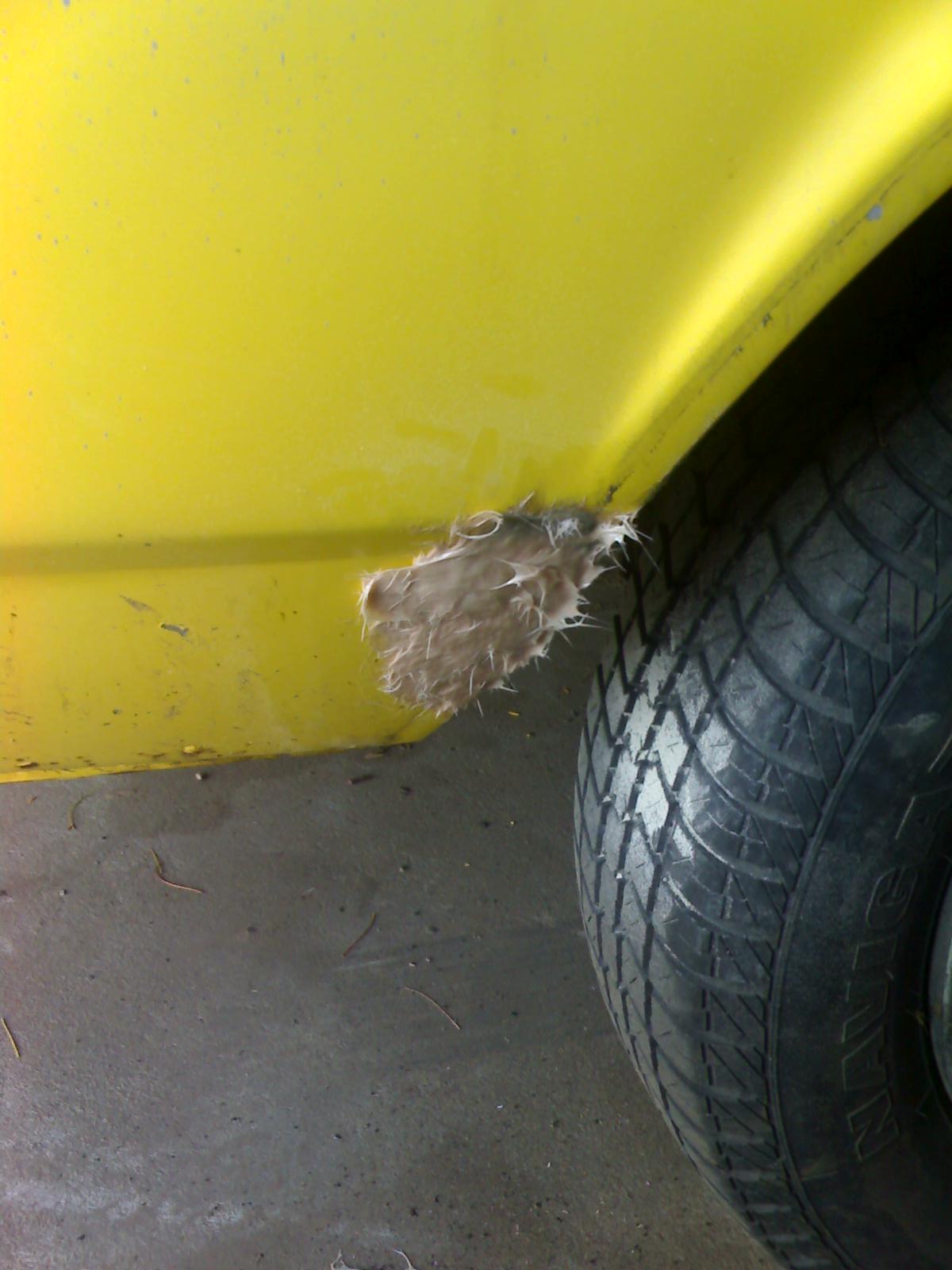

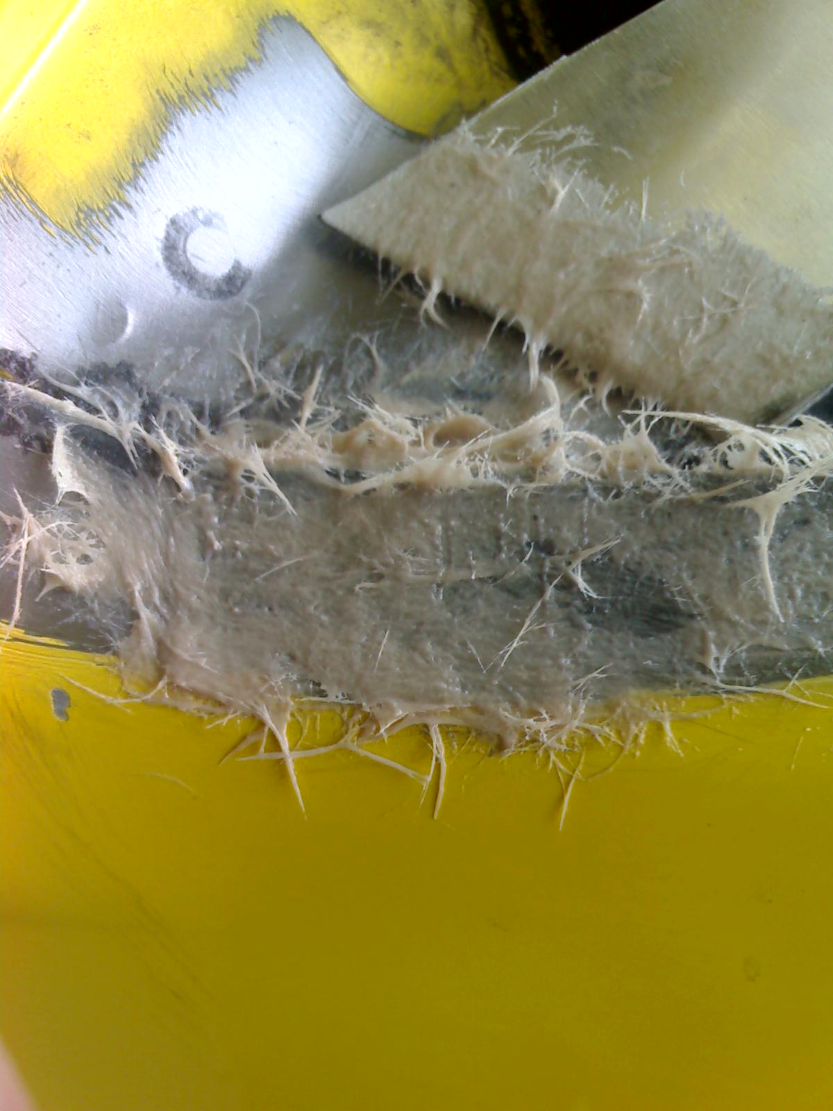

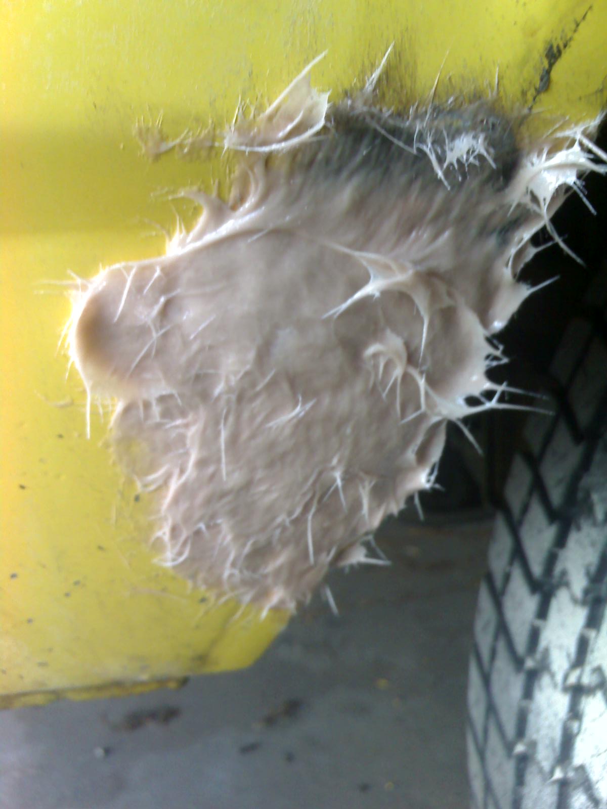

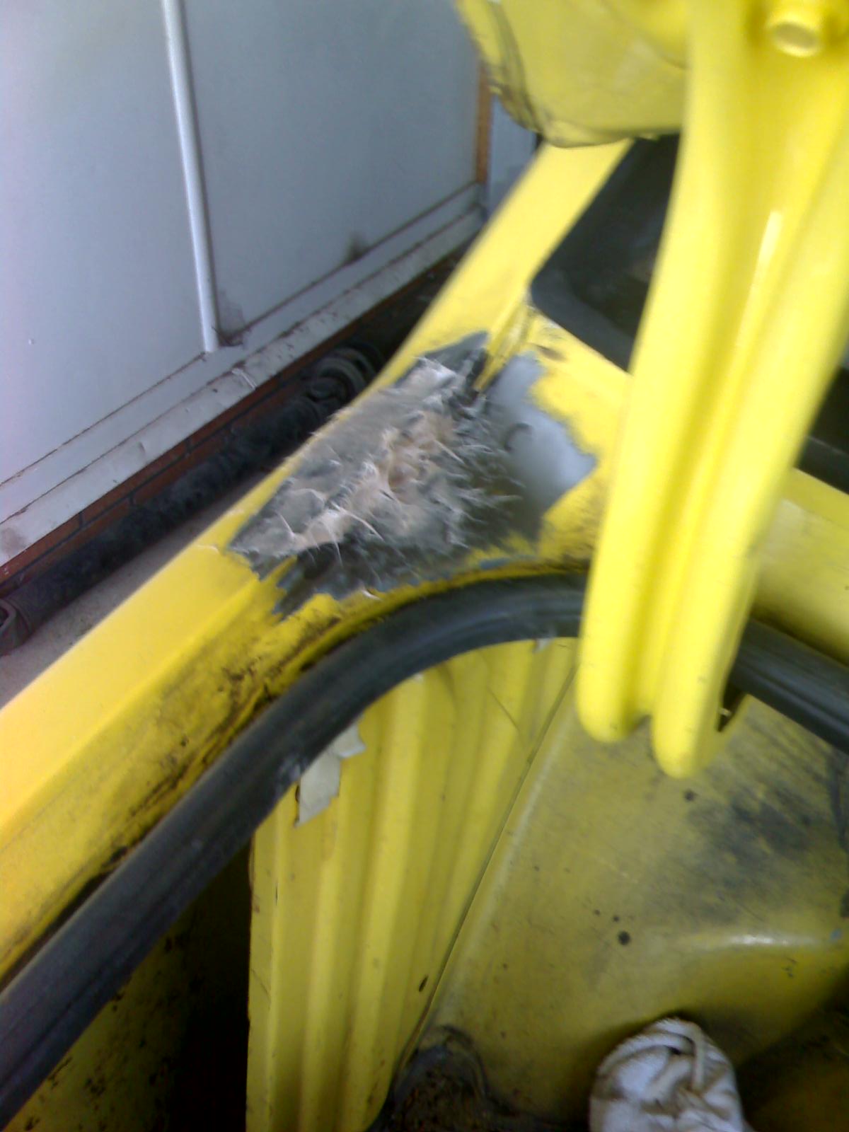

Started to remove more rust today and i attepted to bog the holes up.
Thats how it is left now, I will sand it tomorrow.
The f**ked up shity bog didnt f**king set properly and i had to pick it all out and now its worse than before. :( :) :abuse:

If anyone can do a decent job with bog let me know.
ok you come up and weld in metal to fill the multiple holes
As you can see i WAS pissed off,I'm not now so i might go down and get some quotes soon on the rapairs. :(
it doesnt look like ya mixed enough hardener into it, it should be darker than that, and try and kinda drag it across instead of just lifting it off, just making more work for ya self
just my 2c, you can weld it if ya can be bothered
Yea i hate bog so I'm going to payy someone to do it.or pay someonee to weld it up.

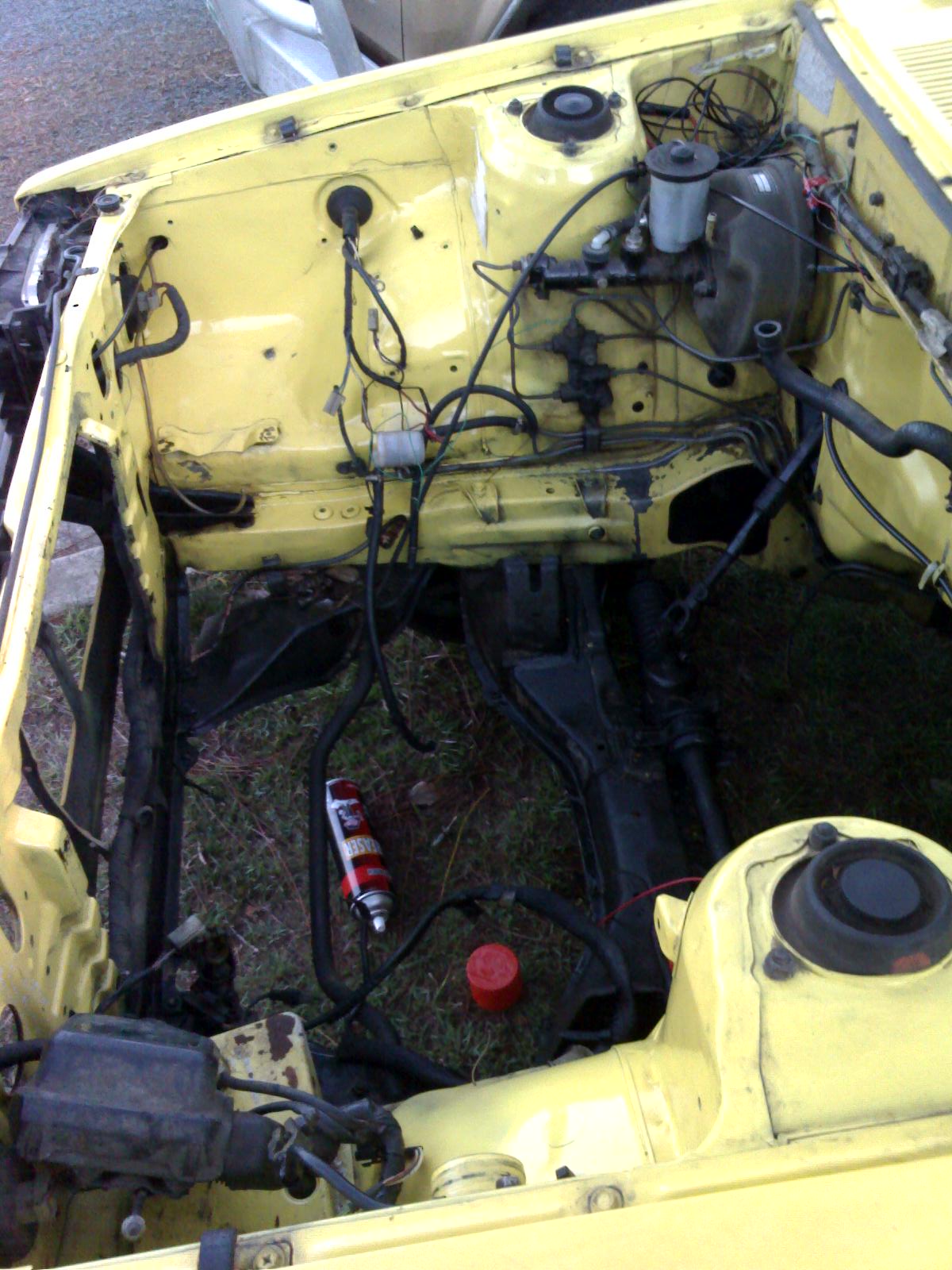

I got bored so i got some degreaser and gave the engine bay on the kesev a quick once over.
