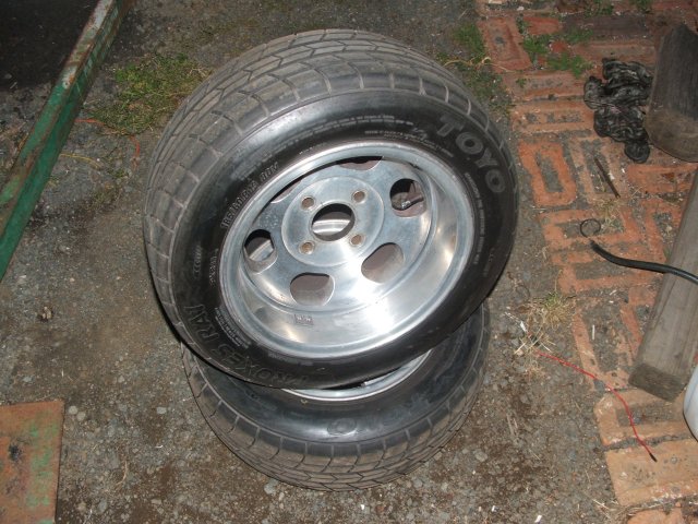

when i did mine, i painted down in between the spokes and the centre black and then polished the top of the spokes and the rim
looks pretty good

these are nickz's exactly the same hope he don't mind
