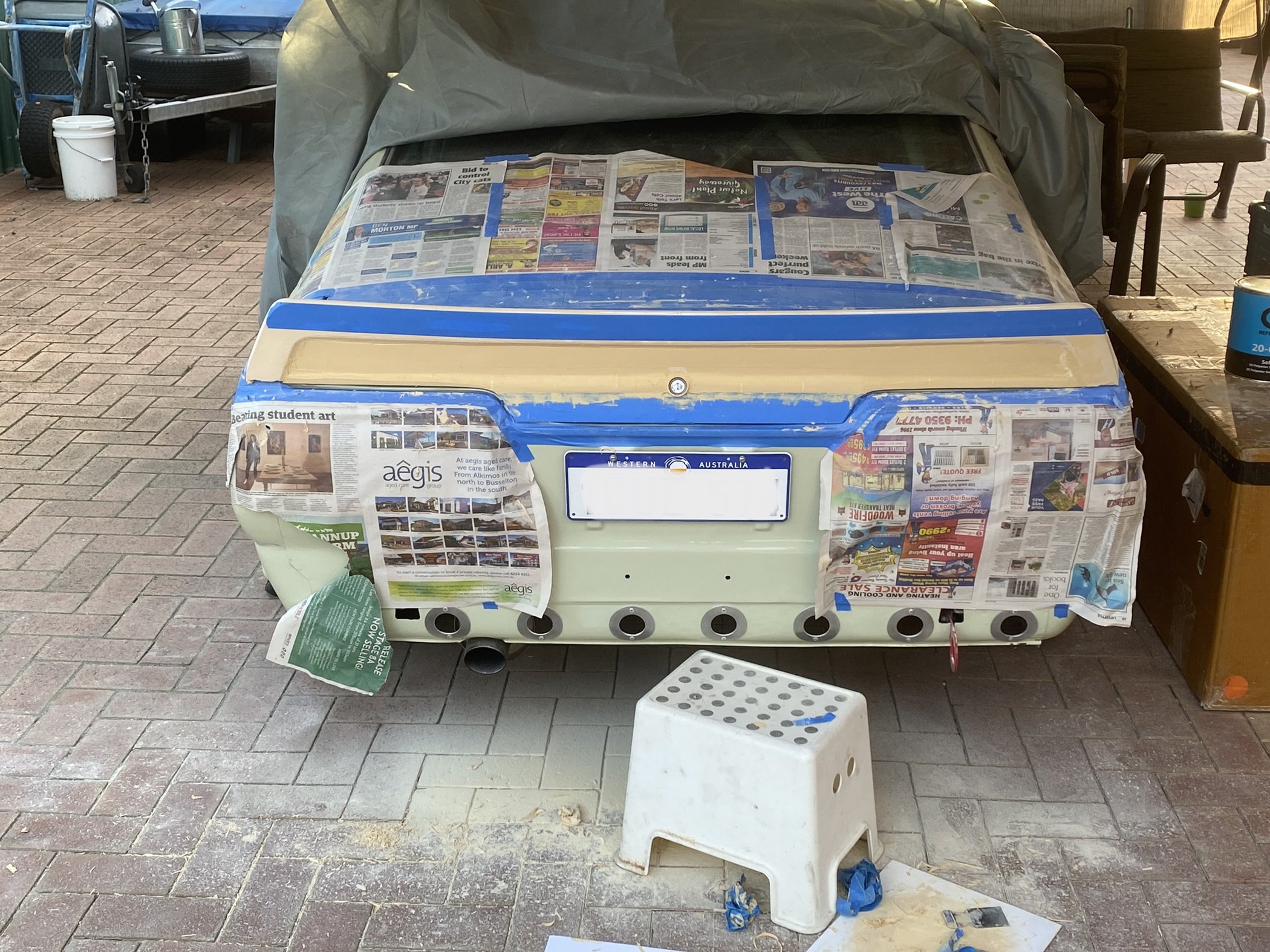

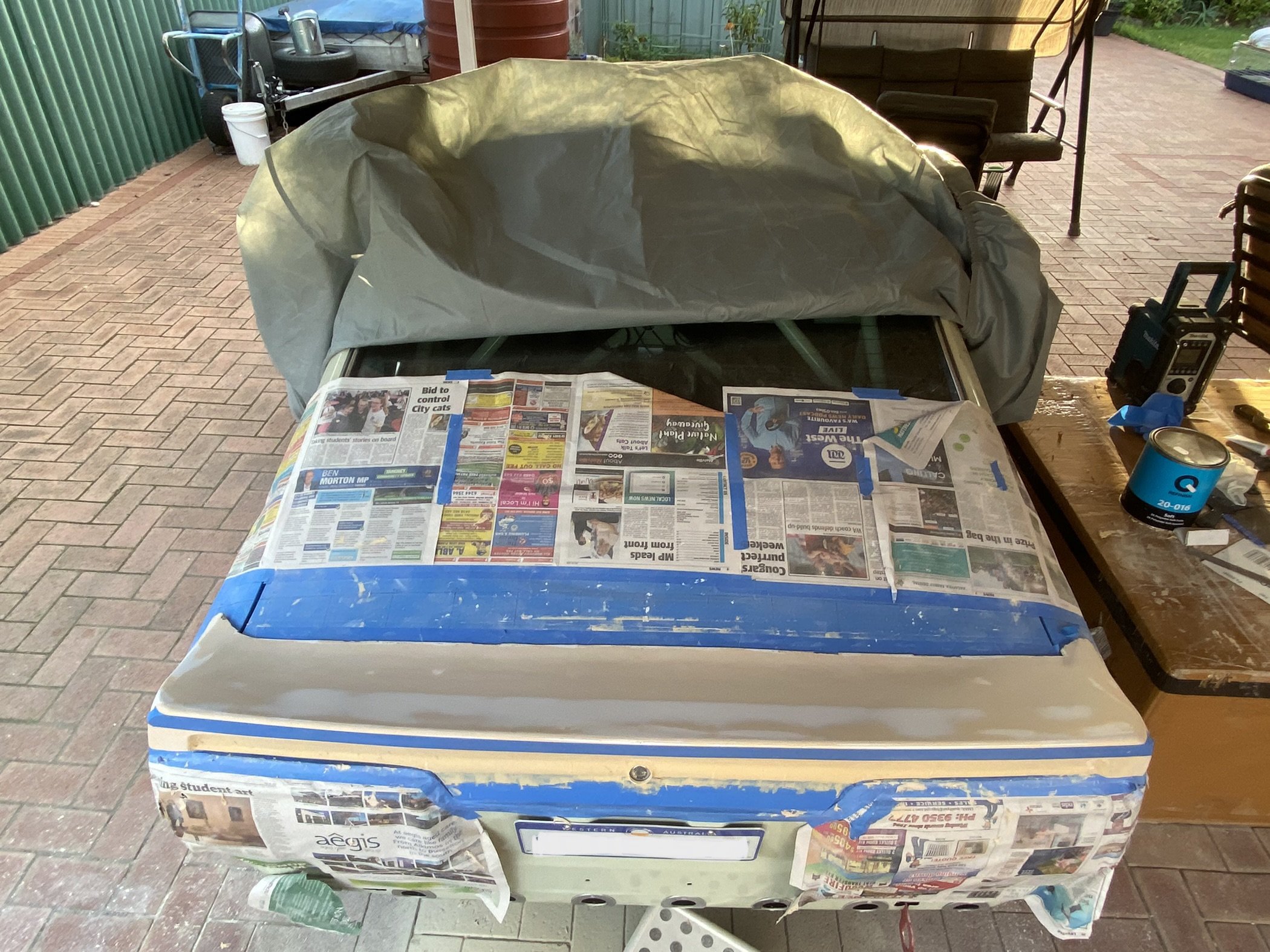

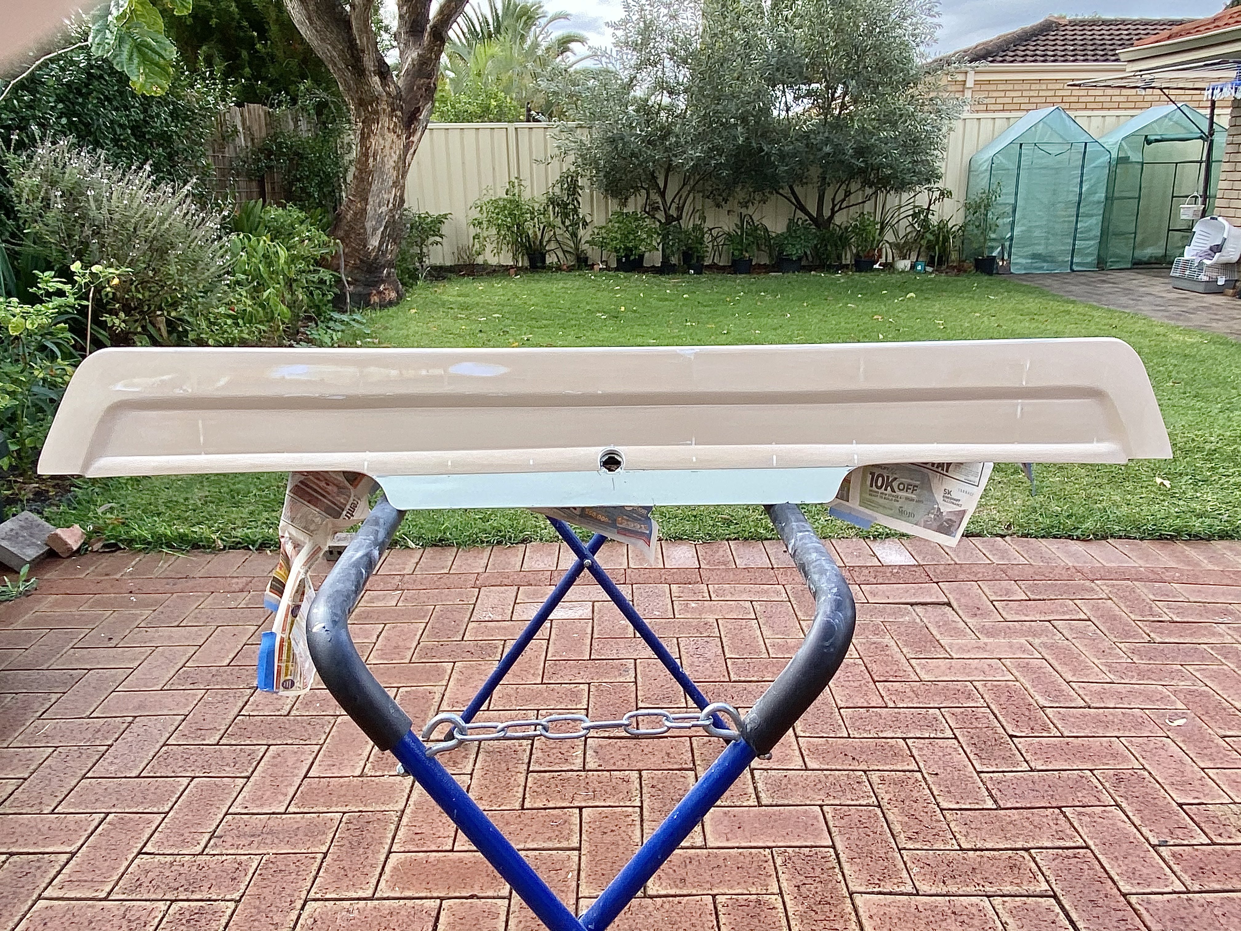

  3. More filler and sanding!!

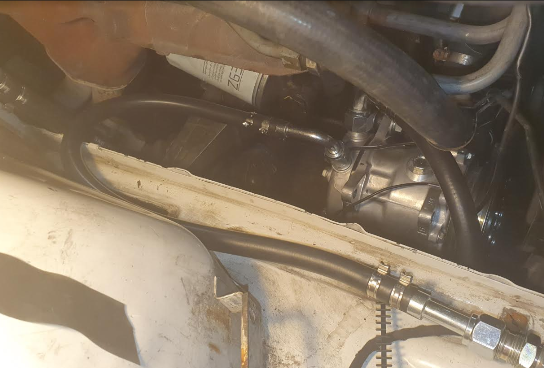

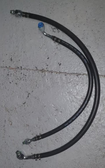

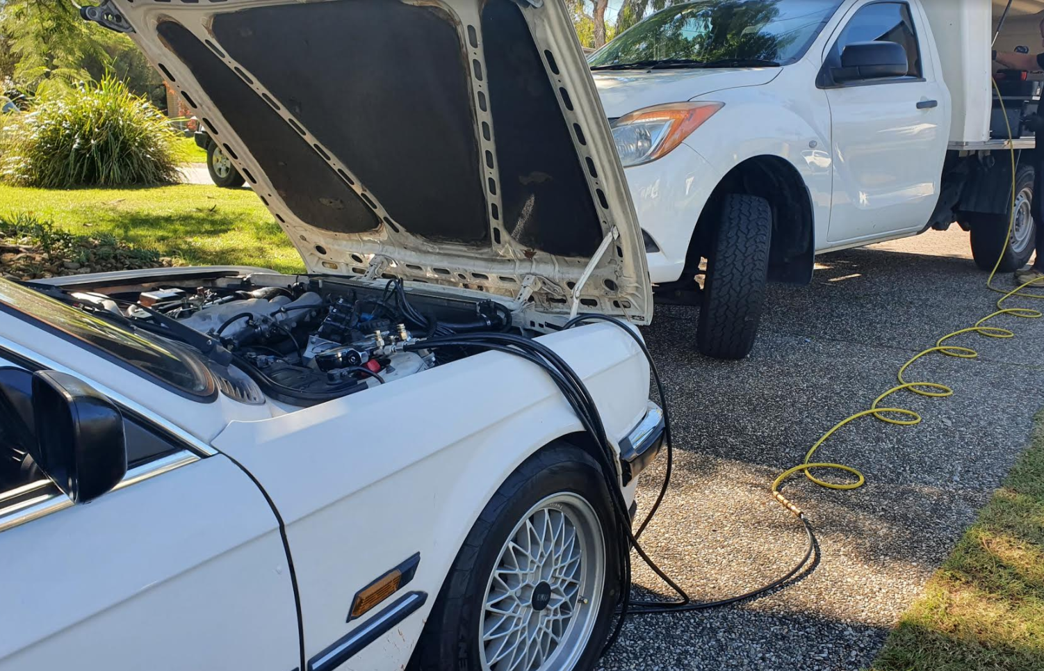

  4. Well 6 months in the making and we have cold AC! soooo cold! Just in time for winter! haha. I ended up making my own hoses using a kit from "speed ac spares" up in north qld. dunno how many ppl will read this but these guys were extremely helpful. https://speedyairspares.com.au/ The hoses came with a set of hand crimpers that were surprisingly easy to use. All very simple. and significantly cheaper than all the quotes i got done. (like 60bucks per hose as opposed to $200) AC man came around this morning and gave it a vac test and everything was all good. 20mins later i had cold air! So its been a saga but lots of fun and good learning experience. learnt how to tig weld in the process so there will be some more tig welding projects in the future. Like most things turns out AC is not that complicated. So next step is going to be relocating the battery to the boot. the 325i and 318is came with the battery in the boot. Dunno why the 323i didnt. but i dont think the 318i did either. I have a battery box and isolator already, just need to get some cable and figure out a way to hold the battery box in. I could get the oem battery tray etc but i think a plastic box secured nicely in the corner will be neater than the oem.

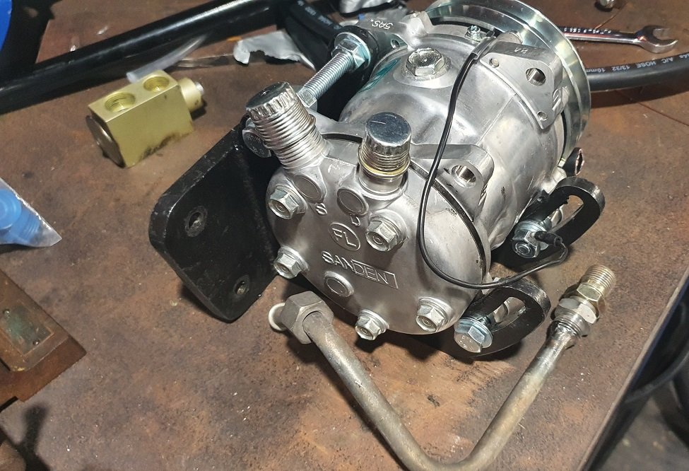

  5. Right well time marches on and waits for noone! Progress has been slow and steady on AC project. - TX valve has been replaced - painful job. found various types of 0-rings on the old tx valve. some green ones, some black ones, and even some brown ones (viton?). all repalced with new r134a compliant green ones. - bracket is finished. did have some dramas with it when i first put it on that i had forgotten about the crank angle sensor bracket. had to notch it out of the back (not in photo im afraid). but will be good. in heinsight i probably should have hung the compressor a bit lower but it will still work. fine. - I bought a TIG welder and have been learning to TIG. Since the new AC compressor has slighlty different sized pipes than the old one i had to weld on 2 fittings to the hard lines, one shown in the photo. Then i bought some rubber pipe and crimps and a crimp tool to make my own hoses from a shop up north that specialises in hot rod AC. i pressure tested my welds with house mains water pressure (~450kpa). Once i get my hoses made i will get my vaccum pump onto it to test before taking it to the shop for gas. So hopefully i am on the home stretch of AC! might get the bracket put back in on the long weekend and start on the pipes. in unrelated news i attended a lake side "euro day" a few weeks back. really good fun, never driven on lakeside before. what a cool race track. heres a photo of my brother and i with big grins on with a Ferrari Dino in hot pursuit! had a blast. e30 performed floorlessly. Didnt explode so my DIY road tune must be ok.
