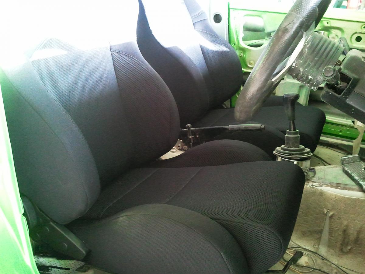

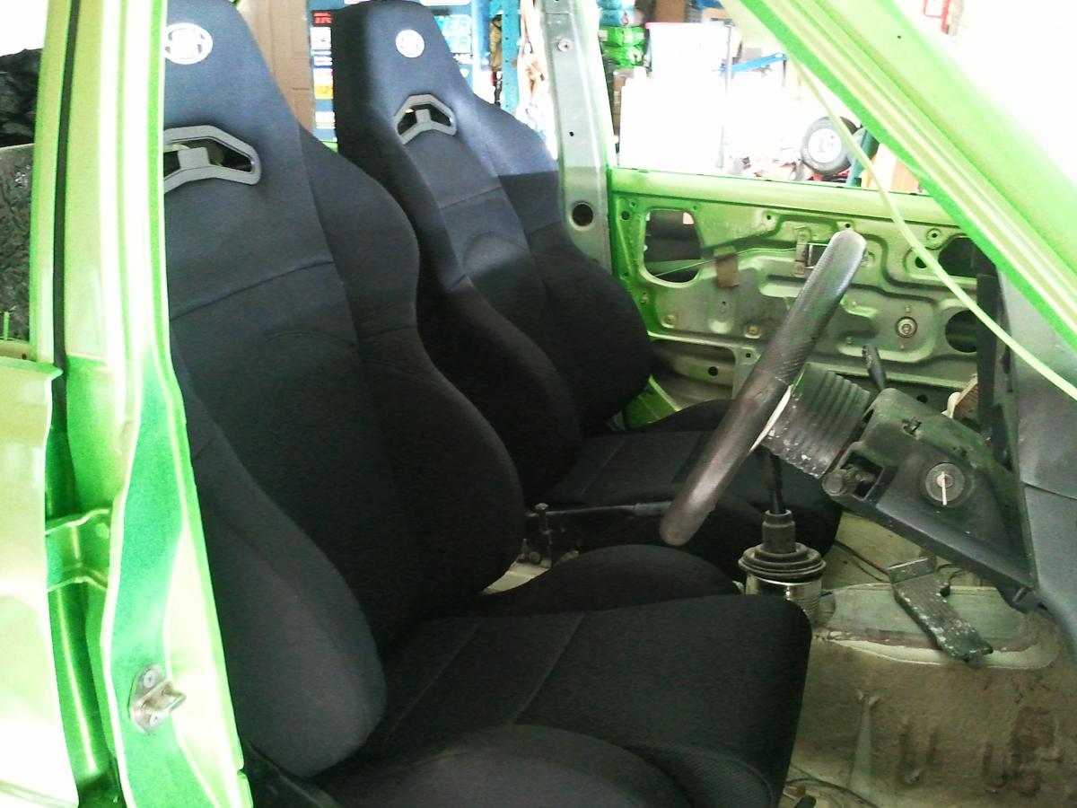

  4. hi cameron seat mount points where 345mm wide approx 375mm long approx yes will have an engineer have a look at mounts , but they are so solid they will be staying in either way. seats are from super cheap made by saas,look good and are really comfy
  5. OK, I've made some mounts that work really well, using the corolla rails and basically split them in half, bolting the top half of the rail to the seat and then to the plate and then welding the plate to the lower part of the runner

  8. the saas seats mounting points are shorter, both in width and lenght, will have to ring saas as they are in wethrill park and not that far from work
  9. I was given some new saas seats for the rolla and was just wondering if any one has bought or made some mounting runner to fit the seat to the ke55 mounting points,and if so where did you get them?
