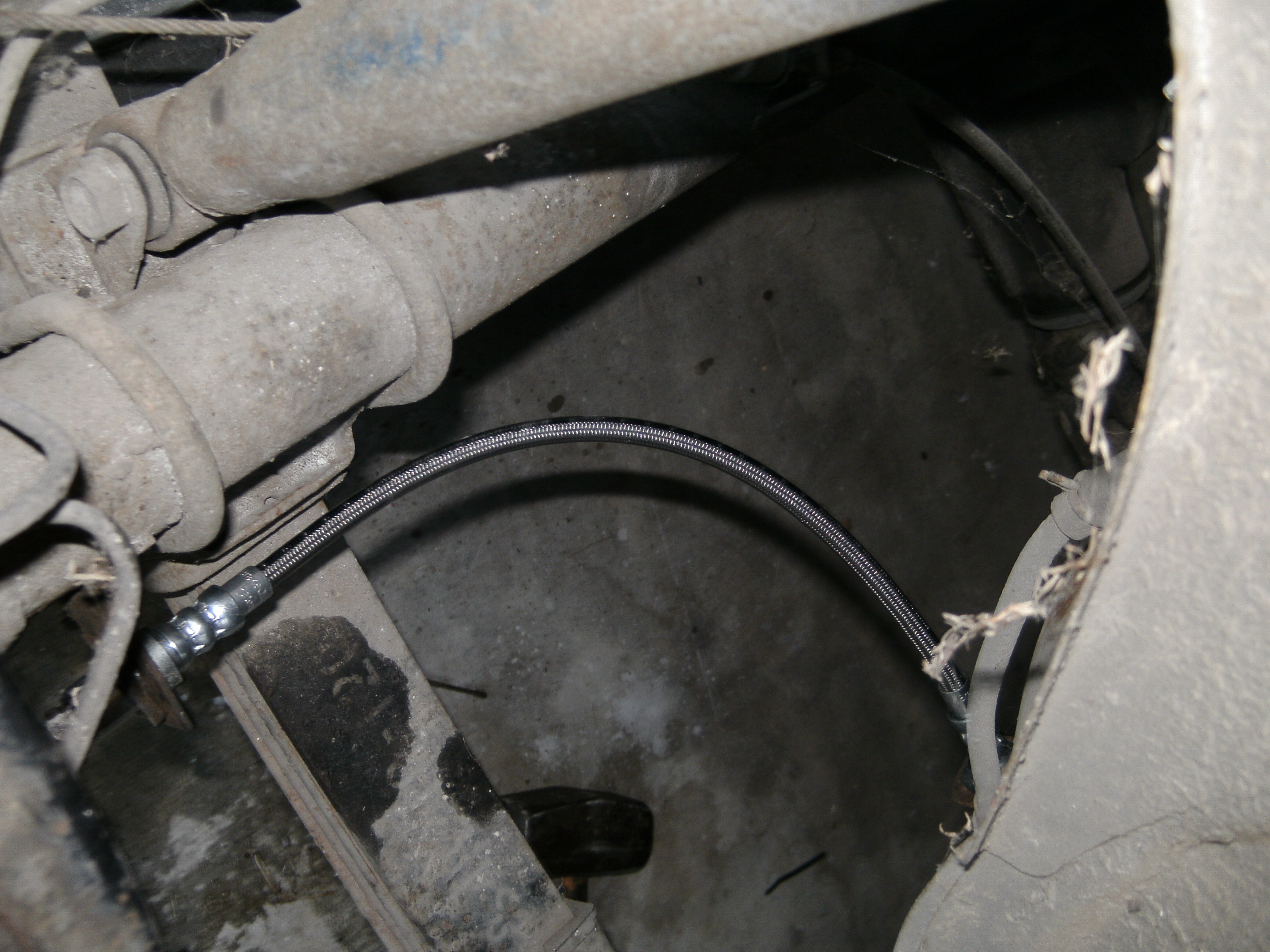

  4. UPDATES: Well got AWESOME news :) Tonight I confirmed my restored powder coated stone chip tray for under the front of the car is going in the post :D Should be here soon so that is that Item taken care of. Also tonight got the rear braided brake hose line in the car :y: Pics below: Looks AWESOME. Now to clean up the rest of under there..lol Also while I was in there noticed was dirty as so on weekend after putting clear coat on the car if I have time (going bass guitar jamming) ill be stripping the rear wheel wells and stone chipping them like I did the front arches so they look the part. Also will change the small rubber line from fuel tank to metal fuel pipe looks old don't wanna risk it. So that is the updates for now watch this space.... Cheers Cameron

  18. ^^ Wont be attending these events as still not road going yet..LOL Well time for ....... UPDATES: Today on the way home from work I dropped into the brake shop with the rear brake line I had spare off a KE11 to get re-made in braided hose for the rear brakes :) Well Pic below of results. Can see old and new hose in photos: Cost $30 to get hose made while I wait took 5 min to make but they were so busy that I was there for over 30min made me late to my bass guitar jam :y:..lol Now for some factual information: All KE1X cars KE17, KE15, KE11, KE10, KE16, KE18 all run the same rear brake hose. I have all the KE1X part number books and they all are the same part number. I had a diff froma KE11 with hose attached and removed it and compared it to the KE15 hose and it was the same. The thread in the brake hose is M10 X1.0. The part number of a rear KE1X series hose is: 90947-02045 In a KE1X you only need one of these hoses as it goes to one drum then the other drum is connected to the first drum via a solid brake line that goes across the diff. There is also only 1 bleed nipple for the rear of a KE1X since it uses this setup. But will try to get this on this weekend. Also a while back the car had a really bad spot of bog on the roof well ages ago I got off my ass stripped the section back and found...was the smallest dint that needed no bog..LOL The old owner put some on the spot and spread it for 1km radius so roof looked even as. I didn't like this bog was cracking etc. So I stripped the section and it came up like below: You can see the pitted area this is where the bog was but I kept stripping as I wanted to make sure I got it all. I then put a TAD bit of bog on the main bit of the dint about 70% less than original owner and sanded primer and did all the stuff you do......Then for the real task of painting it white again.....Now my local shop in there book has over 250 different colors they can mix just for "white" that doesn't even go near cream, grey, etc just WHITE. So thinking I could do it cheaper and prob get it right as the car would of been just "gloss white" bout a small amount of gloss white. Results :y: well its painted..LOL wont rust. Roof isnt normal gloss white so got a huge rectangular are that is a different shade of white stands out 78.42 KM away so ill re do this one day but will pass rego with this fix so I'm happy. Ill get a picture of this spot when there is more light..LOL Also got keen then and the front drives side guard had bog in it again after 40 years was starting to break apart so I decided ill strip the whole front end off and clean it up etc as KE1X are know for rusting out in the lower area of the chassis rail where the lower front guards bolt on so I spent some time stripping the car to pieces. This is all I have done now so hope fully tomorrow night ill get the whole front end washed thoroughly or ill strip it and re dot eh stone chip coating and black it out again. Cheers Cameron
