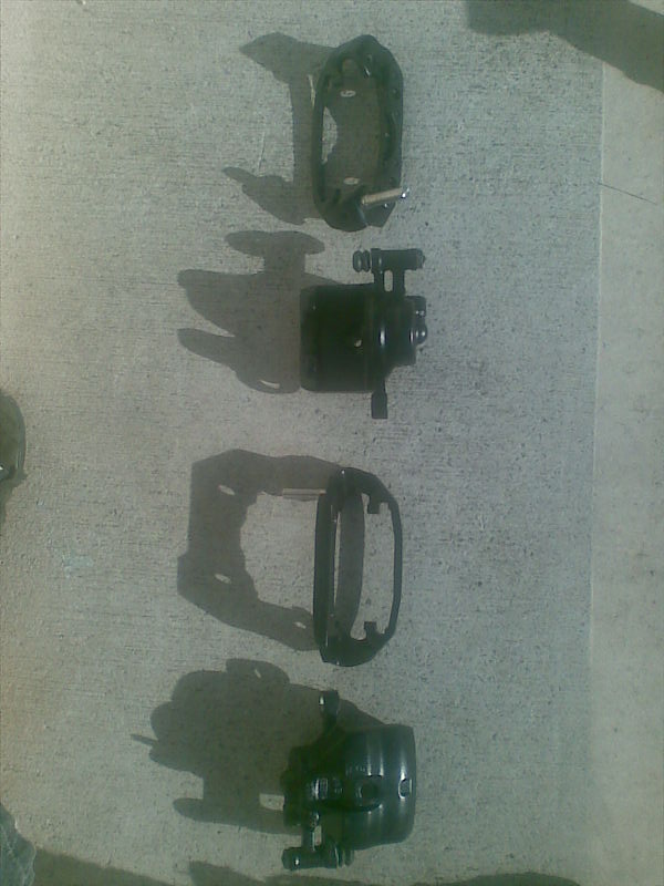

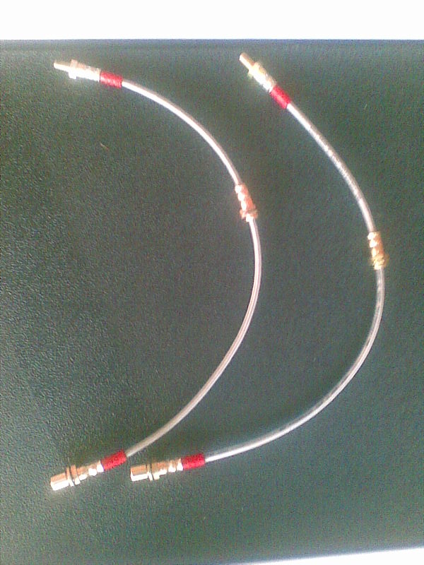

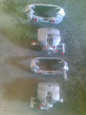

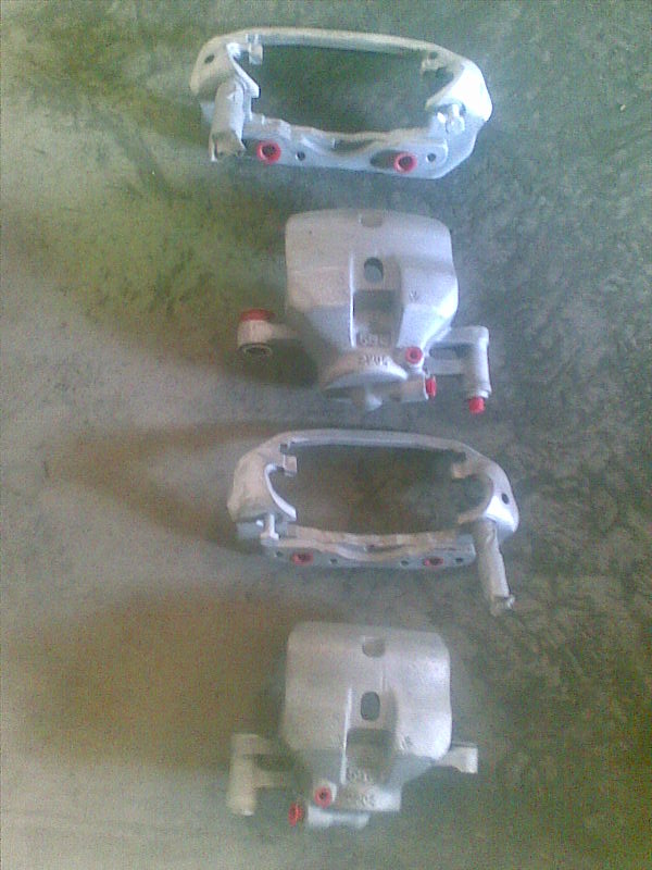

  1. I know it is a W series box but not exactly sure what model. I found it at the tip to use just for dummy fit. I will still be using the corolla pedals, but will be converting to hydraulic clutch. The bell housing I bought came with the clutch fork on the driver side so all I have to do is custom fit the rest. I got news too guys, not heaps flash but it is another thing. I just sandblasted my brake calipers and painted them gloss black, they look much better. I also purchased a caliper overhaul kit so the brakes will be practically new when I install them into the car. Heres some pics. Sandblasted Painted Oh, and brand new braided brake lines

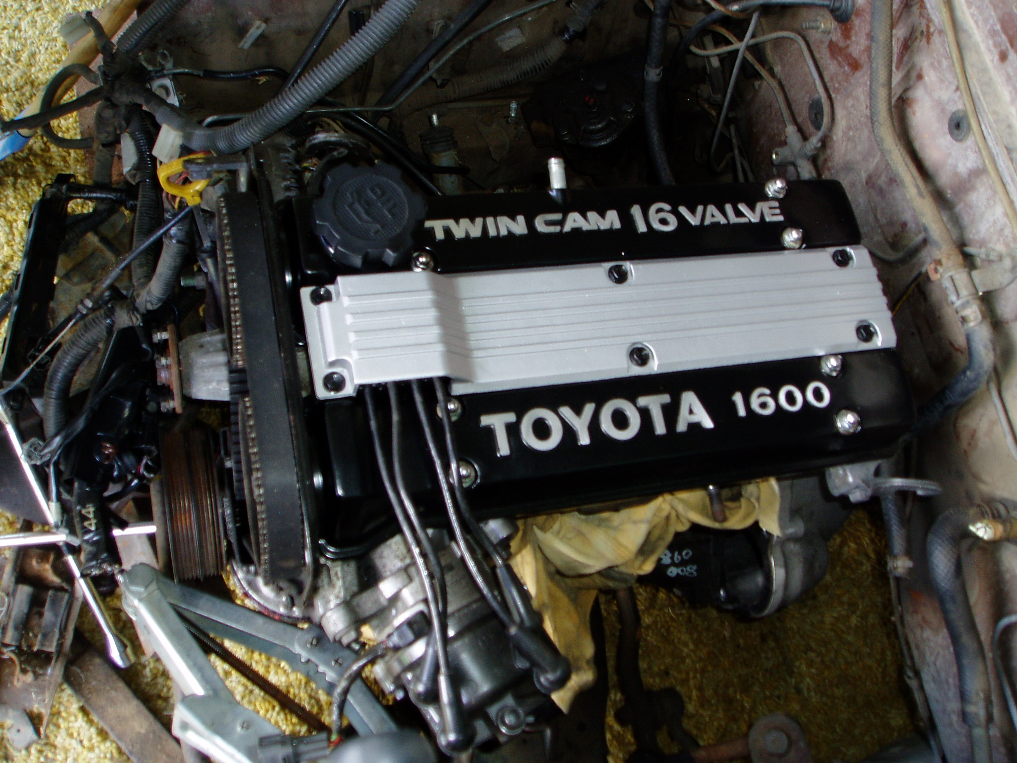

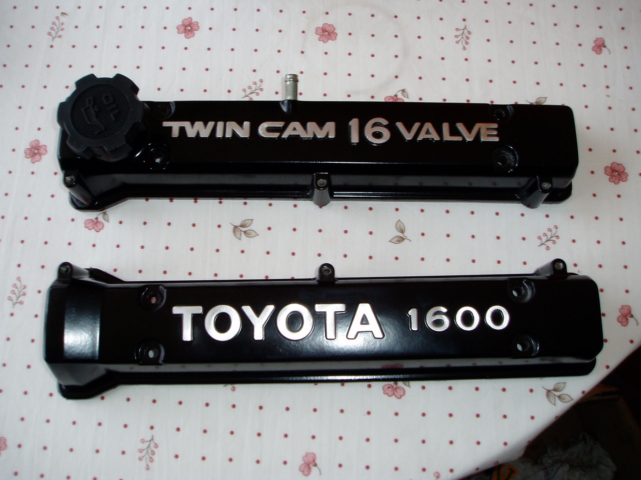

  6. I am at Tahmoor. Near Picton. It sucks so much though that I spent so much money on this and now I can't really do anything. Thats the bad news but the good news is as follows. I just got my cam covers powder coated and they look HOT ! ! ! I ground back the paint on the writnig and polished it so the writing would stand out. Heres some pics, and then next on the list is custom inlet manifold take 2.

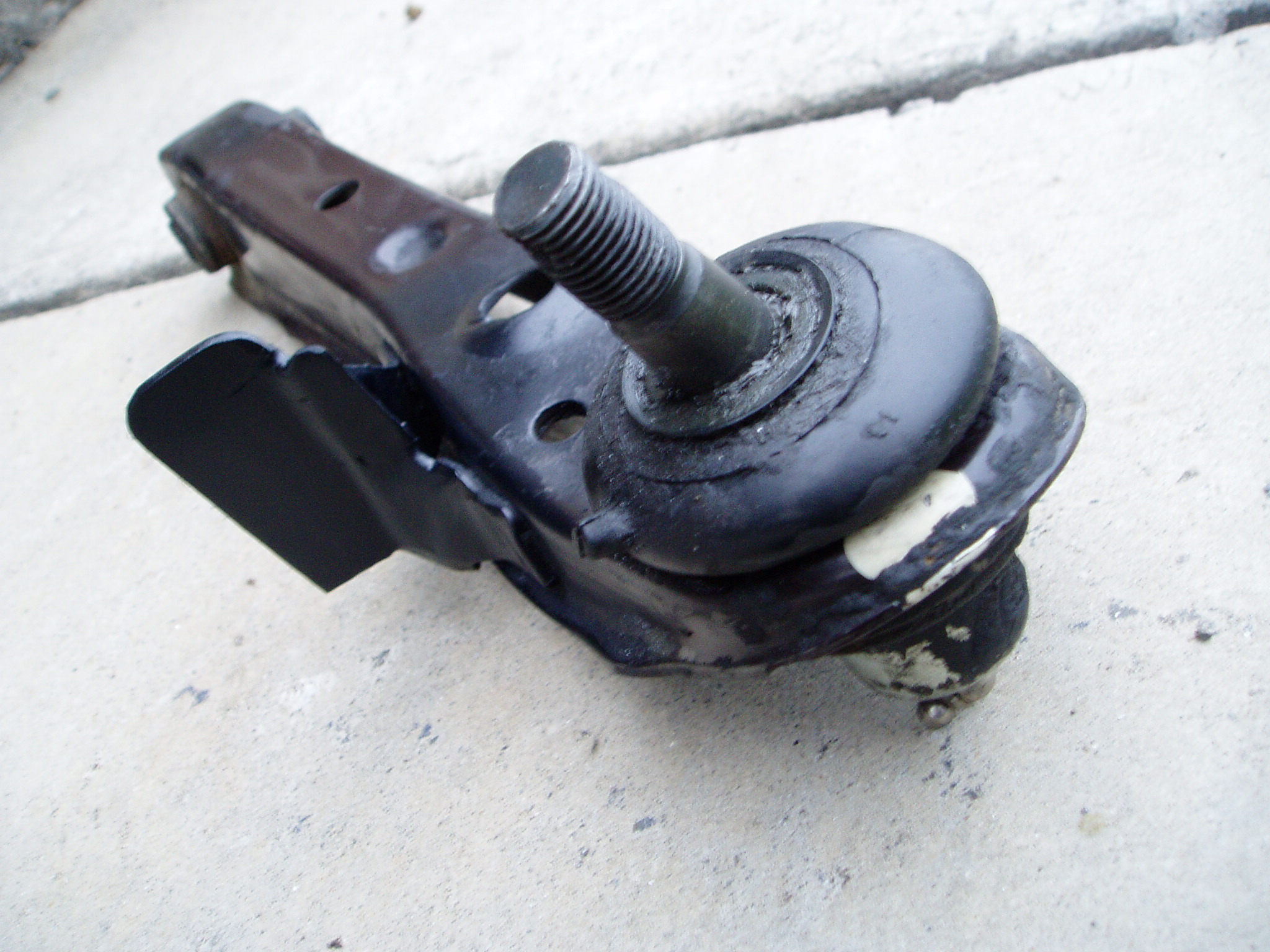

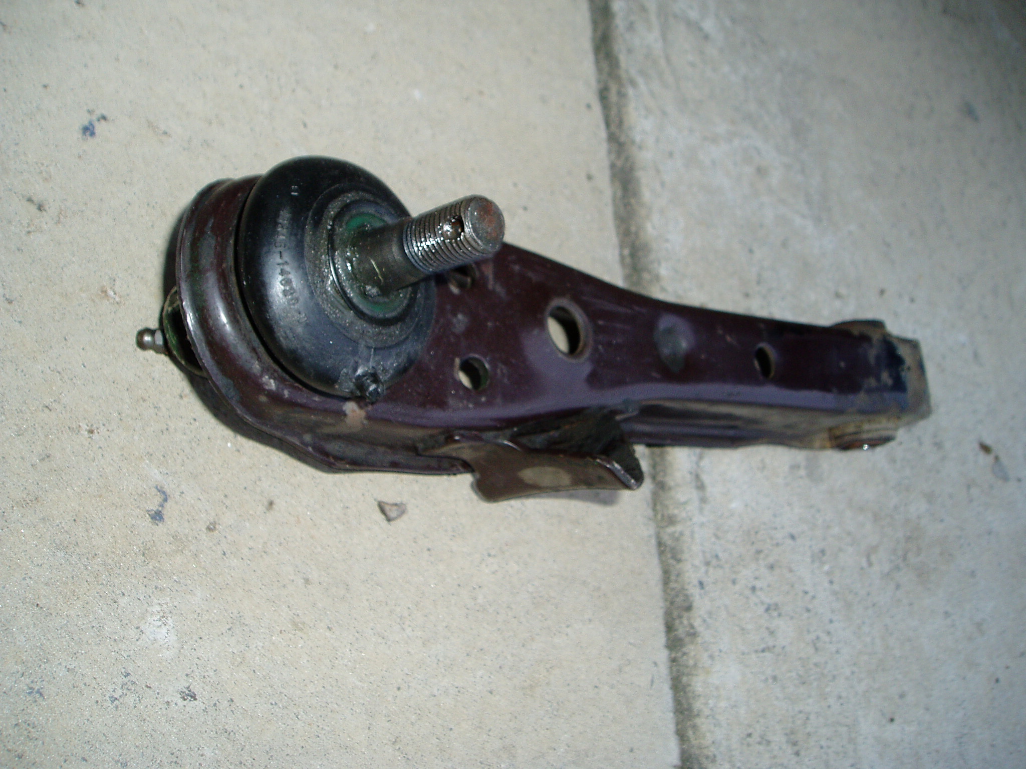

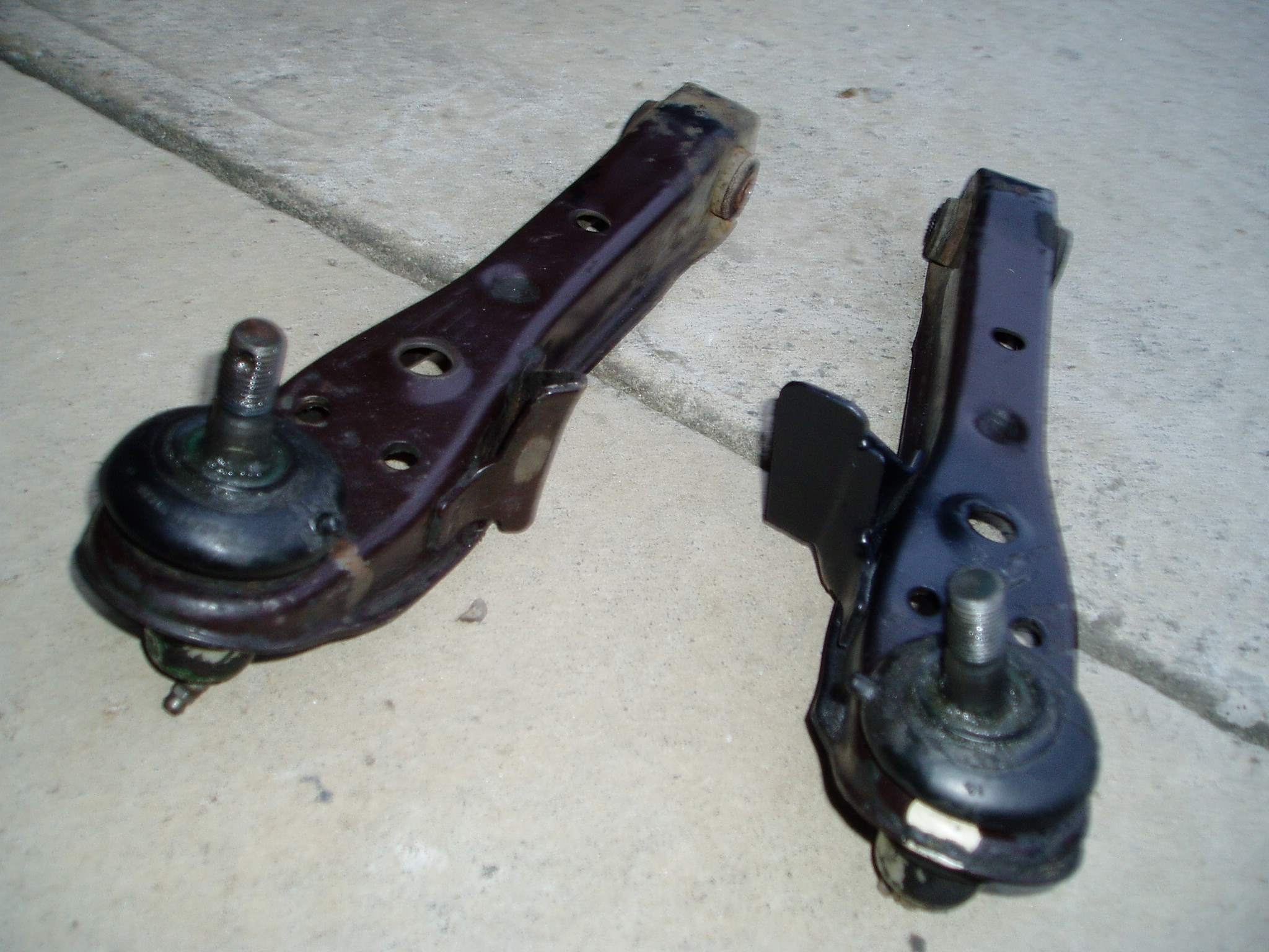

  9. Hello everyone, hope you all doing well after Christmas, New Years and the recent Australia Day. What a long weekend, I love it. Anyway, I got a chance to do some more work on my car finally and I am just doing a lot of shopping for it too. Gotta pamper the car too hey! :hmm: Any way, the RA65 struts that I purchased aren't an exact fit. All I had to do was modify the steering lock on the lower control arm so guess what, I DID. Turned out rather well, just gotta get it on the ground to see if it operates well. Heres some pics. The standard one. The standard one is on the left and the custom one is on the right. The custom one.

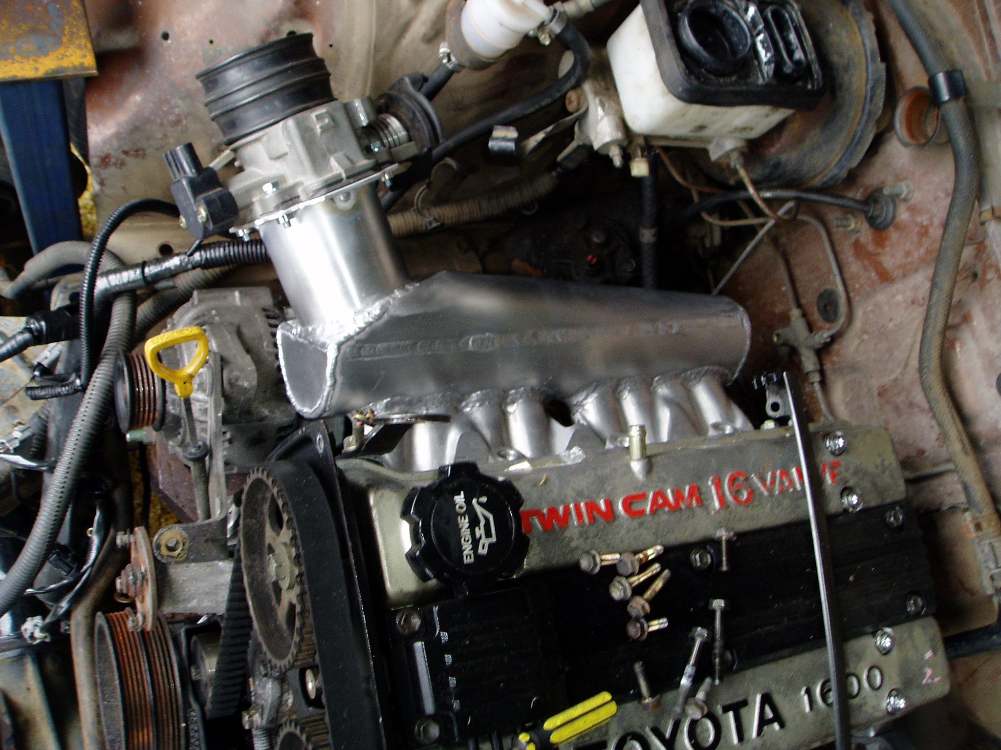

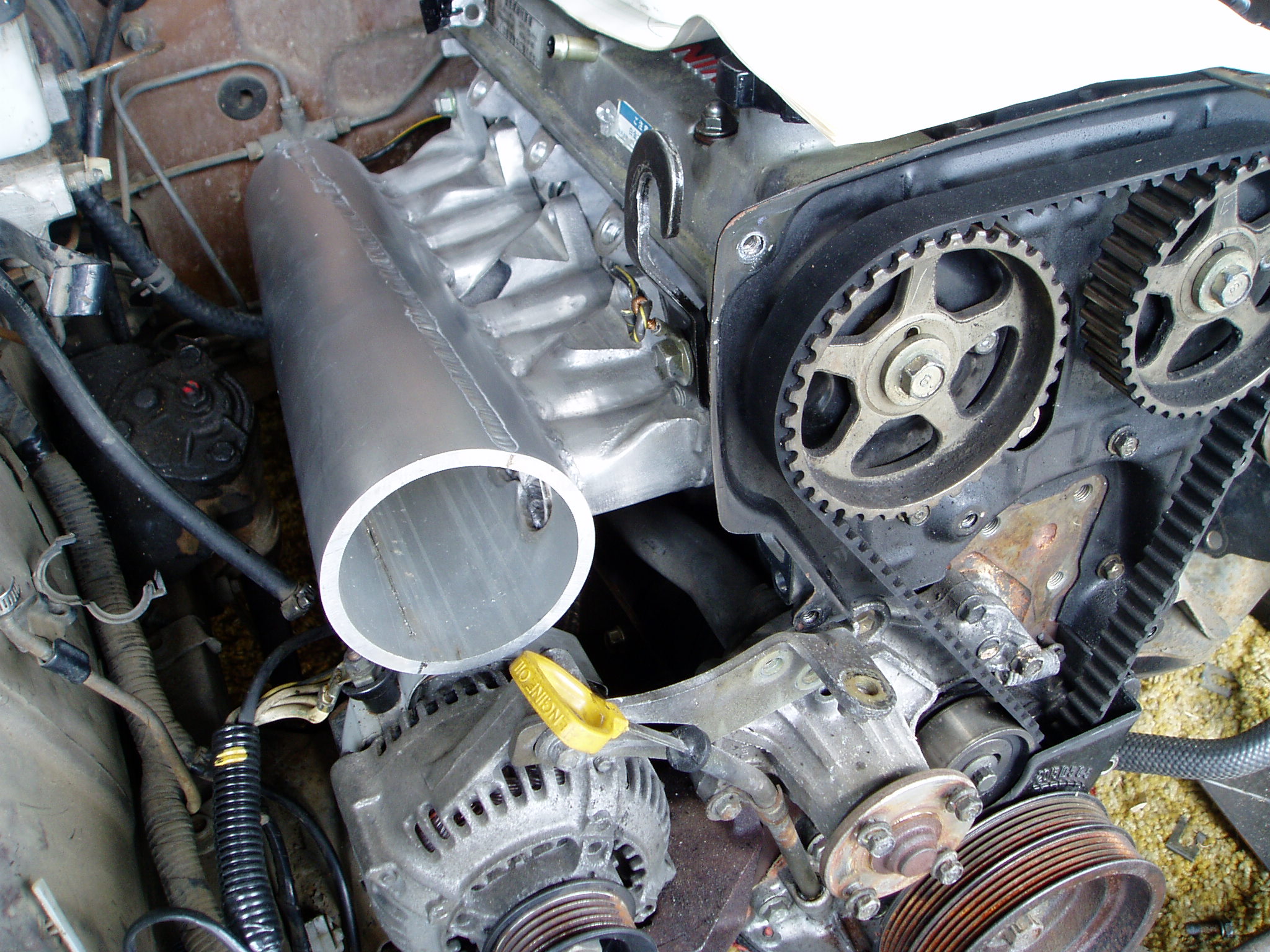

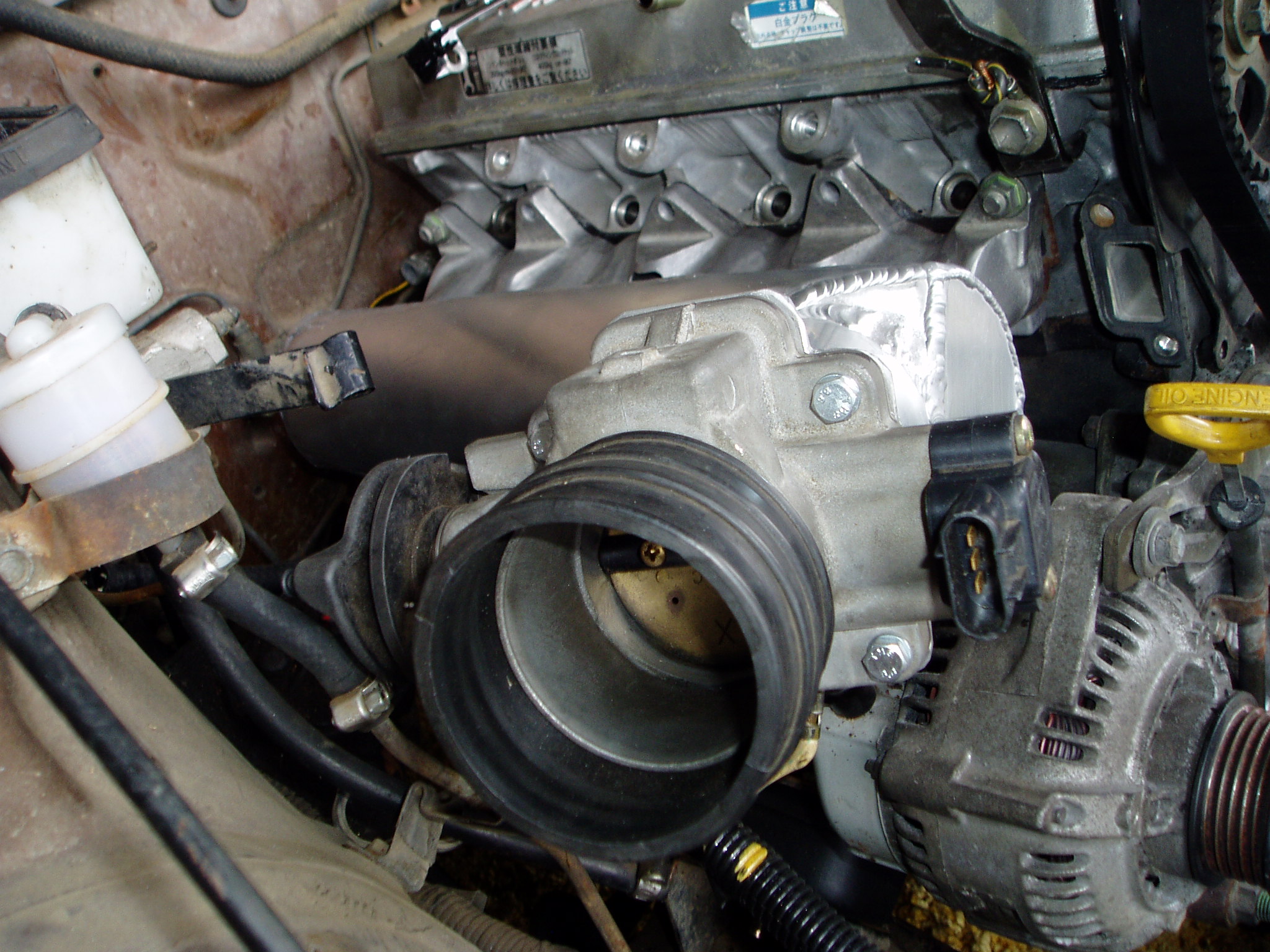

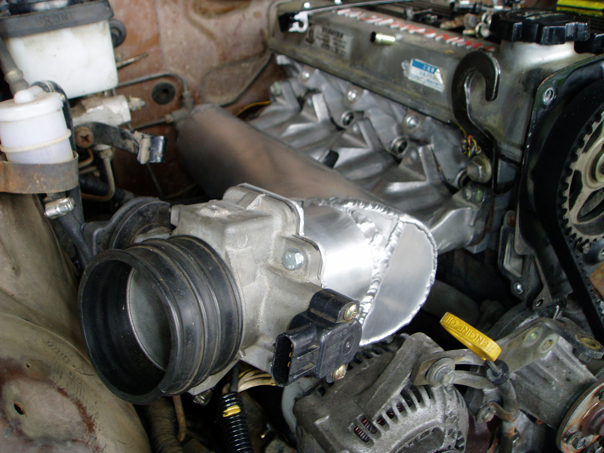

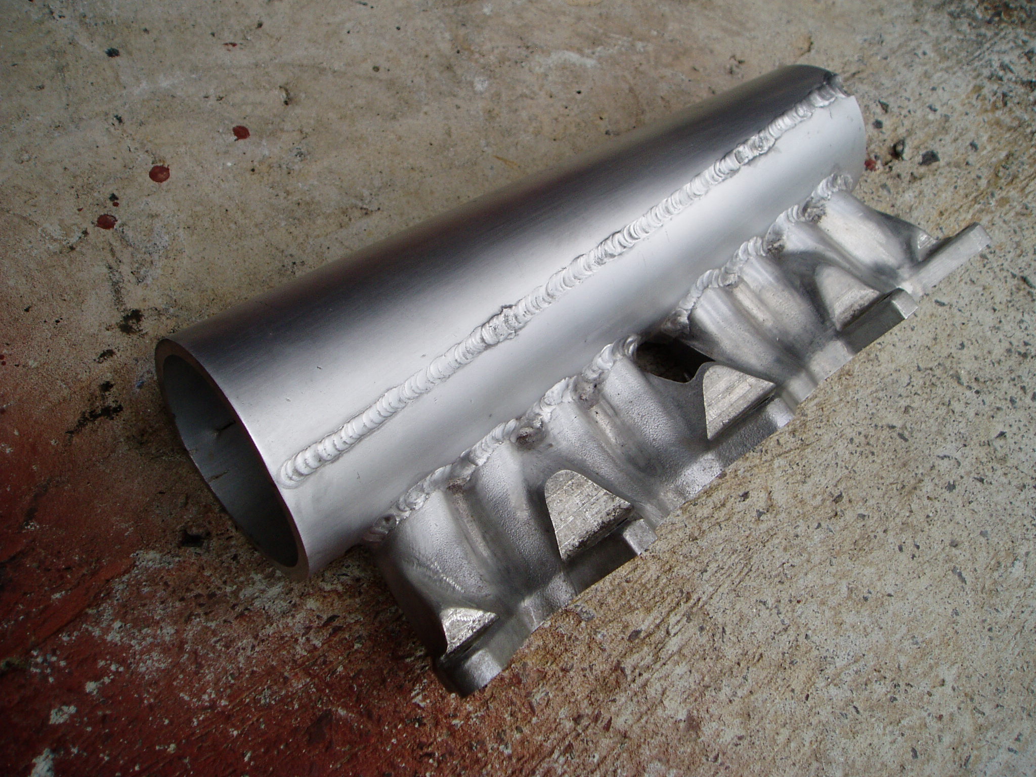

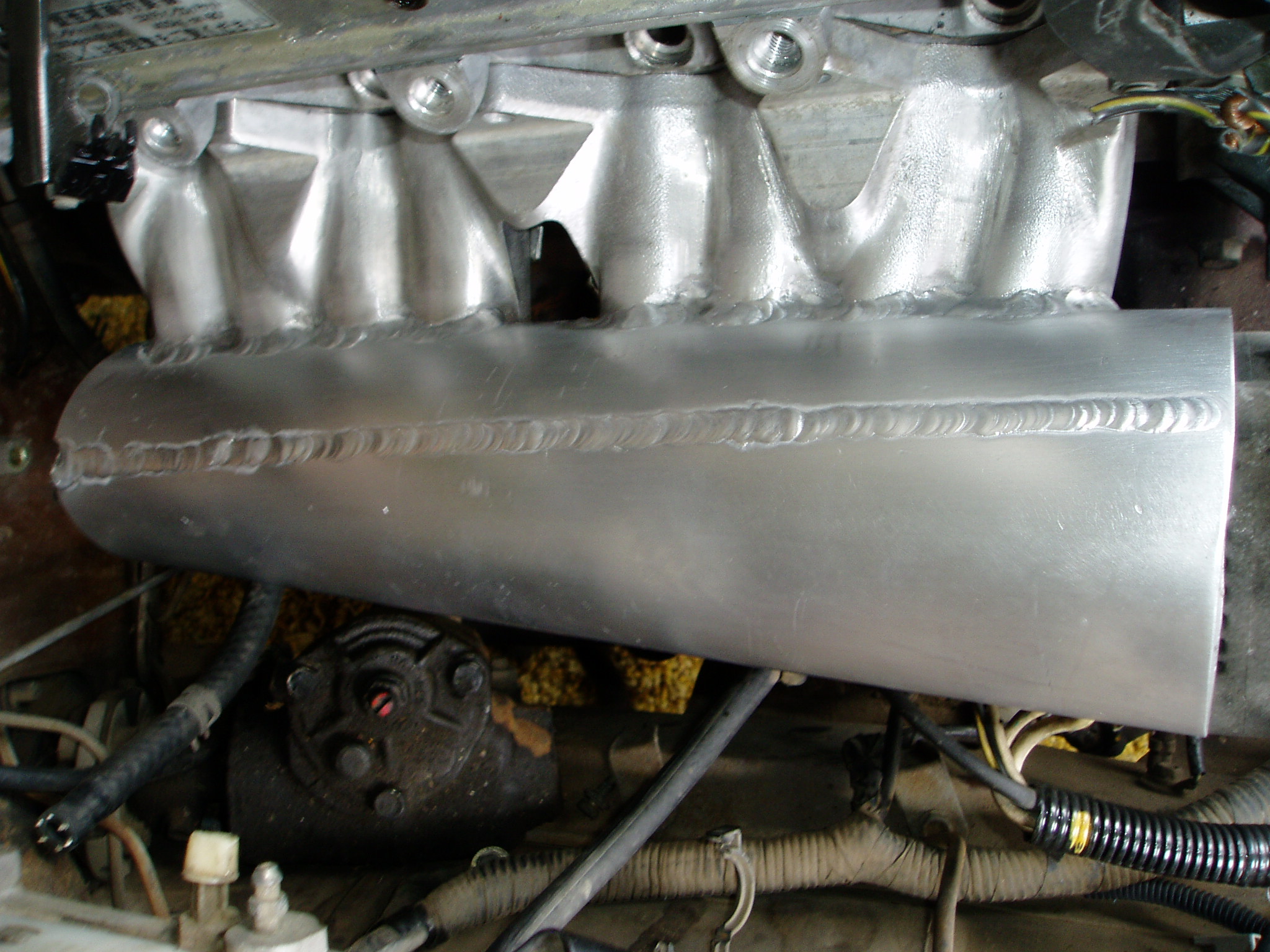

  12. Hey guys, got some bad news. I just discovered that the 86kw 4age that I bought has blown piston rings. THAT SUCKS. :lolcry: anyway I was planning on rebuilding the engine from scratch until I got a quote for it. So I have just recently purchased a 100kw 4age from sss. Guess what that means the inlet plenum that I made won't fit. I thought it would but the port holes don't line up. I have already scrapped it considering it was aluminium along with some other aluminium parts. So, again I travel the path of making a custom inlet plenum, but like everything the second time round it always turns out better. I have done some research on the intake of a car and have found out that the longer the runners the more torque, the shorter the runners the more revs. So effectively I am aiming for dead on half way in between. This weekend I will be customising my lower control arms. All I gotta do is make the steering lock plate a bit bigger to suit the celica struts. This is not a hard job. I will be getting some brand new pads and rotors for the celica brakes, and then I will get some news pads and rotors for the pintara diff, which mind you will be getting shortened shortly. :drgrim: Anyway, I would like to thank all you guys for all your words of advice and everything. Thanks. Will keep you updated as more happens.

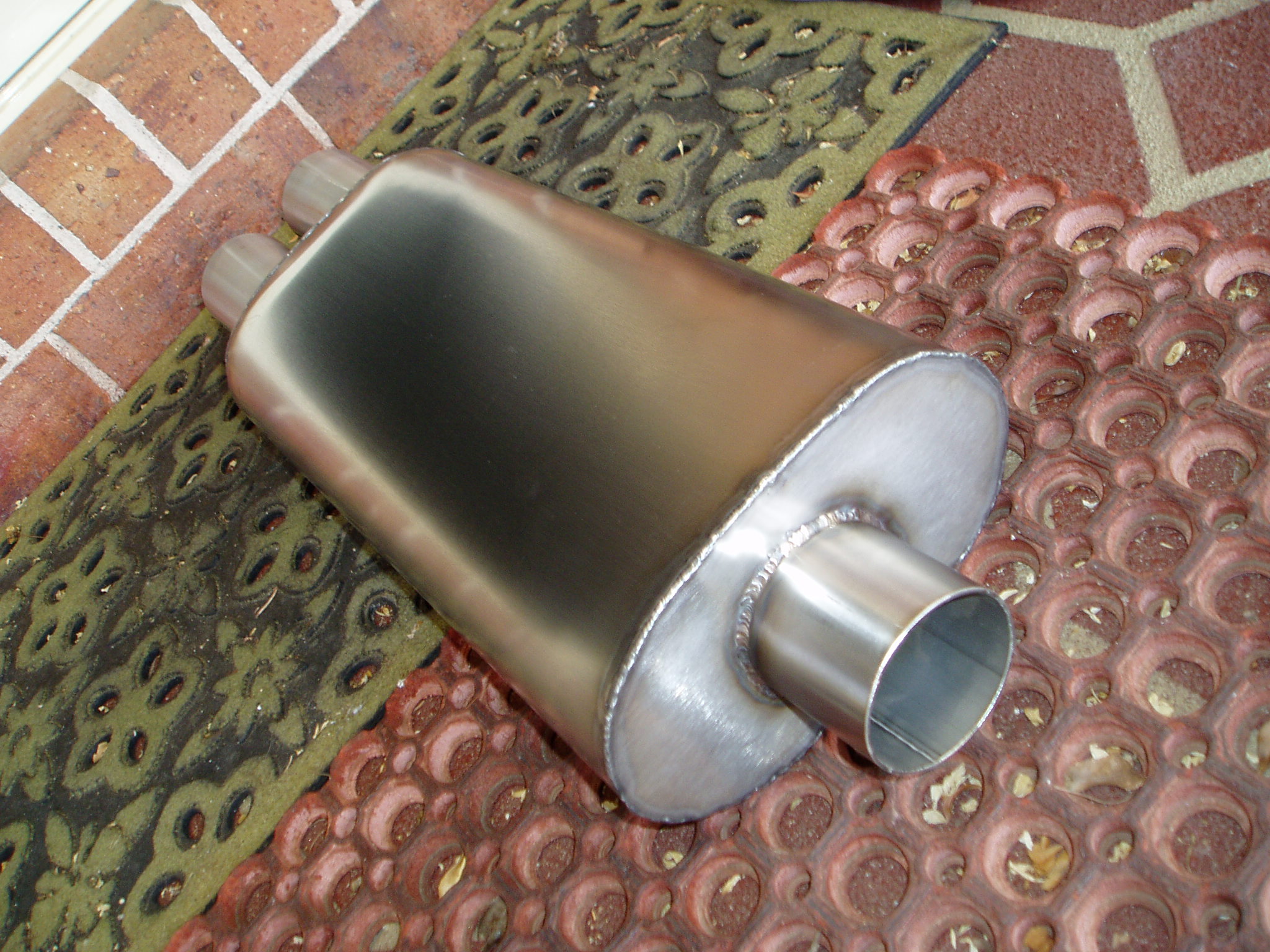

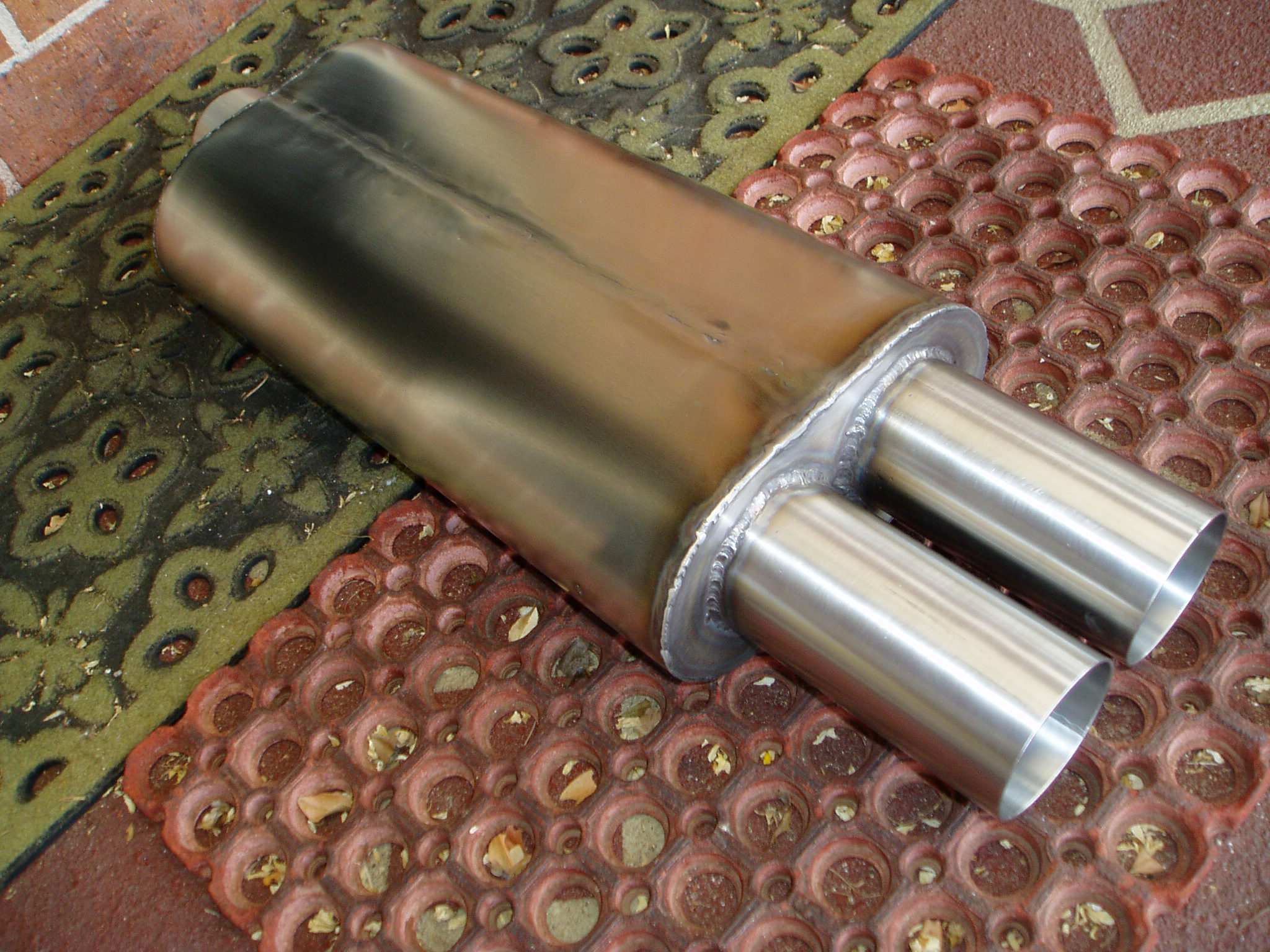

  17. Thamks dude. All I can say is practice makes perfect and I am still getting better. I would be happy to help you man. Question is how. I am also making a muffler for my car. Here is a previous picture of a stainless steel muffler that I hand fabricated for a mates car.

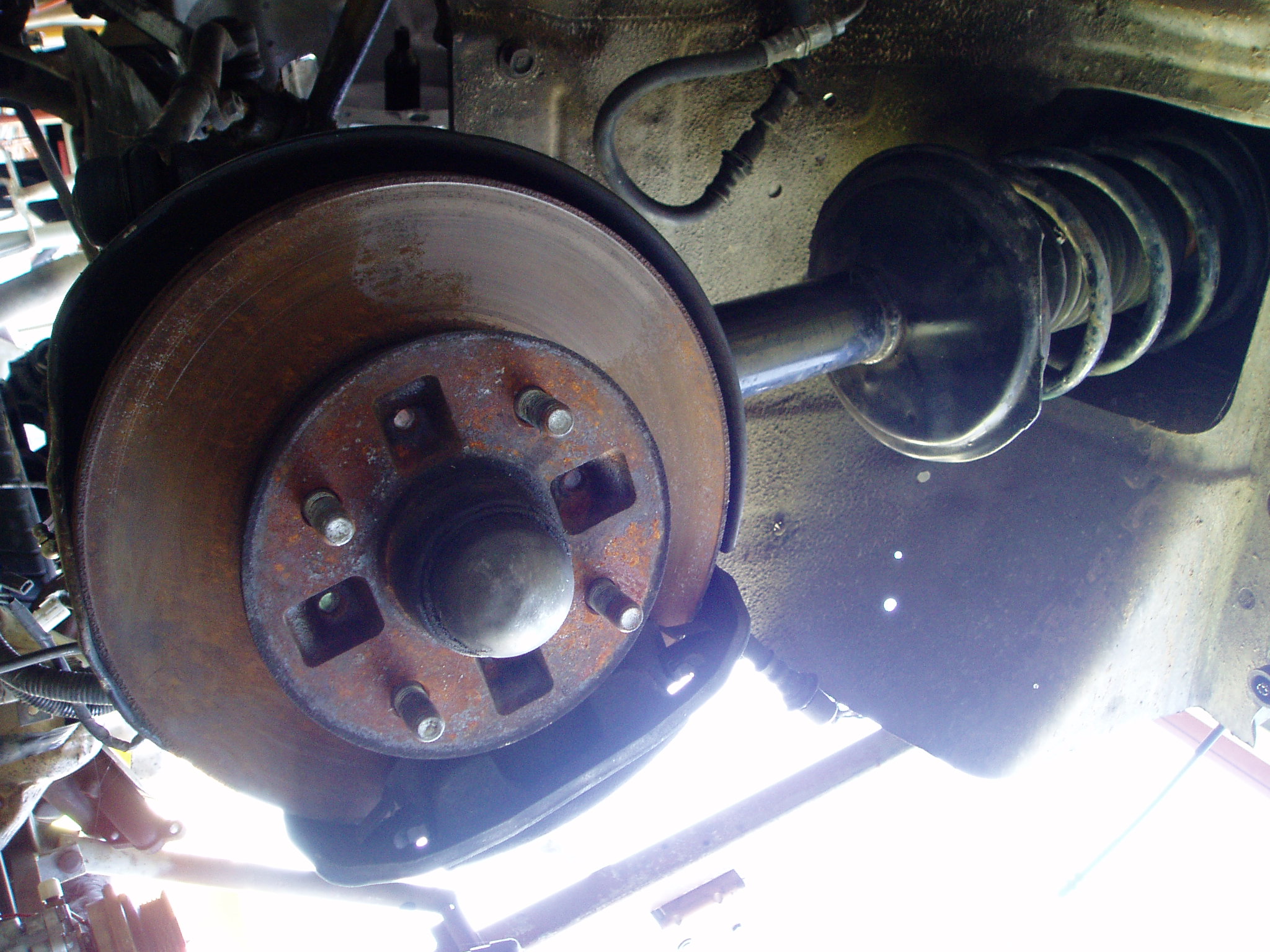

  19. ALRIGHT. Well thanks to Sbox I ahve now been motivated to share a few more things with my conversion. First of all I purchased a set of RA65 Celica struts for $100. They look fully overhauled with new shocks, dust covers for the shocks and KING Springs. It bolted straight onto the corolla lower control arm although that was using the celica arm that went from the bottom of the strut to the sterring arm. It all fit in well but then I discovered that the hole centres of the strut tops were different. After hours of trial and error I discovered that the celica spring was a larger diameter and the corolla spring was a smaller diameter. I played around for a bit and the bottom spring seat was the p[erfect diameter for the corolla spring, I then used the corolla top spring seat and strut top and it all bolts in beautifully. Reason behind this conversion was obviously larger brakes. (these dimensions are when they are bought brand new) The corolla ones are SOLID, 218mm diameter and 12.7mm thickness. The RA65 ones are VENTED, 258mm diameter and 20mm thickness. So quite a satisfactory difference. :lolcry: Here's a pic. Hope you like. Now for the next part of news. I have been working on making a custom inlet plenum and so far so good. I am using the standard runners that go into the head. I simply chopped the standard plenum off before the bend and began fabricating the brand new plenum. I welded the large pipe onto the runners after endless hours of getting the holes cut correctly to suit the runners. I then tapered the pipe towards the back in attempt to even the amount and pressure of air that is going into all cylinders. I am using a six cylinder Ford Explorer throttle body which measures 62mm, which should be more than ample enough for the mighty 4AGE. I made the throttle body come off on an angle to the pipe to clear the alternator and to allow for easy setup of intake pipes to the air filter. Anyway, more pics for you all. Again I hope you like. Plenty more to do so I will keep you posted.
