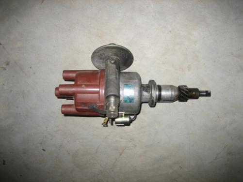

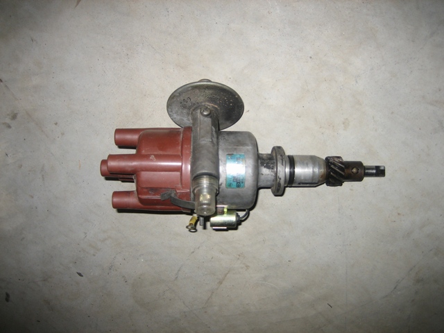

what Motor Is This Carby And Dizzy Off
hey my mate got me a carby and dizzy for nothin, he said there supposably from 4K but there different to the ones i have on my 4k first the dizzy is different it had a thing on the outside where u can adjust the timing advance or retard a screw also it is a long and skinny one not like my short and fat bosch one second the carby, it lookes similar to the one i have on my 4k but the throttle links are different also when i pulled it apart the secondary jet is on the floor of the float chamber thingy also there are two buttiflies in the secondary intake but one is not hooked up to anything theres just a weight on the outside of the carby. there also is many emission hose outlets coming from the carby which makes me thing its off a older motor i will try to get pics thanks
