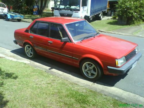

the motor is 60000ks old since rebuild it has a ported head reground cam jetted carby and aftermarket coil king springs and gt gas shocks... i am fairly happy with it all ive done since i bought it 2 weeks ago is rims and the rear muffler... not that is muffles much as this thing is damn loud and i like it :) overall its a clean ae71 except for a little rust but hey its 24 years old... let me no what you think!!!
