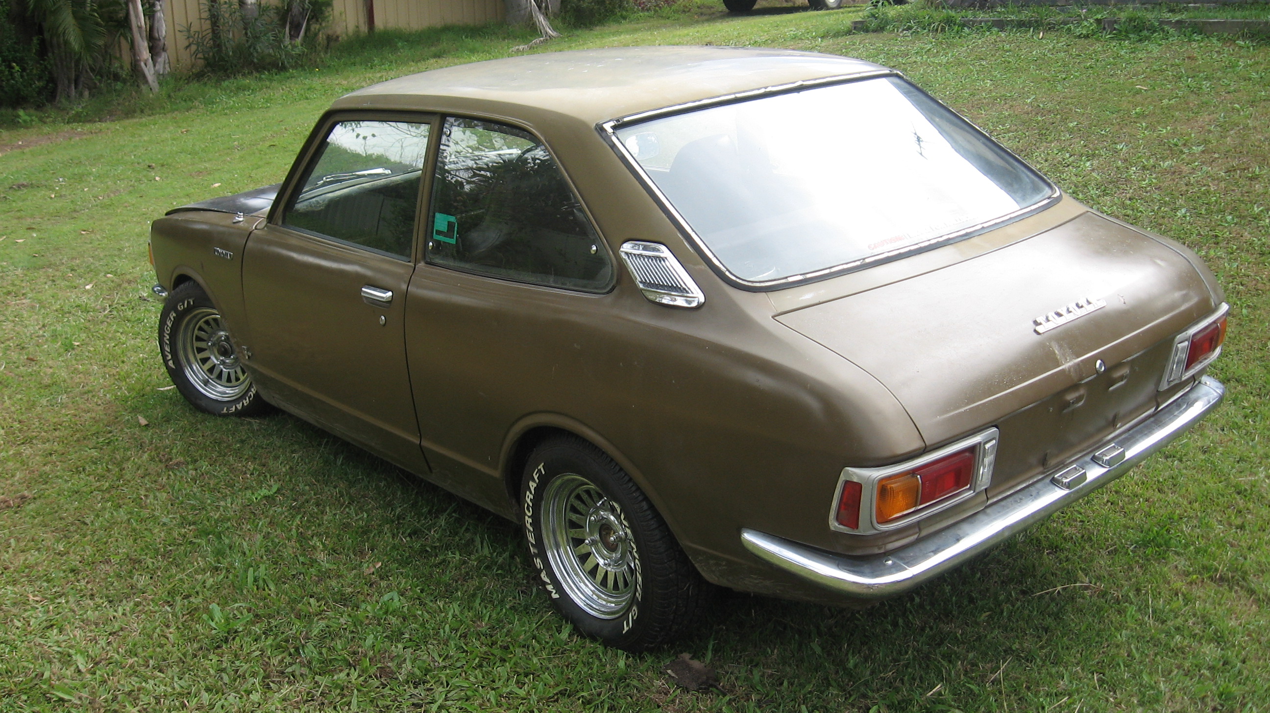

  7. Roo posted a topic in Rollaclub Rides
    hey this is the new project, a 1974 ke20 atm the specs are: Engine Specs 4k engine with fresh rebuilt bored out 60" with new ACL pistons Ported & Polished Head double valve springs Custom Grind Cam Done by Tighe Cams webber 32/36 tuned length extractors and 2" exhaust system Crow Cams Electronic ignition Electric dizzy Rebuilt 5spd gearbox suspension: front is cut springs new shocks adjustable lcas New Front DBA Rotors with Bendix CT Pads. The Calipers have been rebuilt and gold Anidiozed New wheel Bearing Kits rebushed rear looks like reset springs added swaybar and now the pics front (she is sexy, got cold air induction) interior, pretty shit but will fix her up the beast of a engine my new front brakes and adjustable lcas cam is really lumpy so idle is like a rotor but i guess the exhaust doesnt help so the plans: full respray, better front suspension, full retrim, new rims, new exhuast will get a vid of her idling soon so what you guys think? cheers andrew
