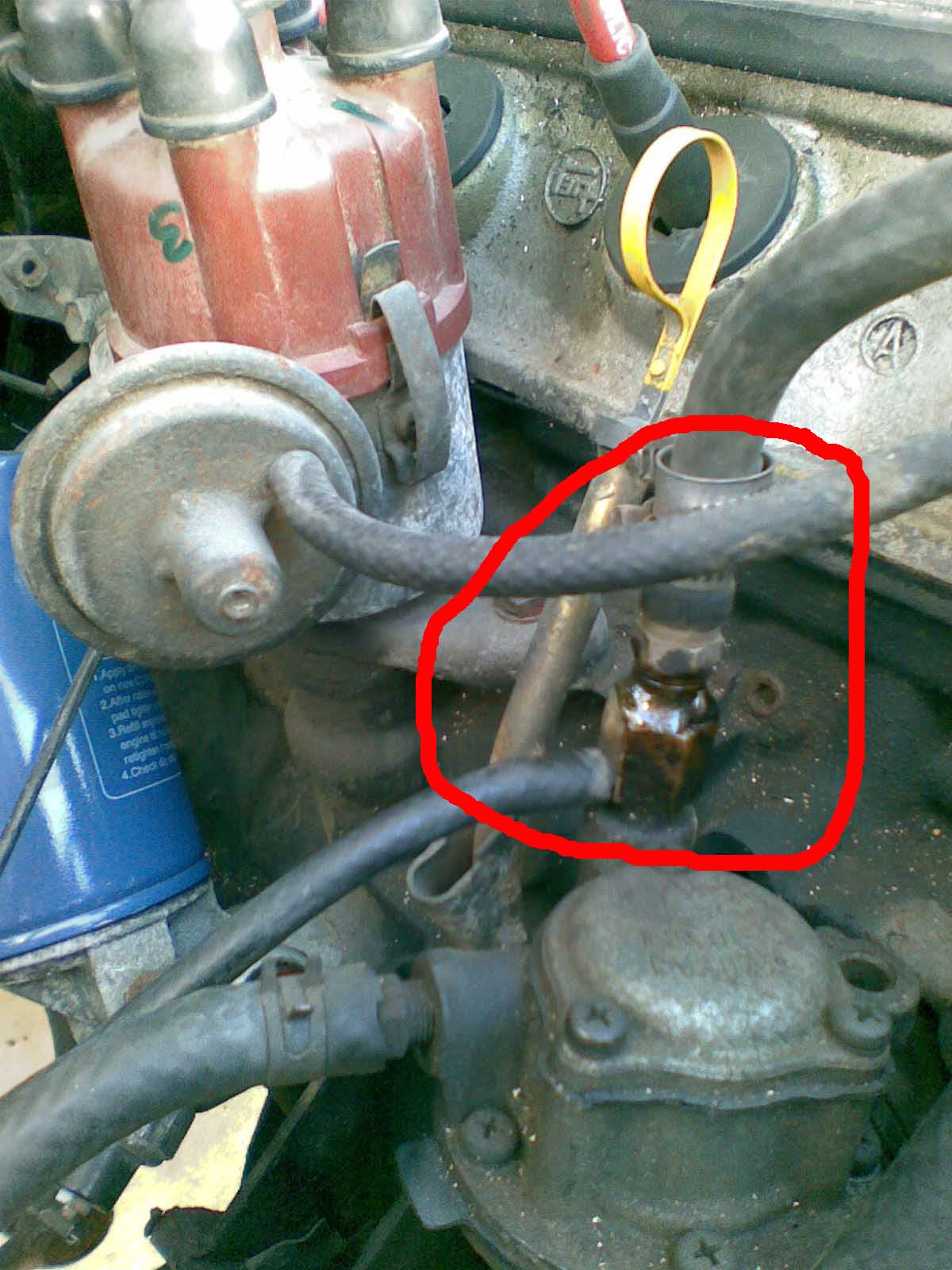

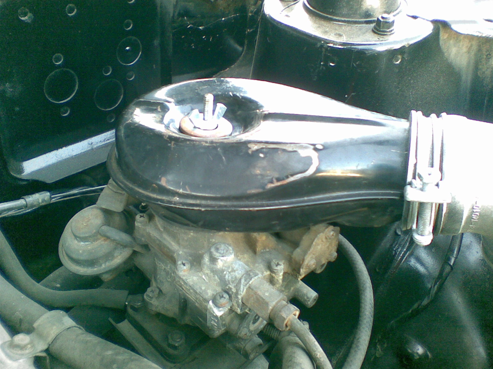

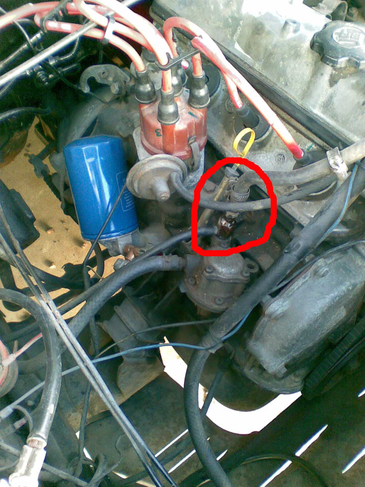

  10. need some help again please. i was smelling petrol when my car was running and thought it was just running rich until i just put my new battery in and had my head under the bonnet while the car was running. i saw something dripping and upon closer inspection found it to be fuel!!! not too great as far as safety is concerned..... here are the pics of the culprit... circled in red is the origin of the leak, it looks like its leaking from the middle where it seems to have been braised or welded. i don't know why fuel has to go here but I'm sure theres a reason for it. so what i was wondering if someone could please tell me what this is for and where i can get a new one that wont leak! what models have the same thing?

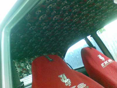

  11. dude that sounds like it would have been hilarious to see!! did a bit of work on the weekend but i don't have pics yet sorry.. 1: installed the roof lining, looks sweet! 2: covered and installed the sun visors 3: installed bmw headlights 4: serviced, changed oil, flushed radiator, changed oil filter, installed "fully sick" pod filter, changed leads, changed points, plugs 5: finished installing the front seats, and seatbelts, (thanks paseo!) 6: started mucking around with the dash, gonna take a lot of work!! i also installed my 4 in 1 tacho and found out its dodgy! :D tacho works but the three little dials in it don't work all that well, readings jumping all over the place. not happy. anyway, ima go see what else needs doing. cheers

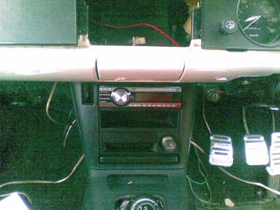

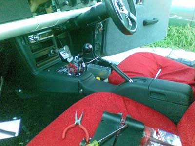

  16. centre cosole is in but still needs finishing touches, (black bolts etc) stereo is in but wires need to be hidden better sits just under the dash, nice and neat, white dash bits to be painted black. dash is out now too, ready for a custom job on the weekend my "custom volvo" venetian teaser shot of the roof lining......... enjoy, more to come!!

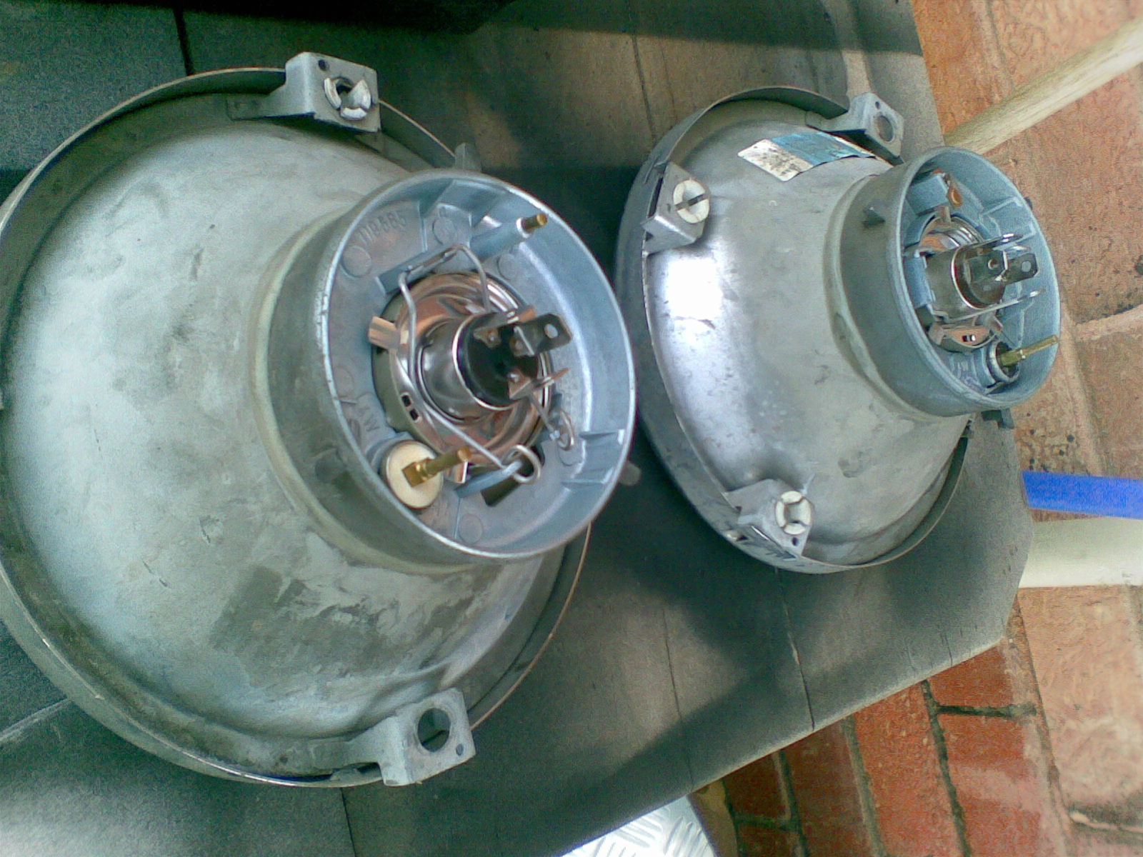

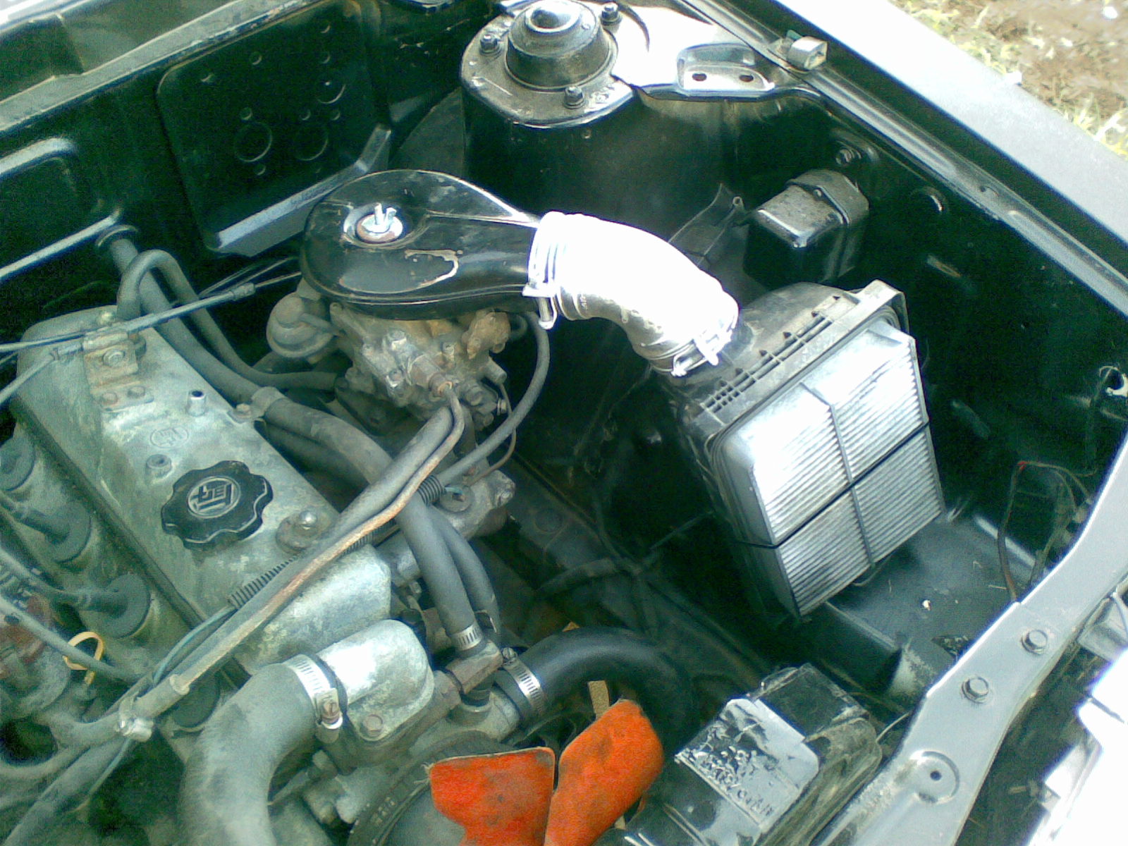

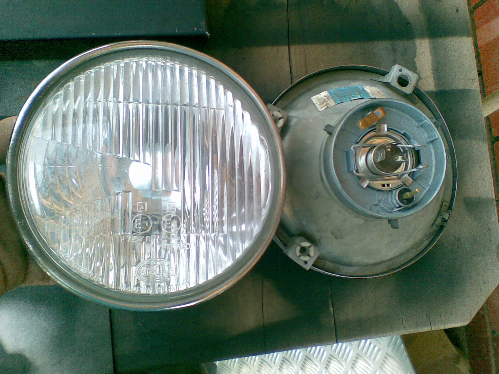

  22. just went and found some semi seeled beam headlights at u-pull-it! 55 bucks on ebay and i got them for nothing. these ones are off of some bmw, can't tell you the model though sorry! prolly wont be a direct fit but ill make them work. now itll tak a h4 bulb instead of having to replace the whole big thing!! and here is the induction thing fitted, i need to get a pod filter so i can get rid of that ugly air box!

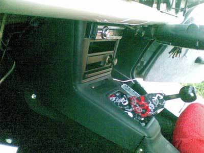

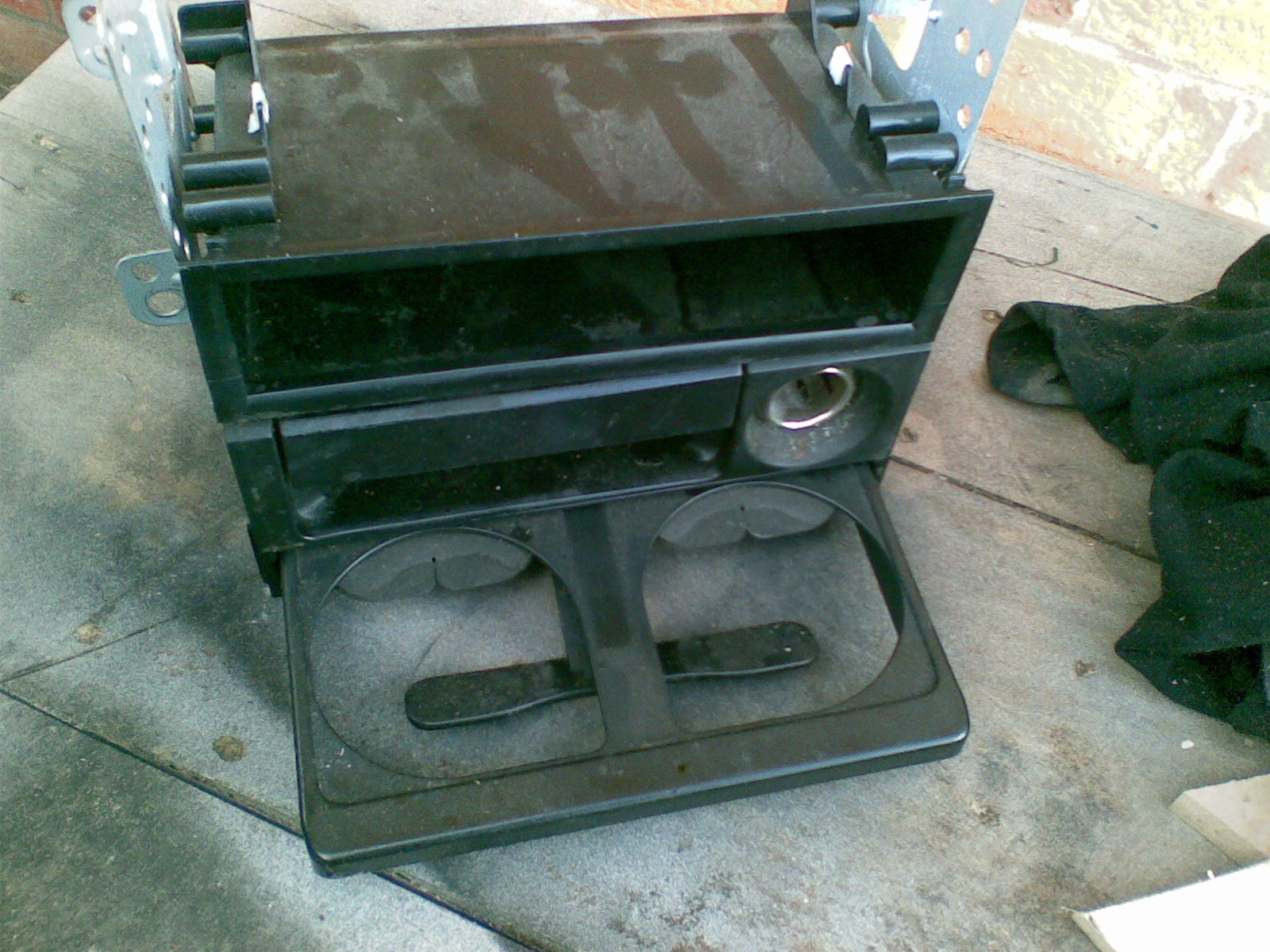

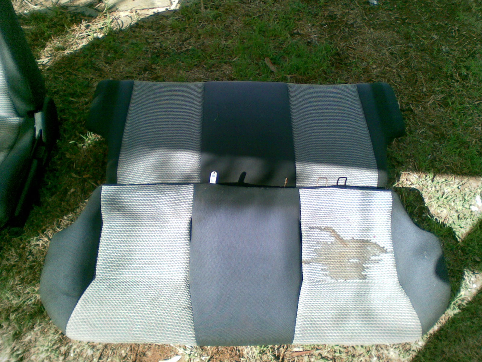

  23. here are some pics of the seats, console, etc. Paseo Front bucket seats Paseo Rear seats Paseo centre console comes with cup holders, uh i mean beer holders!! this thing i got off of a ford econovan, its part of the intake system, and guess what, fits exactly onto my standard carby!! makes cold air induction so much easier and doesnt cost 300 bucks like the ones in the shop! anyway, ive gotta go and make the console fit and install the cd player so i will leave you there for now. cheers oh, and if you didnt know a paseo is a toyota too so I'm still staying true to the brand!
