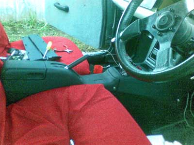

here are some pics of the seats, console, etc. Paseo Front bucket seats Paseo Rear seats Paseo centre console comes with cup holders, uh i mean beer holders!! this thing i got off of a ford econovan, its part of the intake system, and guess what, fits exactly onto my standard carby!! makes cold air induction so much easier and doesnt cost 300 bucks like the ones in the shop! anyway, ive gotta go and make the console fit and install the cd player so i will leave you there for now. cheers oh, and if you didnt know a paseo is a toyota too so I'm still staying true to the brand!
