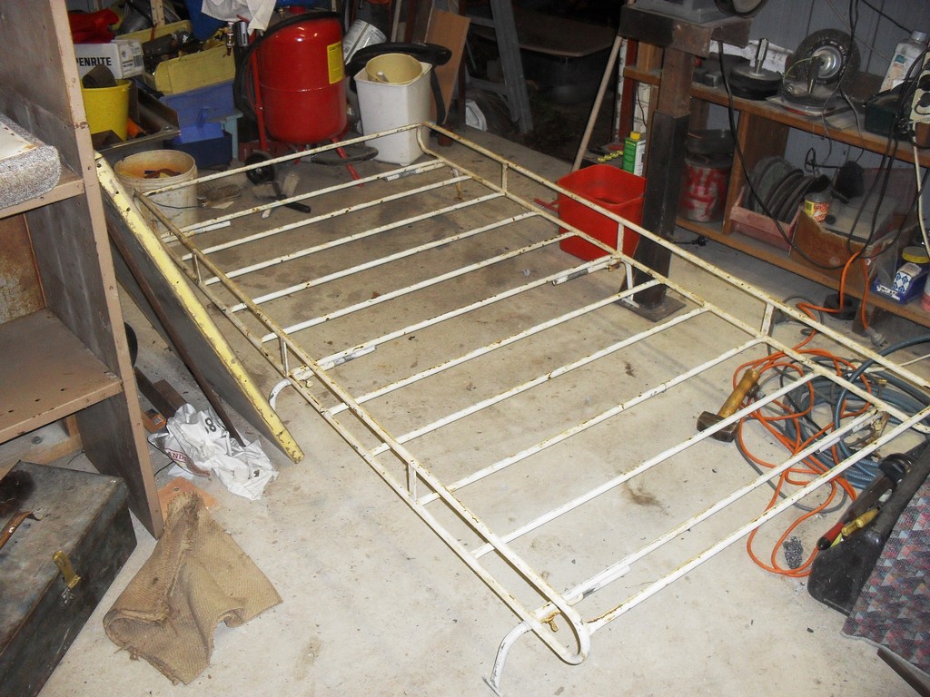

So Pete and I have been working our butts off gettings the roof racks finished up and they are now on the home stretch! 98% of the paint is off; the two rack sections have been welded together and the mounts have also been welded back on in position. It was a tedious process getting everything spot on for alignment, but it paid off, as there must be less than .5mm staggered fitment of each section joined to the other. I fitted them up 5 minutes ago for a test fit. They fitted exactly how I wanted it! :) There is about 40mm of adjustment outwards before they sit in the gutters, so just in case I get a car with slightly smaller gutters they should fit. The only thing that I'm not liking too much is that they are slightly too high compared to their length now. They still look great and will be perfect for the trip. The next step is to touch up the grinds on the welds and finish getting those last few chips of paint off. Once I've finished this I will give them a good clean and then give them a lick of primer/paint... I tested the colour of the Red paint that I bought on some scrap roof rack and it is quite bright, but I think it will still look fine. I tried out some hammmered copper finish on them today to see what it looked like. It wasn't too bad, however it wasn't a match for the blue paint, so I'll stick with the red! :) Pictures soon guys!!!

So I've been working on the roof racks recently. Here are some pics of them of how they would "fit" when I first picked them up. The plan is to cut them down and take out 4 of the bars running across the roof, leaving 9 in total. It will end up going from where I want it to sit at the back to halfway along the drivers door. The mounts also need to be removed and brought in so they aren't too wide. I'm moving each side inwards approx 65mm to leave about 40mm of adjustment outward before they attach to the roof of my car. I'm also painting it RED! :D So on Friday night I got to work cutting them down, ready to weld.. that reminds me that I have to pester my mate to borrow his welder! This is what I started with... "The canvas". First thing I did was mark it out and work out where I was going to cut it so I could weld the pieces back together easily. Next on the list was to remove the mounts, ready to be welded back on. This is the original position of the mounts. They will be moved in about 65mm. I started to cut at the welds with a thin grinding wheel as carefully as I could so I didn't damage the frame. I nicked it a few times and couldn't help but cut into it slightly on some of the welds. I love the wing nuts. They don't make things like they used to! So once I removed the mounts, I cleaned up the frame by grinding away the excess weld so it was all schmicko. I also cleaned up the mounts so I could get a good weld on them when they're ready to go back on! All of the mounts removed So after all of the mounts had been removed it was easier to manouver in the shed and get my sectioning cuts straight. I measured it all up and used a square to make sure everything was plumb before I started cutting.. As I've always been told to "measure twice, cut once". About 500mm (half a metre) of the middle came out and the two end pieces are going to be welded back together. That's all I did on Friday night and I've been trying to get hold of a welder so I can put the two pieces back together. In the meantime I've been taking off the old paint, with paint stripper, scourer and an abrasive grinding disc, ready for the RED! Can't wait to see how they turn out! :cool:
