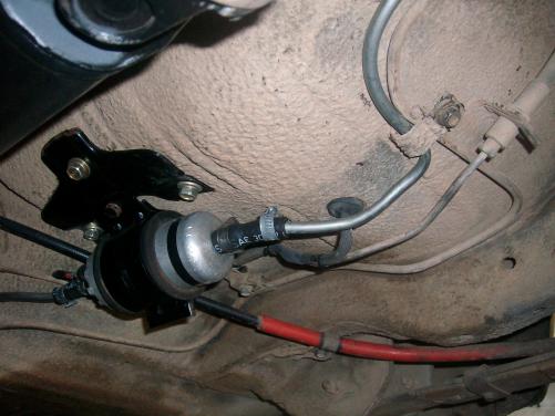

  15. off getting exhaute done now 2.5in Engin bay done EXCEPT A/C NOT FITTED YET pick of pump placement
