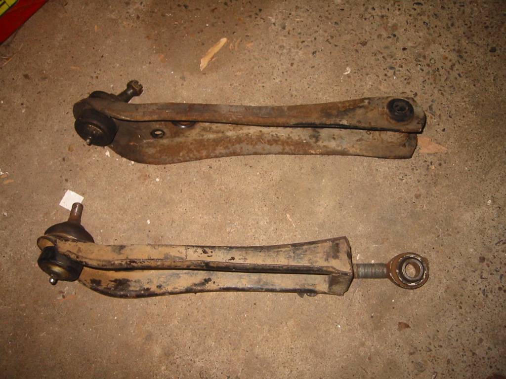

ok i did a rough mesure of my control arms tonight and came up with this:
total length from centre of inner bush to centre of balljoint = 330/335mm
inner bush to castor rod = 270mm
inner bush to swaybar = 240mm
so it looks like the siggy arm is too short?

cheers fellas, i might consider the rosejoints then, were do i get them from??
also i have heard people say that with there ke30's they used gj sigma LCA's first and they were to long so they might be the right length for ke20's??? just guessing though, i will have to do some investigating
