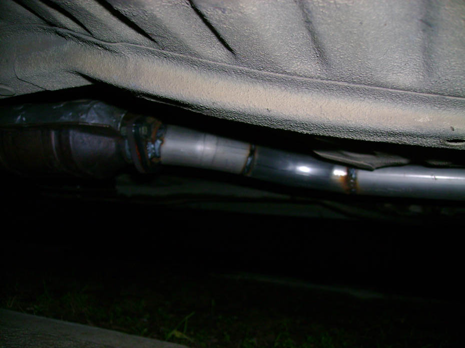

Got around to my mates yesterday (where we did the engine conversion) and had the cat convertor put in - the exhaust note is sooooooo much nicer now - not raspy, and you can't hear me coming from 3 blocks away, which is good for Regency :D Can hear the engine roaring when you push it now too, so that's a good enough sound to listen to!

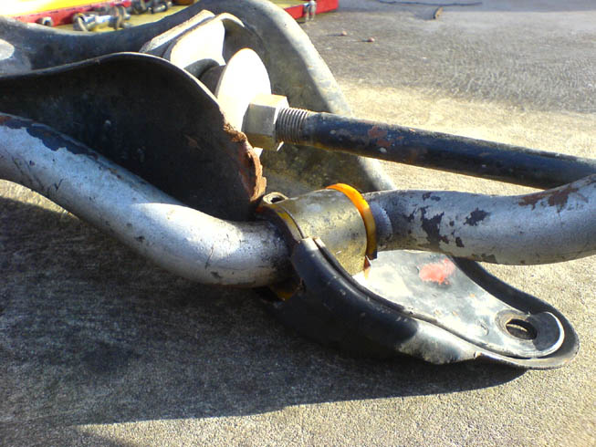

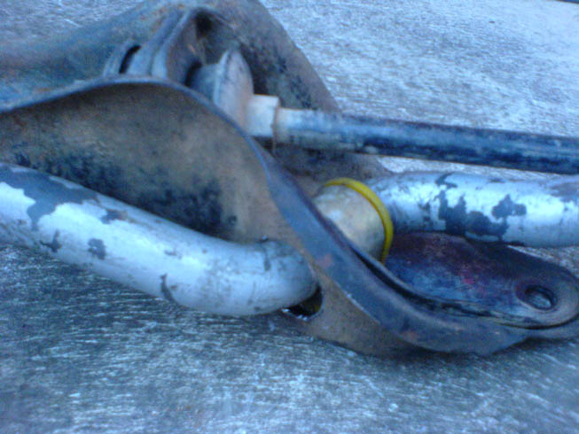

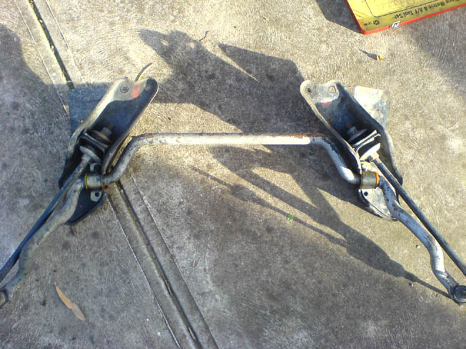

After a bit of weeding in the garden this morning, i decided i may as well give the castor brackets a shot - came out easier than i was expecting, but getting it all back in wasnt as easy :( had to grind about 2-3mm off each side of the eyelet end of the swaybar to get it through the stock sized hole on the bracket (didnt have big enough drills to just grind that out a little), then took about 30mins to work out what way it all had to go etc. Finally got all the bits through and then mounted it all back in place - couldnt quite get one bolt on the bracket back in so will leave that for another day as it was getting quite dark (spotlight had to come out!), then there was quite a bit of grunting and pushing to get the swaybar and castor rod mounts back on the lower arms.
Old "modified"/hacked ones
New nice non sharp edge ones
But its all back together now, ready to be taken on a test tomorrow to make sure it doesnt fall apart. So a couple more things ticked off my list..... :(

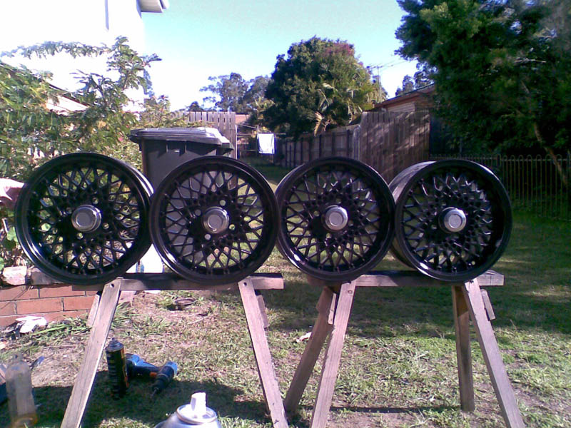

Have also still been hunting around for some new wheels to get rid of any potential issues from the officers of the law/regency/insurance. Got my eye on a set of meshies. Only thing is they're only 14x6, and was ideally going for 14x6.5, but may go ahead with it anyway and can run a spacer if i wanna get them pushed out a bit more.
Thoughts?

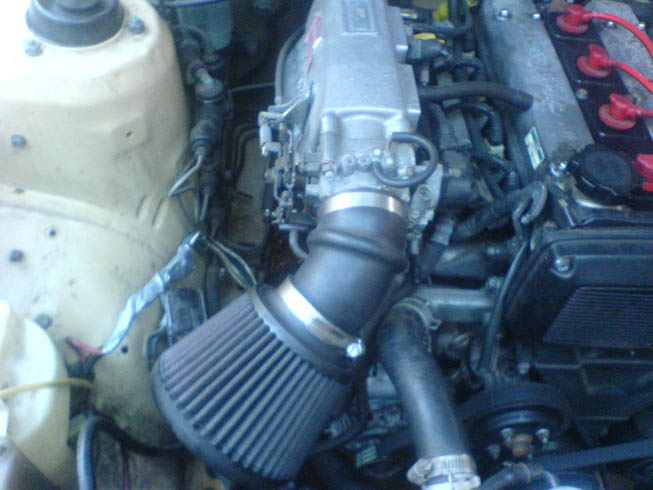

Old setup - pod was literally just sitting on the rubber "hose", and you could pull it off with no effort at all - did the job though :)

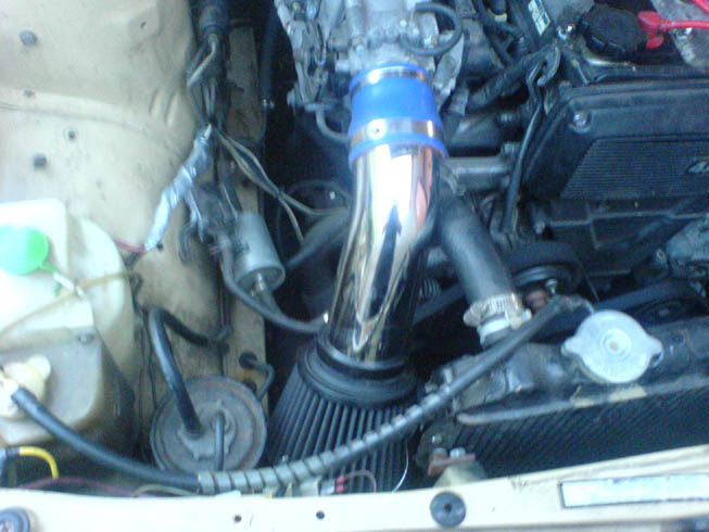

New shiny one - have managed to squeeze it in between the carbon canister and radiator, and will have to stay there til i go through regency - then the canister will come out and the pod can sit in its rightful place :hmm:
Might wanna heat shield that champ or you'll just be sucking in hot air which isnt good :yes:
Yeah, was thinking that - not really gonna be driving it like that for long/at all, so wont bother with anything for now as it'll be going over where the carbon canister is onces its been through regency - plus the airflow where it is there at the moment isnt great either - might actually put the "old" setup on it until its gone through regency, then the new one after its done and can go in the right spot :dance:
Just make sure the old one is secured or you'll get knocked back.
Better still, retrofit an airbox when you go through to keep them happy that the airbox will arrest any sparks. :dance:

I'll slap the new one on when i go through as their main concern is the pod not being able to move, which it can't with that setup - wont hurt it to drive it down there sitting where i put it :dance:

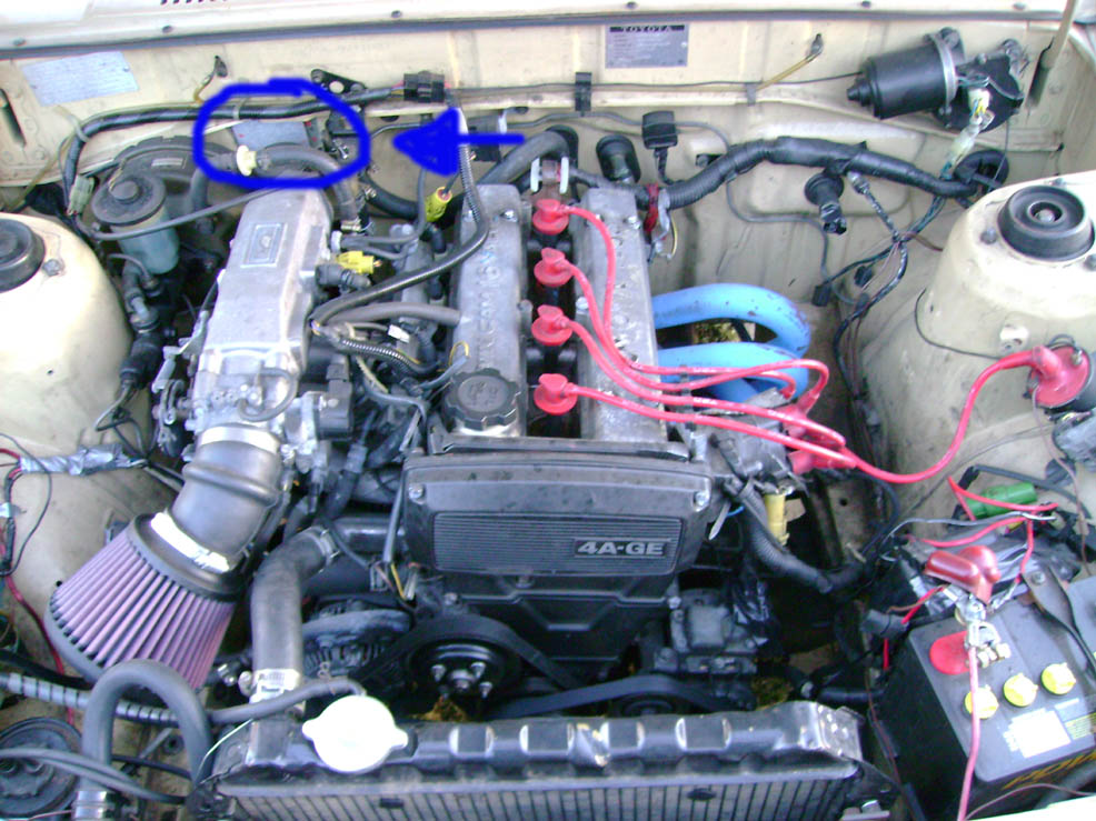

Very average pic of the job my mate did for the cat converter to go in:
On the "legal" side of things, looks like i just need to get the speedo recalibrated, put stock rear springs back in, swap with my mates wheels and MAYBE weld up a plate in the engine bay where the old clutch setup used to be before the conversion :S
With the hole which was used for the cable clutch, I just put some of my new loom into that. It looks like Toyota put that hole for the wiring from factory! hahaha
You've been quite the help to me tonight adam :S might have to look at that as an option
This is all we did - just a metal plate glued on - maybe i can get away with it if i spray it the same colour as the engine bay, as i've got some paint laying around? :D
