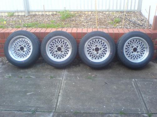

There are 3 type of SSR mesh style wheels i know of
Formula Mesh - Stepped dish
Reverse Mesh- flat from the mesh to the outer lip
Formula Star - Which you have, and there is a possibility they are the same as revers mesh, as i am yet to see a difference in them. (could be a name given to them, because it looks like the reverse side of a rim)
who cares tho, they look hot and I'm jealous ahha
cheers
matt

Cool, thanks for the info! it does look like they are the same though hey!
Thanks Philbey - looking forward to getting them on the car this week - looks like i've got a buyer for the hotwires so thats good too - pays for the tyres :y:
Organised some rubber for the new toys this arvo - was just gonna go for some Nankang's, but ended up going with some Sumitomo Tyres that are made in japan - apparently alot better than the nankangs - i know stuff all about tyres, so who am i to argue, and were only $15 more each.

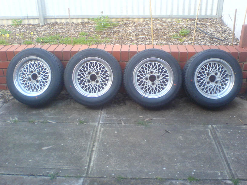

nice how much did the tyres cost ya?
what profile are they? tyres look huge
yeah mate, they're bigguns :) 185x60x14s - was gonna go for 175's but they didnt have any there ;) figured a slightly higher profile tyre would make it look a touch lower until i slap some lower springs in it - was running 60's on the hotwires, so not much of a change
Um, they were $90 each i think
ok thought they were 15s thats why thought the profile was big,
they look good, but they don't fill the guards?
go any pics with them on
nah, they don't quite fill the guards - got the flared guards up front and they are inside them by a little, and a bit of room up back, which is good though as i couldnt have anyone in there before as it'd scrub - will get some pics up tonight, but it'll be with the standard springs in the rear. Wanted something a bit narrower though, so I'm glad there's a little bit of room there :)

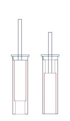

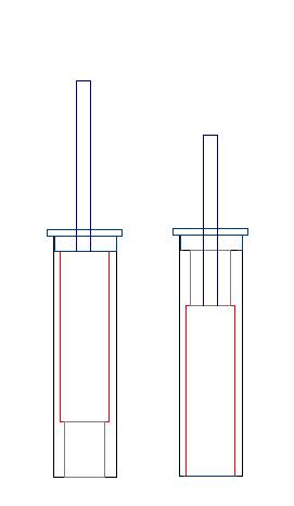

With my Celica short stroke shocks, they don't keep the 210mm springs captive at all. You'll be able to make it captive if you put the spacer between the gland nut and shock though (mines currently sitting with spacer at bottom).
Here's a picture to show you what to expect with your springs. I'm running 210mm 8kg, so yours will be slightly lower.
Cool, thanks Adam - you're running st204's in yours arent you, or ST185? What do you mean by putting a spacer between the gland nut and shock (like t3 gland nut style???). I do like that height though :y:

Taking a look at that beautiful paint work of mine, the black box is strut, red box is shock, silver is the spacer, the blue colour thing is the gland nut. I hope you can kind of see where I'm getting at. :y:
Yeah, that's what i kinda had pictured in my head - i would've thought short strokes would've kept short strokes captive though, but i guess not. Looks like it'd be best to have the spacer at the bottom though spring captivity wise :y:
